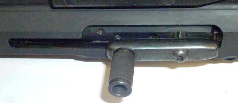

I got a BCA upper side charger for a 300AAC build and after taking the bolt apart a few times I noticed the handle mushrooming.
Looks like soft handle steel against the hardened carrier started making a mess of the factory handle. Wasn't over-torqued either, just
brought snug each time. The carrier has (had) a slight curve at the landing and that seemed to contribute to the flaring as well.
I was afraid with repeated flaring the socket head 10-32 would protrude through the carrier wall and stop the bolt!
I used a shoulder bolt Grade 12.9 and so Titanium rod and made this.
No way it can come through and stop the bolt now. Can't corrode and it's extended enough so that a cross-reach AK charge
keeps my hand from hitting the QD scope levers.
I'm just a retired machinist who understands guns. And isn't scared of Ti.
Ah, the prototype bolt was a 12.9. My source says these are more a grade 8 steel bolt.
I also offer these in stainless 18.8 now. Boat gun, Bayou, Alaska, wherever, it won't corrode.
I don't see how you could get in the way of a recip bolt handle.
Here's mine. Standoff is a drill bushing countersunk in an aluminum hand shaped scrap.
Gonna modify for two bolt holes.
