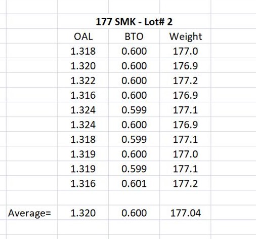

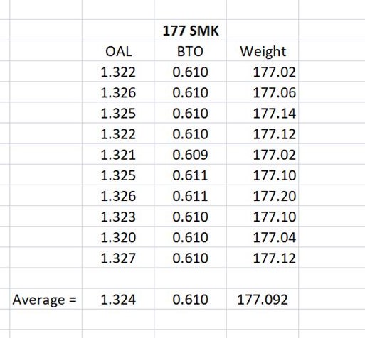

Just measured a bunch of these.
OAL - 1.325"
Using SAC 30cal bullet comparator
They are consistently 0.576" to Ogive
Using Hornady 30cal bullet comparator
They are 0.672" to ogive
Thanks for this! (y)
Your OAL's are very close to the 1.324 average that I got.
Quite a difference between my Sinclair comparator and yours, as it is with my Hornady comparator as well. ;)

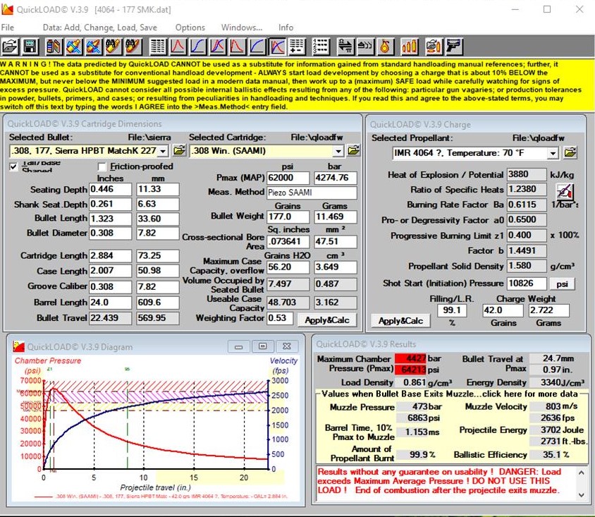

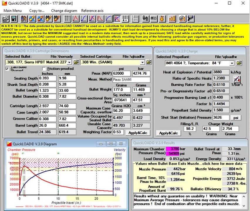

Looks like the velocities you've got is very close to what my QuickLoad app calculates for the particular lot of IMR-4064 that have. Pressure being a bit over max. And I see you're using the CCI magnum SRP's.
(edit on 8-17-2023, adding a new lot #2 I just received)

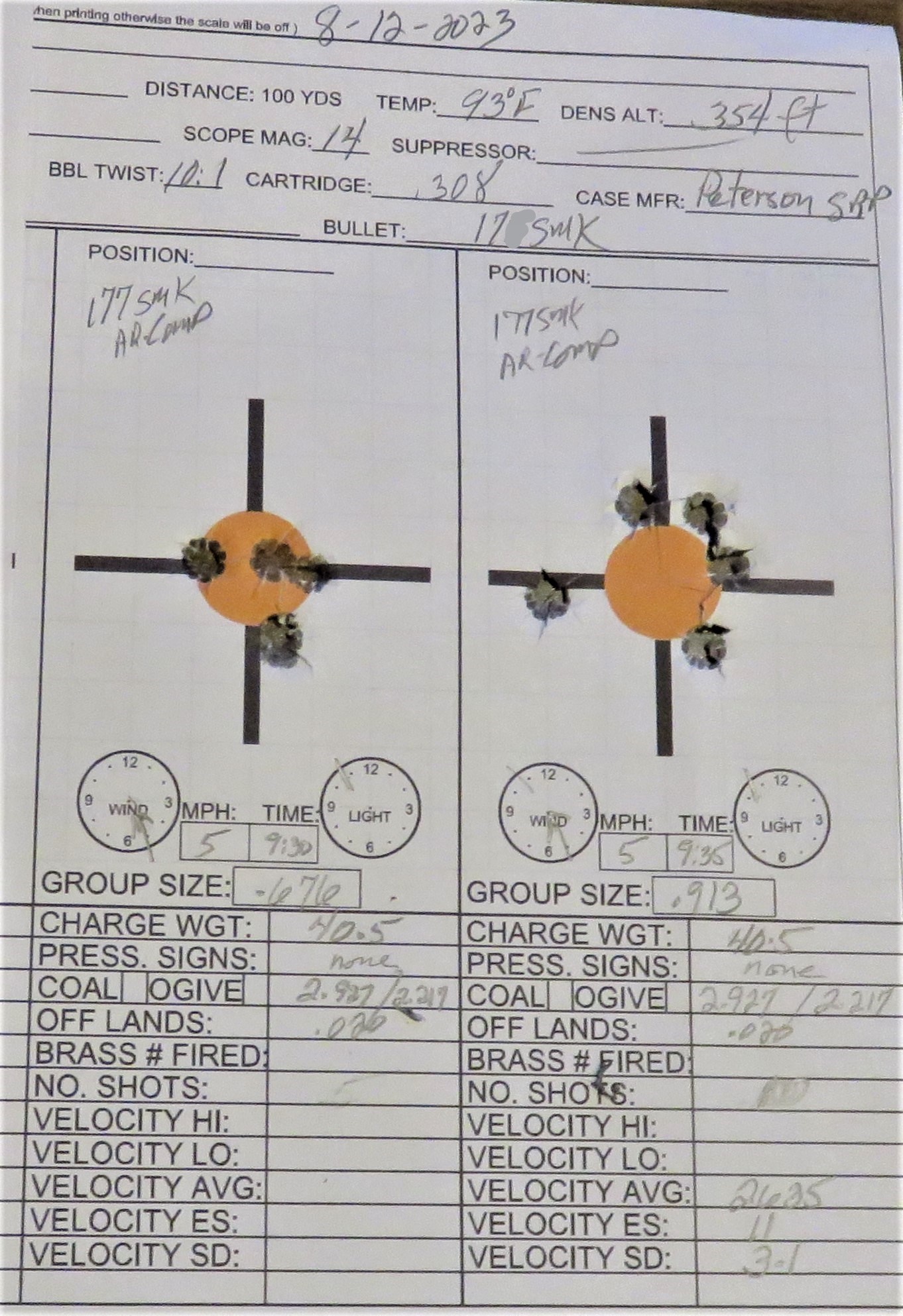

Was doing some load development with AR-Comp for the 177 SMK's and it looks like this is not the powder for them. Got some good results at 42.0 grs (high pressure) and 41.4 grs was also a little above SAAMI max. I don't want to run that hot. I had loaded up 10 rounds with 42.5 IMR-4064 and got a 10 round group of .331 MOA at 100 yds with MV average at 2639 fps with CCI-400's. Note the OAL is at 2.937" (.010 of my lands) and barely fit in my mag I'll have to run another test to verify if this is really that consistent.

@straightshooter1 - Do you have Staball Match powder in Quick load??
I'm using Gordon's & it's not in there.

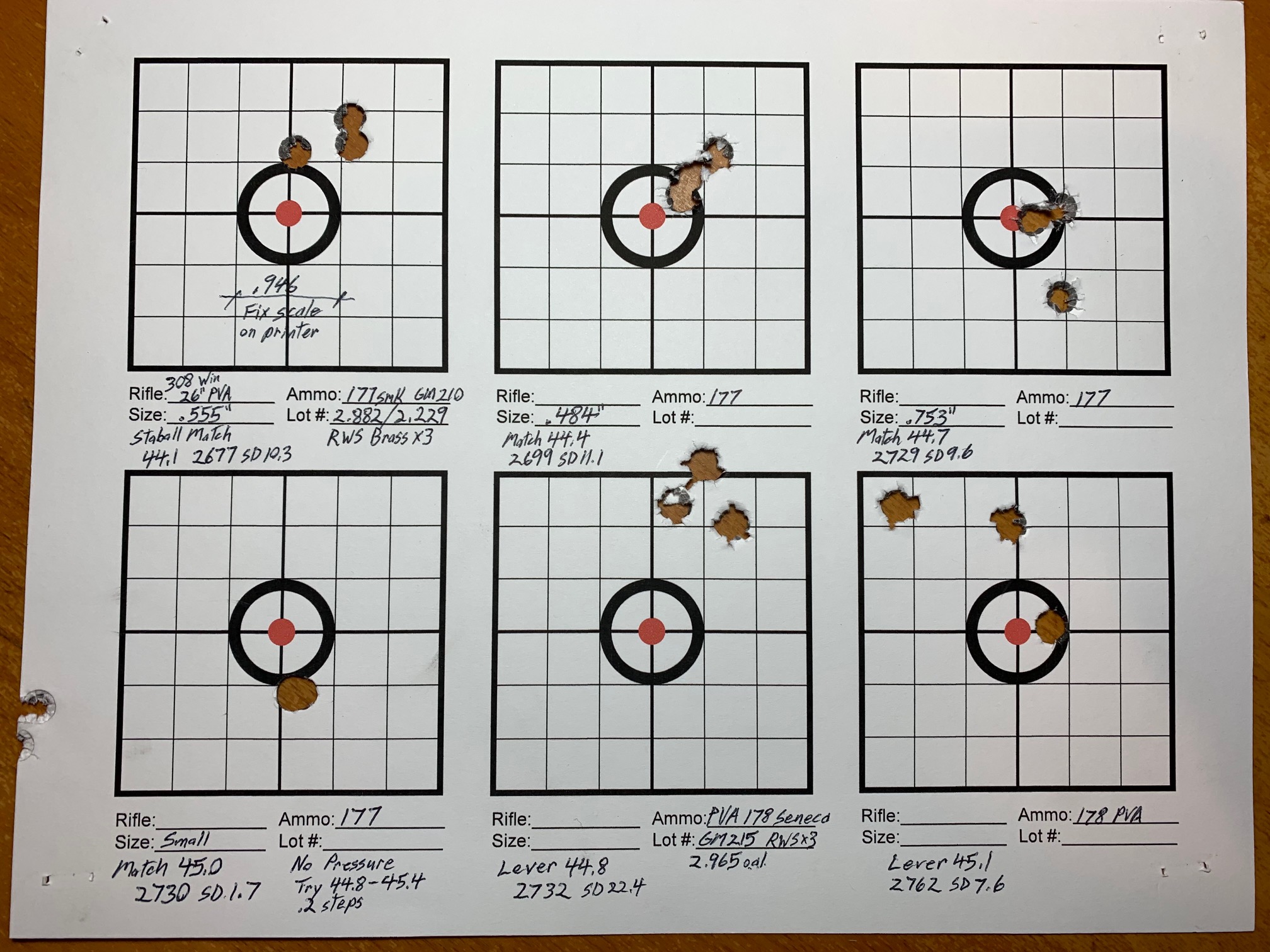

Shot a ladder today with the 177's & Staball match looking for a powder charge. Just 3 shots each for these.
26" PVA Osprey 10T
177smk oal 2.882 cbto 2.229 = .021 jump, GM210 primers, RWS Brass.
Staball Match
44.1 = 2677 SD 10.3 .555"
44.4 = 2699 SD 11.1 .484"
44.7 = 2729 SD 9.6 .753"
45.0 = 2730 SD 1.7 ** Small

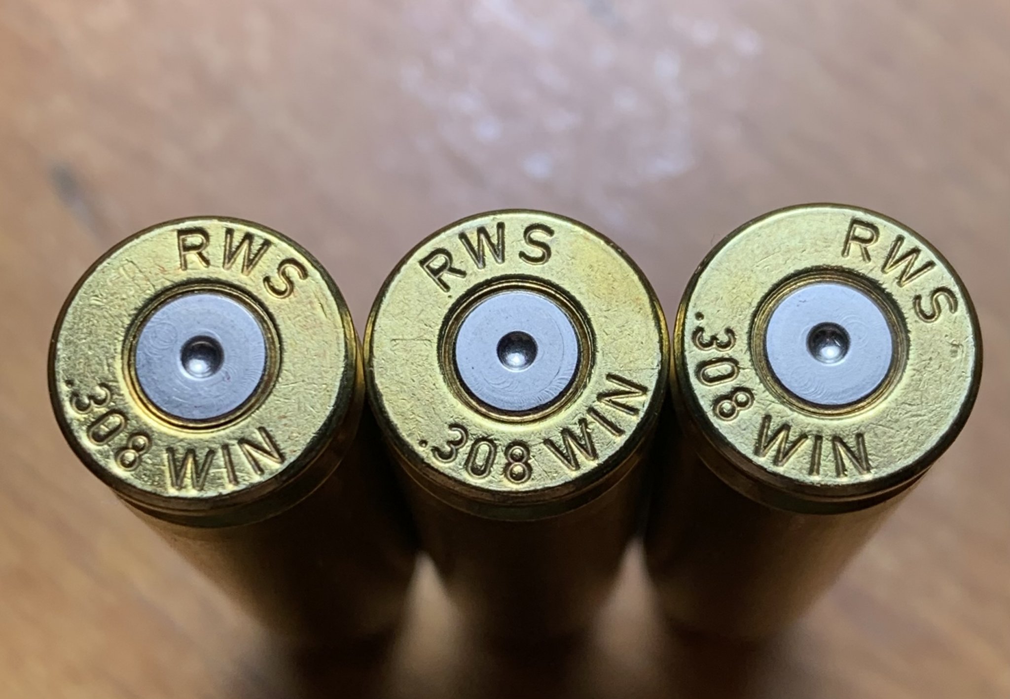

No hard bolt & cant really see any pressure signs. Primers might be a touch flat, but no cratering. I'd love to know where I'm at with pressure.
Brass is the 3 from the 45.0 load. I can see the tooling marks from the bolt face on the primer.
Going to try again with 5 rounds each 44.8 - 45.2 in .2 steps.
Picked .021 jump for the 177 because the 169's shot very well there.
My gas gun was similar with Staball Match & 168's in that it shot better at the upper end loads.

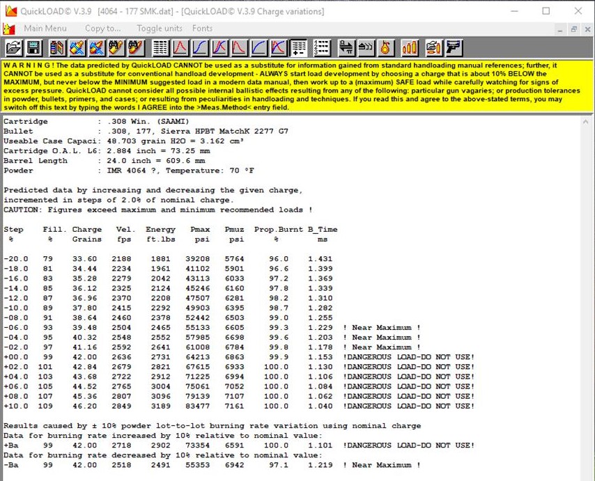

My QL doesn't have StaBall Match and I think I have the latest update which I acquired several months ago. Some data that I've accumulated shows that StaBall Match's burn rate is very close to the Winchester 748's, and the Winchester 748 is listed in QL. So I took the QL data for 748's along with that from Hodgdon's reloading data for StaBall Matach on 175 SEI HPBT and did a little interpolation and then used your velocities with the 177's to see your various loads tracked with the calculations (not knowing the case volume to use for RSW brass, I used SAAMI's 56.0 grs). Since I got pretty good tracking with your velocities, it appears the 45.0 grs of StaBall Match for the 177's is right at or maybe a hair above SAAMI max pressure . . . just to give you some idea. Since I don't want my estimated calculations to have a chance of going viral in any way, I'm not going to show my QL calc's. Hopefully, the next QL update will have this and more of the new powder's in its database.
Reactions: 357Max
My QL doesn't have StaBall Match and I think I have the latest update which I acquired several months ago. Some data that I've accumulated shows that StaBall Match's burn rate is very close to the Winchester 748's, and the Winchester 748 is listed in QL. So I took the QL data for 748's along with that from Hodgdon's reloading data for StaBall Matach on 175 SEI HPBT and did a little interpolation and then used your velocities with the 177's to see your various loads tracked with the calculations (not knowing the case volume to use for RSW brass, I used SAAMI's 56.0 grs). Since I got pretty good tracking with your velocities, it appears the 45.0 grs of StaBall Match for the 177's is right at or maybe a hair above SAAMI max . . . just to give you some idea. Since I don't want my estimated calculations to have a chance of going viral in any way, I'm not going to show my QL calc's. Hopefully, the next QL update will this and more of the new powder's in it's database.
I'll have to check my QL...I purchased the QL update a few months ago as well...but I think I got another QL update email recently I didn't purchase yet.ill have to check
Thanks for running those numbers for me. FWIW I did measure fired RWS on the FX 120 & h20 volume was 56.06 avg.
That's why I chose the GM210 primer for this test hoping it would show pressure if I hit any, quicker than a cci#34 of GM215 anyway.
Another interesting point of information is that I also shot a ladder with Staball Match & 168TMK's yesterday.
Same brass, primers, environmental's etc.
44.7 = 2747 SD 8.3 .712"
45.0 = 2765 SD 2.4 .207"
45.3 = 2788 SD 16.5 .902"
45.6 = 2797 SD 27.6 .850"
45.9 = 2842 This was a single shot & no pressure signs. Primer pocket still tight.
Just like the 177's 45.0 was low SD & best group.

The 177 gr with 44 gr IMR 4895 from an ultra light 16" 6 lb 3 oz AR 10 (without scope.) Ran 3 shot groups in the .2" and .3" followed by 5 shots around 3/4". 2584 ave fps 10.8 S/D from light weight fluted barrel 11.25 twist. I'd say give them a try, this was the first and only powder I tried, with the 177 SMK.
How did this turn out?
I haven’t revisited the Staball Match.
Settled on a load with RL 15.5 that’s working well.
177smk
45.4gr
2.885 oal/2.235 bto
Primed Norma brass
2758fps
PVA chambered Osprey 10T 26”
This was a zero check target from Franks class with the above load. That’s 6 shots & the one on the right was Nick’s 6.5 lol.
Also shot this load in the Major Land Match so about 300 rounds so far.
This Osprey is the easiest barrel I’ve ever had to clean.
At around 1000 down the tube, they shoot well. I’m working off my last box off 500 of these, I’d say 2600-2650fps they seem to perform well. I tried 2700ish fps and it was just more recoil for minimal gain. I’ll probably shoot up what I have left and want to try out those 169s if available. If not I plan to go back to the 168 eldm at 2750fps.
