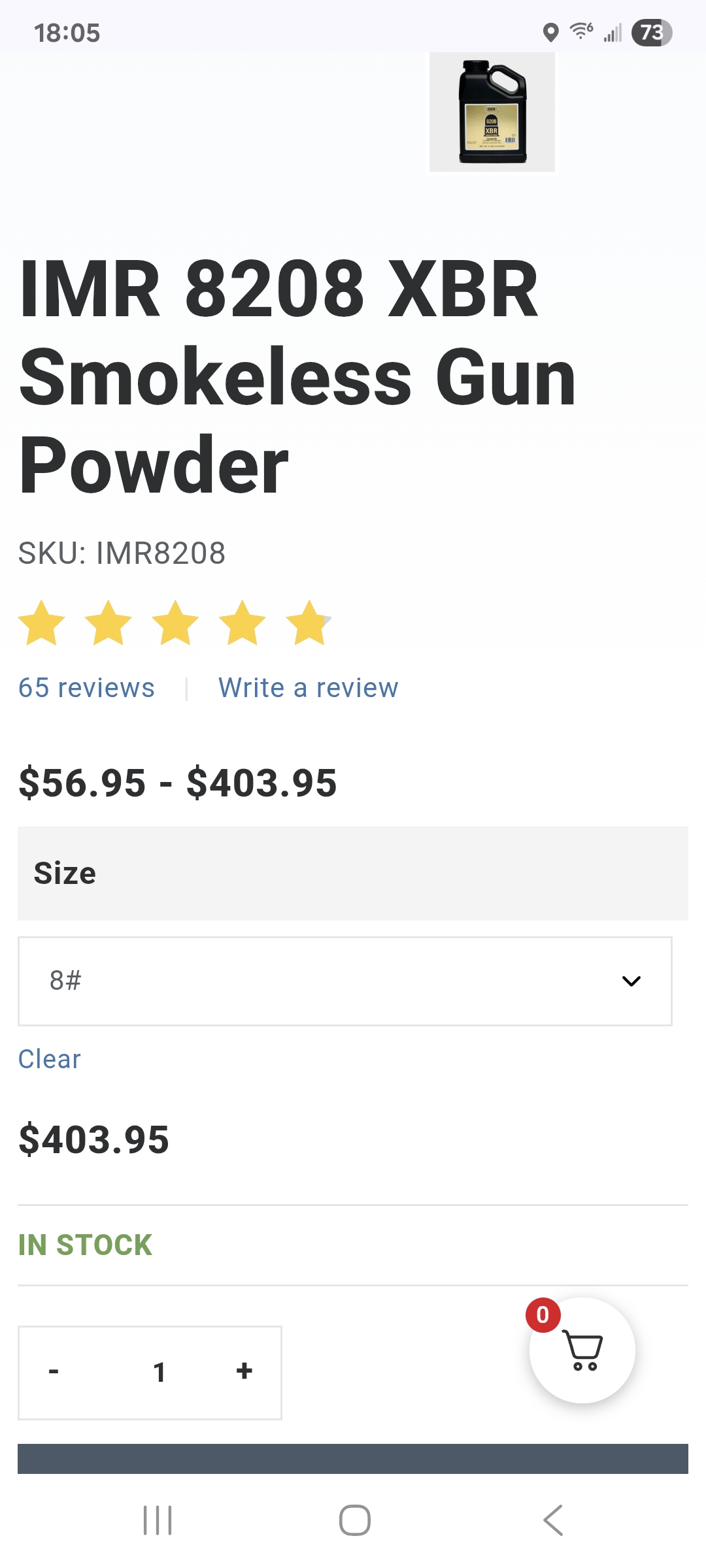

Xbr 8208 is awesome if you can find it as well. I’ve got some N140 I’ll be playing with.
Powder Valley has it
