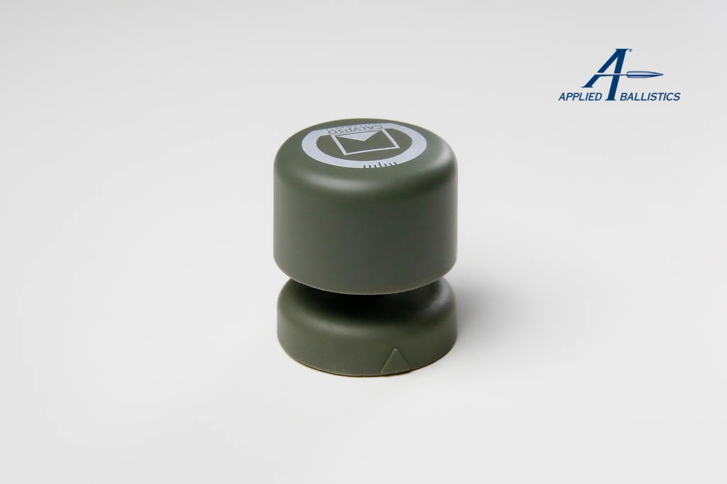

The Kilo 10K Gen 2s are going to work with the Calypso AB Mini. A rechargeable 7 day battery life ultrasonic wind meter the size of an old film canister.
So there is a new piece of calypso equipment interfaced with an AB software suite? Sounds great. I'm hoping this will also work with the AB in the new vector-x I have coming!
It's already available, take out your credit card. 😬
