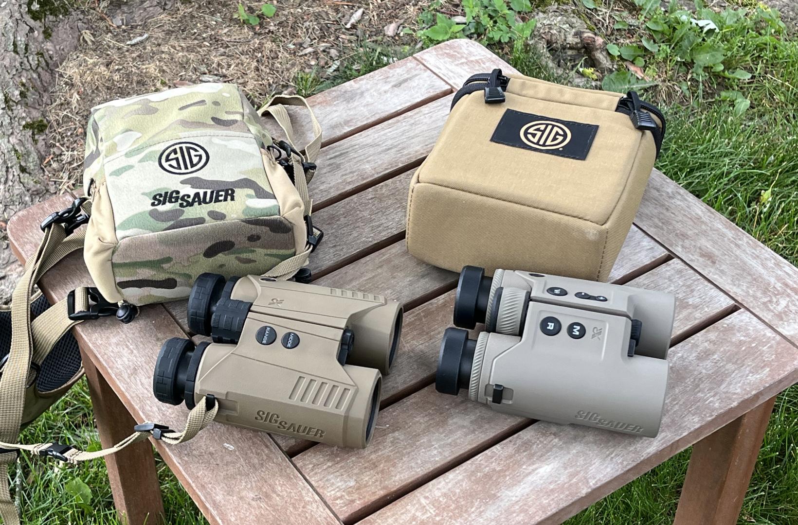

I have finished up and posted the Sig Kilo10k-ABS HD Gen II review. I was quite impressed with how much improvement in the user experience resulted from the removal of the blue tint present in the Gen I units. There were a number of other improvements and refinements as well including three more buttons for fast wind input and better menue navigation, improved ergonomics, a better internal compass, more remote map point options, and cloud profile storage. Sig has also improved the warranty to a transferable lifetime for electronics and optics. That is huge in my judgement.
Sig KILO10k-ABS HD Gen I (left) and Gen II (right) laser rangefinding binoculars
