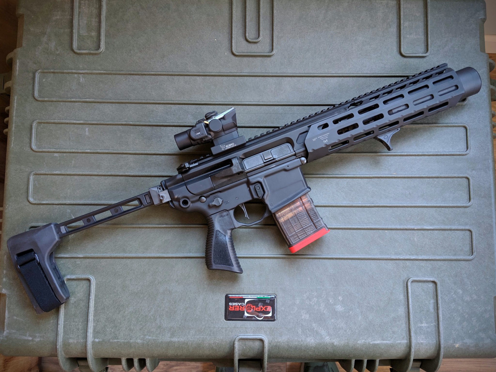

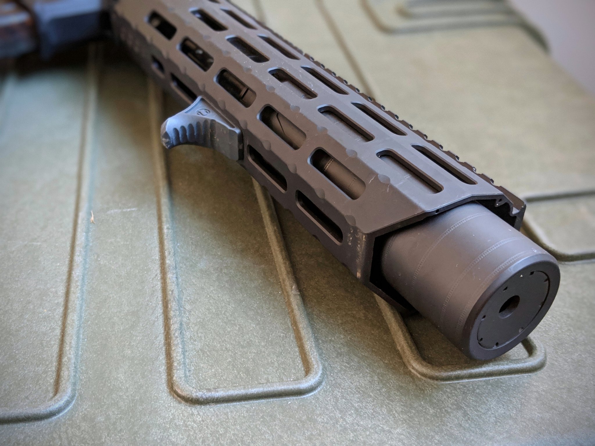

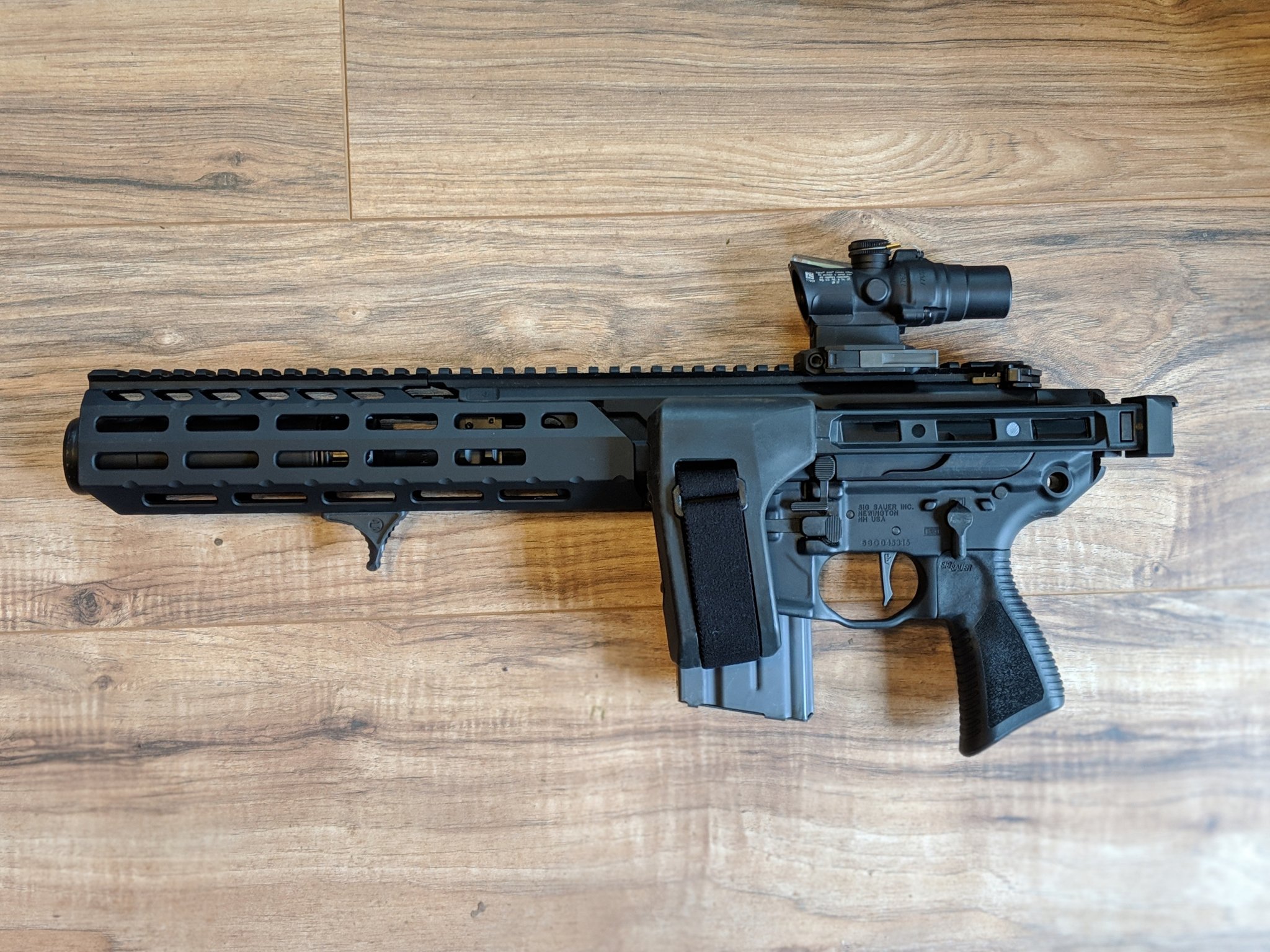

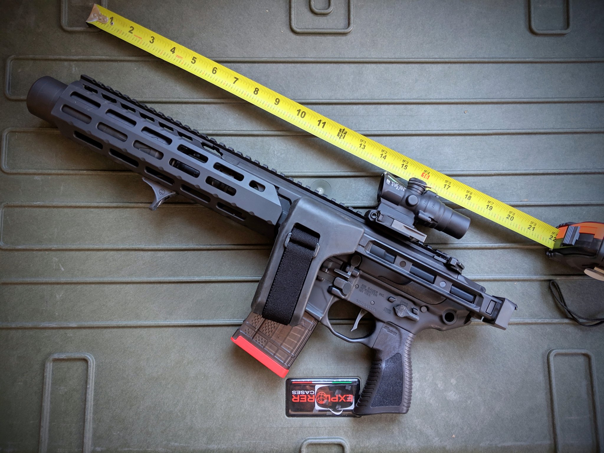

    My attempt was to do accuracy testing on the 5.5" barreled Rattler with 11 different loads. Turns out, that will mostly have to wait but I was able to get *some* preliminary data for perceived accuracy and some chrono numbers. The gun normally rides around swallowing up a Sandman K or Nomad Suppressor in the below forms:

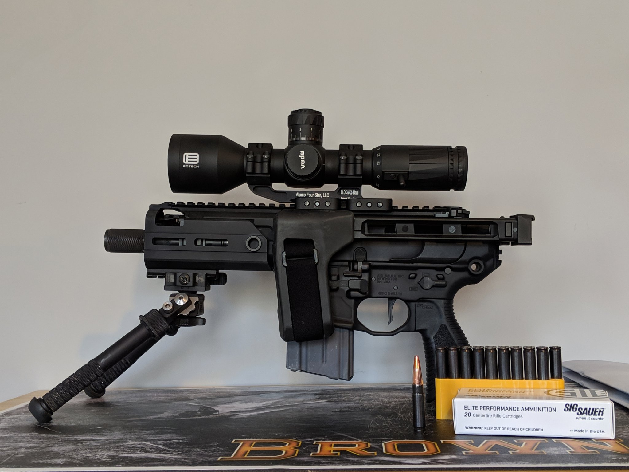

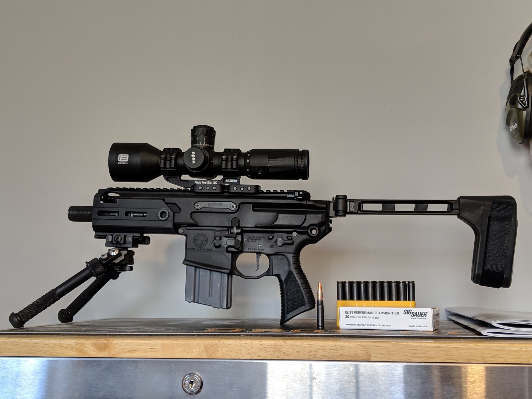

    Getting a good cheek weld on that stock while prone is nearly impossible, unless of course, you make one from t-shirts and duct tape. Only issue with that is that it is so large you can't run the charging handle and its still too big to even fold completely out of the way. I quickly realized I was going to have to shoot 5 rounds unsuppressed, remove the stock, shoot 5 rounds suppressed, remove the stock to clean the gun, and repeat....22 times. The gun is so short, and so light, that you really do need a good cheek weld to keep it from moving around, even at 50 yards. Regardless, here it was in the "Accuracy testing" configuration:
    The second issue I had, is I had no idea the point of impacts would be so far off of each other. Subs vs Supers are obvious, but you would think the super rounds would shoot "close enough" to the other supers, etc. Not. A. Chance. This gun is PICKY. I attempted to get a zero with the 123 Mag Tech ammo. I thought my scope was broken. We are talking 3-4+ MOA at 50 yards. I finally gave up and told myself to just try something else, I pulled out the Barnes 110 TAC-TX with the same zero and went inside of 1". I tried a couple other rounds and every single cartridge had a mind of its own as far as POI. I will say, and I will mention this later, there was a couple of surprises when it came to accuracy even though I did not officially test that today. I tested all of the below, plus MAGTech 123 Grain and the NEW SIG SBR ammo in the pictures above:

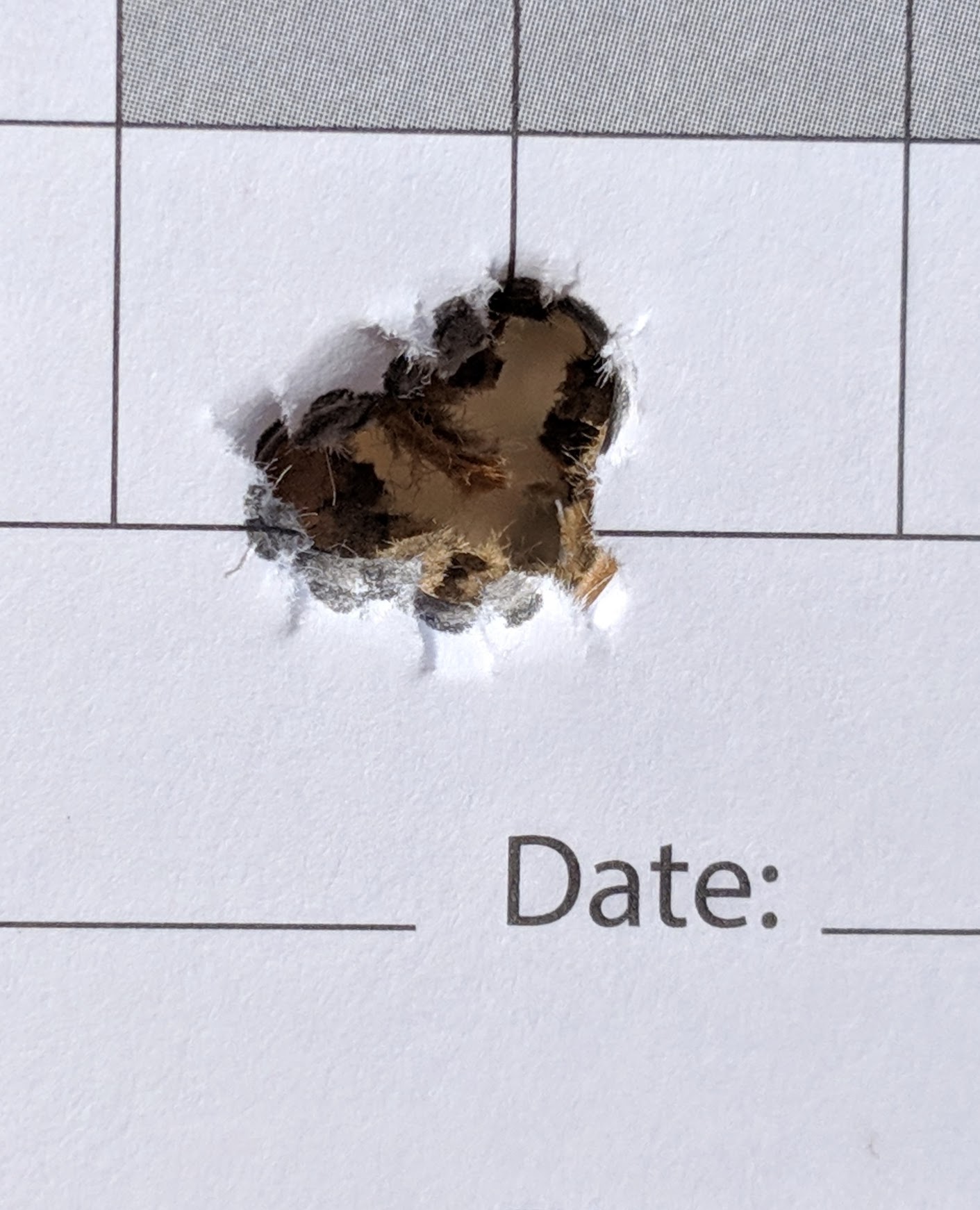

    3. And the surprise of the day, the Winchester Dear Season 150 grain (Lowest Supersonic velocity, best accuracy, 5 shots, one single hole...ridiculous)
    Here is the Winchester Deer Season 150g, 5 shot group on a Larue 0.5 target grid:
    Again, take the accuracy with a grain of salt until I can give each round its proper due in the next test, but I have feeling nothing is going to touch that Winchester Deer Season 150g, at least not in this Rattler.
