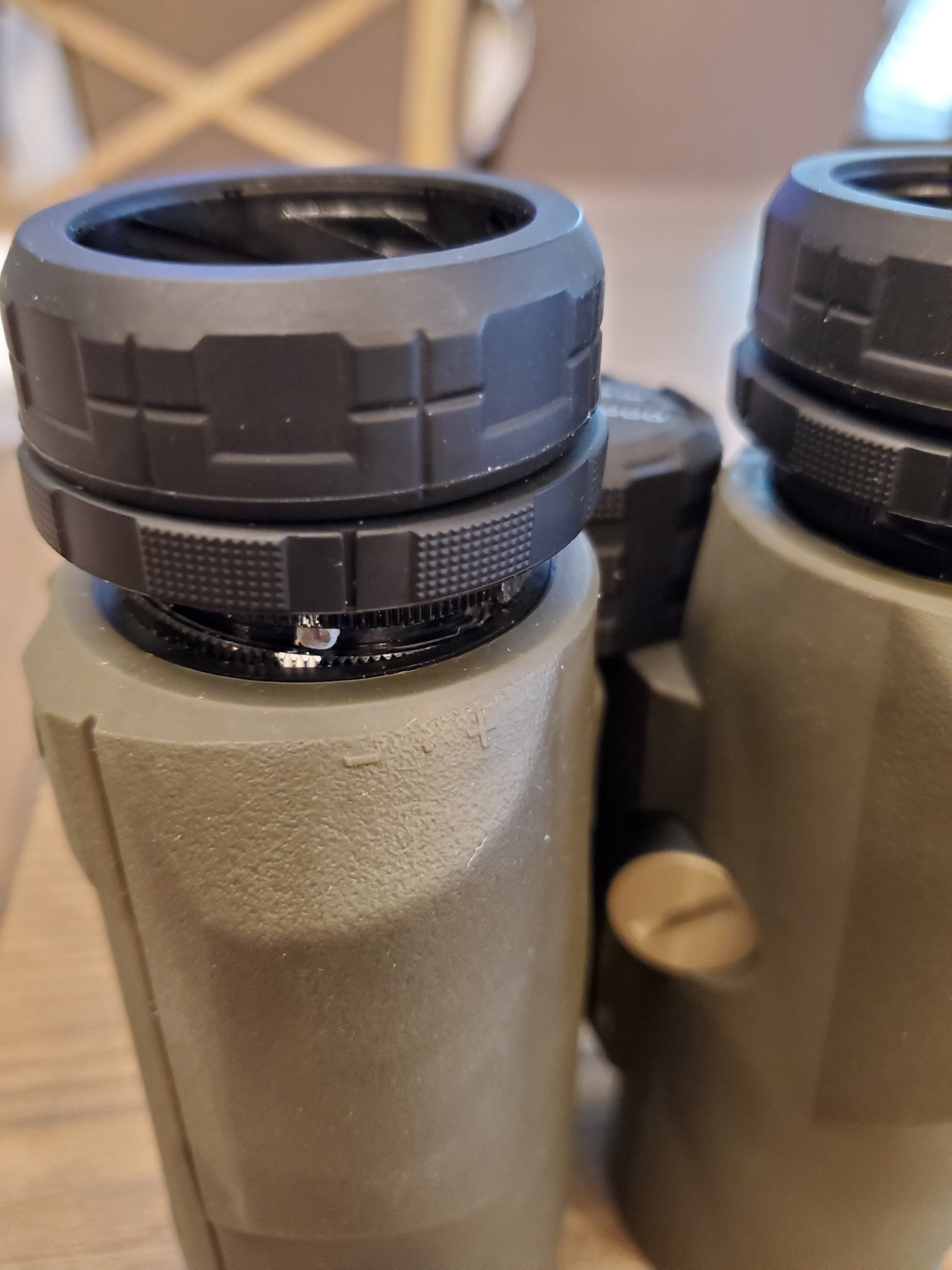

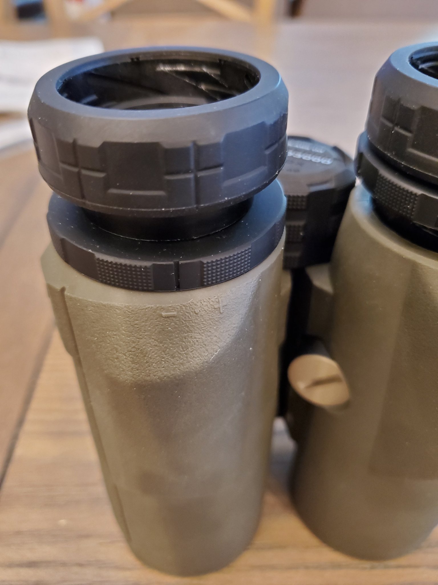

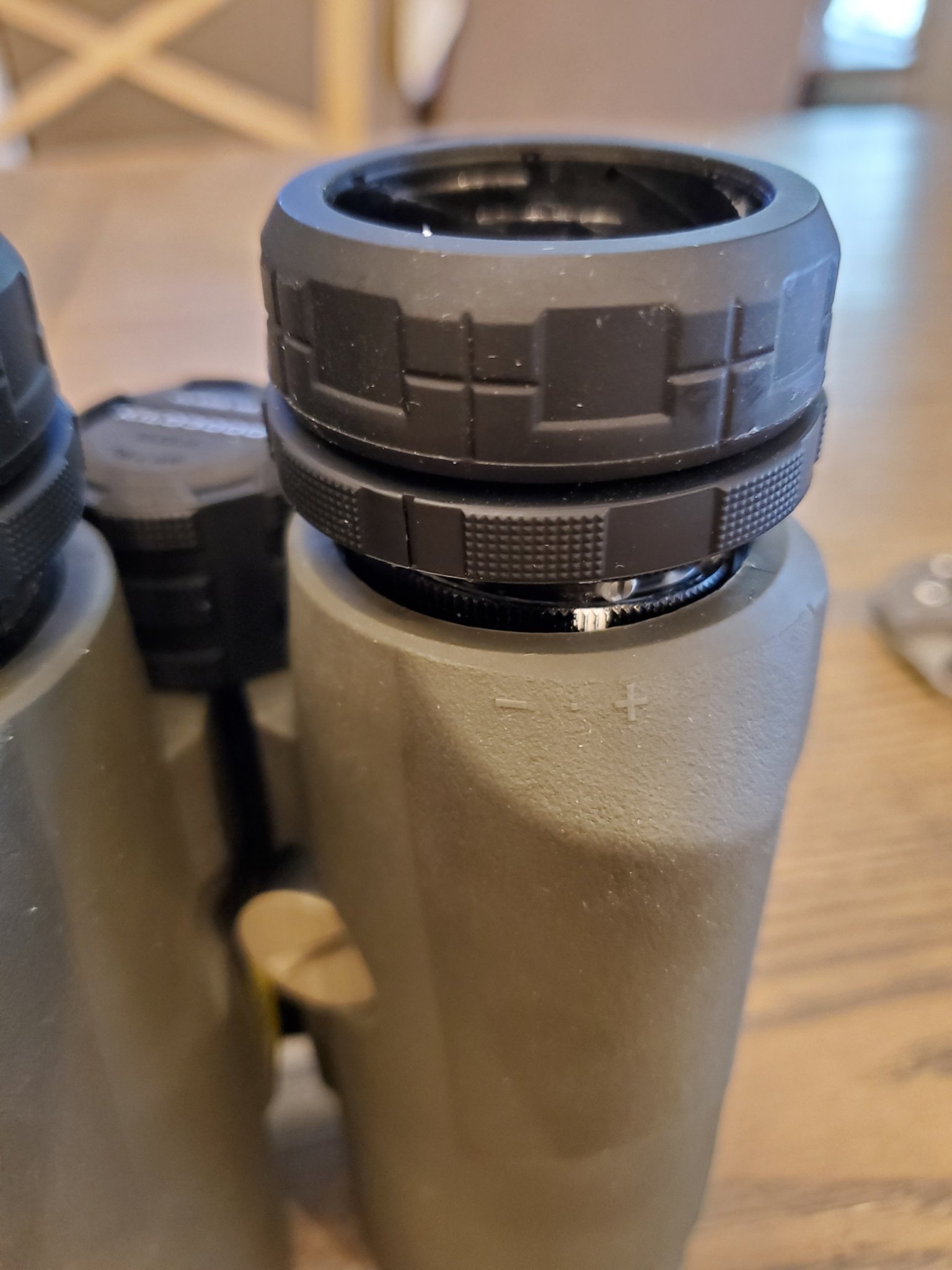

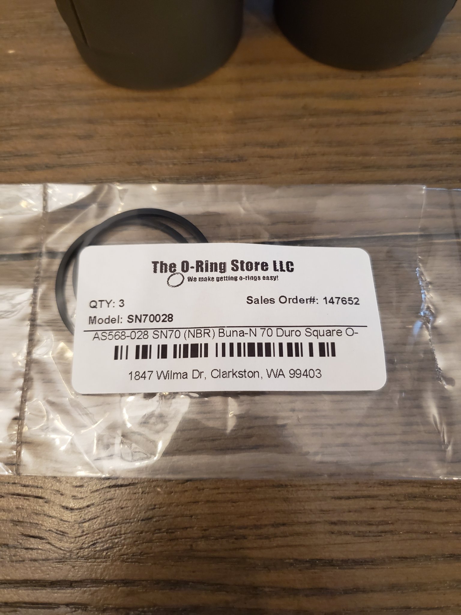

Ok. My orings came in. The idea doesn't work with round ones but are wonderful with square. Notice the oring stuffed in between the diopter ring and the rubber over mold of the housing. The rubber over mold of the diopter covers it up making it look factory. This oring creates a rubber on rubber bind with the rubber housing over mold. This oring tightens things up considerably but I'm going to order some more to see how much more tighter it can get. I think its plenty tight enough but it might not be for others.

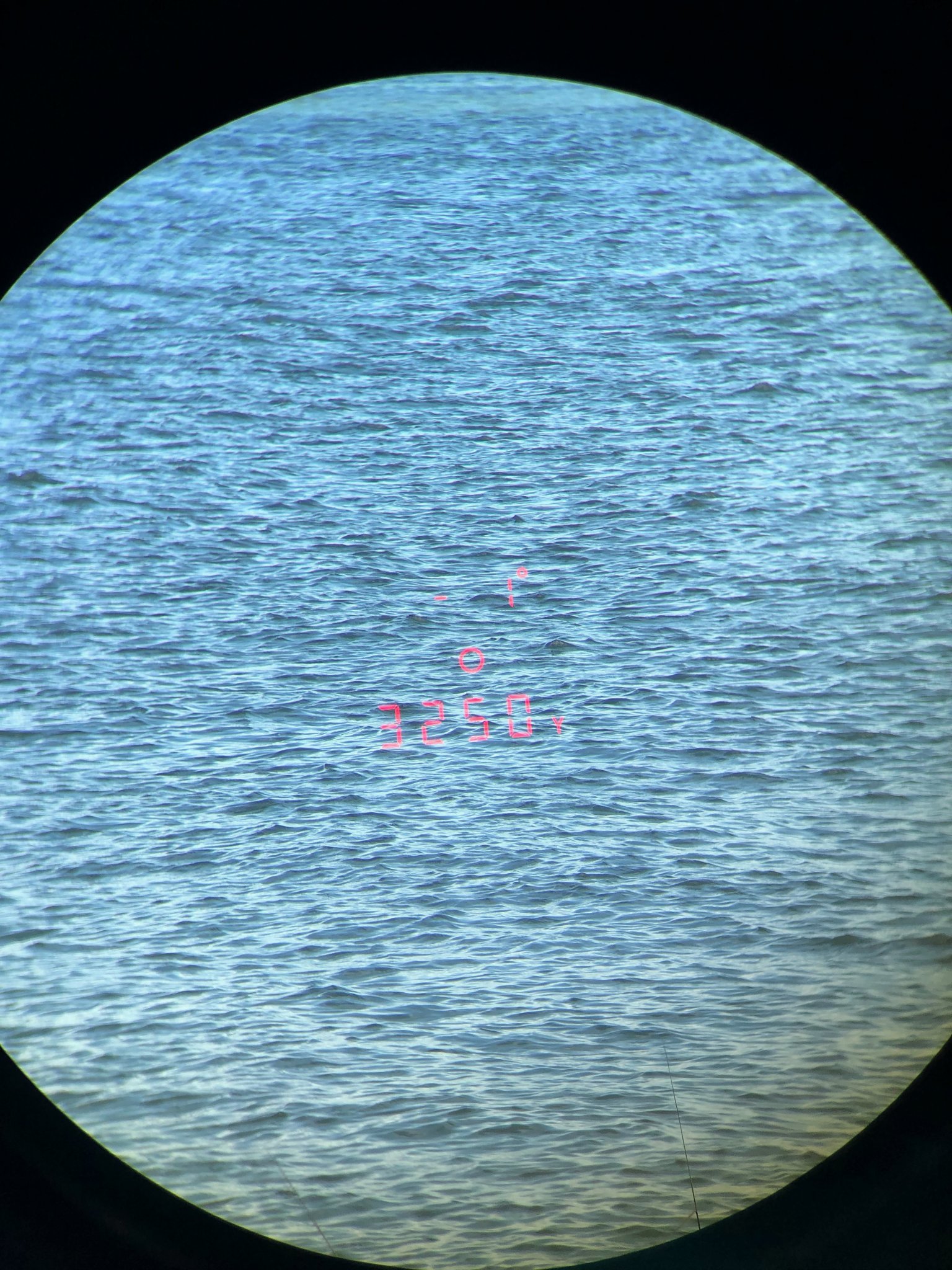

Used the rangefinders over the weekend, had great success with them. This morning, I hit a nautical buoy at 3250. Impressed as hell! This was done off hand. I'm gonna bring the tripod down and give it a go.

To follow up on tightening up the diopters. If you want them really snug (honestly appropriately snug) use the attached oring. It is a bitch to stuff it down in place... and you do need to trim down the thickness so the over mold seats all the way down. But it is perfectly snug as a bug. Factory looking to boot. Highly suggest it. No need to mark the position with a sharpie.
If you don't want to dick with thinning out the oring then use the other I suggested. It works just fine.

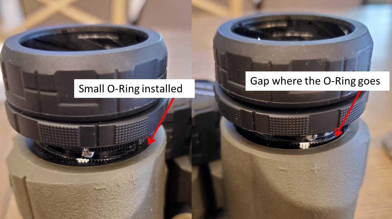

Sig has made this simple... they were cheap but it makes it simple. There is nothing to unscrew.
First extend the eye cups out.
Next pull on the rubber diopter ring toward the eye cups. This is just an over mold. You want it to end up between the eyecup and the diopter ring. It is glued on two sides and is mechanically retained by a lip that rides in a groove on the ocular tube. The glue isn't very strong, seems like a contact cement of some sort. The over mold is held in place mostly by the lip/groove. The diopter and rubber over mold are grooved vertically all the way around so they are mechanically locked for rotational forces.
Then you stretch the oring over the eycups and diopter rubber.
Last you stuff the oring between the body over mold and the metal diopter ring (you will see this gap). The trick is that it likes to roll into the grove that actuates the diopter. But there is enough real estate below to hold it flat and not roll it. I used my el cheapo dental pick set from Harbor Freight. You need a blunt object to press and drag around the ring and some kind of pick. I found the body over mold needed some persuasion in some locations.
If you use the thick oring you need to get the thickness down to about 1/16" (0.070"). It's thickness comes at about 0.100". This is the cross section too so this is why it is more effective at binding up the diopter. If you don't then the rubber over mold of the diopter will not drop down enough to engage in its locking ring, this is because it stands too proud above the body over mold. Oh and don't forget to note the indicator line on the rubber over mold in relation to the diopter ring below because inevitably the ring will move and you will forget. If you miss this step its no big deal , it has no impact on performance. I found that you can find remnants of the glue on the rubber ring and match it up with the glue on the metal diopter and get you really close. If you want to you can actually ignore the preset location and you can set it for your self. For instance you can set the focus where you want it then lift up on the rubber ring and set it back down aligning the indicator with the O on the body.
Finally if for some reason the eyecup over mold comes off it is retained by double stick tape only. Cheap solution by Sig... but I guess it works.
If you use the thick oring it will not move unless you want it. In fact if you have sweaty hands you may need to dry them to move them.
This modification is the perfect way to solve this problem. If you need to send it in for warranty then pull the oring and its back to factory. Plus it shows no outward signs of being modified. Sig could help us out by modifying their over mold and accomplishing the same thing as this oring. Actually the modification to the mold to produce it would be quite simple. Are you listening Sig??

I’ve ordered both sets of o rings you suggested, I’ll probably run the smaller of the two. Again... great fix, to bad it had to be done ?

I used a dremel with the medium sandpaper drum at a low setting to thin out the thick oring. Just kept rolling and grinding until it was thin enough and even all the way around. I used my leg as the surface to give it some give. I was wearing jeans of course. Just take your time and you won't grind too deep.

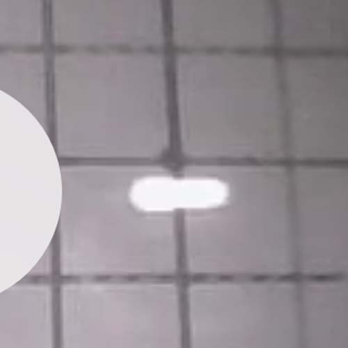

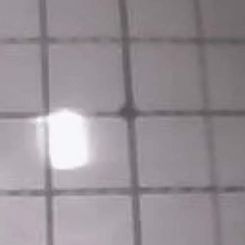

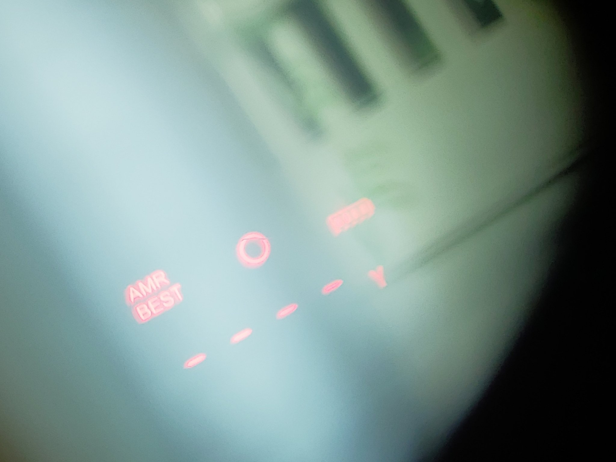

Been playing with my new BDX 3000 for a while and put up a review in its own thread. One of the things I looked at was the beam relationship to the reticle. Beams are rarely perfectly centered so I always check. On my first unit the beam appeared to be outside of the reticle around 9 o'clock. To confirm I set up a cheapie IR camera and lased a reference grid. For reference the reticle was a one inch circle on the grid at the distance tested.
Here is what I found (Grids lines are 1 inch and laser was 14.125 yards away):
7086167
I tried a second unit and the beam was above the 6 o'clock point of the reticle. But what surprised me was the difference in size and orientation of the beam:
7086184
Interesting so I thought I would share.

Did the above diopter fix using the smaller dia. O-rings, very simple to do and tightened them up significantly... A bonus being after I got everything adjusted I rotated the over moldings and lined em up for the center dot. Now it’s also a bit easier to see if I have shifted em a bit.... this was a great fix !

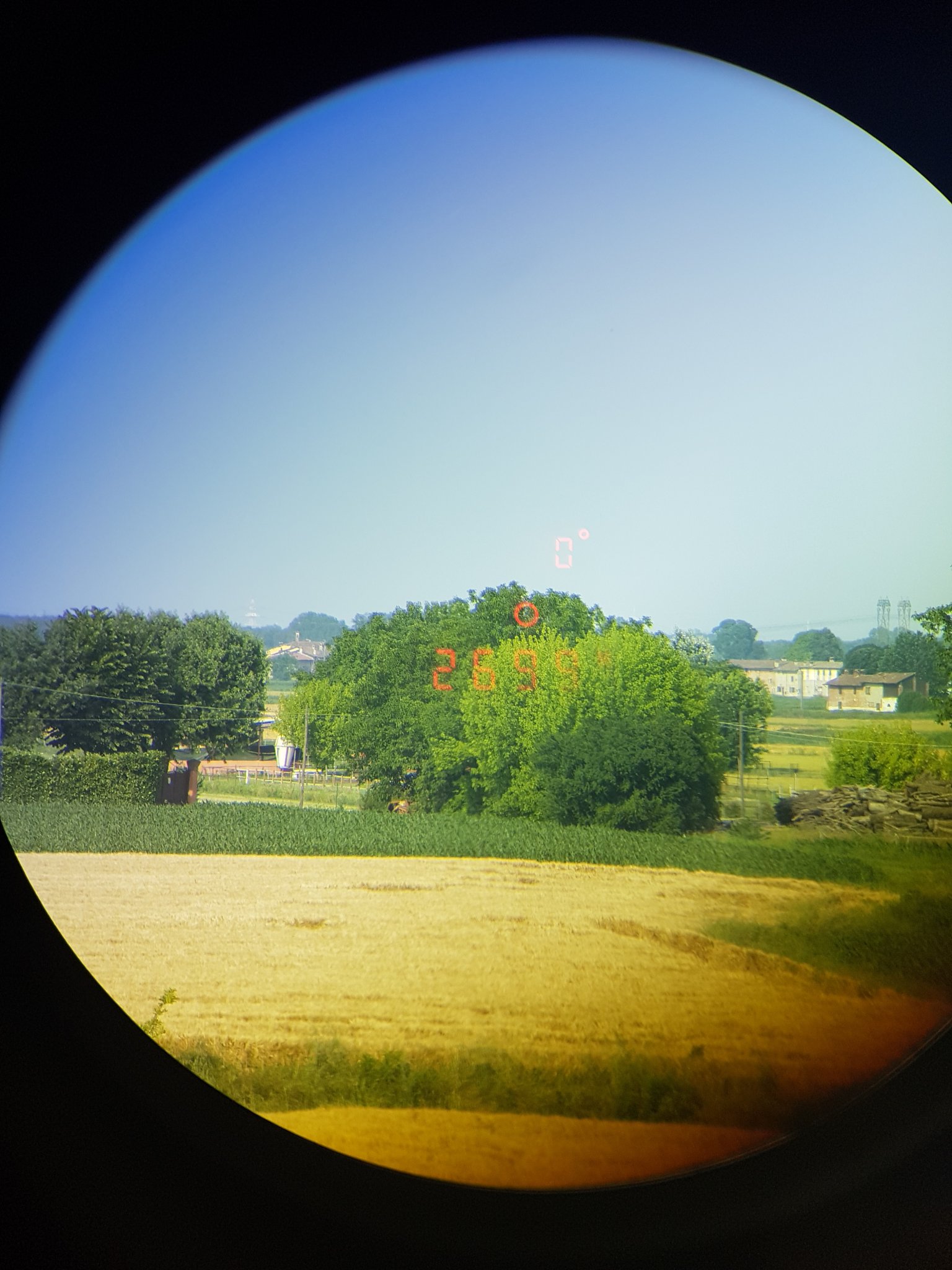

This range finder continues to impress me.
I have used it for several classes as a spotter on movers and wide swing dynamic exercises. Found the glass to be very usable over extended viewing. Not Leica or Swaro imagery but workable when staying on it for a few hours a day.
The LRF feature is what I am totally impressed with.
I have repeatedly gotten quick reads at distance through dirty air. On more than one occasion I have put it side by side with my PLRF10 (which is a good one) and have actually been able to tag some targets that the PLRF10 had troubles with.
Using it out over the flight line behind the shop, the terrain is flat and a shit ton of mirage when the sun is up. Typical Louisiana humidity and the mirage makes for trashy atmosphere to range through. Both units were ranging a mobile welding unit at 3,455 and 2,900 yds when the sun is down with ease but when things get dirty, the Sig was getting me reads when the PLRF wasn't.
I really could care less about ranging something at 2 or 3 thousand yards. I want to be able to tag a smallish target in a mix of terrain or structures inside 1K and have confidence I'm not reading on the hill behind it, the car in front of it or the tree close to it but not the same distance. So far, so good.
