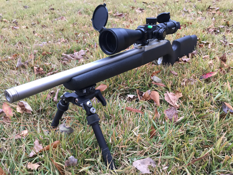

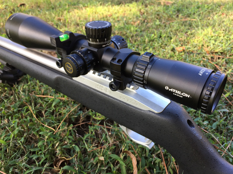

Lawless, I shoot a Kidd Supergrade with the factory Magpul stock that I would like to upgrade. What stock is that on your rifle?
Sorry bro, I just saw this. It is a Boyds Pro Varmit that has a steel bedding block installed and a steel rear shelf insert installed too. It is very solid and the action has zero droop. If I was buying a stock today however it would be a Victor Titan with their rear tang.
I changed rings to a lower set and now the comb height is absolutely perfect for me...but I wear a 7-3/4 hat so I have a big ”mater” <-hillbilly speak for head

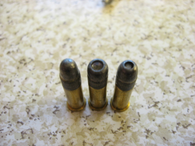

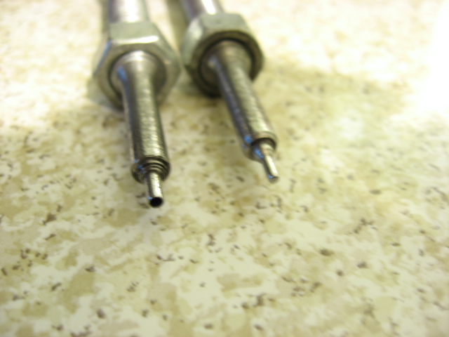

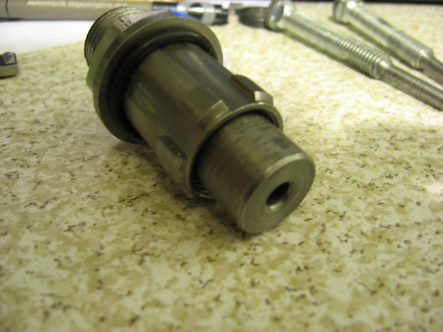

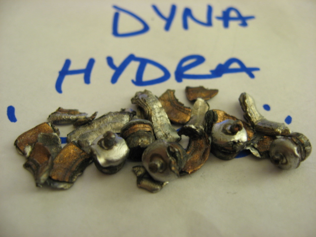

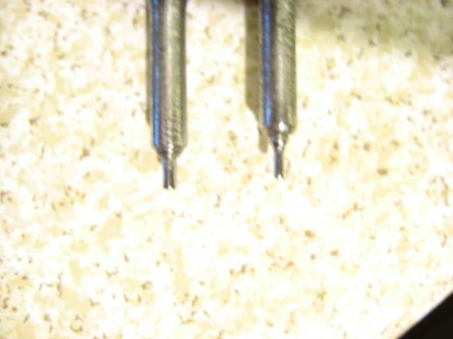

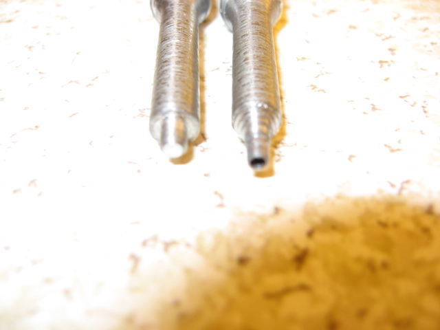

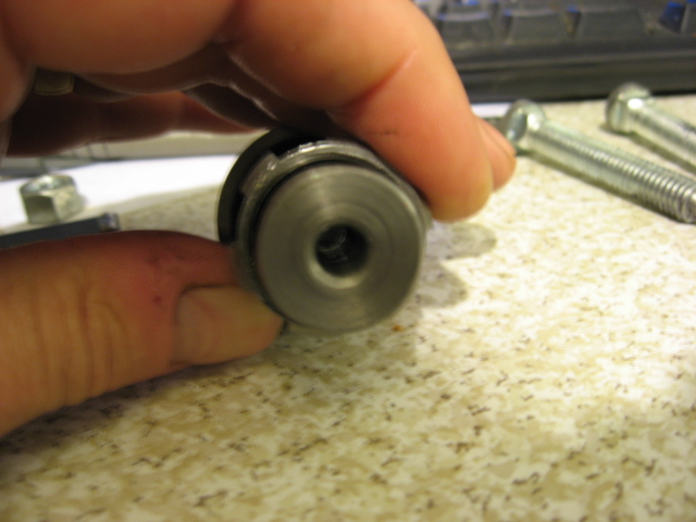

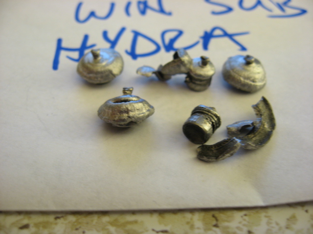

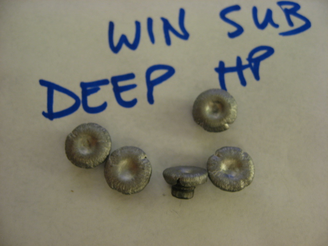

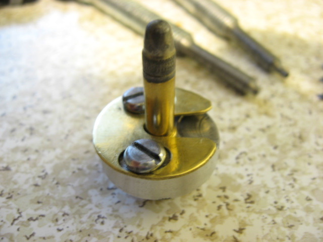

I made a set of dies once that would resize loaded ammunition to a more uniform size. It would push on the nose of the bullet and it would squish out to fill the die. It seemed to help with the accuracy but the biggest reason was it allowed me to make different hollow point profiles. I made different sizing pins to add different nose profiles and different hollow point profiles. I even made a hydra shock type pin that worked identical to a real hydra shock round.
I would get some that would expand out past .35" when fired into water.
Sorry for the quality, this was about 15 years ago when digital images were pretty crappy but you get the idea.
View attachment 7197290View attachment 7197291View attachment 7197292View attachment 7197293View attachment 7197289View attachment 7197294View attachment 7197288View attachment 7197296View attachment 7197295View attachment 7197297
I took some Stingers and opened up the hollow point with a drill bit twisted in my fingers many years ago. The effect on squirrels was John Woo film dramatic.
