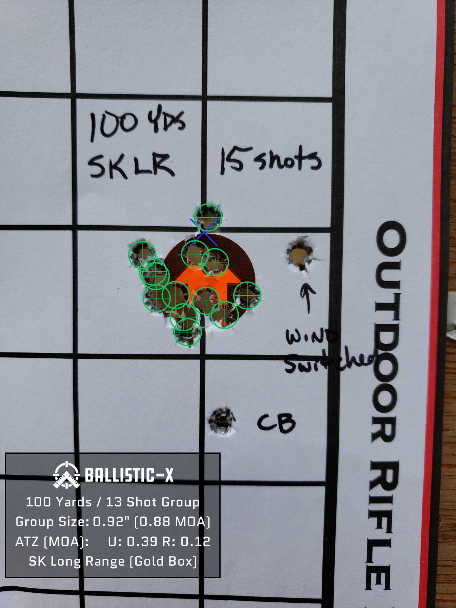

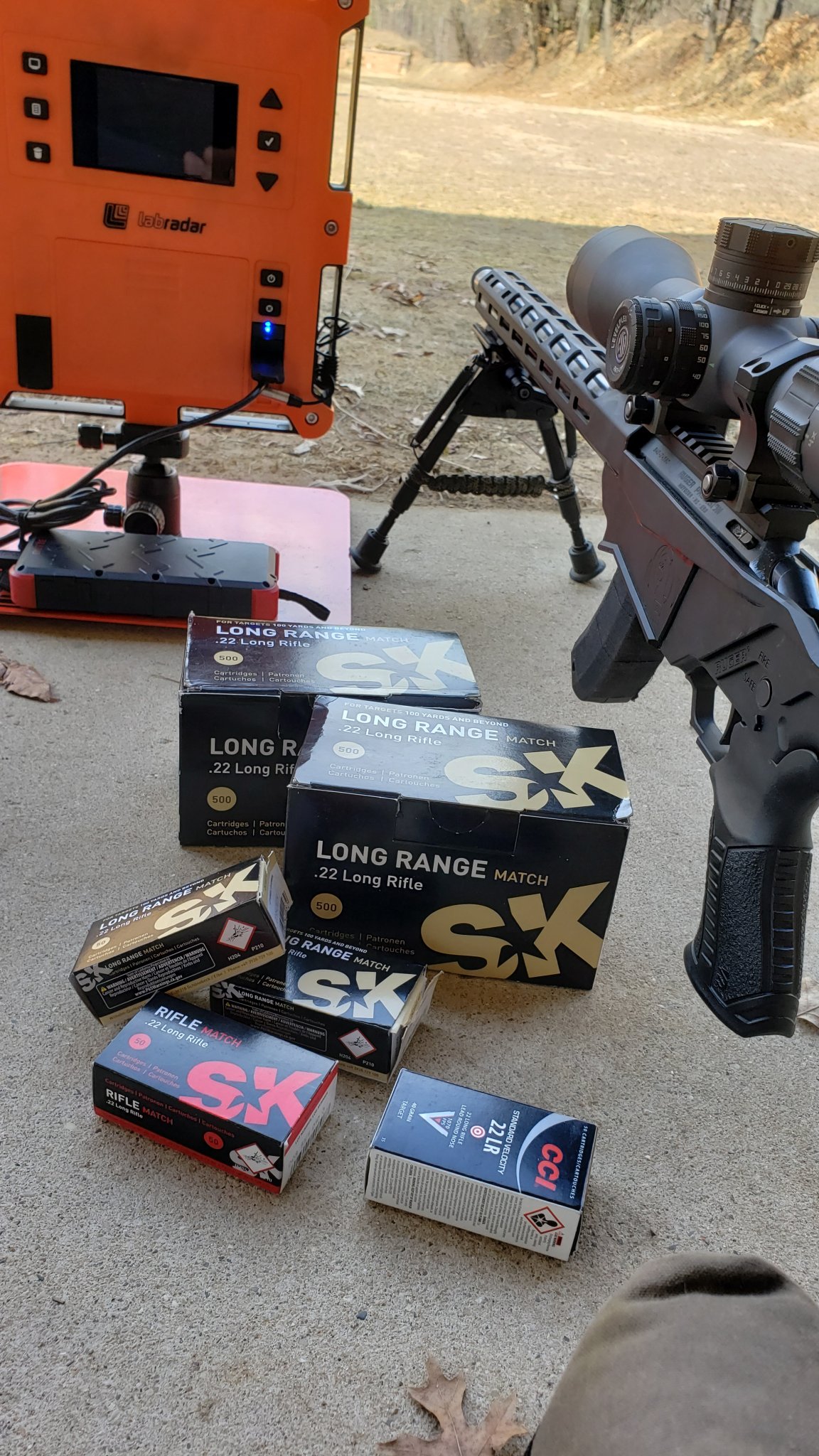

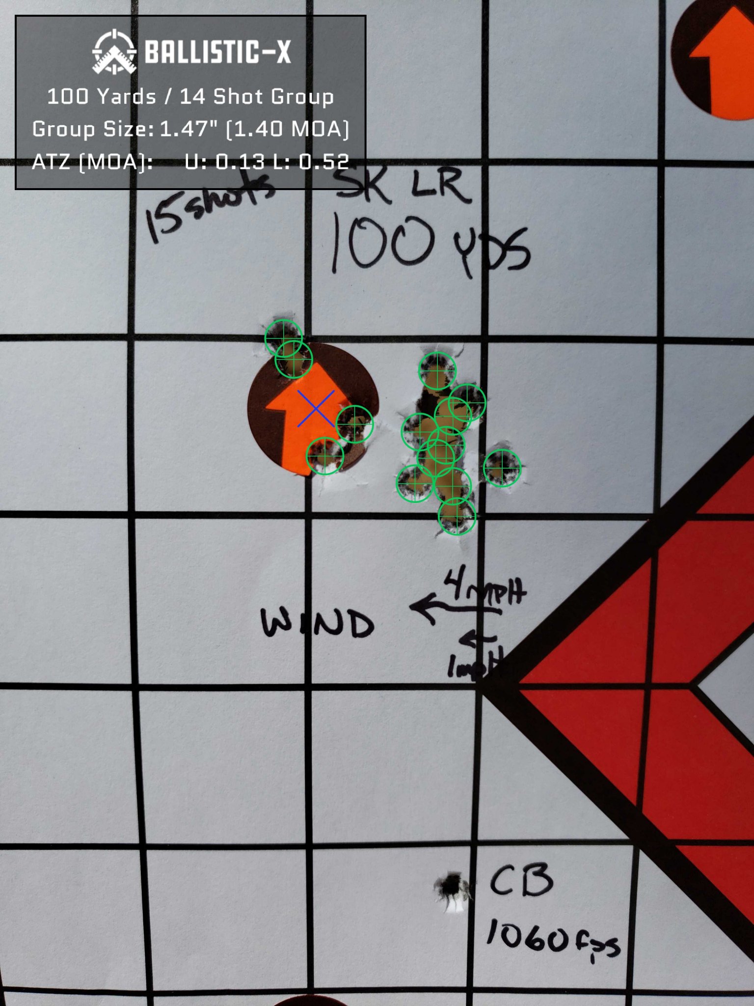

Just add some quick data:
Ruger Precision Rimfire
18" Shaw barrel
Labradar
15 shot groups 100yds. Not too bad for a cheap rifle and switchy winds! It outperformed SK Red Rifle Match, and CCI SV both of which have been around 1.5" at 100 for 15 shots.
I should add that excluded the CB shots and 1 known bad wind switch shot. The rest stayed in.
If anyone knows how to fix cold bore dropping 1-2 MOA low on first shot after barrel sits idle, I'd love to know what to do to fix it. It's not me; multiple shooters and Chrono show it's 40-60fps slow on first round from magazine unless fired IMMEDIATELY after a mag change. Seems that barrel was cools and slows bullet.
View attachment 7051832View attachment 7051833View attachment 7051834
I've also had a lot of cold bore shots drop low. Glad to hear I'm not the only one. I did cringe when I saw you are using the 15rnd mag. I'd repeat the same test for accuracy using a PITA sled. I'll see if I can grab a box of this soon. Thanks for testing!!

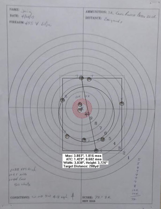

here's 10 at 200 with SKLRM
3.8 inches at 200, 1.3 inches at 100, 0.45 inches at 50 yards for 10 shots.
The other 4 targets reeked. :(

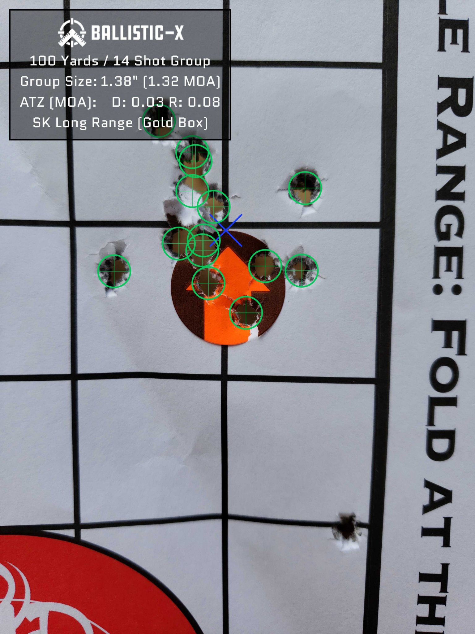

18" Shaw barrel
Labradar

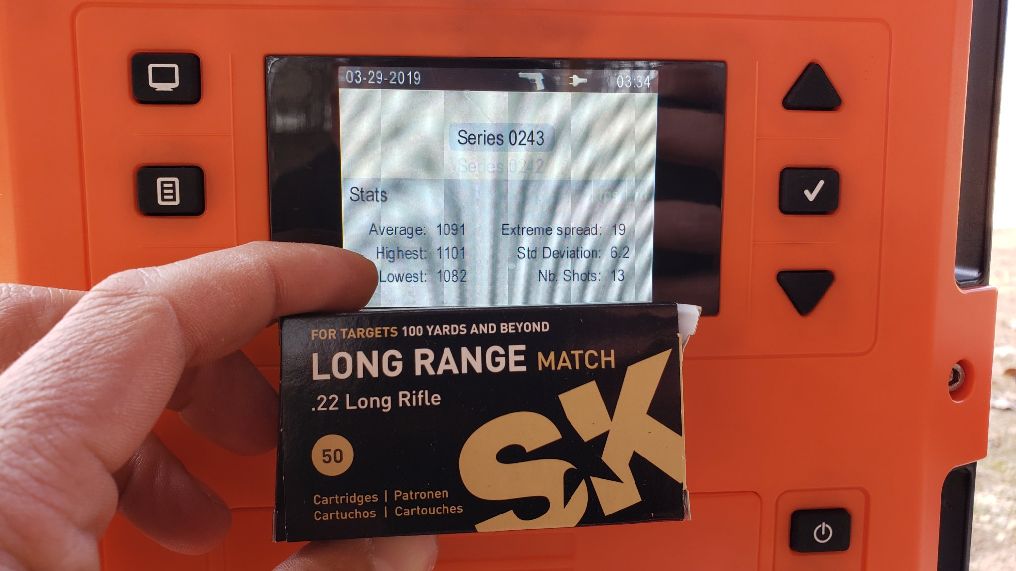

Here’s some of the numbers I got from the SK long range trough the Labradar
Rifle CZ 455 16’ barrel 20 shot string FPS 1120 ES 20 SD 6.5 Shot well at 50 10 shot group under .5 of an inch

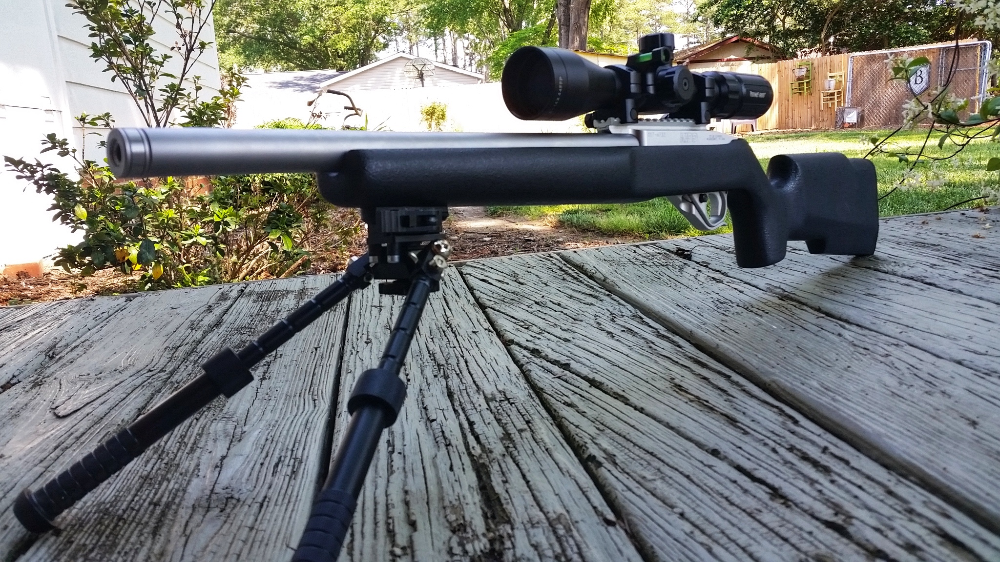

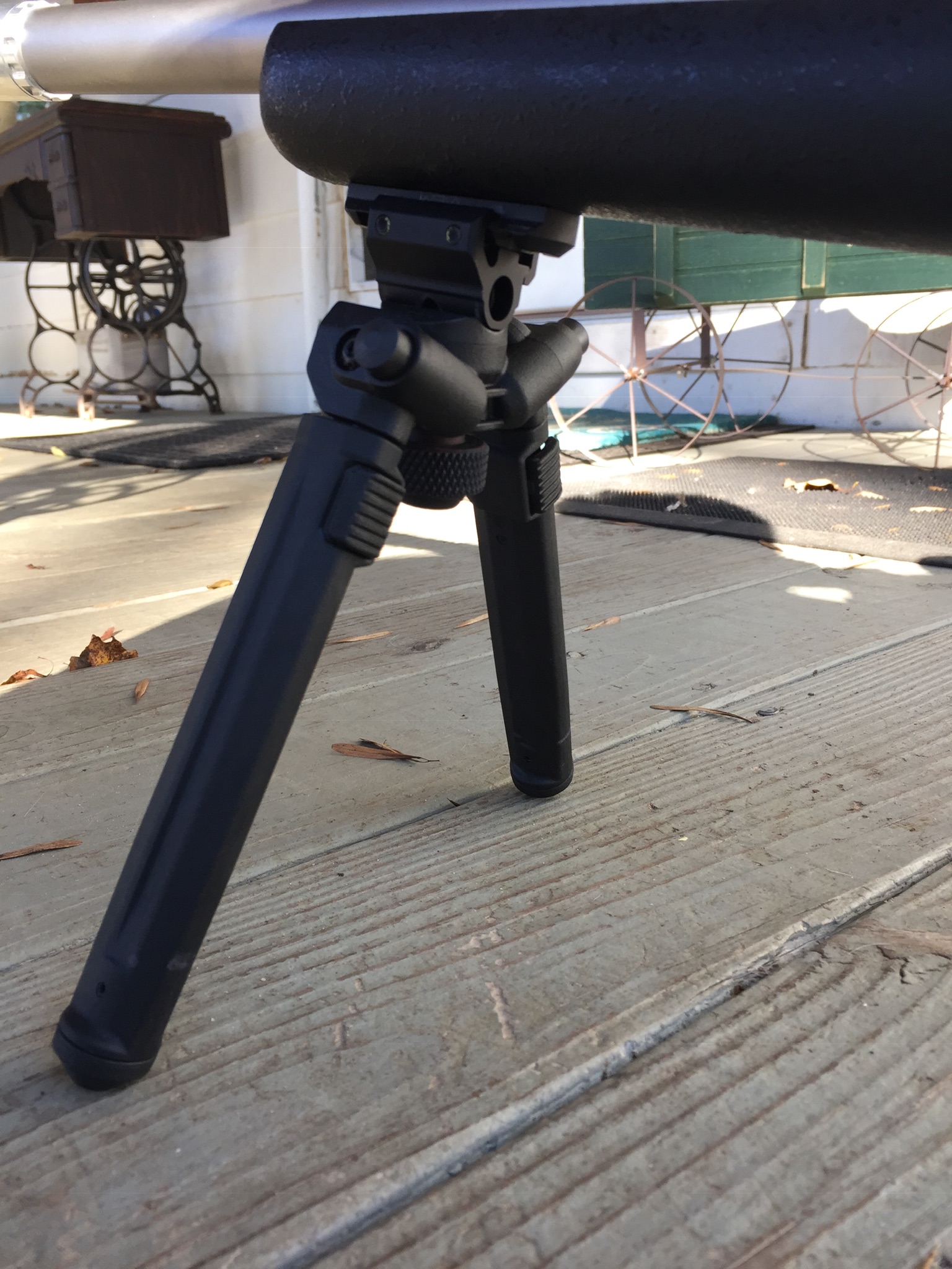

Forgive the bipod, it has a Magpul on it now.
400 for 22 is incredibly fun and the wind will wreak havoc like shooting 308 at 1K.View attachment 7003043
