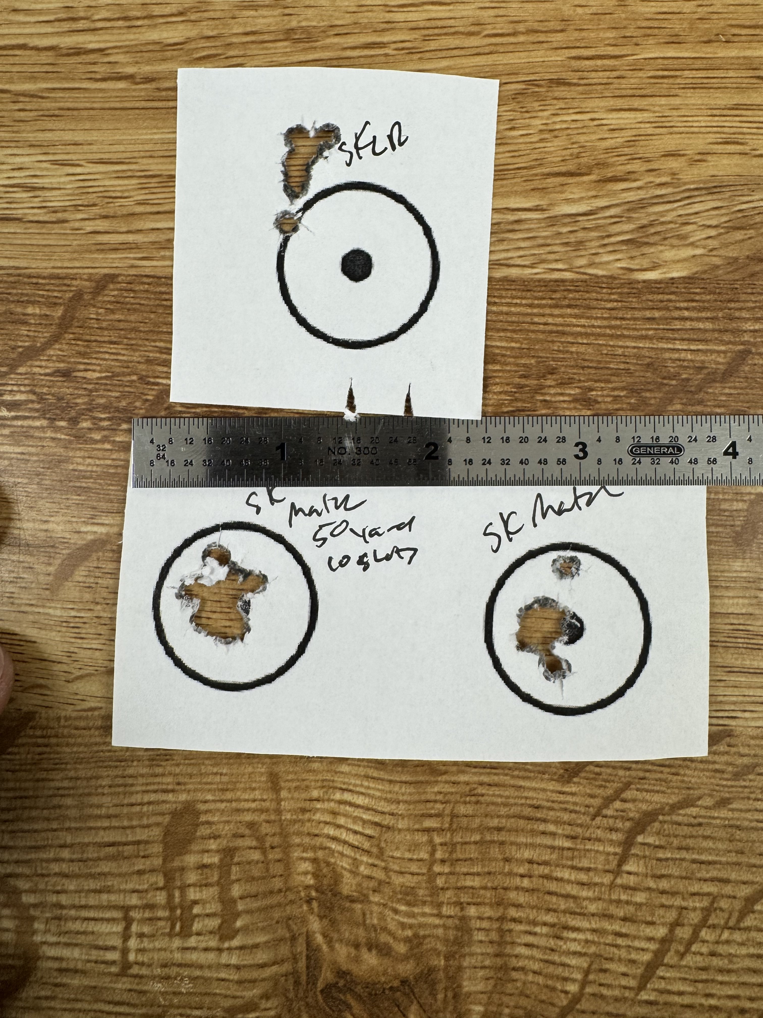

In my experience SK shoots good 4 out of 5 shots. I always get a flier no matter what type of SK it is.
These 10 shot groups would concur.
