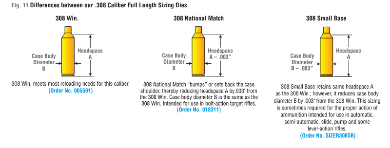

Attached is the figure from forster dies. So your under the impression that .003 is the end of the world?View attachment 7755319
Find some statically significant data that shows runout is linked to accuracy. And excessive runout define that as well.
