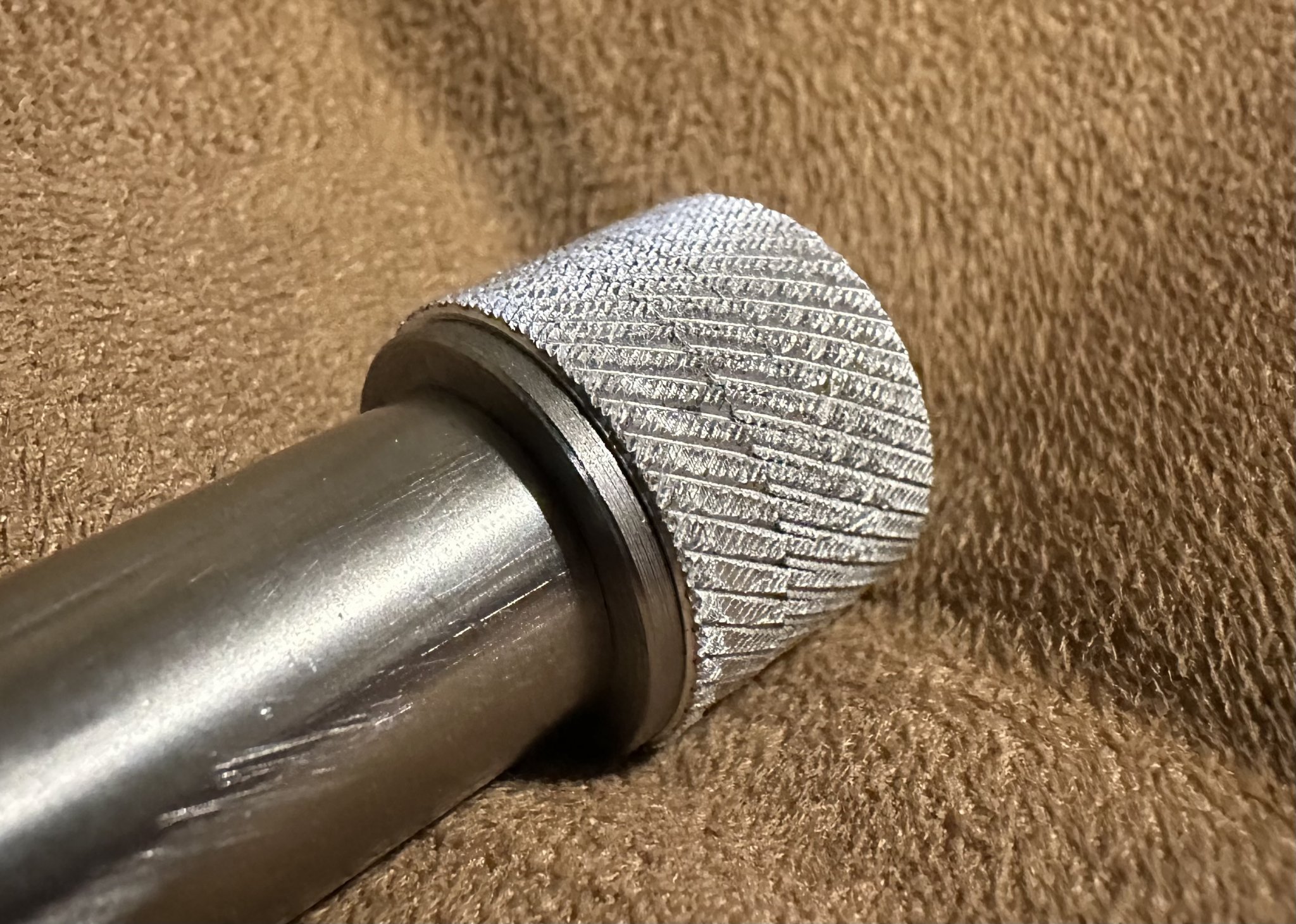

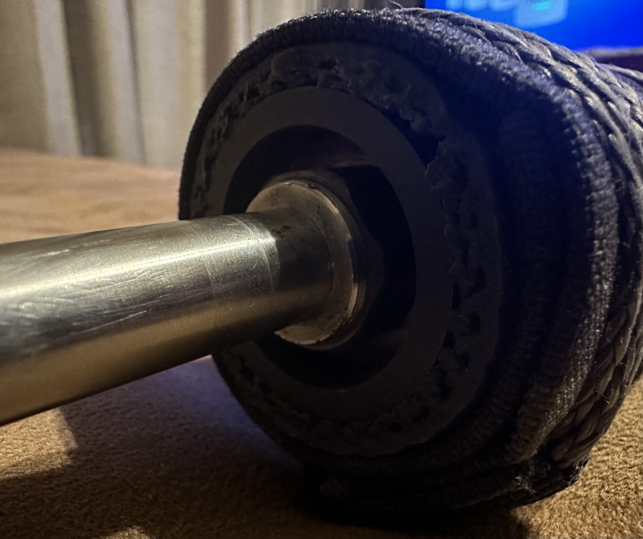

The KBA Custom shoulder for my Tavor got me thinking to use the Accu Washers as a shoulder. They are machined flat and sturdy enough to handle the torque from a muzzle device. However I opted to run Q's Cherry Bomb in 9mm for my 300 Win Mag threaded for 1/2-28. The Cherry Bomb for 9mm doesn't have the interior taper, so the shoulder of the muzzle device is super thick and worked perfectly with my barrel. I mainly got it as a mounting device for a suppressor.

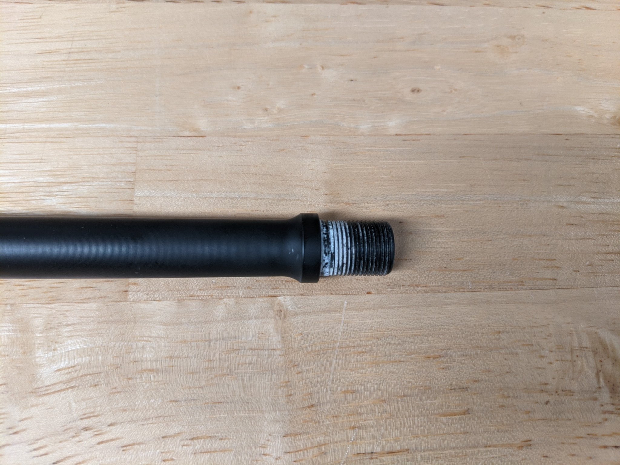

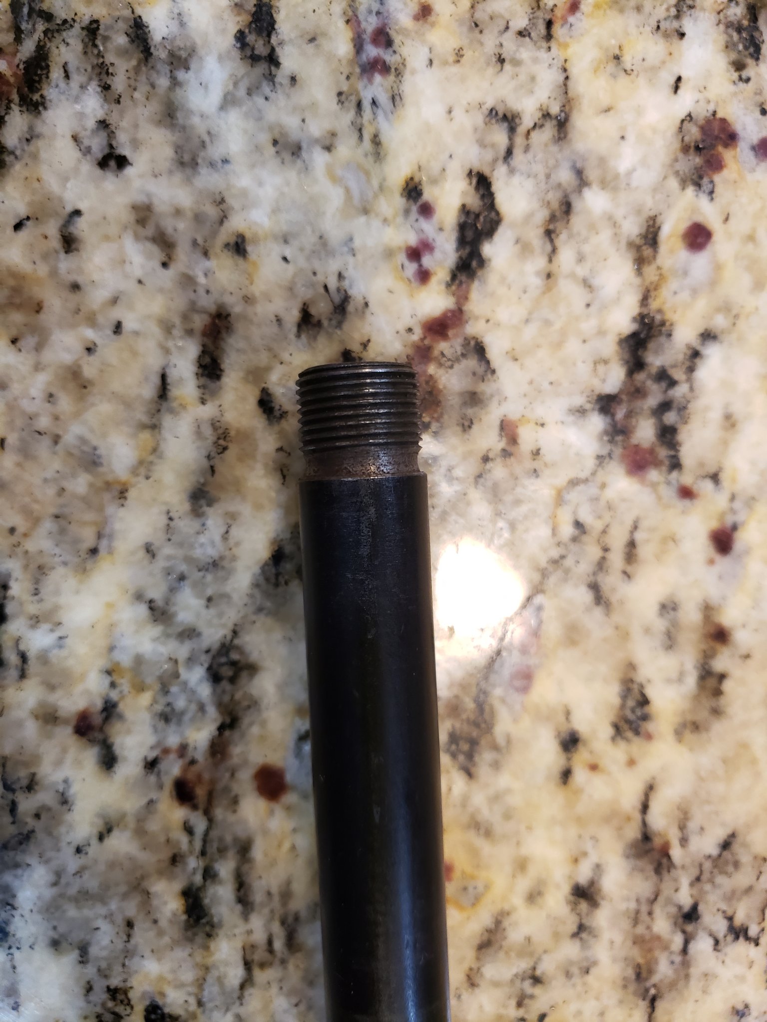

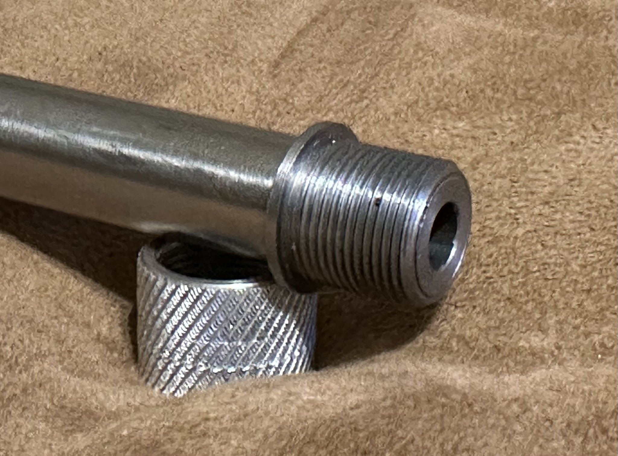

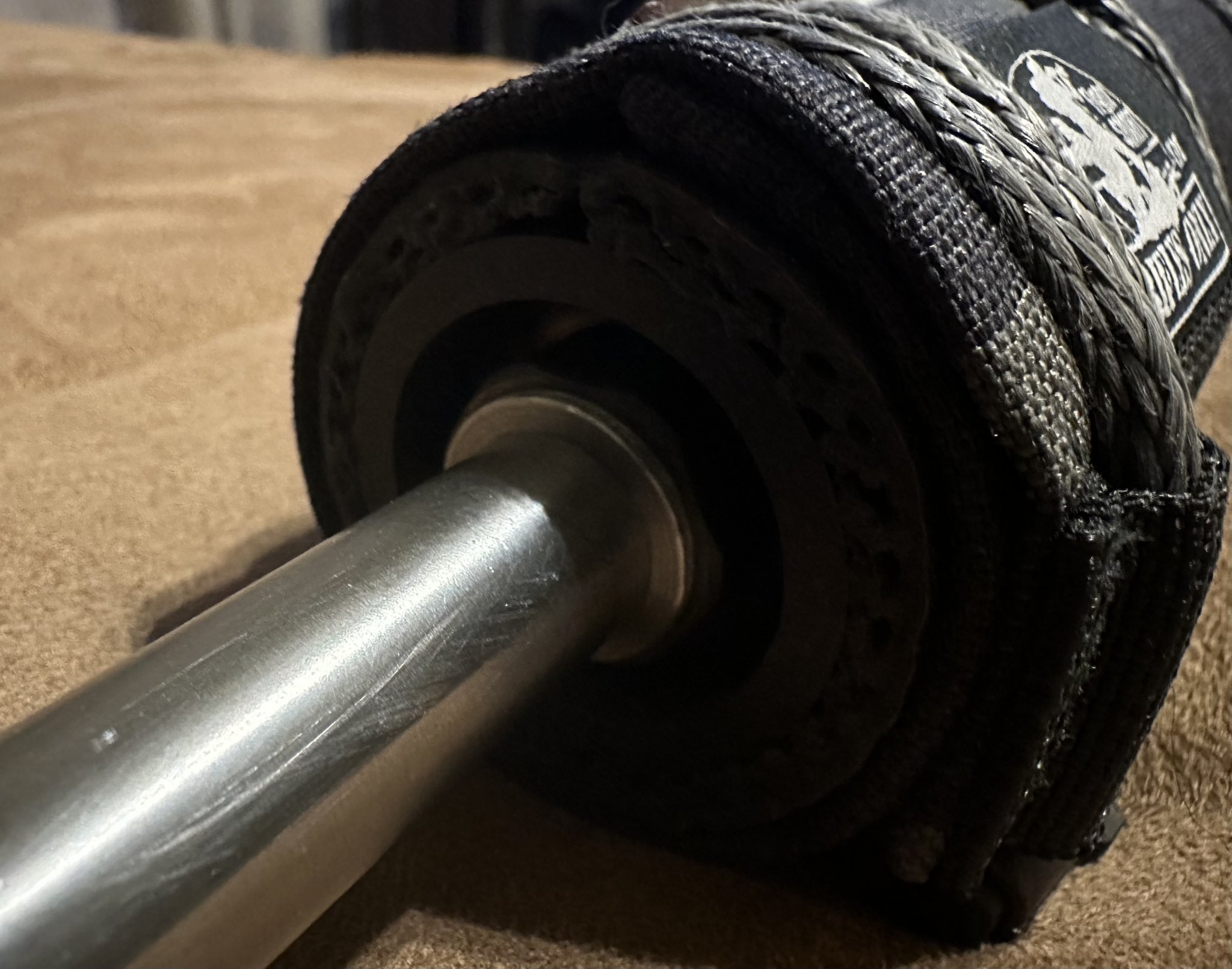

Just had my smith thread a couple of old Ruger M77 MKII pencil barrels for me, and he made some custom permanently-attached 5/8-24 adapters from an old 416r stainless barrel he had laying around, that have shoulders on them. They’re not perfect, or pretty, but they’re straight, true alignment, & functional. 👍🏼
Just had my smith ... custom permanently-attached 5/8-24 adapters ... They’re not perfect, or pretty, but they’re straight, true alignment, & functional. 👍🏼
This would be perfect IMHO. I assume silver soldered? If your smith doesn't mind and accepts work via shipping please provide his deets just in case Ruger is able to fix my 308 Govt. rifle.
Unfortunately, he doesn’t. He’s extremely peculiar about who he does work for. He’s been doing all my work for over a decade, so I’m one of the few that can just call him and drop stuff off on a whim.
I’m not sure on the compound used, I’m guessing either some sort of permanent steel epoxy like DevCon, Permatex 4-Ton, or Loctite, or he could have used silver solder or flux?
You're in Texas I see, contact the guys over at South Texas Armament in Uvalde. And then show them the pictures I posted. I'm sure they can hook you up with something on your rifle. They do amazing work (I see their posts on instagram), and are semi-local (in-state) for you, so you might be able to drive them there, or quick-ship.
I don't have FB, but you can still see their address and phone number if you click on the link.
