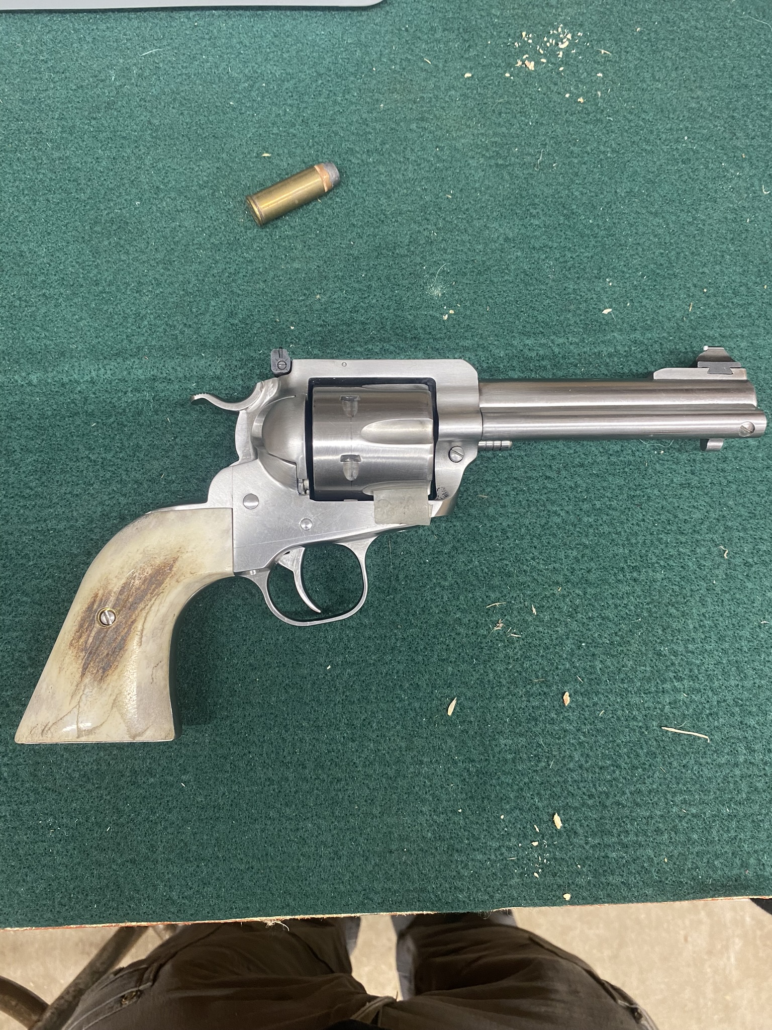

so i have a ruger blackhawk that i am customizing. i've done everything with my hand tools up until now, my next step i need some guidance on and figured the folks here might be able to point me in the right direction.
there are five screws that hold the frame on. two of the five are identical; the other 3 are each different. the issue is (like most revolvers) the flat screw heads. they are the stupidest thing ever, and most manufacturers stay with them. dan wesson, and magnum research are the only two i know of that was smart enough to use allen screws instead of flat tip trash. and for those thinking "use the right screw driver and this wont be an issue"....not the case. the fucking things deform even with me being very careful.
the solution here is to use either an allen head or torx screws and alter them to fit. at least that's what i am thinking. if there is a better option, i'm all ears.
i know there are guys here with the skills that can point me in the right direction. any and all help is appreciated.
so far, i've done the free spawl (super simple), put custom elk grips on it, dovetailed an old ivory sight, slicked up the action, and fitted a bisley hammer to it. replacing the shit screws that come with it is next on my hit list.
