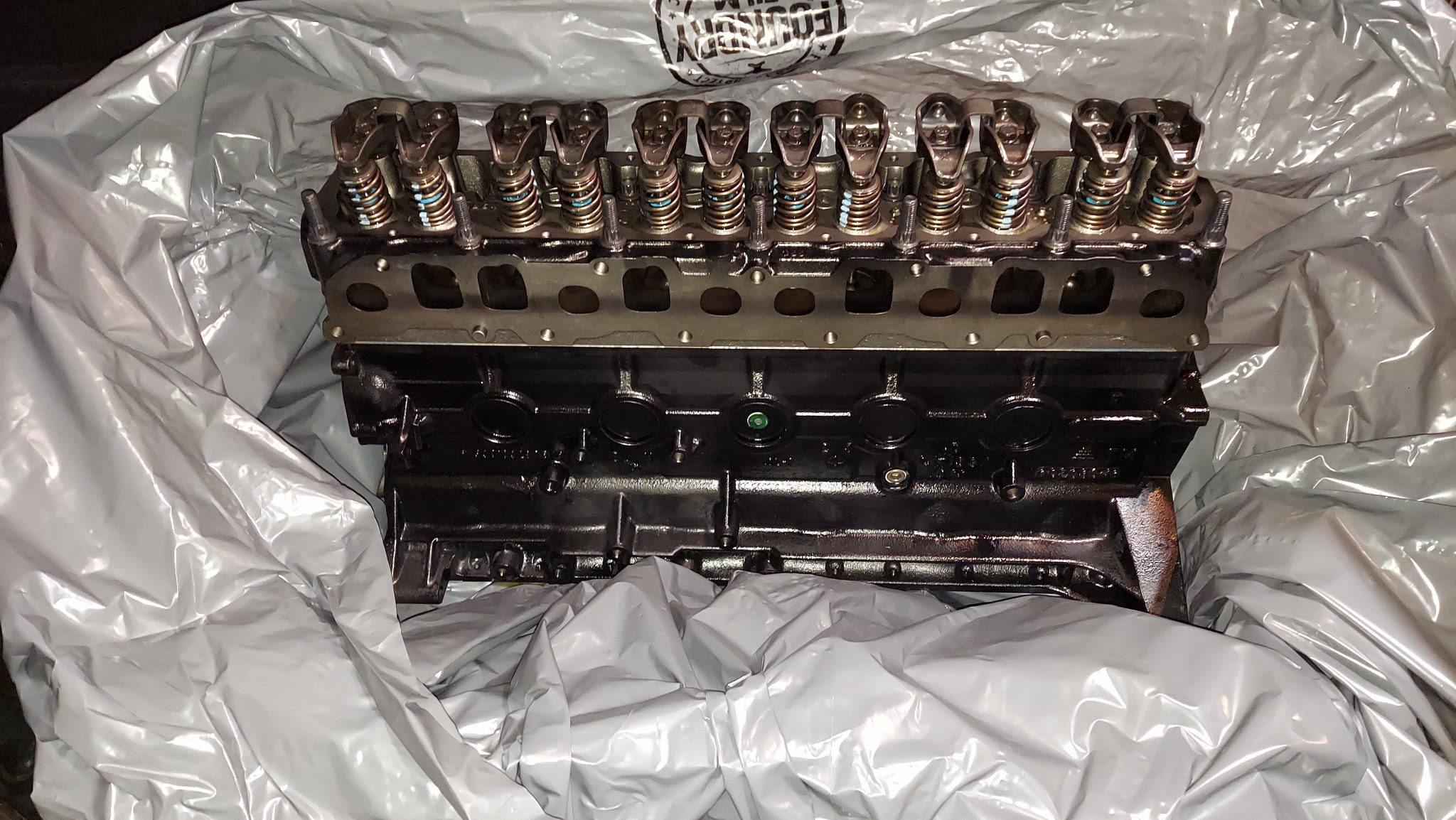

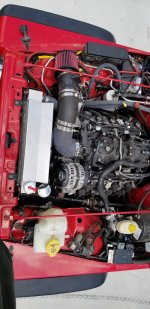

Running 5.3l gen 3 V8s in both my LJs, 400hp and 330 ft lbs of torque, unfortunately the 6 speed manual could not handle the power, so went with a 4L60e since s bigger manusl would not fit. Still hsve a 6 speed if you want it.

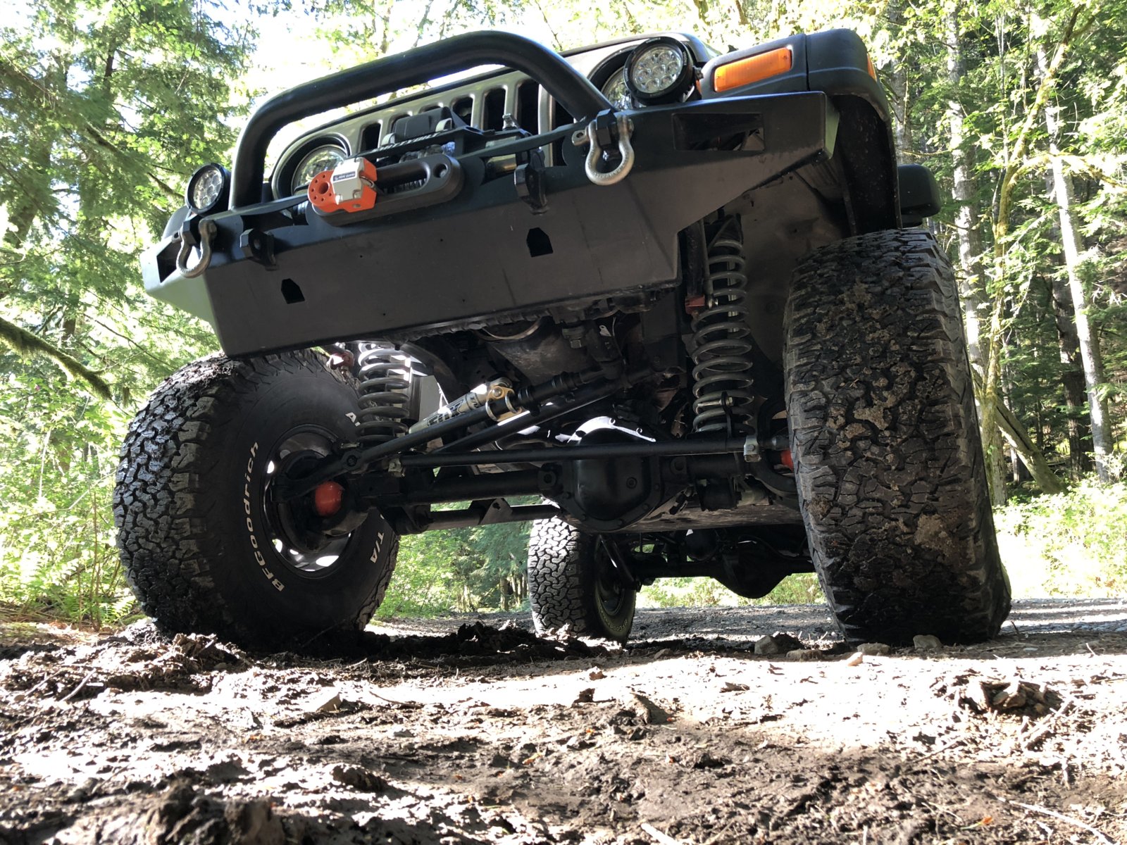

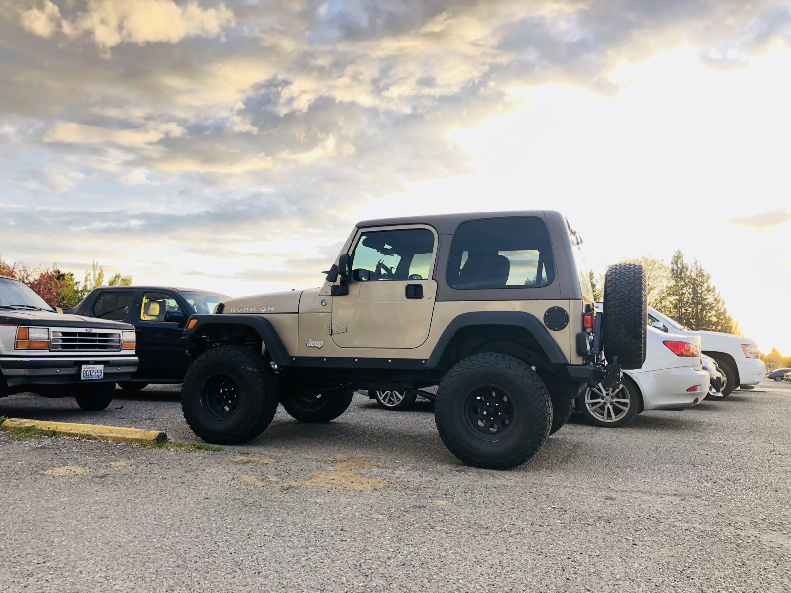

Had a 97 Jeep TJ and we decided to make a little project out of it after I blew the original engine up.. Not quite done as I wanted to finally get new/larger wheels on it and swap out the MetalCloak fenders on it to the wider 8 inch version as the short ones allowed mud/rocks to fly off the front wheel and basically shotgun the rear fenders and the MetalCloak Rocker rail as it seems the wife now needs a 'step' to get into it.
Here's where I'm at:
3L turbo diesel out of a Touareg (pushing 24lbs of boost at the moment)
AX15 transmission
Intercooler
Teraflex lift, short arm, Bilstein shocks
ARB Engine compressor with front/rear air lockers
MetalCloak front/rear frame mounted bumpers
MetalCloak fenders
MetalCloak stinger
Lightbar + fairlead 'connected' lights
Fog lights
IR lights with Blackout switch that kills all visible electronics; Odometer delete
Complete repaint in 686 tan

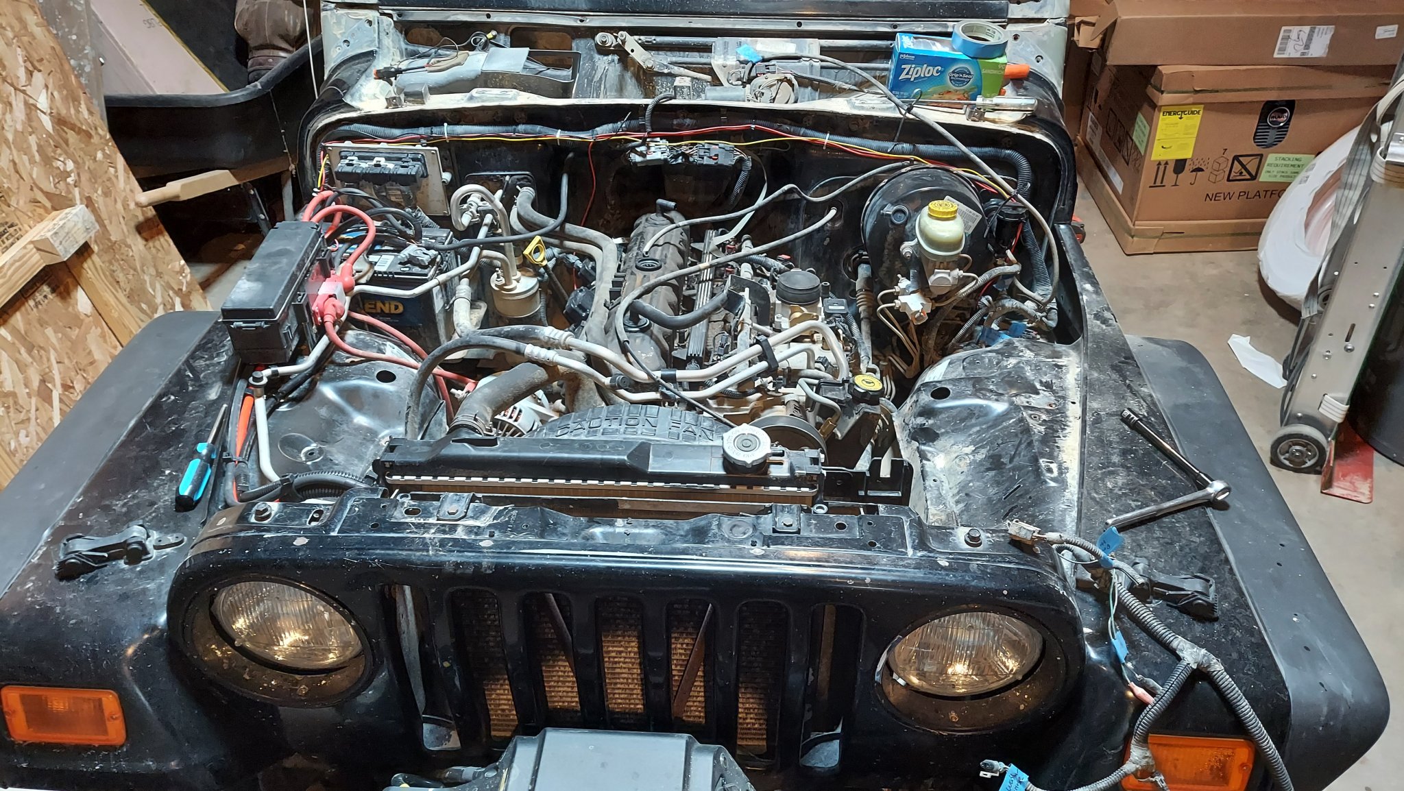

If it would heald out I was gonna do the Mercedes om617 in my TJ over the Winter, but sadly the motor is hammering good. Once I get back the whole Jeeps getting an almost frame off overhaul, new 4l, teraflex lift, axle work, all the trimmings. Paint next month, and maybe, an Eaton supercharger

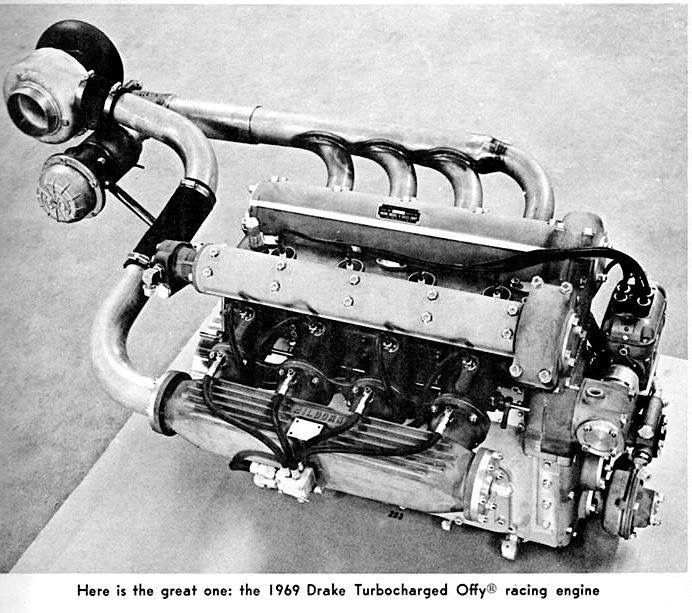

This would have been my first choice....about 350 lbs max and easily up to 1000 horse, I've seen them on Terry Drakes dyno with all the exhaust glowing red and pushing 1400 horse.
You want a small engine with plenty of nads.
You don't want a heavy engine, kills performance and offroad handling.
Dang. Those are BMW M12/13 numbers but 14+ years earlier, although the Offenhauser has a displacement advantage. Thanks for bringing those to my attention, I hadn't read much about them till now.
