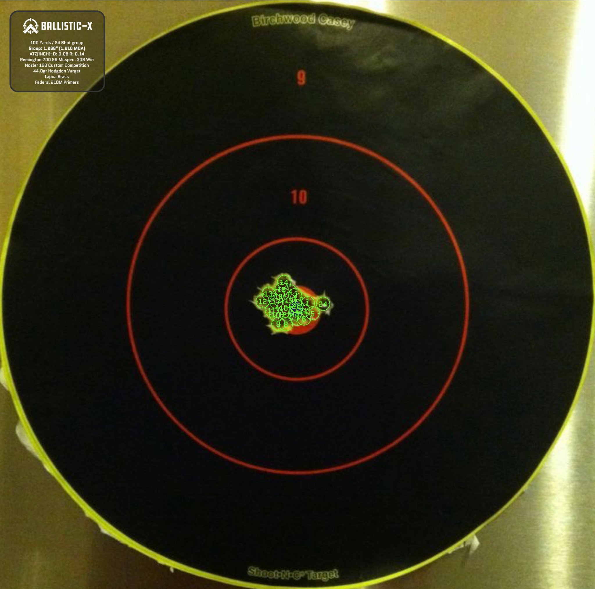

24 shot group with a factory 700 5R Milspec .308… Had I not rushed the last shot (far right pull), it would have been sub-MOA..
Well I'll be Fuhqed.
24 shots into 3/4 MOA, I'm impressed. You're one of the few who I'd be happy to say have a true sub MOA rifle 95% of the time.
Such a breath of fresh air. I'm completely over the bullshit 3 & 5 shot good group proclamation.

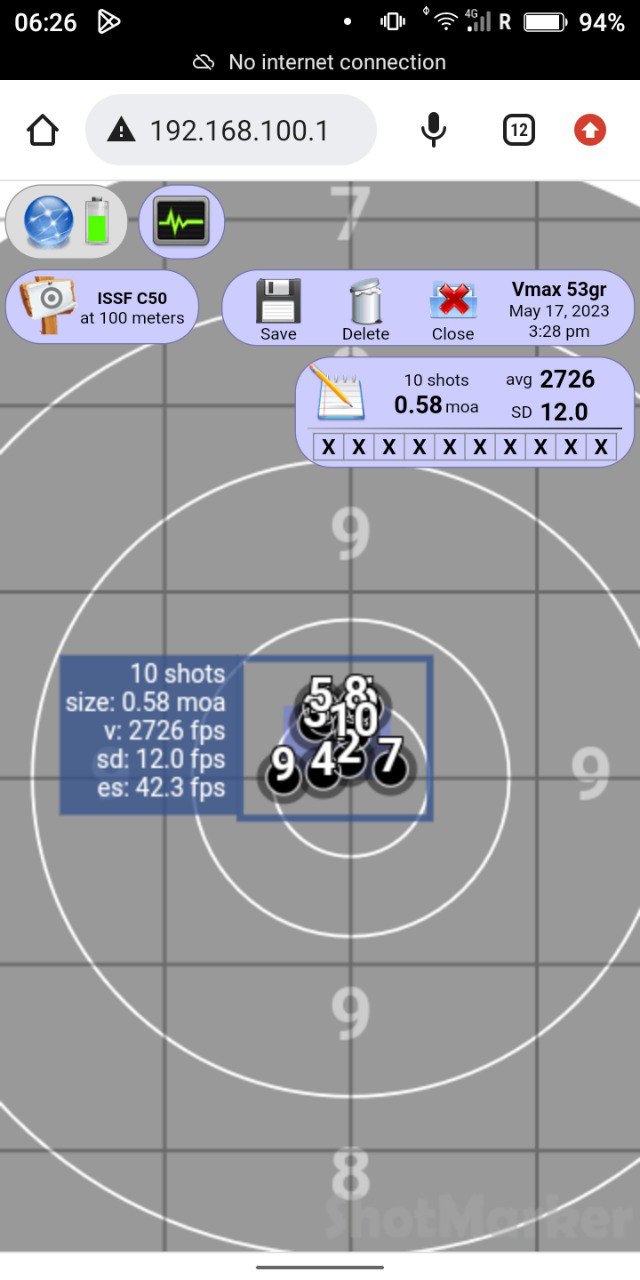

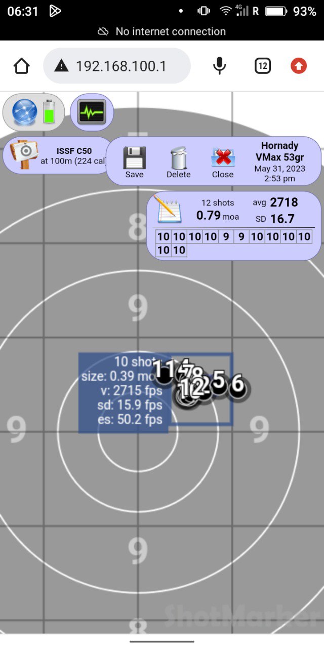

Well, if you want 10 shot groups at 100m, here's two consecutive ones that I did for load testing. Unfortunately it is only .223.
Rifle is a Tikka T3x Supervarmint in .223 with Hornady 53gr Vmax. Rifle is stil in the original plastic stock.
I will be picking up my .308 in February.
The first group is actually 0.8 moa. For some reason shot 6 and 11 wasn't included in the stats.
