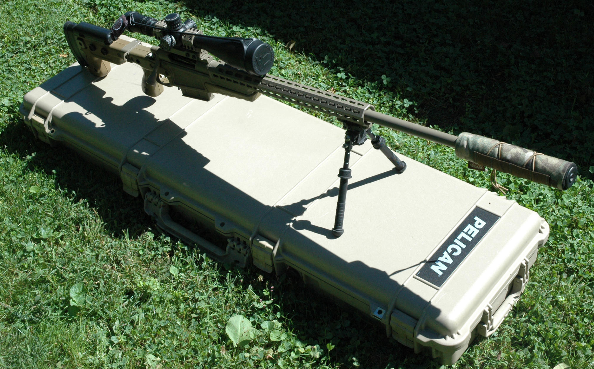

I'm a retard and completely forgot to take pics last weekend...Was having some issues with my 300blk and just completely forgot about it.
I'm headed back over there next weekend...I'll snag some pics of the 300WM and the SASS.

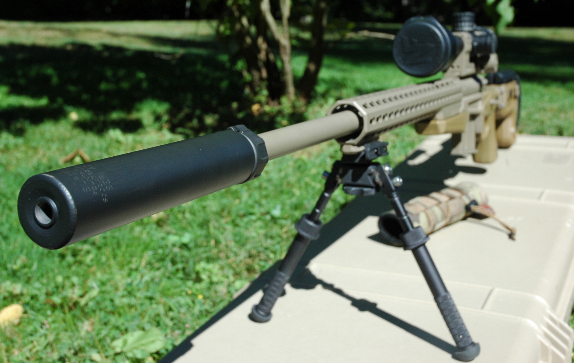

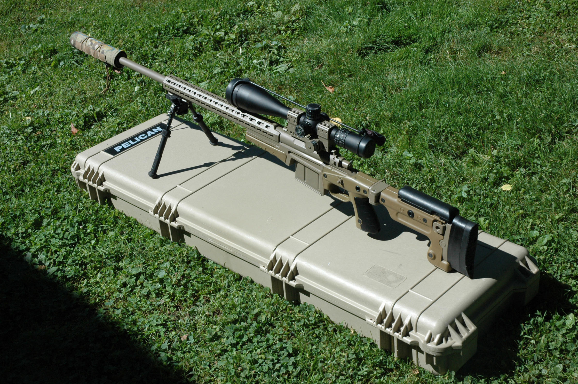

I come with pictures!!!
Yesterday was a nice day so, decided to bring out the big boy...
This is my Mk13 Mod 6 "clone"...Again, I shoot MK 248 Mod 1's with H1000 and 208/220/240's...It's extremely pleasant to shoot, maybe I'm just used to the magnum?
The suppressor cover is a Tab - Extremely happy with it.

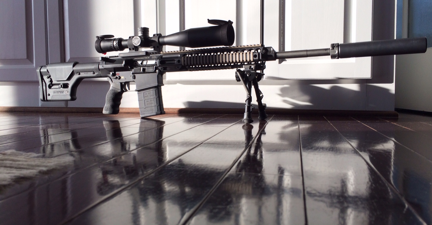

I'm not sure I have much to add to this discussion. But... I went with the socom 762 primarily because I liked the QD mount, and Surefire's reputation (though I'm not saying others' reps aren't also fine). Also, my LGS stocks SF and its a store I like to support.
I have it mounted on a 20" LMT with a heavier buffer weight. Recoil is reduced, but I also find different--like the impulse is changed--and I find this makes everything more manageable. Sound reduction is... fine. I don't have a lot to compare it to and don't shoot with others who own suppressors. I have found very little-to-no POI shift, which I like. I shoot 175 SMK, primarily FGMM and handloads.
I also have a 556 version, and had a hard time telling a different between the sound reduction when I swapped the 556 and 762 on my 11.5" SBR. I will admit to always wearing ear pro, so my test may be flawed, as well as subjective.
