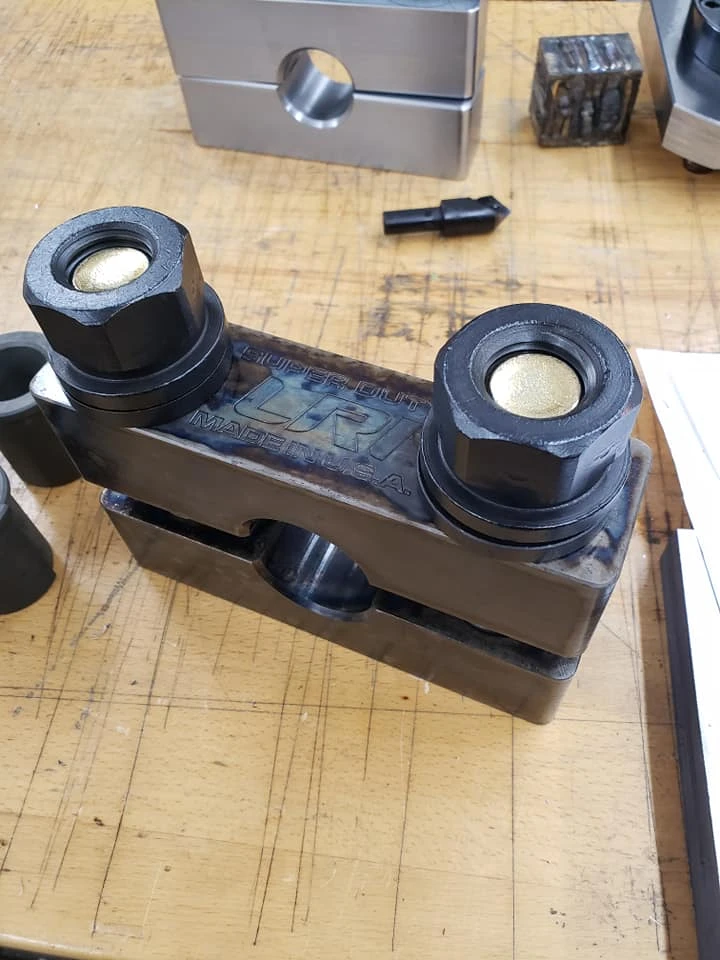

Thanks guys for the feedback, barrel vice it is

that LRI model looks amazing...love the case hardening

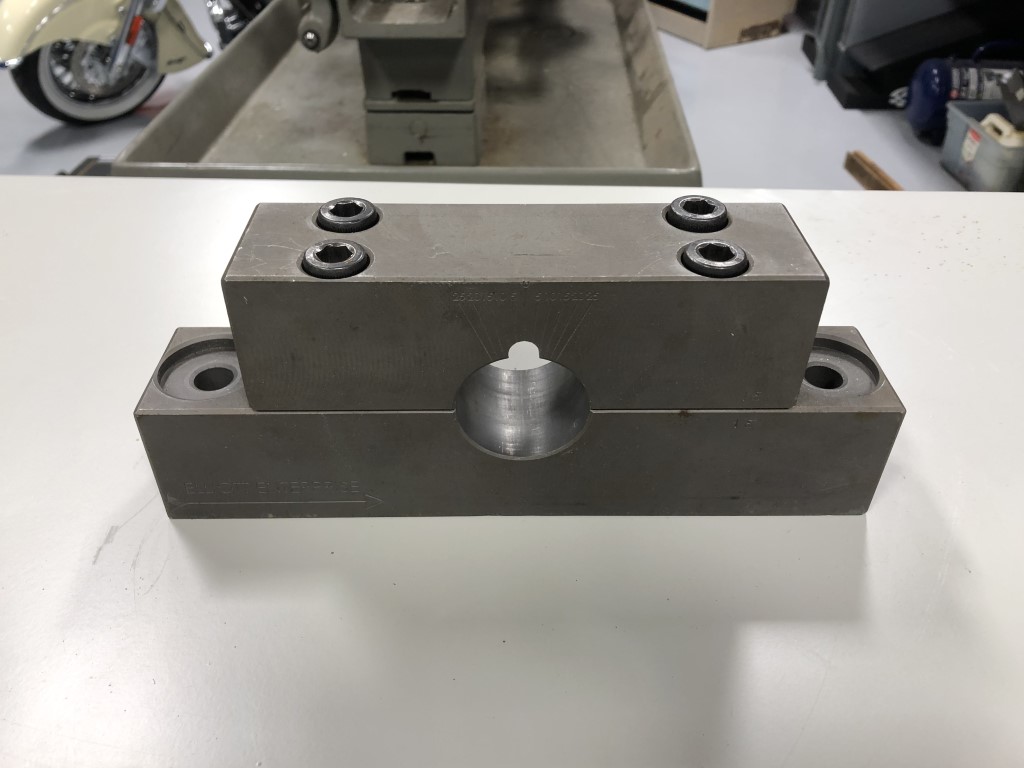

Picked this one up 20 or so yrs ago during my FAL days ($75?) not realizing how useful it would be down the road for other stuff. Made from 2" bar stock, base is 10" long, and it takes Brownells standard size bushings. Speaking of Brownells, there's one of their bbl vises on ebay now for $100 - not as heavy duty as this one but looks better than most. There are also some <$100 vises made from bar stock on ebay that look stout but who knows.
