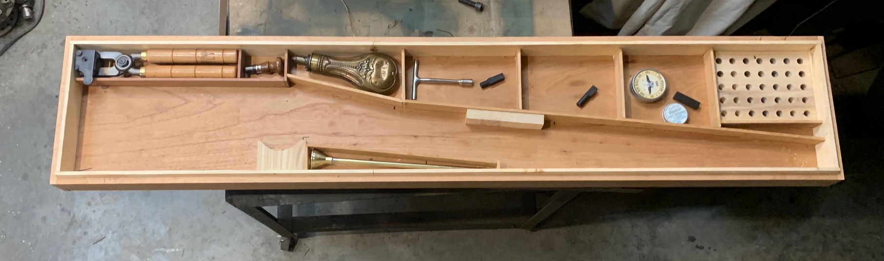

And a bit more on the 'case' front today... Not the Army Navy case, but a period-looking case for a Confederate Whitworth sniper rifle (Pedersoli repro.)

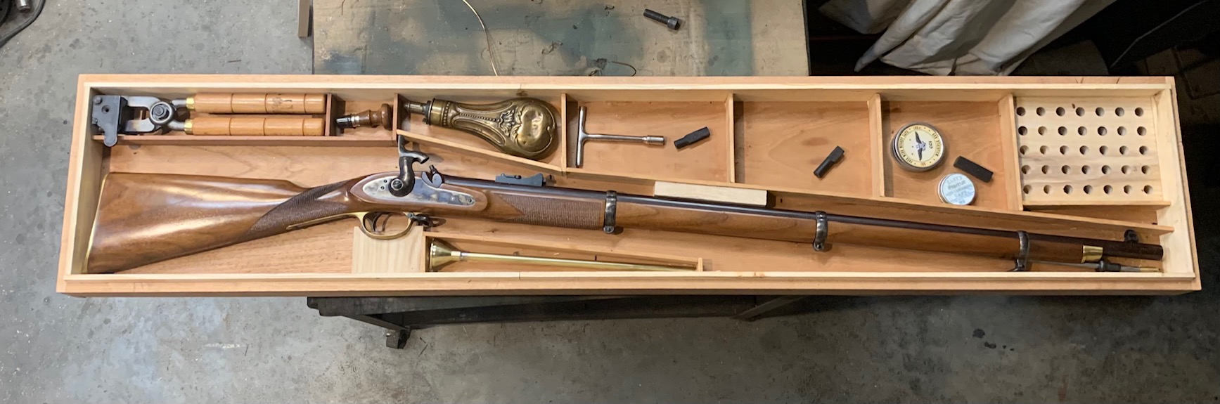

Box made of cedar. It's 'sort of' like the originals. Though there are very few original surviving and they are all a bit different. So I just made something that I like.

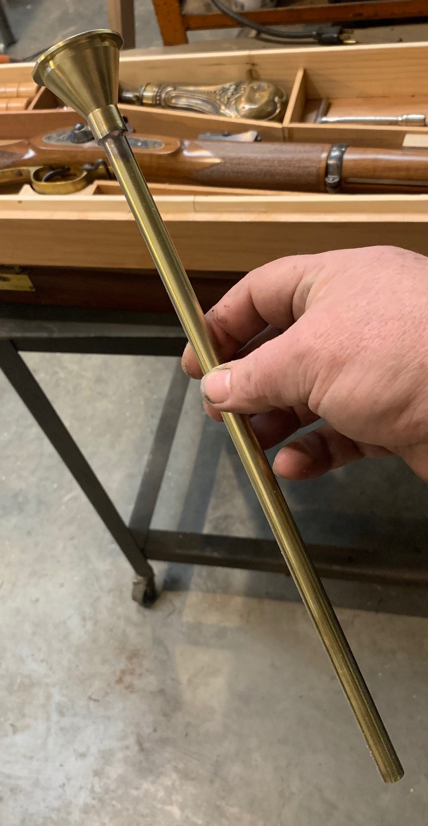

Long Reach funnel I made to use and go in the case. Turned from a solid brass bar with a brass tube soldered on . These were used to deliver the powder closer to the chamber than just pouring it down the muzzle. This led to better filling and more consistent shots.

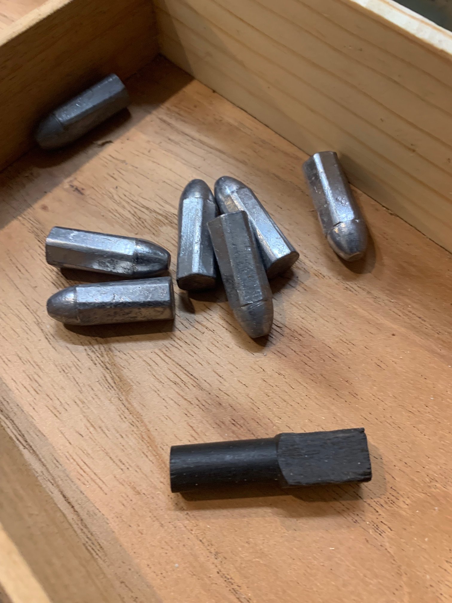

Hexagonal boolits... for the Whitworth. These are as-cast. Drop poured. My 'new generation' are hand poured from a ladle and much better.
Piecing the compartments and box together. The three compartments at top with the ebony blocks in them will have covers with knobs on them.

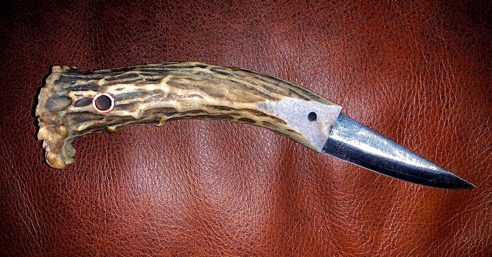

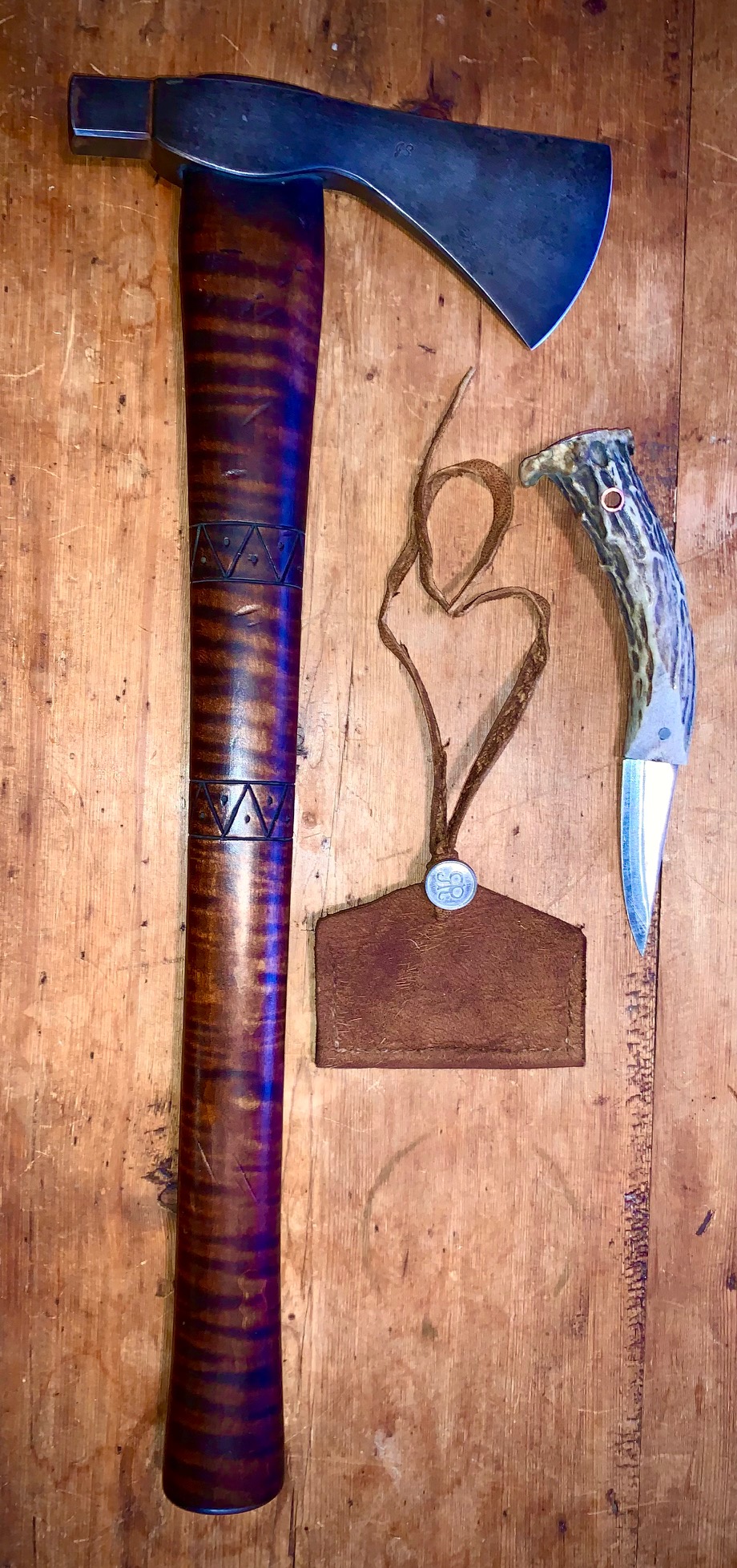

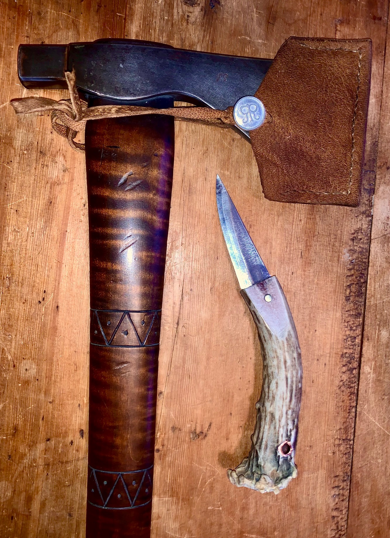

Got more done on the Whitworth case today... but big 'finish' was to get my little patch knife done with a pewter pommel cap. It's based on a Revolutionary War CT Militia Button. The 'Hawk is from Rich McDonald of the Contemporary Longrifles Assn. Forged and gorgeous!
Deer antler. German Silver pin. Forged/filed/ground blade. Copper lining in the lanyard hole.
Size next to 'Hawk. Patch knives were tiny and for trimming the patches off round balls when inserting a patched ball in a muzzle-loader.
Gratuitous picture of a really cool forged 'hawk!

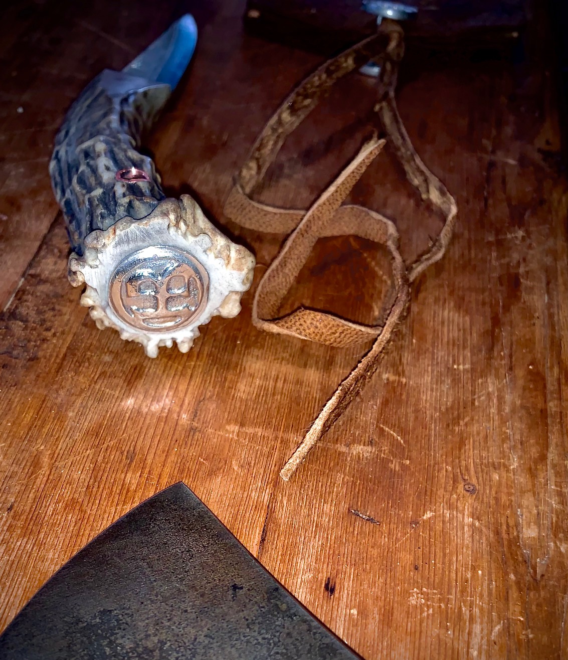

Pommel cap is a pewter button, affixed to the antler root and then polished.
I'll finish the Whitworth case tomorrow! Did hinges and one case corner today along with covers for the various compartments. Ordering some leather straps from Galazan, too. So it closes nicely!

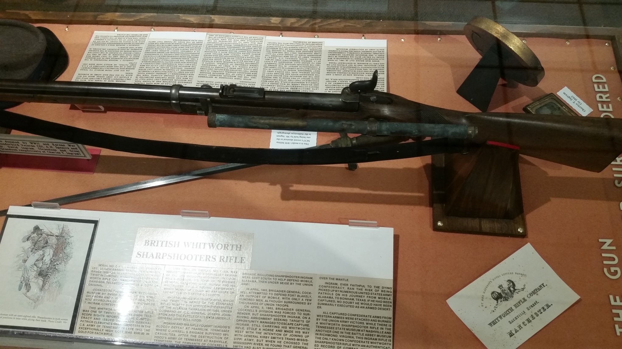

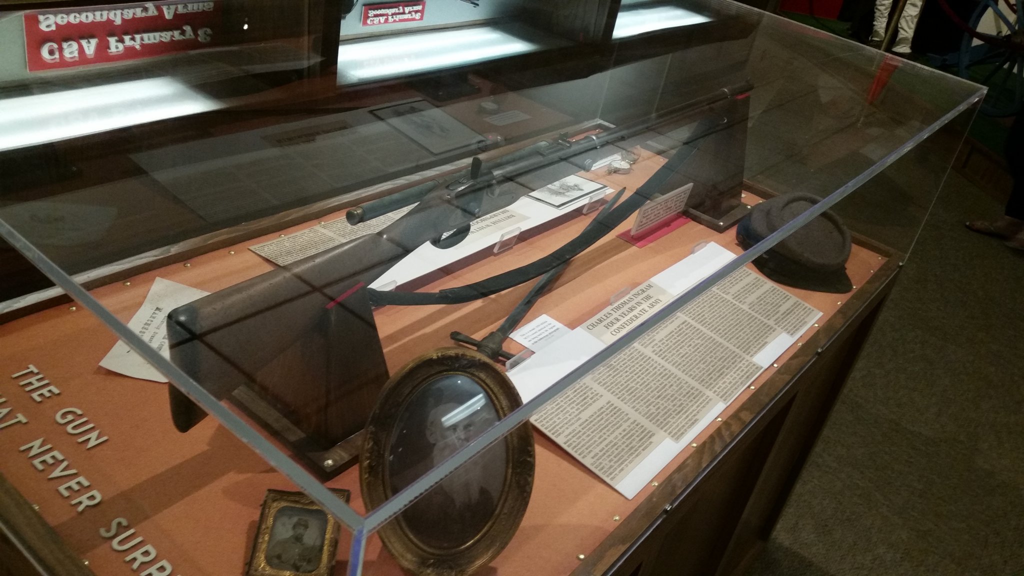

Sir in your travels, if you get to Oklahoma City, visit the 45th Division Museum. They have one on display. They have a nice vehicle collection and a very nice collection of firearms and ephemera from the Civil War on. They also have a large section on Bill Maudlin.

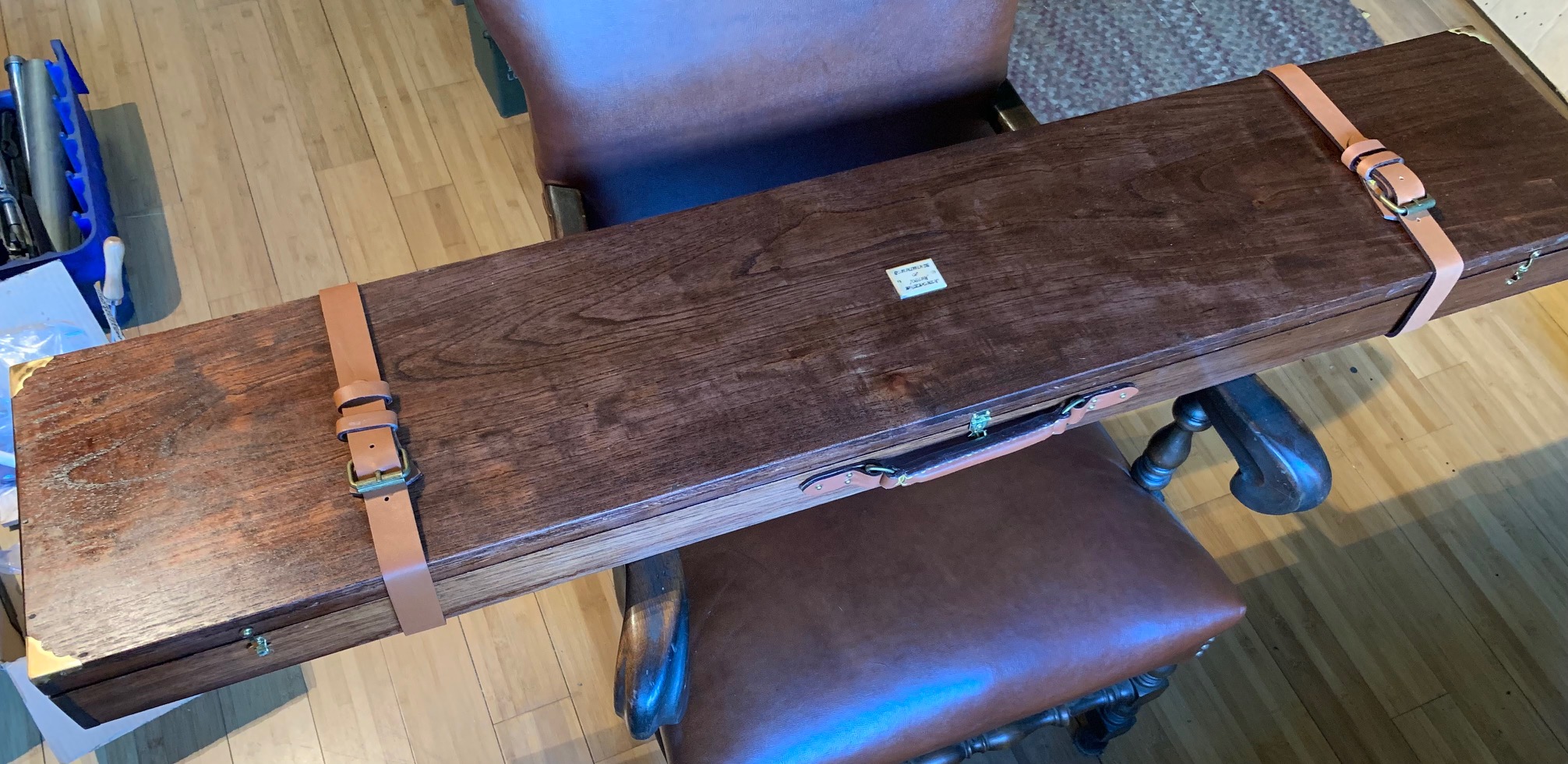

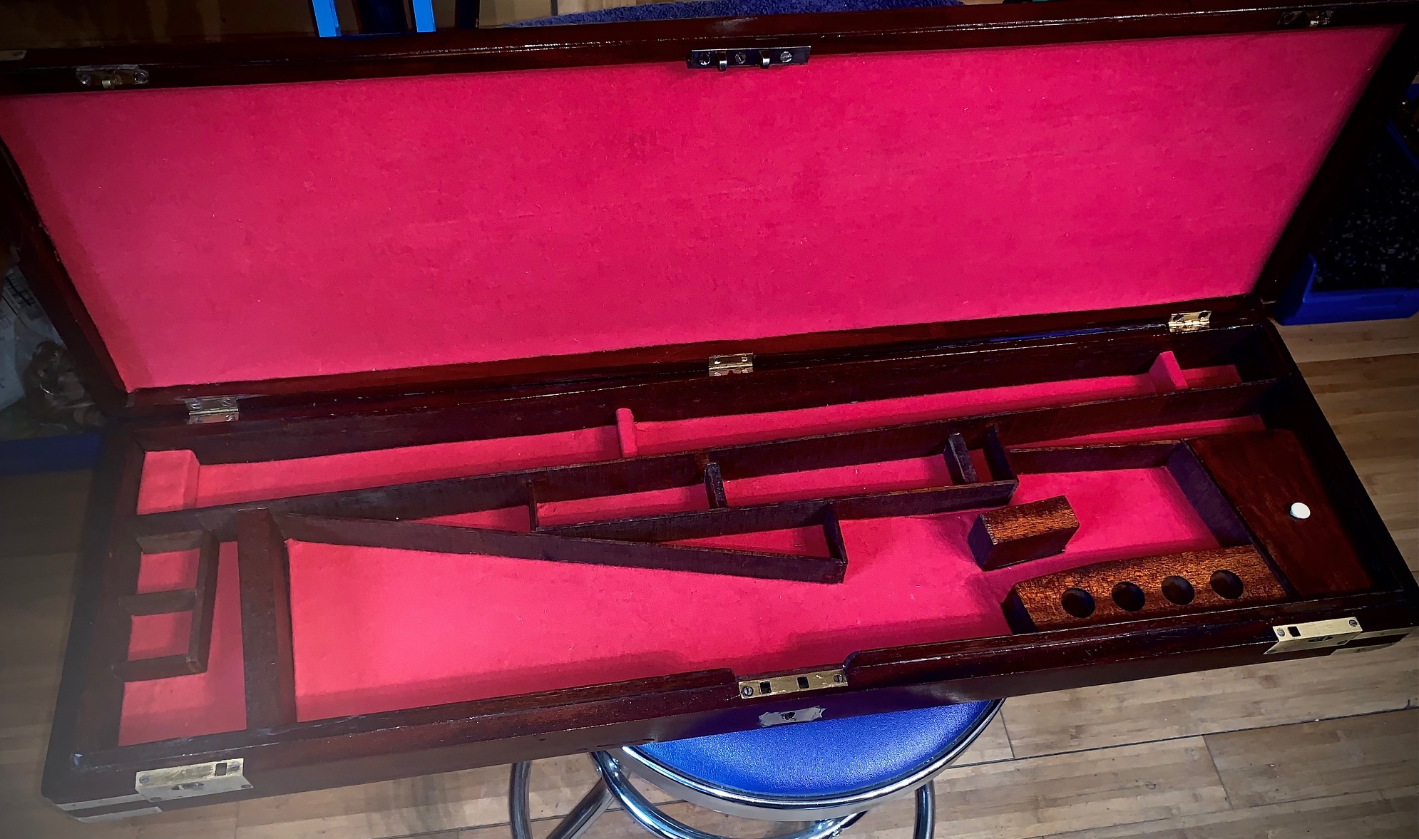

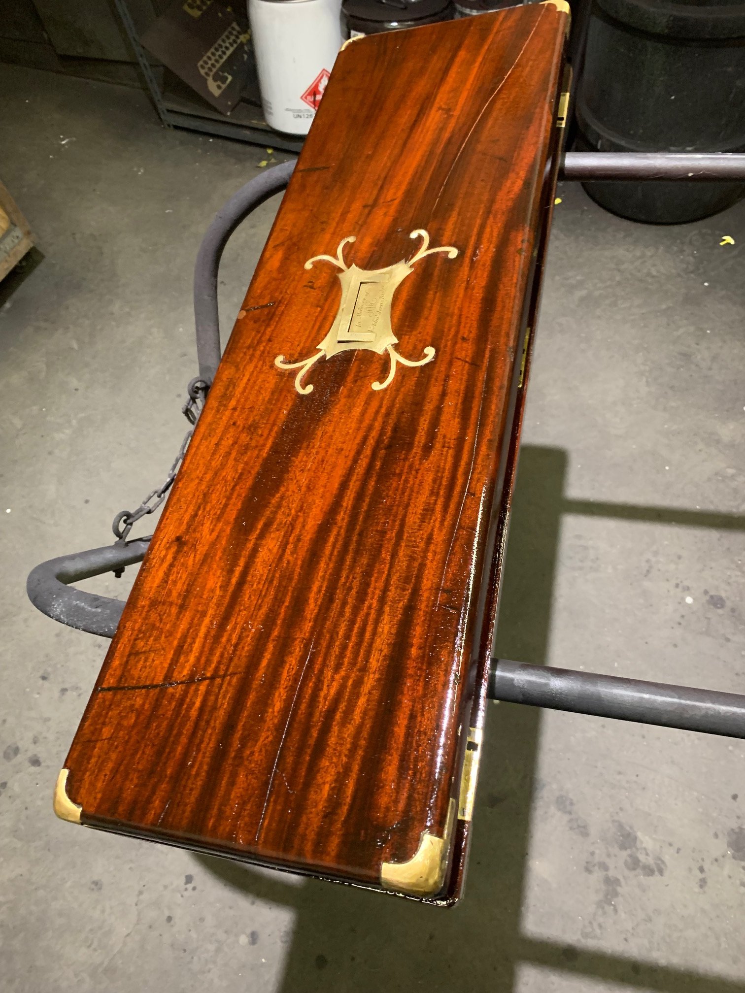

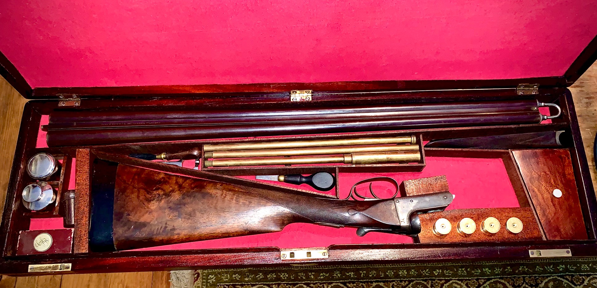

So finished the English case today... came out really well. Still needs a case label. Working on that. Used a nice red felt. It looks 'redder' in the photos.
With my C. 1910 Army Navy English 12 more. This gun is what would be called a Birmingham Best. Sold by Army-Navy store in London. Sort of an outfitter for British officers heading overseas to India, Africa, France and other third world countries. Very light and fitting sort of thing an Admiral would have had. As the case is 'named' to Admiral Jervis Tucker.
Tomorrow, I'll finish up the Confederate Whitworth Sniper case. All the felting is done. Lids, too. Label is in. Need to do latches and leather straps and a nice leather handle. It's going to really look good! It's not intended to be a 'fine English' fitted case. More of a fitted transit or delivery case that they'd ship in. Though some of these rifles were ordered pre-war by Southern Plantation owners for competitions, etc. So the case is a cross between a simple shipping/transit case and a quality case befitting the highest-quality rifle one could buy in the late 1850's/early 1860's.

What wood and finish on the Whitworth case? Love the blue. The other case felt looks pink.
Yeah... not pink ;-) But camera sure makes it look that way!
The finish is Minwax stain... kind of mixed with some reddish. The case is cedar. So reddened it a bit. The finish is a polymerized tung oil finish. I can send you the brand. It's made here in New England. I definitely like it. It's fantastic on maple and gunstocks!

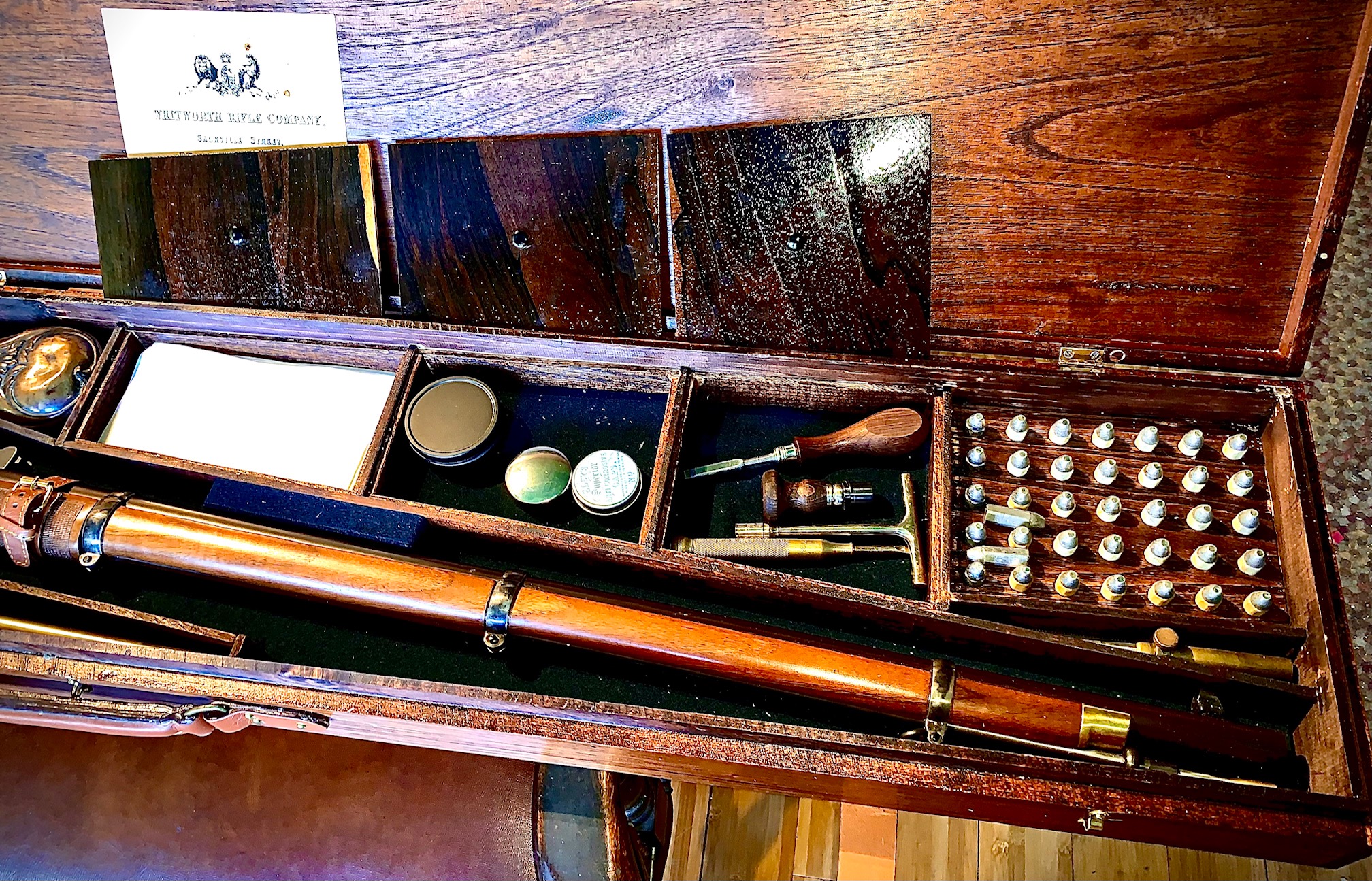

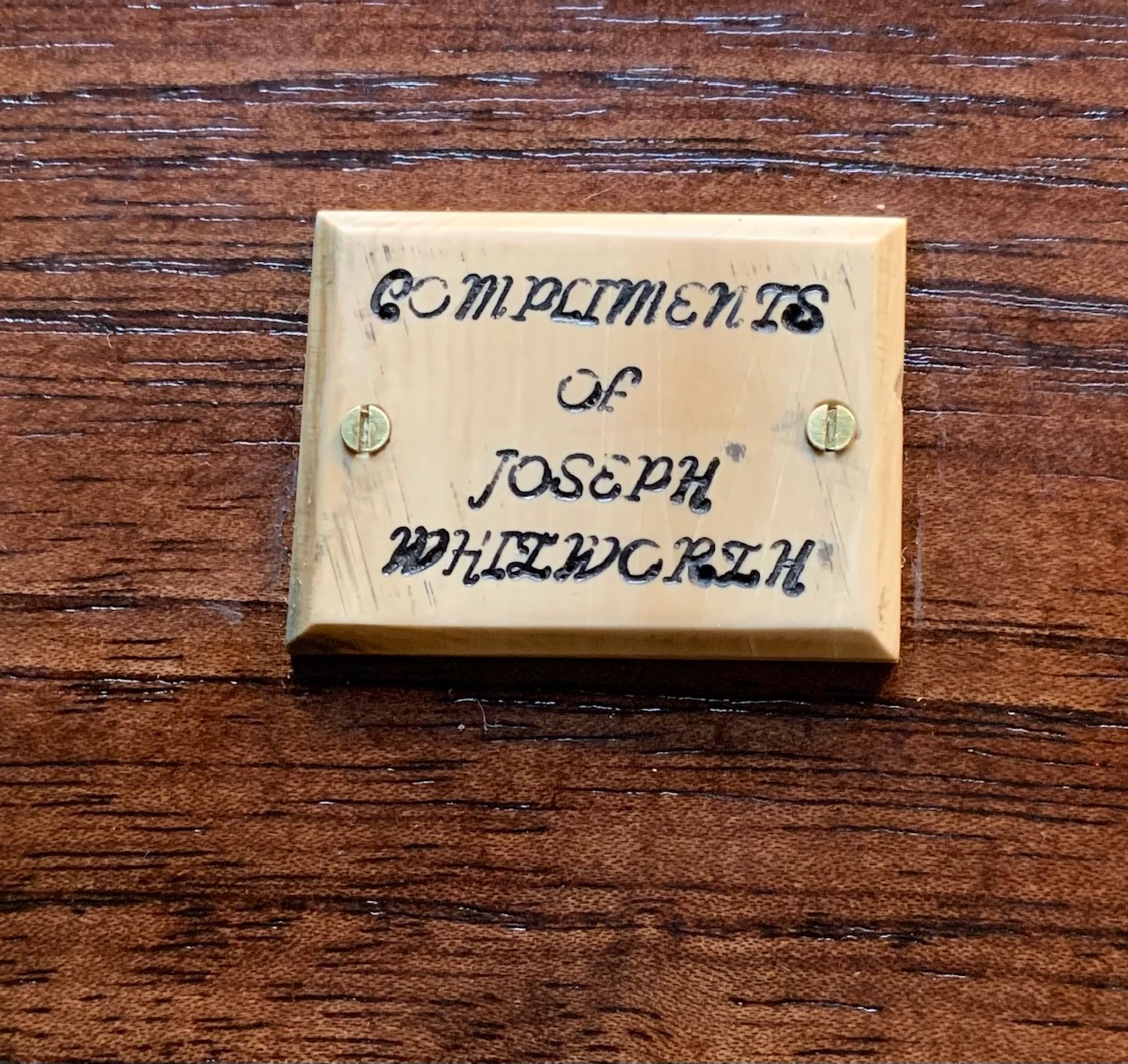

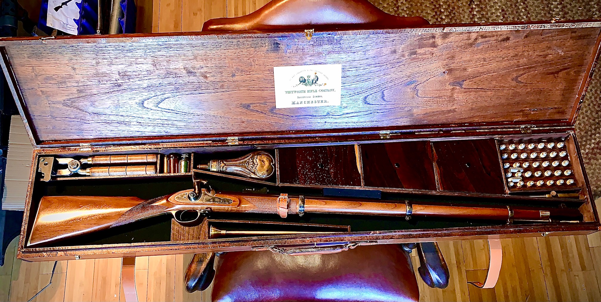

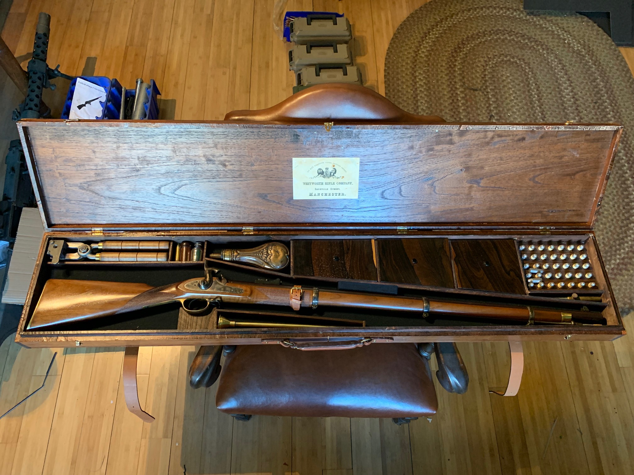

So finished the Whitworth case today. Went a bit overboard including the ivory scrimshaw presentation plaque. Meh... go big or go home, I guess! Leather straps came out great. Got them from CSMC. Along with the case corners.
Bit of mammoth ivory, scrimshawed with the Whitworth presentation info. I think he'd have made a nicer case if he presented a rifle to some shooter... or Jefferson Davis. I almost scrimshawed it to say "To John Sedgewick from Jos. Whitworth." Just for irony's sake. Sorry about my scrimshaw work. It sort of sucks compared to the masters.

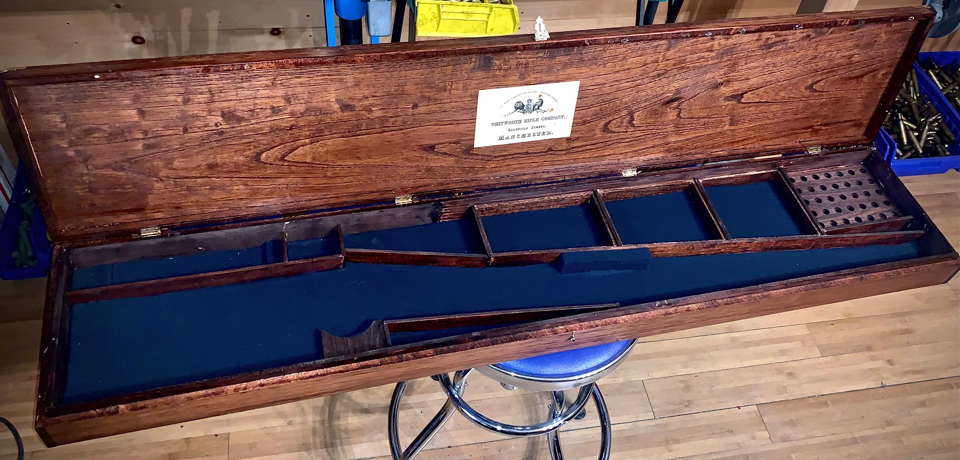

Inside the case with the box tops off. Wrapping paper, primers, grease, patches, tools, boolits, all the good stuff. Repro Whitworth label from Dixie Gun Works.
Rifle with mold, etc. and the covers on the compartments. Box is Spanish Cedar, in case anyone was wondering. Got a deal on a couple of sheets at my local wood store. Best smelling shop in New England. Except for the cigar shop and the puerto rican bakery in Ludlow... but I digress.
So, another fun project put to rest. This will go South in April with the Hinson Rifle for some empirical testing of Confederate Sniper capabilities. Right now, I can't say it shoots much better than minute of grapefruit at 200 yards. But have not really gotten into it. Just tested function. When I fired it into my steel silhouettes... it didn't so much group as knock them backwards on their posts. Thing hits like a ton of bricks.

What's the projectile weight on the w
Whitworth and estimated velocity?
The results are amazing. Your a craftsman.
Thanks! The bolts (technically not bullets) are about 500 grains depending on alloy. You can put more tin in these and cast them pretty hard as they don’t engage rifling, instead riding the hex.
With 70 grains of ffg they run about 1400 fps (from tables - I have not chrono’d). Though some 1000byard shooters run up to 100 grains BP in them.
Hoping in April to have more data.
View attachment 7770410Deer antler. German Silver pin. Forged/filed/ground blade. Copper lining in the lanyard hole.

The 45th ID Museum also has the howtizer captured from Mosby's Rangers and a swivel gun which has provenance to Adm. Dewey (he was a junior officer aboard the USS Mississippi when it was sunk at Port Hudson, Louisiana) of Manila Bay fame ('You may fire when ready, Gridley"). They also have Hitler's cape (donor during his childhood wore it to play Batman and was jumping off the garage roof when his father (a 45th ID man) said, "Hey, stop playing with Hitler's cape." Only at that point did the father realize the significance of the cape. He took it to wrap up and protect the chinaware he was looting. When donor grew up, he donated it to the museum).
