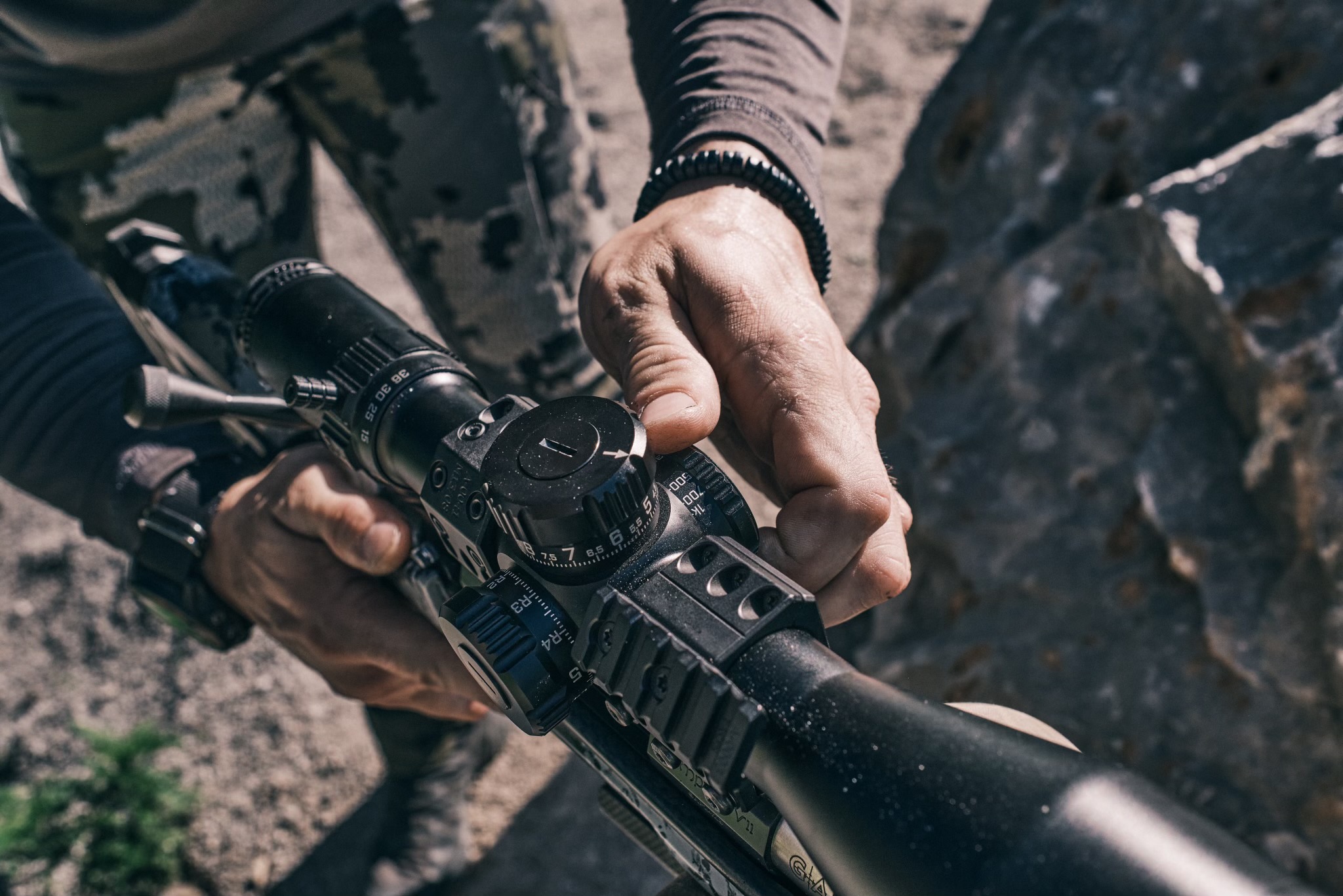

It's not something that stands out in the photo unless you know what you're looking at, but the updated font on the turrets is really nice in person.
Reactions: lash
I did notice that and thought that is a nice addition, I wish more manufacturers would take notice (ahem TT) and how larger numbers help us "old" folks ;)
Could be a 4.5-36x. If so, I'll be interested to see what they do with the reticle on the low end without illumination.
Heck, it's nice for us not-quite-as-old dudes that just want to be able to read the turret easier.

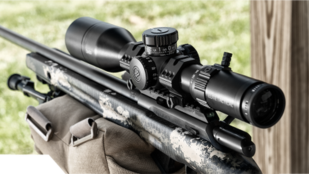

There's a few common things on both the DMR3 and XRS3 that are changed/improved over the previous generations.
Glass & light transmission were increased 2%. Parallax was decreased from 75 to 50, and 50 to 25 at max magnification. Turret numbering was made larger and easier to read. They both get Multi-Position Throw Hammers to give you the option of placement for left or right handed configurations - DMR3 = 2-position, XRS3 = 3-position. The parallax knob friction has been reduced on both. Magnification ring friction has been reduced on both. They both are launching with the G4P reticle which is a G3 but with a floating dot and a pile of other changes - It's a .04 MIL center dot FYI. The main stadia were also decreased in thickness. They both are 'Elite Tactical' on the ocular housing now.
DMR3 builds on what we learned from the II, the Pro, and HDMR II CR. The 25-yard parallax is the biggest thing that stands out first. The diopter friction has been increased on DMR3 to help prevent unwanted movement. Same big eyebox DMR has always had. Lots of travel for rimfire use.
XRS3 is a clean-sheet design. Some design elements from XRS2 transitioned over like the turret machining looks and they both use the same Revlimiter zero stop and we brought over the locking diopter from the XRS2, but that's about where it ends. It's all-new aside from those things. Through the use of the 56mm objective we managed to keep the 'eyebox' basically the same as the XRS2 at their respective full magnifications. At 30x & below on the XRS3 that eyebox will outperform what the XRS2 had.

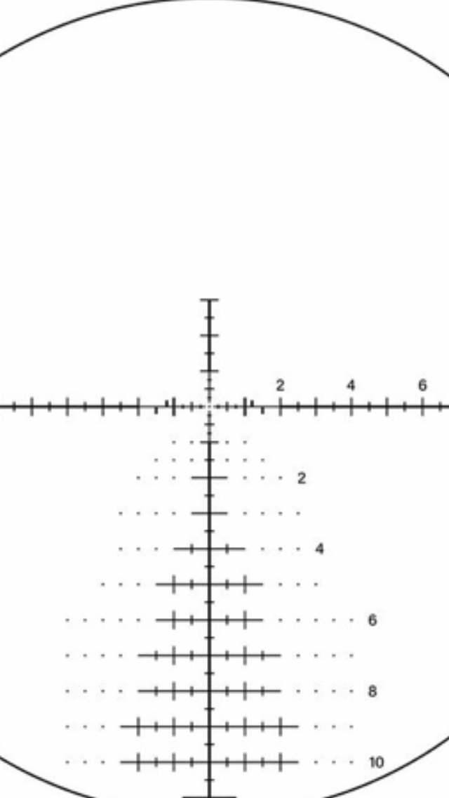

The image of the G4P reticle really doesn't do it justice. I think all of the people that complained about the thickness of the G3 reticle are going to fall in love when they see this thing in person. I was floored when I got my hands on it, and I was NOT happy when I had to give the test unit back.

For the DMR3 it looks like same essential design as previous (same length, similar weight) but with a slightly less forgiving FOV, 25y parallax and a bit greater eye relief.
The XRS3 is where its at! Completely redesigned optic, looking forward to seeing this and comparing to my XTR III 5.5-30x56.

From the 0.04 dot, what are ret subtensions out to 2 mil windage? Looks almost like 0.25 mil?
