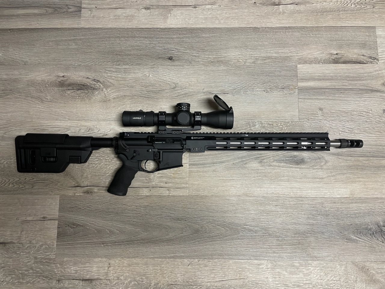

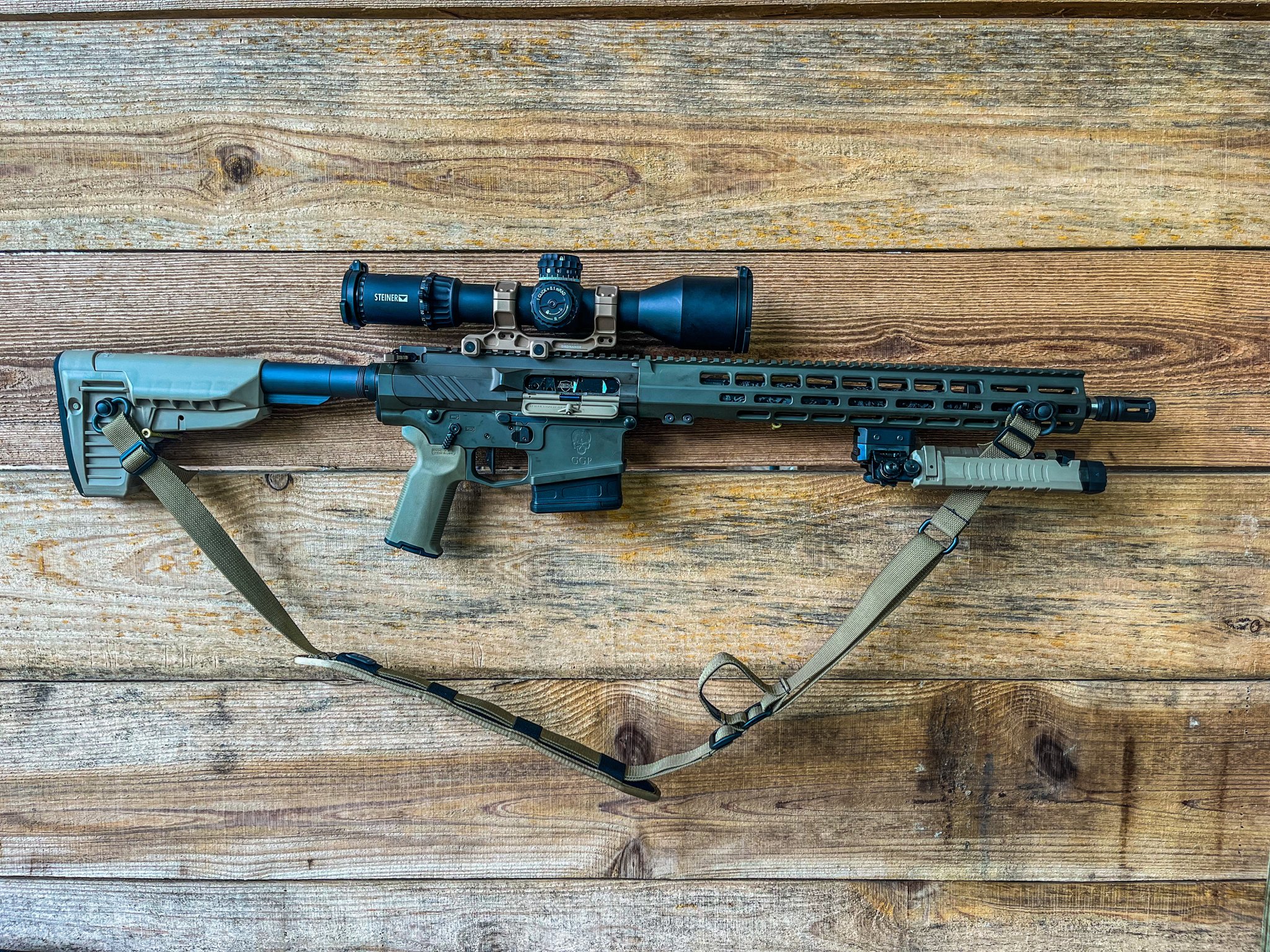

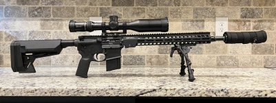

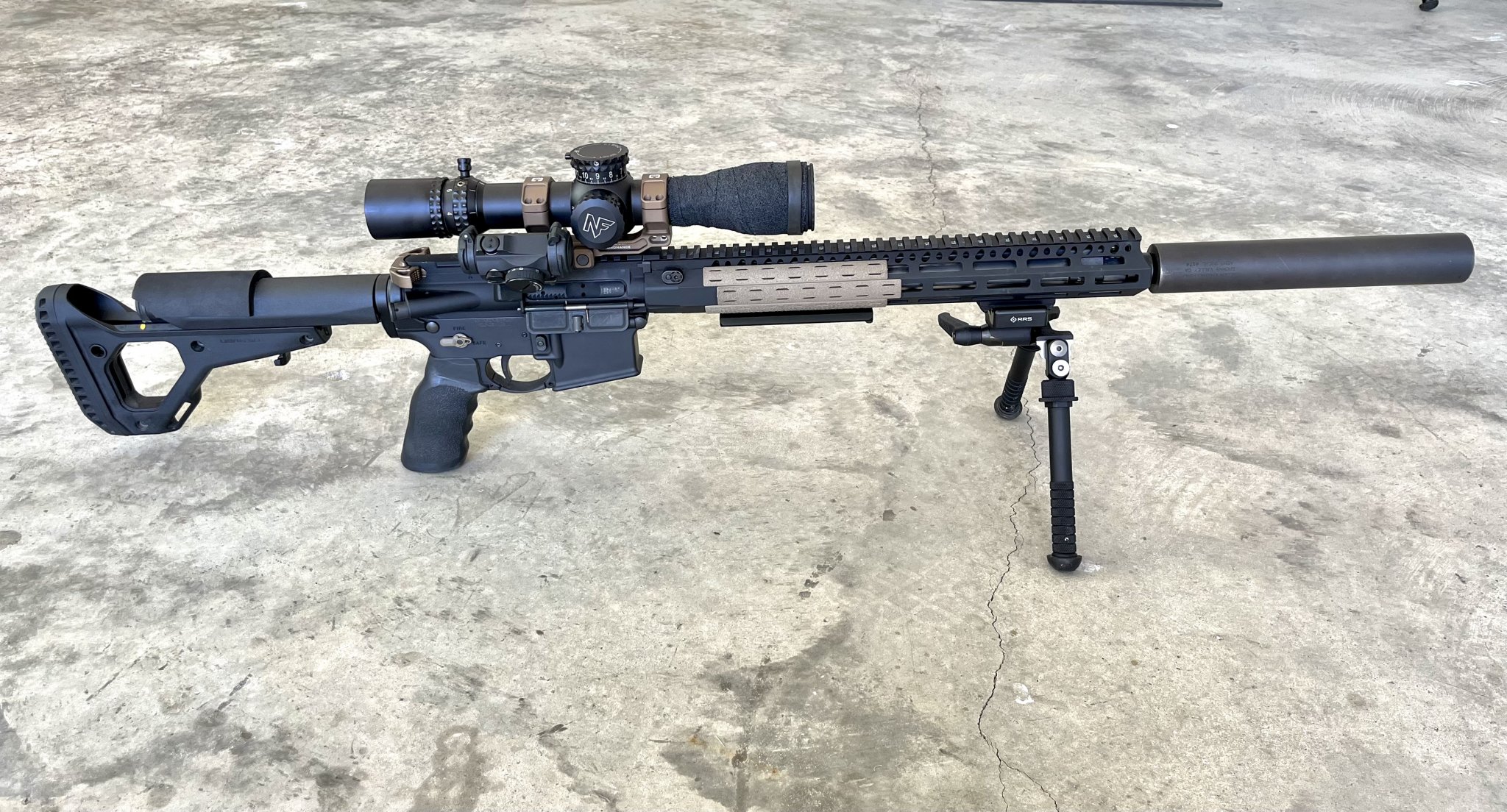

As you can see this 18” 6 ARC is a 100% clone correct Mk12.
Nice. I miss my 6 arc. Got specs for it?
-Aero slick side upper
-Magpul Ejection port cover
-Peace Geeks/Unbranded AR ambi lower
-Larue MBT2S
-BKings LPK (actually really nice for the money)
-CMMG ambi mag release
-Magpul MOE grip
-Magpul PRS lite stock, generic buffer tube, spring, and H buffer
-SOLGW Exo 3 15” rail
-Rainier Match 18” bbl
-Aero adjustable GB
-Magpul bipod
-Slate Black handstop
-Odin works Arca rail
-Griffin Micro brake for my Rex MG7K with Plan A hub
-Topped for now with an Arken 4-16 in an Aero ultralight mount and a
-Romeo 5 in an Arisaka offset.

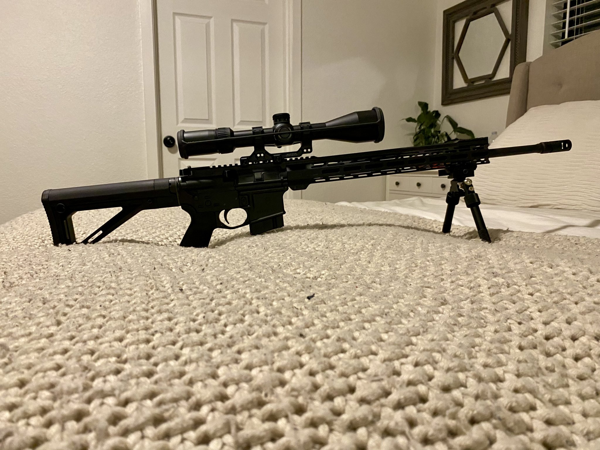

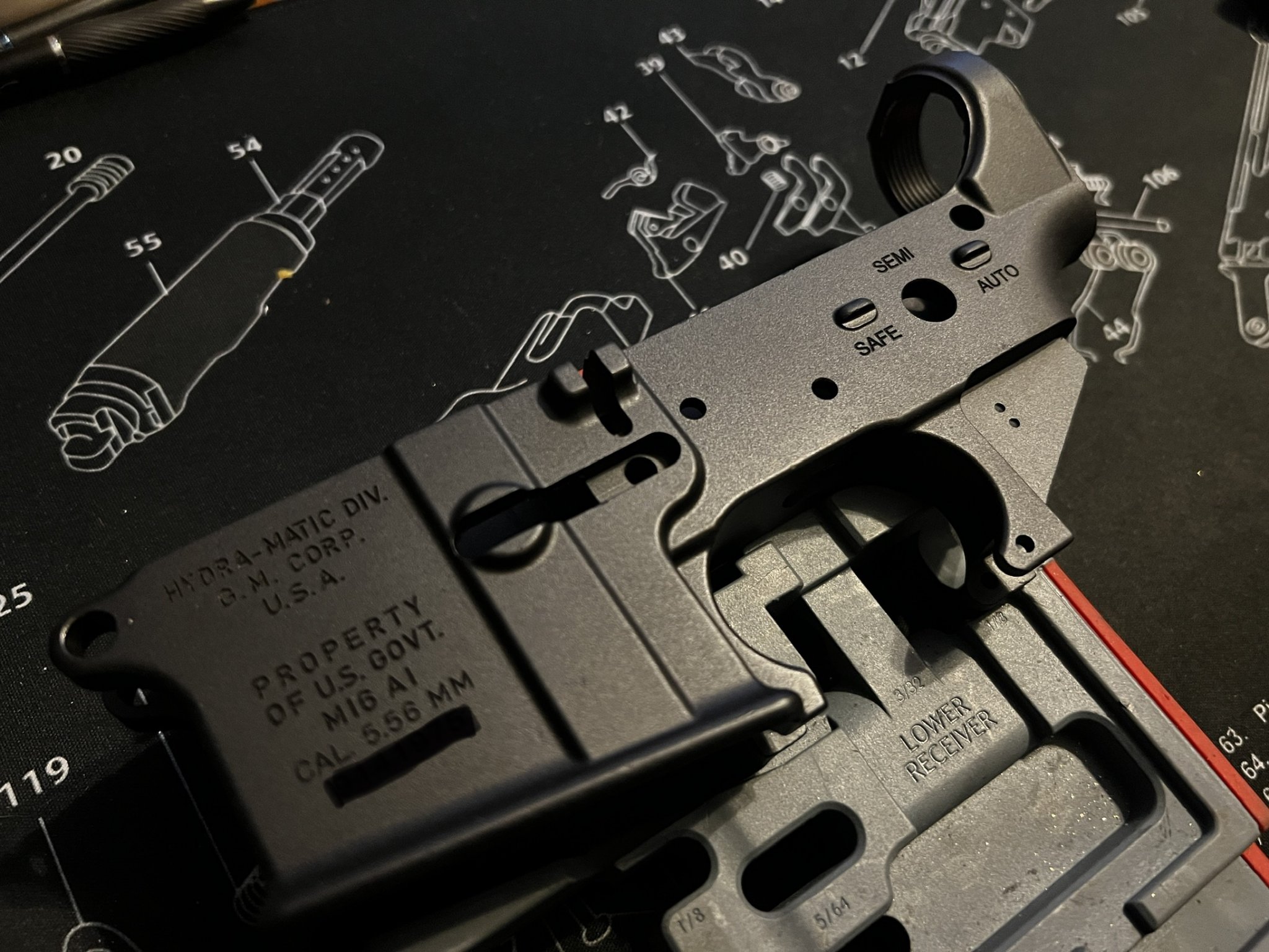

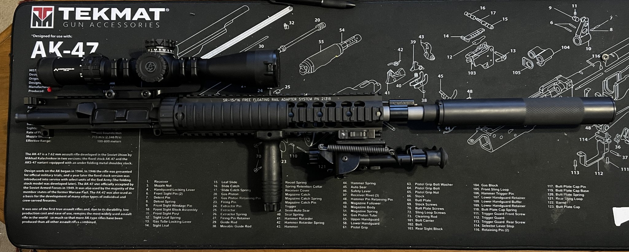

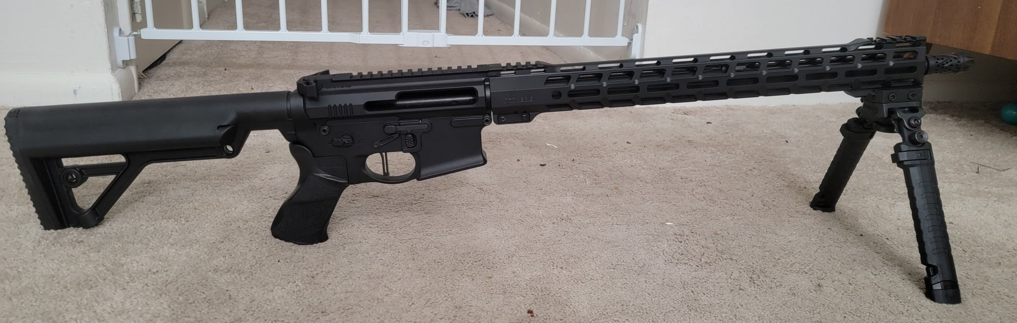

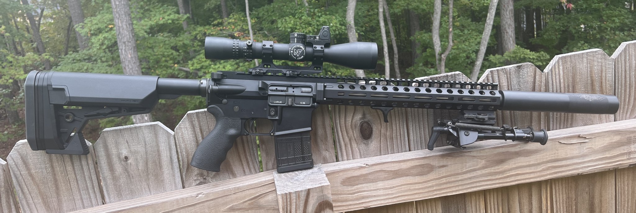

So I took mine apart. New stainless barrel, and new upper and lower receivers. I’m waiting on a parts kit to arrive to finish building it back up. I have a 6-rib Knight’s rail cover inbound as well for the underside of the pic rail. I went with a Rock River National Match 2-stage trigger for now. When the SSA’s go on sale again, I may grab one.

BKings is good shit. I’ve got 500 rounds of 6ARC waiting for a build. I’m tempted to grab the 18” BA barrel from BKings for $150 to play around with. BA barrel never did me wrong…accurate and quick.
Reactions: danr and Bluedog82
Worth a shot. My Rainier isn’t fully broken in yet but seems to be putting 108 ELDMs into an inch or so and costs twice what the BA does.
Honestly, the RRA is about 85-90% of the quality a geissele is.
Reactions: darkfader
Nice build. Currently putting together a 6ARC myself. What issues did you have with your build?
Barrel related QC and cycling. Gas system wasn’t cycling well. I’d recommend a VLTOR A5 system and adjustable gas block. Check the gas port with some pins and you should be good.
Had an undersized gas port on a replacement barrel after rounds were stripping material out of the bore.
Glad you got it figured out. My lower has a SOLGW A5 buffer tube and a Vltor A5H2 with their spring that comes in the kit. Also going with a Riflespeed adj gas block. Hopefully everything will work out.

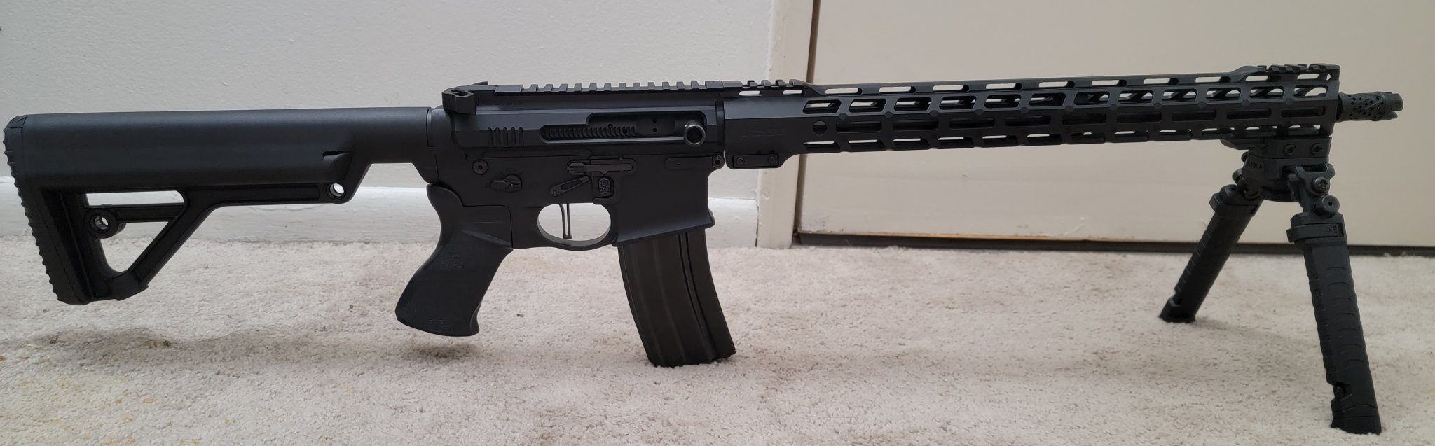

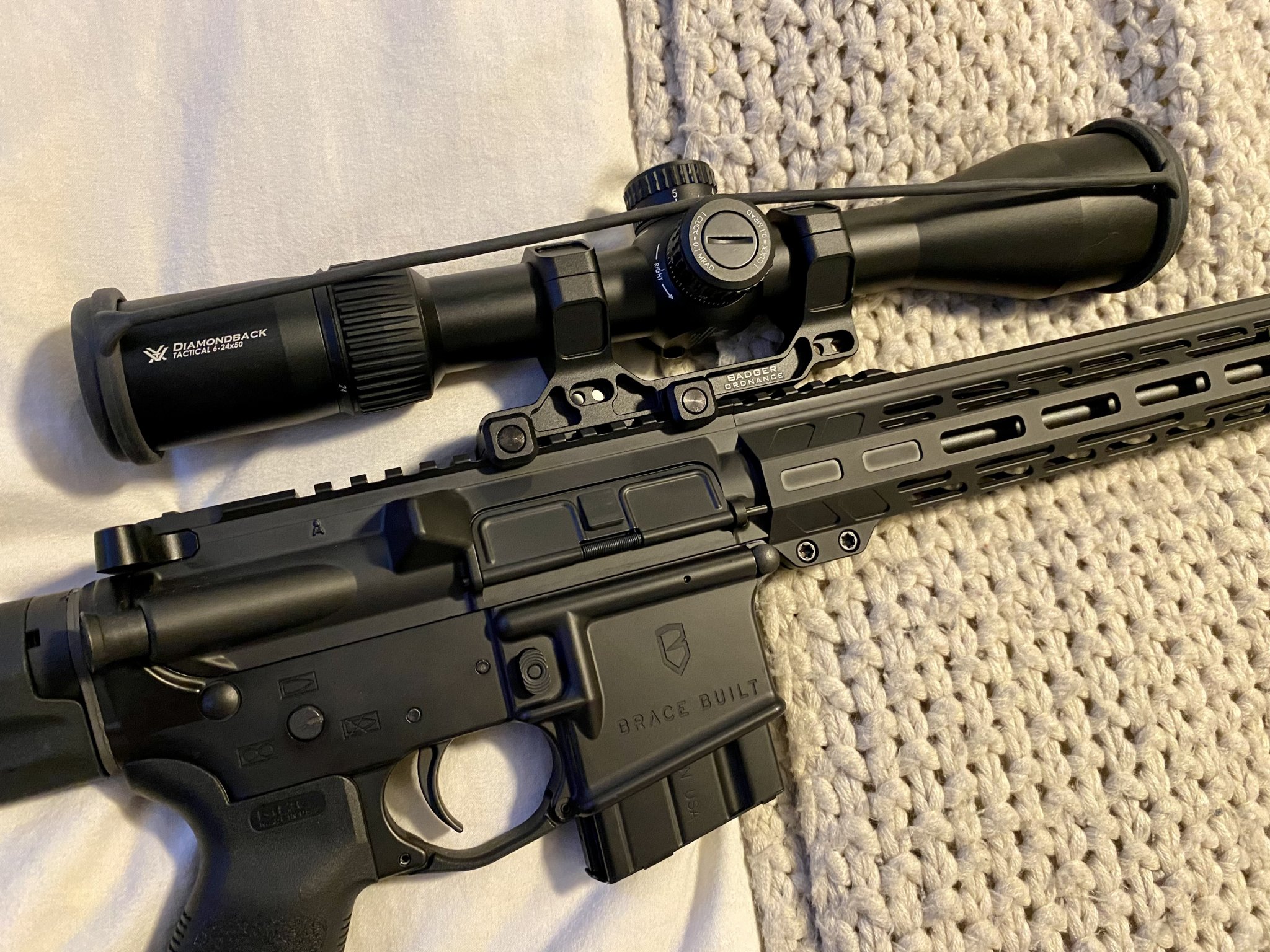

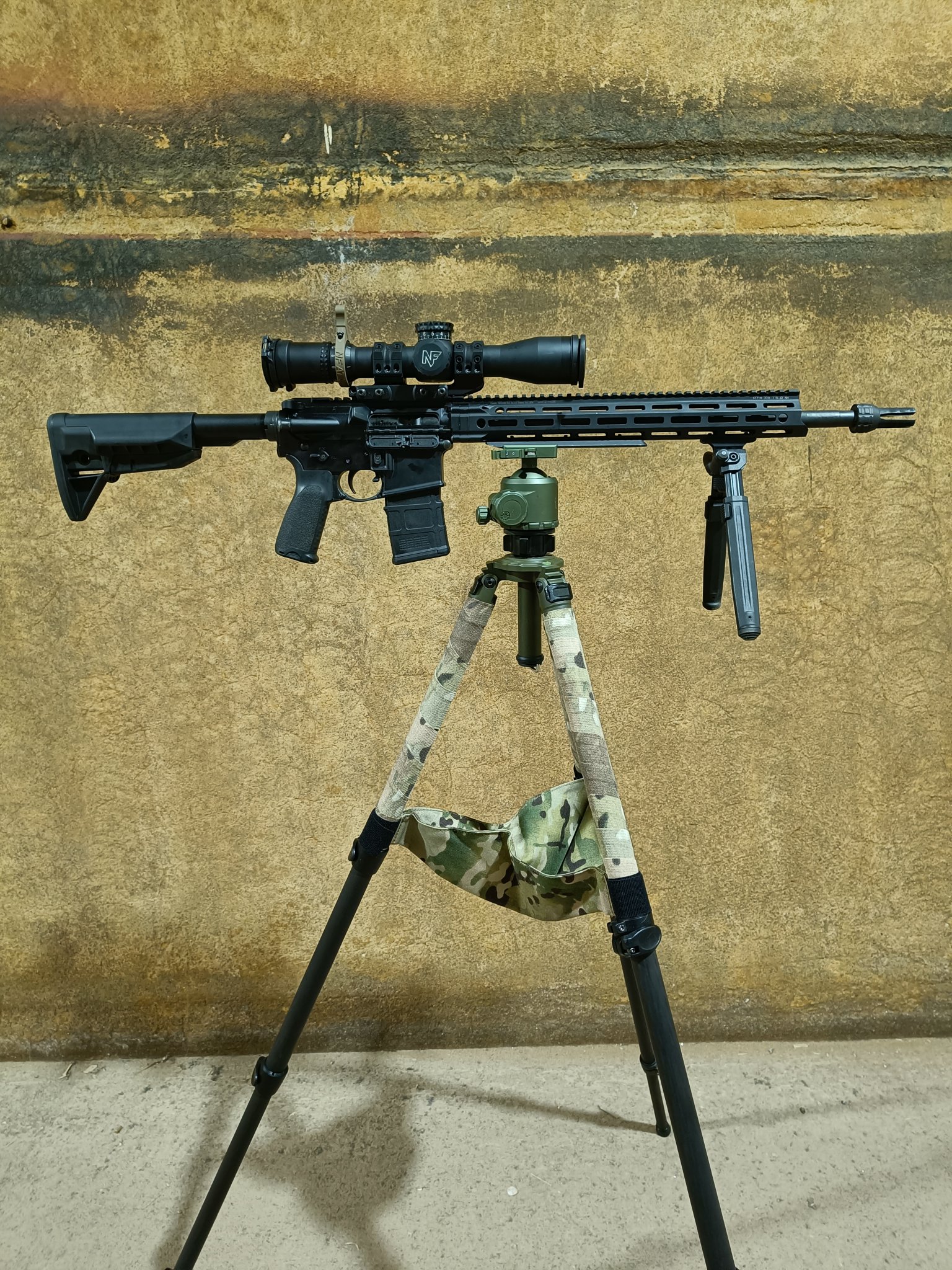

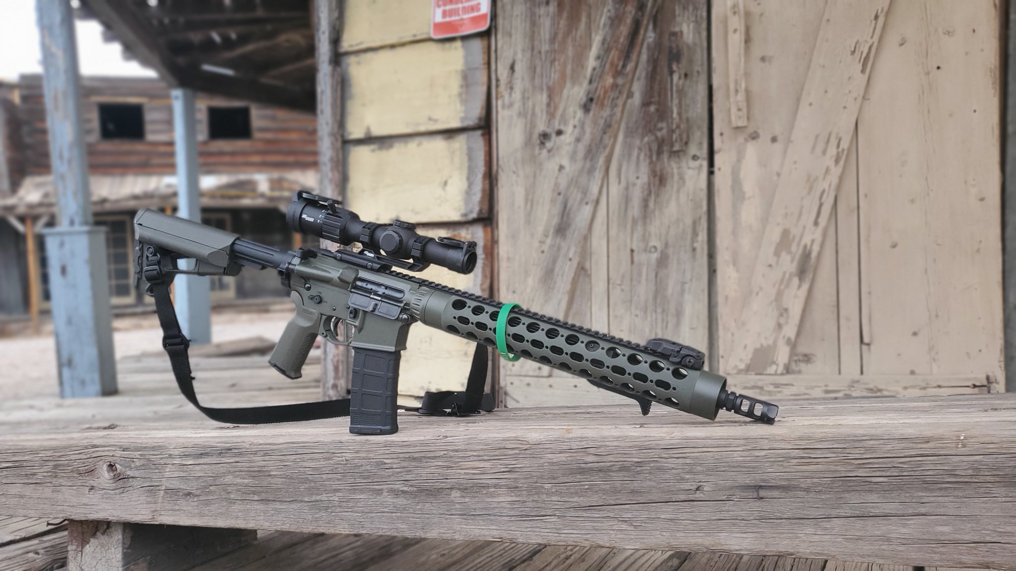

Basically finished my 6 ARC. Ready to shoot anyways.
Still want a K2+ or K2 XL grip. Badger Universal Safety to get selector on strong side. And a nice trigger.
Lower parts are Aero with Badger Ordnance Tactical Latch for charging handle.
Pretty happy with fitment on the Cmmg complete 20” upper and Brace Built lower. Zero play
Looking forward to seeing how it does

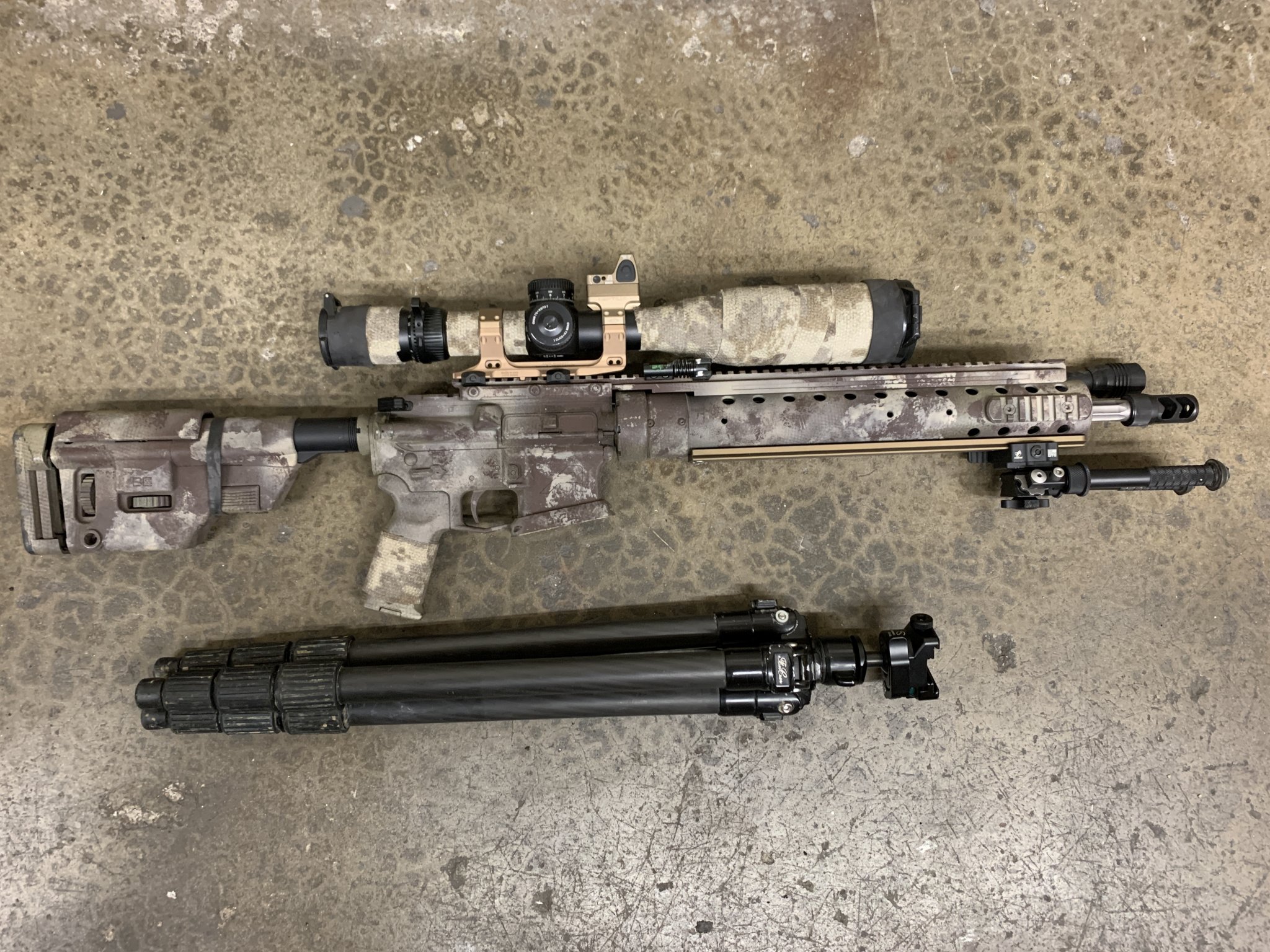

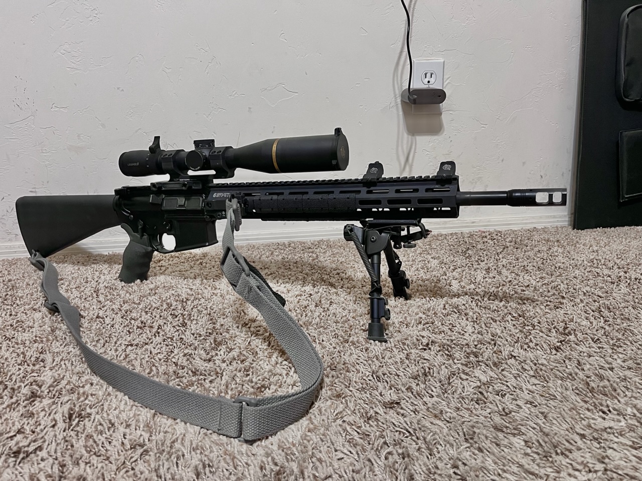

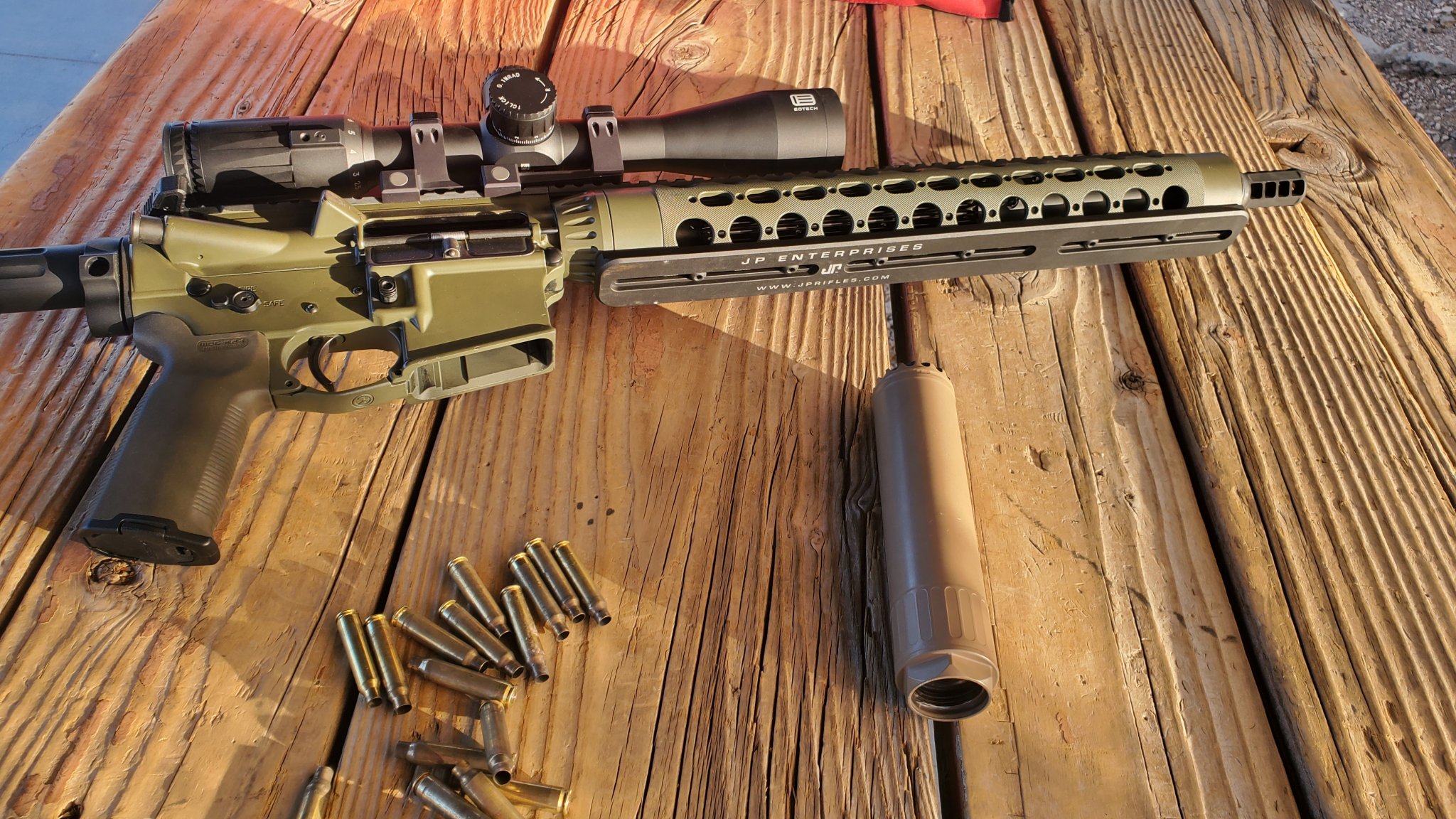

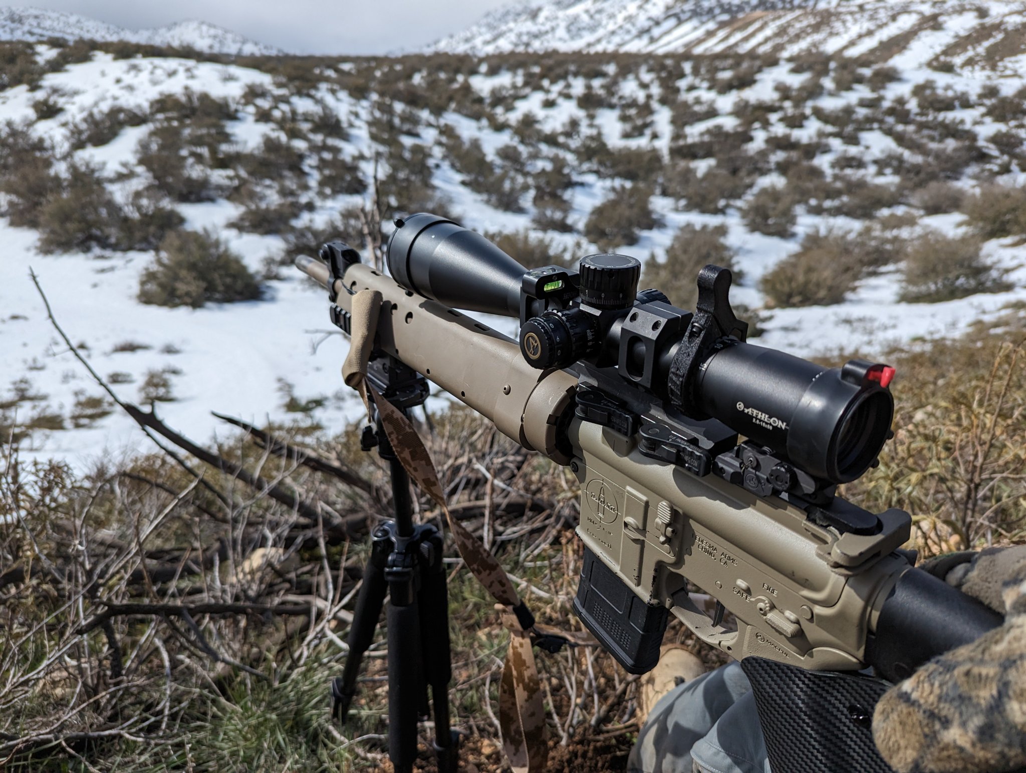

My CA-legal Mock12 (ignore the grip fin). I love the way the EF-X A1 stock mimics the angles of the Delta forearm. I can't wait to see how this thing runs when I get the Ops Inc brake installed. Also, the TriggerTech 3.5 lb trigger feels like it was made for this gun.
Don’t be embarrassed by the fin grip these days. Haven’t you heard? The cool way to shoot rifles now is without wrapping your thumb around the grip.
I hardly notice it when I'm calling coyotes in the field with it mounted on a tripod. I'll gladly take an ugly featureless rifle over a magazine-locked compliant gun any day.
But this thing is begging for a can and some fresh paint...

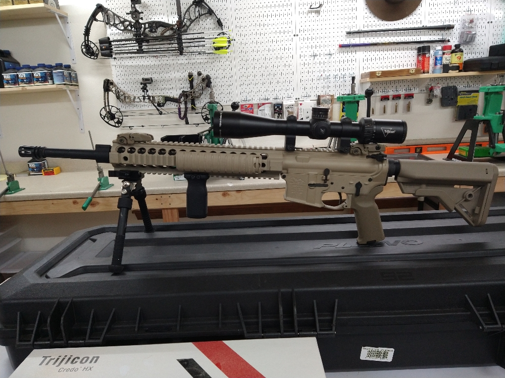

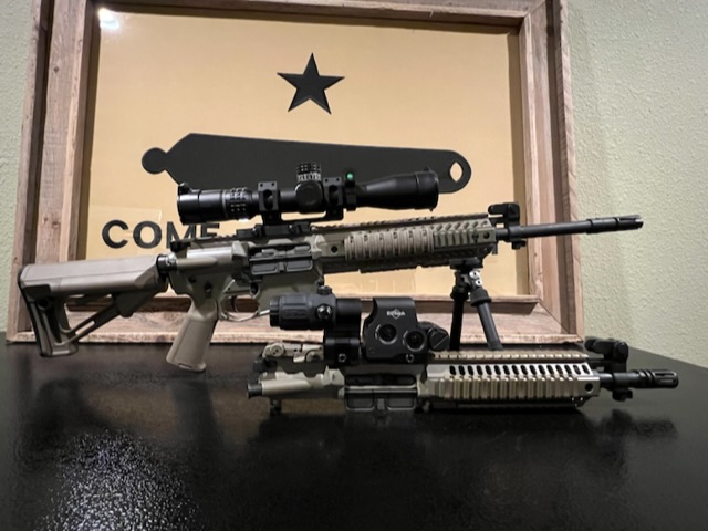

Up Top: Colt LE901 16” 308 monolithic with a 6943 monolithic 5.56 upper & caliber conversion kit.
On Bottom: LWRC M6
shout out for the LW M6 DMR. havent seen another in the wild before. mine has been outstanding out to 500yds with IMI 77. the little scope starts to fall short then
and the BA barrel one, cheap and does what i need it to. both at 1moa if i do my part.

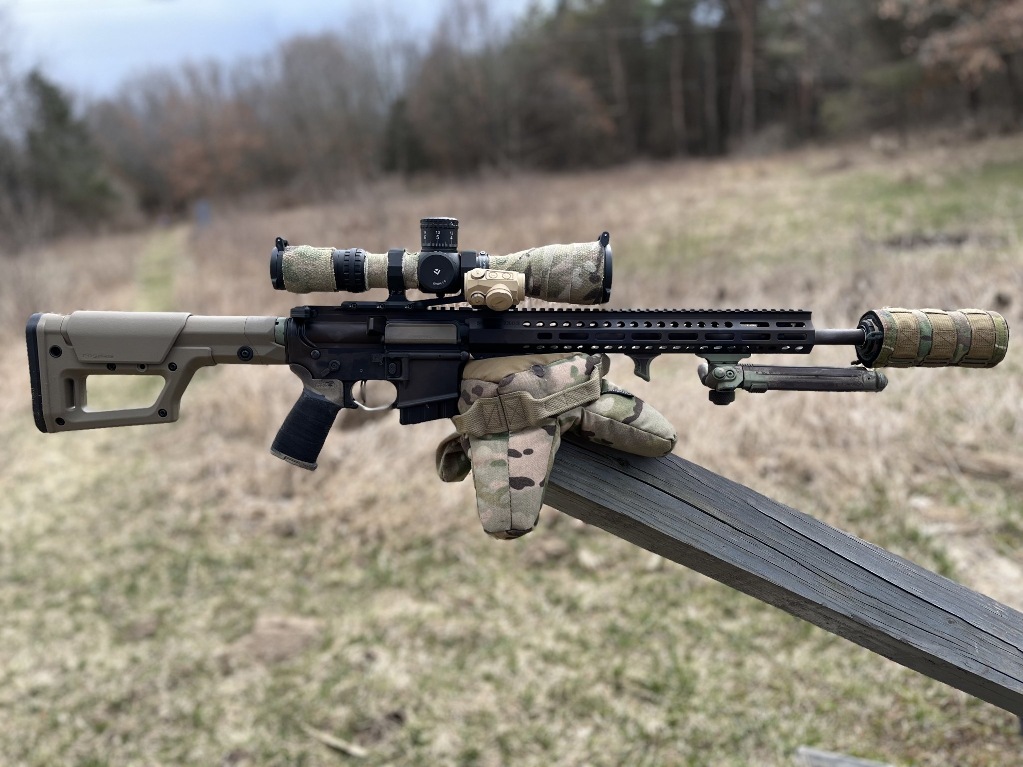

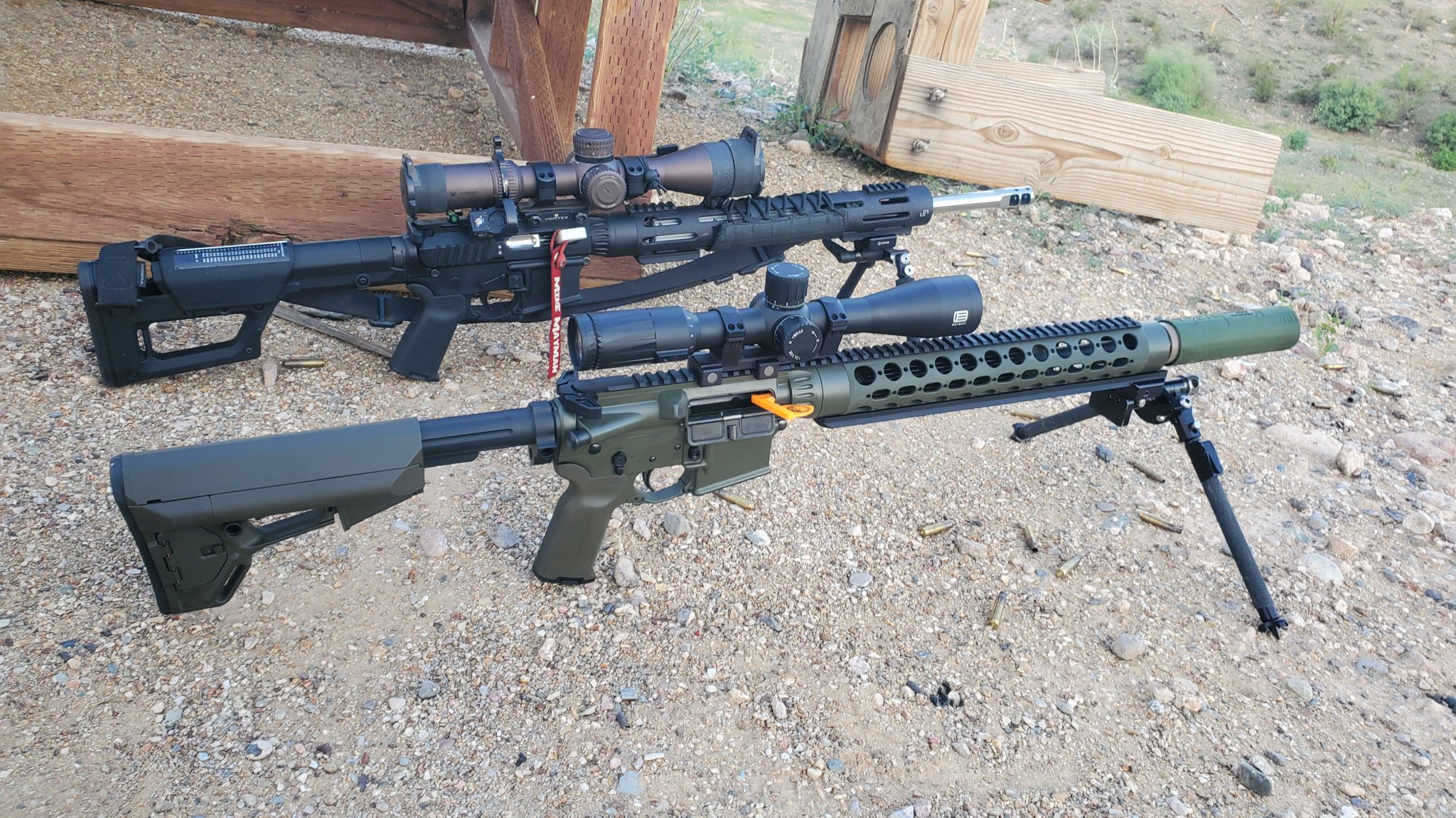

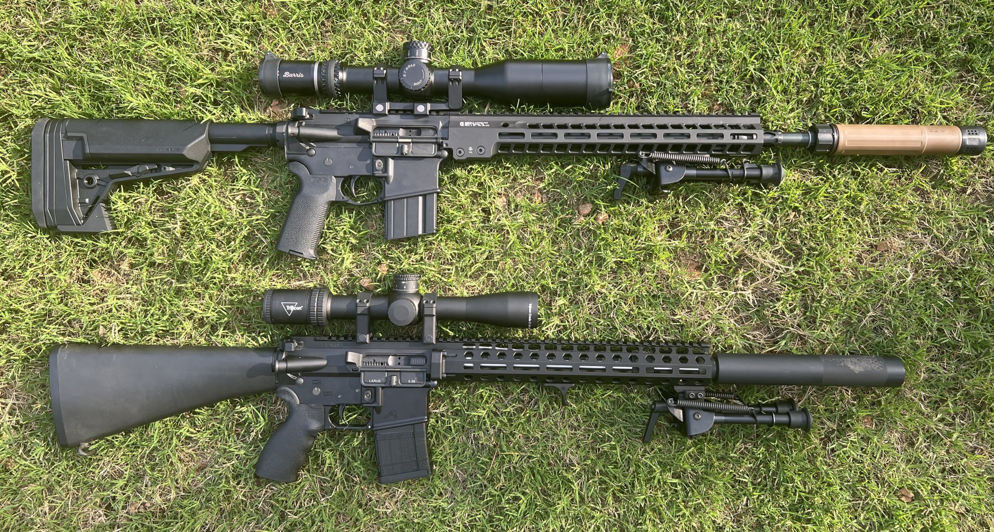

My SPR rifles. Both have cans on hold, 6 months waiting now.
GGP set, 16” Proof 308 CF

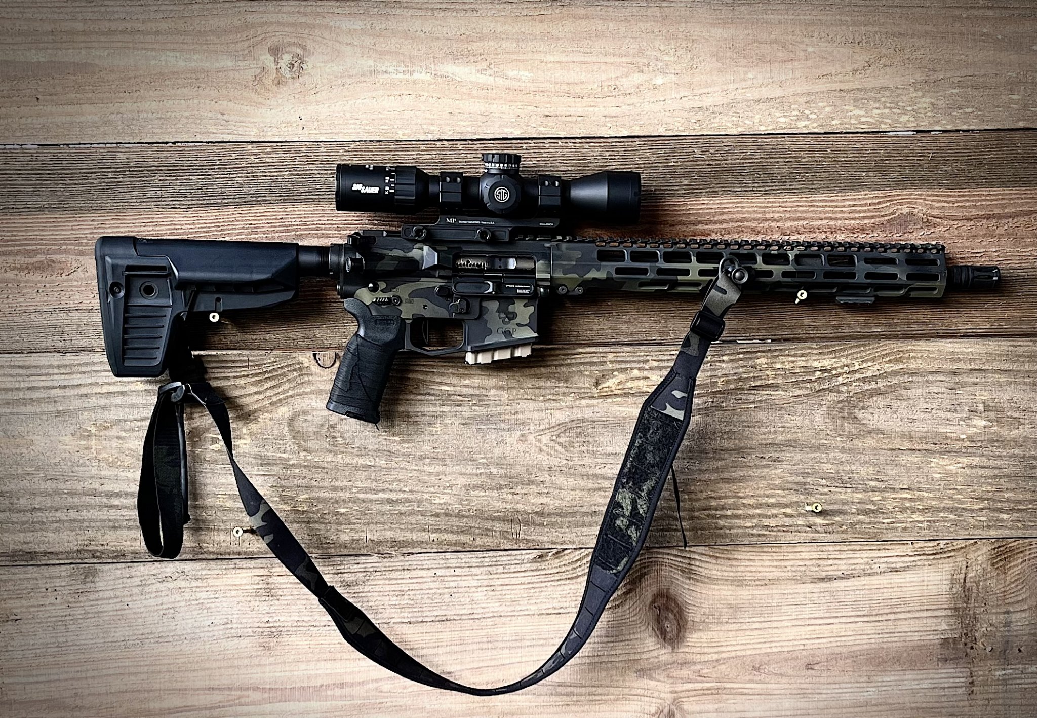

GGP set, 16” 223 Wylde Douglas by compass lake. Probably my overall favorite rifle and is in my truck daily on the farm. I just switched it from a Pst ii 3-15 to this Whisky5 recently and really like it on this particular build.
