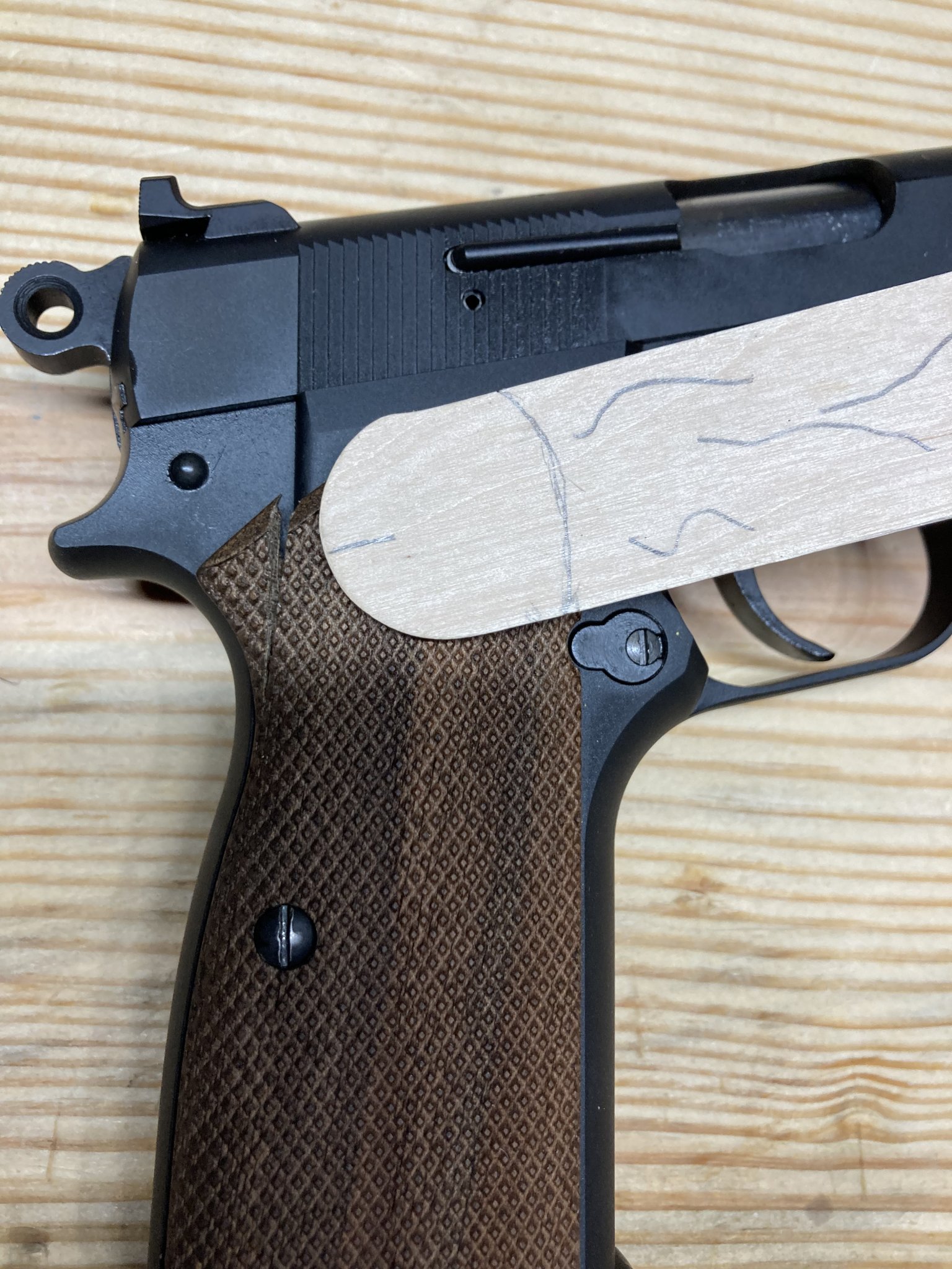

Something seems a little off here…oh, and the screw came buggered from Springfield. Figured they hired the old lady from Colt that was over tightening grip screws from 2011-2015.
  • Sad
Reactions: pmclaine
That whole grip appears to be suffering "crackage".
Do you know anyone that can make grips?
Yeah, Hogue, lol. Have a set of checkered Cocobolo grips on the way. The $75 spent on Hogue is about $300 cheaper than it would cost me to make a set due to wasting my time, lol.
I’ll also be emailing Springfield to get a new set of Walnuts. When I put the grips on, it was a slight interference fit right there so not surprised.
This is my punishment for not using BLO.

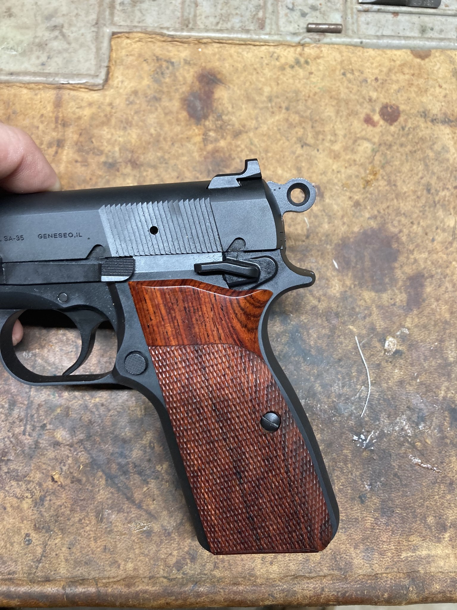

Got the new grips in. Nice cocobolo, and dirt cheap at $75. They don’t fit as perfectly as the factory walnuts, but good enough for me. Beats the shit out of having to make a set, lol.
Cocobolo grips look great. Let us know what the sight dovetail is and what new sight you go with.
