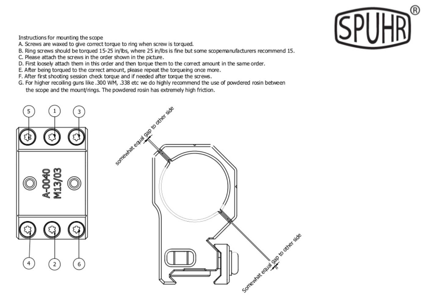

followed this pattern. Started with finger tight, then torqued to 15 inch lbs with Fix It Sticks, final torque with Borka Tools not exceeding Kahles specs. Parallax seemed okay even before the parallax ring was attached.
I am highly surprised and I really want anyone who have this issue to contact Randy and change the mount.
We haveto date NEVER got a single return for this issue and last years production have been in excess of over15000 mounts per year.
So I really want to get hold of mounts with this issue so we can measure the mount in measuring machine.
The only feedback I have got so far is from Tangent Theta, who changed their torque recomendation to 15in/lbs.
I have a TT here on loan from them and I have not been able to do it, that scope refuse to bind:)
so appearantly very very few scopes have this problem and only good way to start somewhere is to measure up the issue mounts to see if there is an issue with roundness or dimension.

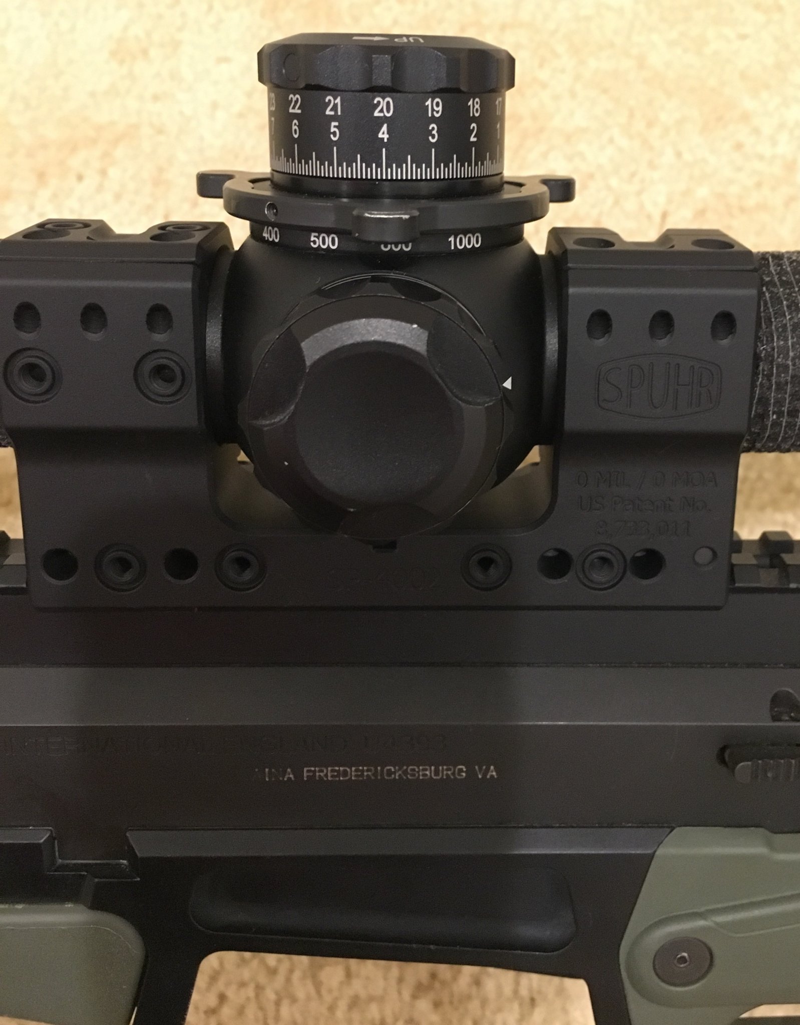

Reading this, I got concerned for a sec cause I just remounted a k525 in an SP-4001 and didn't check the parallax wheel. After pulling them out of the safe, my 525/624s don't have any issues. Little friction at the minimum settings but nothing of concern. Pic rail bolts torqued to 45, ring bolts torqued to 18. All in SP-4001.
Reactions: deersniper
Random thought - noticed yours and the other guy who posted a pic with issue seem to be RSW? Mine that don't have an issue are LSW. May not be anything but just an observation if I'm looking at the pic correctly.
My K525i has zero friction at any setting. Nor my K318i either unmounted or in their respective ERA-TACs. If there wasn’t friction before it might be something to analyze.
Only my 624 has friction and it’s the last 1/4” of turn to minimum 50yd setting. Not going to worry about that at all. 525 has no friction. I need to buy a 318 for another rifle and it will also go in a spuhr when I get it.
I could send you the SP-4002 that bound up my Tangent Theta, it's been sitting unused in a drawer after the mounting failure. The solution I was offered via phone call was to remove torque, but it bound at <15 in/lbs and I was reluctant to go lower. Not sourced from Mile High, by the way.

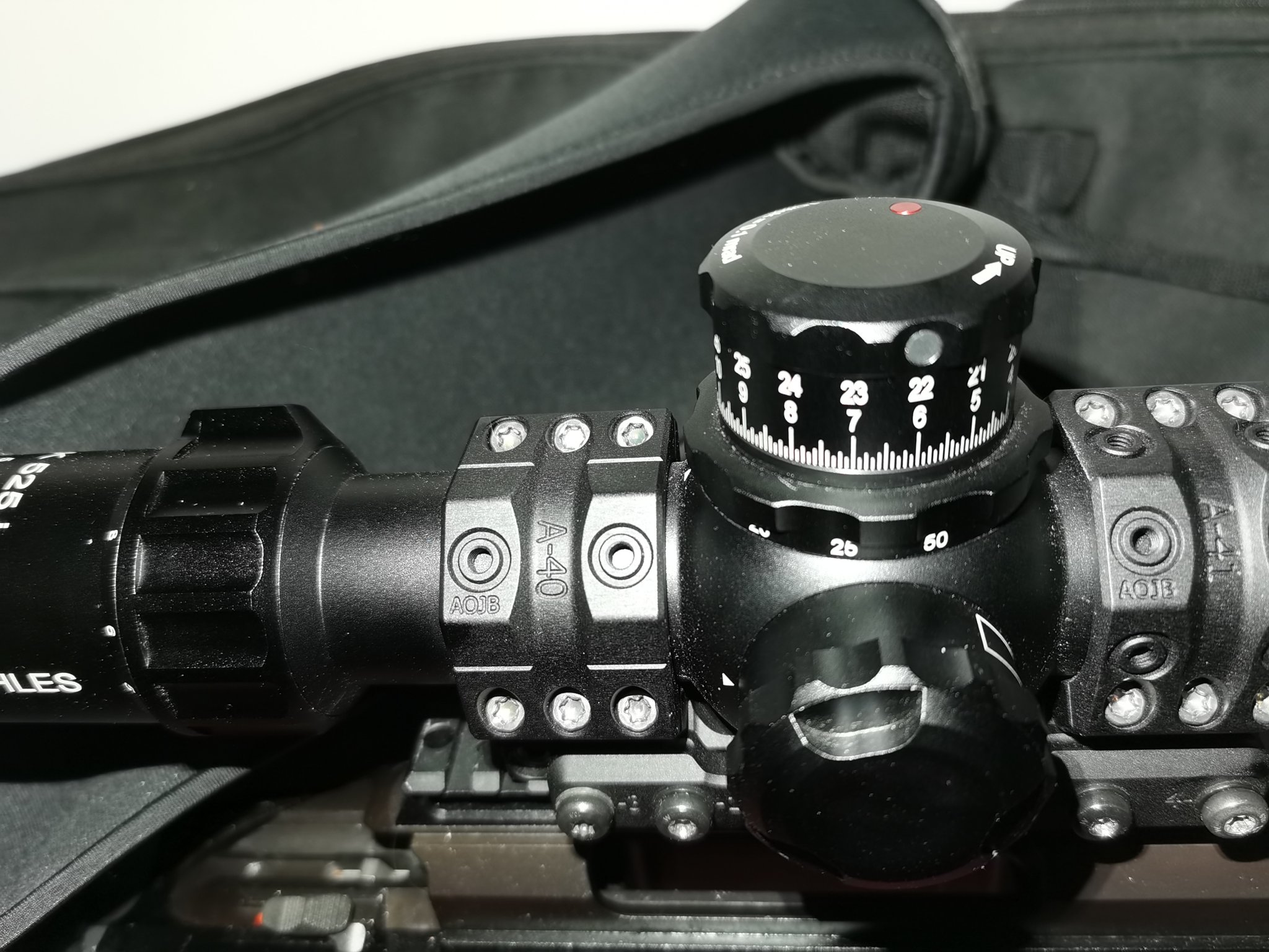

Picked up a 318i threw it in a Spuhr and what do you know? My paralax is bound at 12-15 inlbs...pulled the rear most front pair of screws and it's good to go. Even finger tightening the back two on the front ring it will not turn....
