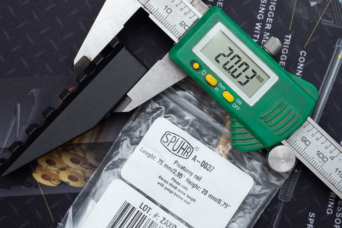

I was on the Spuhr site - https://spuhrwebshop.com/en/accessories/rails/ - and it wasn't clear on where the height measurements are taken for the rails (no schematics for any of the rails)
If it says height of 10mm, 14mm, etc., is that measurement taken from the bottom of the rail to the very top of the rail, or is that from the bottom of the rail to the bottom of the picatinny rail groove?

If you compare one of the lowest height accessory rails to the 1913 specification you'll see that there is a minimum .367" clearance required from the bottom to the top of the rail. Given this looks roughly the same as the product I linked, it would make sense to me that the height numbers are all to the top of the rail in the manufacturer's height specification.

I ended up getting one sight unseen. The measurement spec advertised by Spuhr is from the bottom of the rail to the very top (top of groove).
