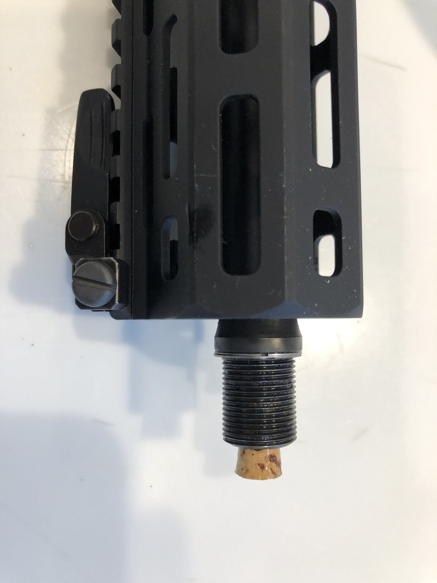

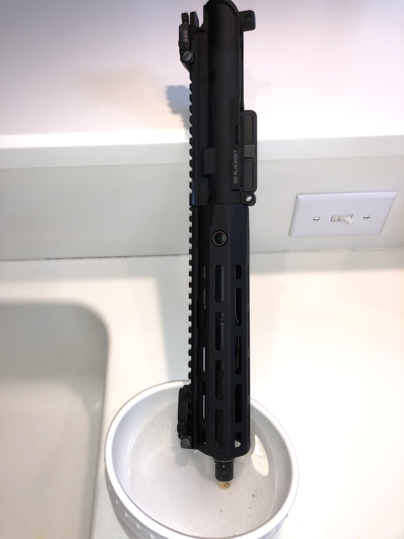

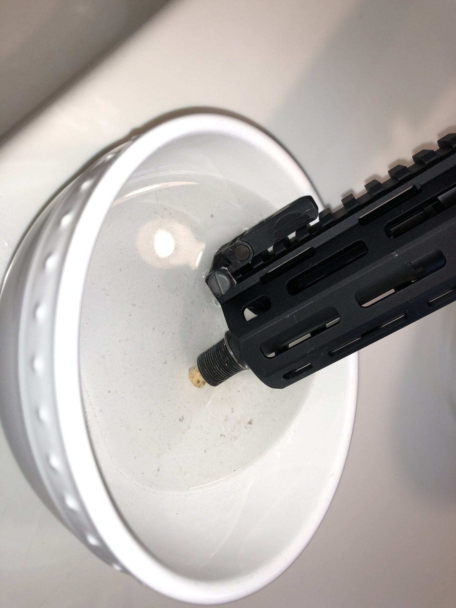

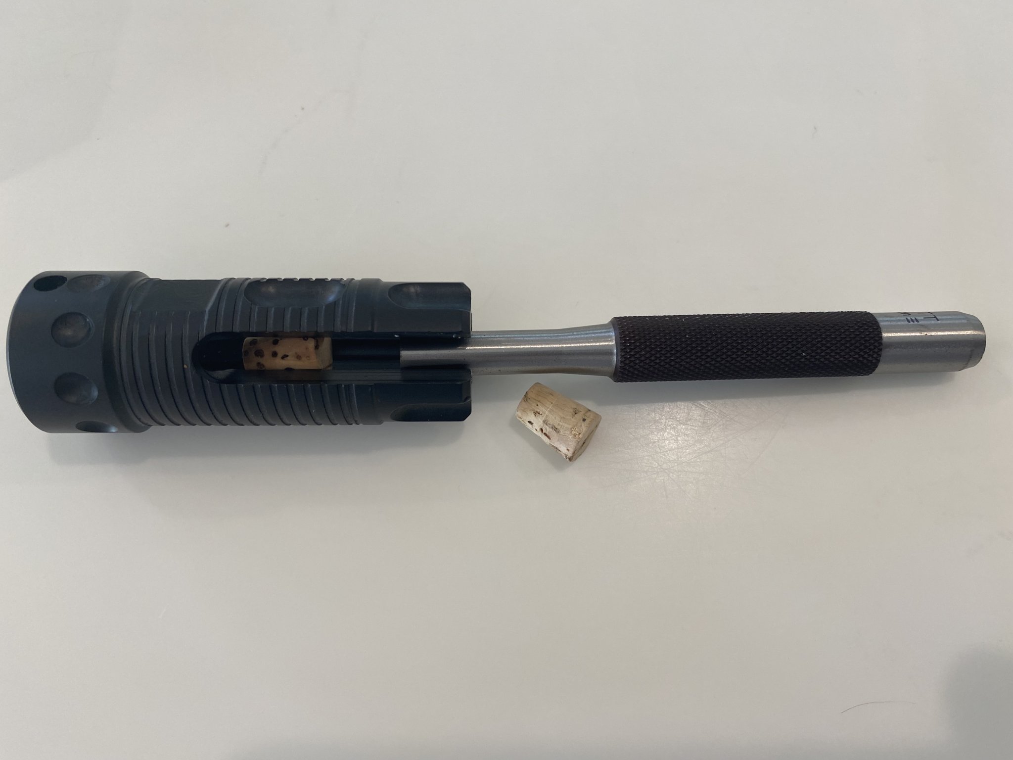

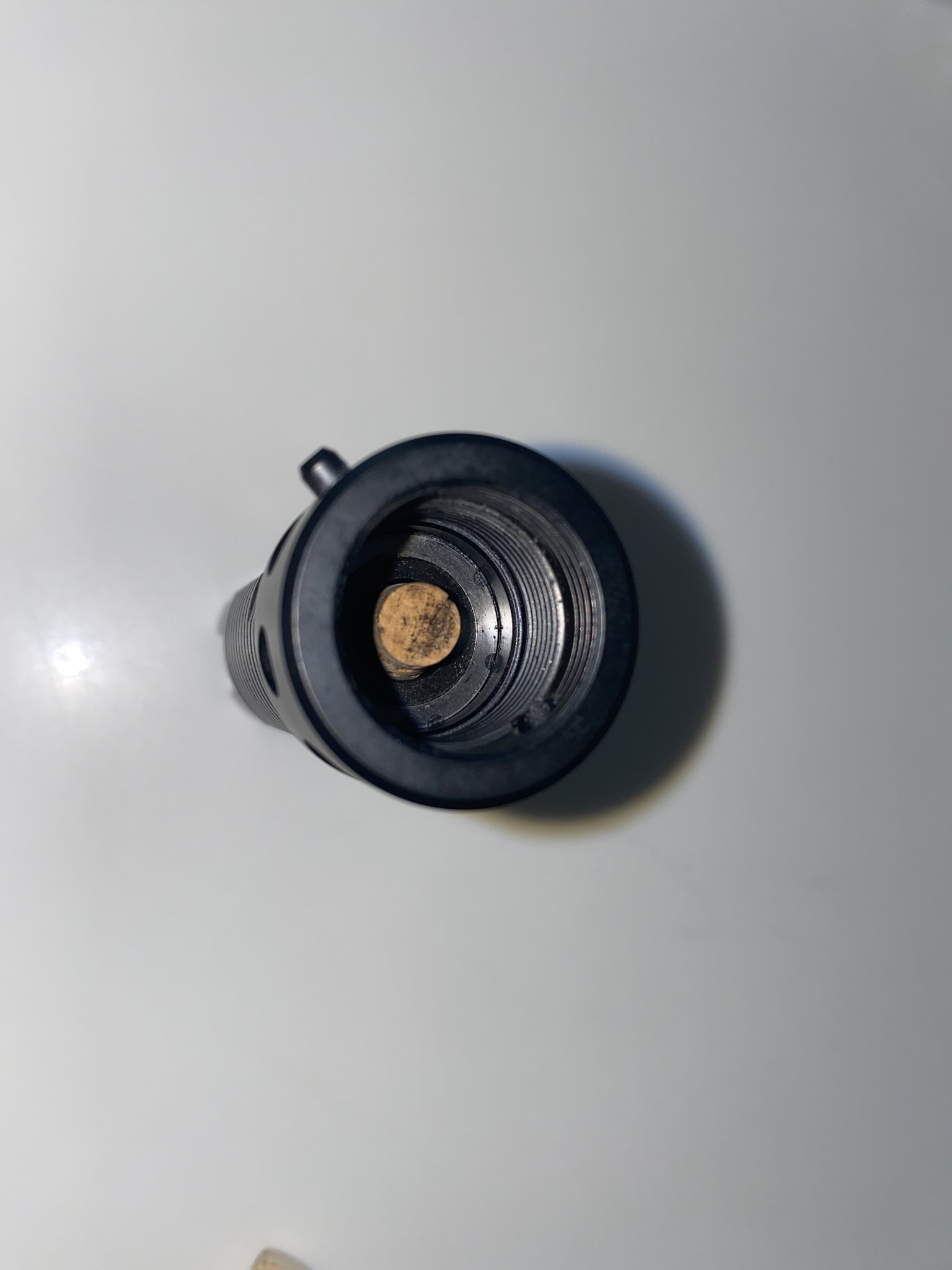

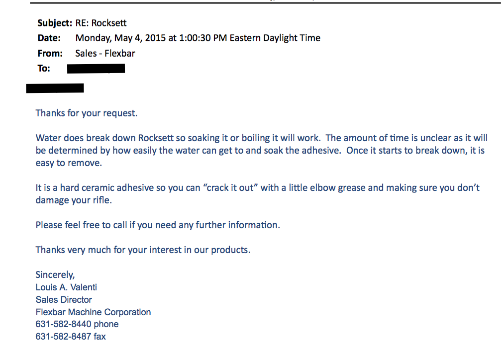

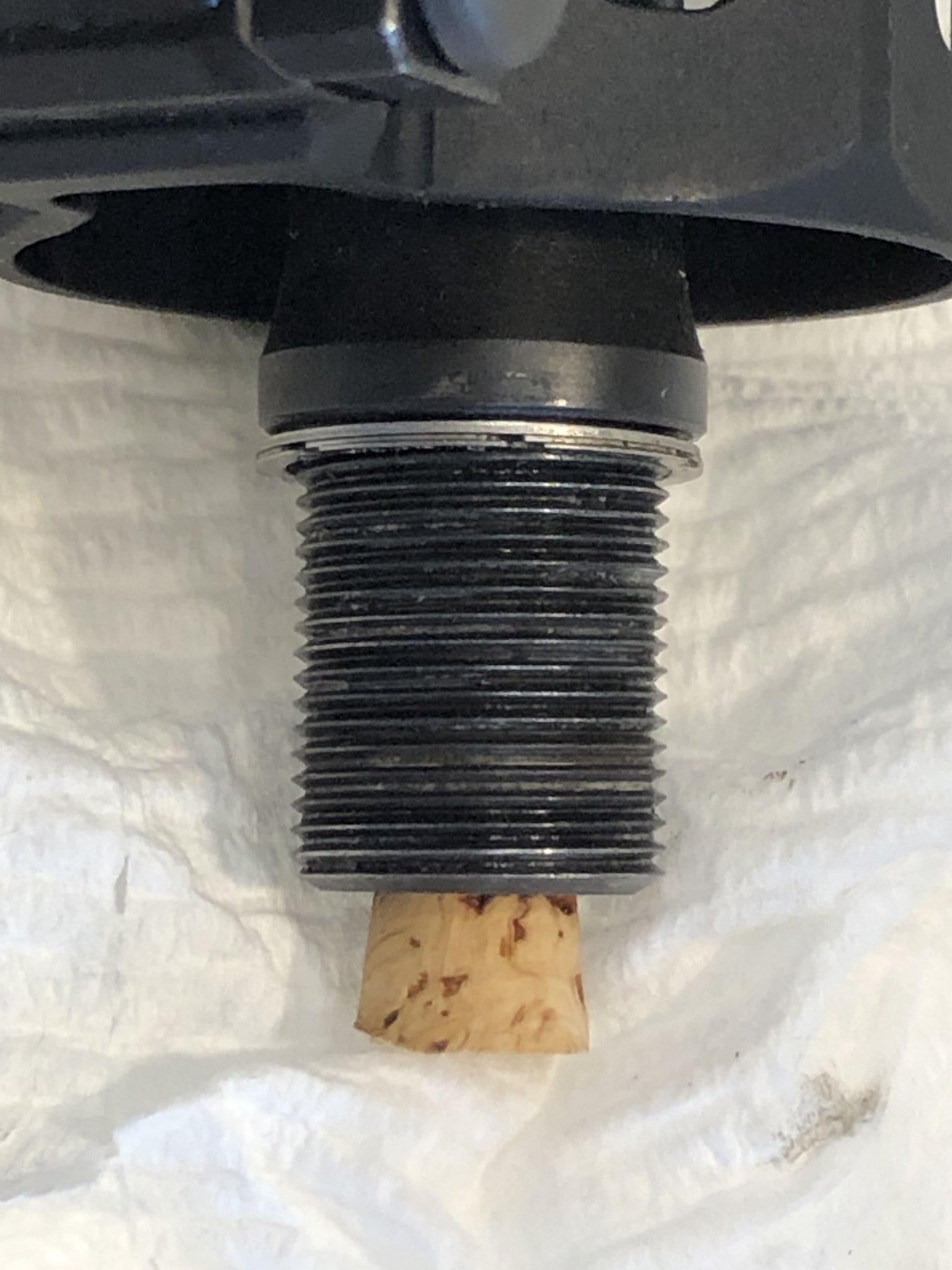

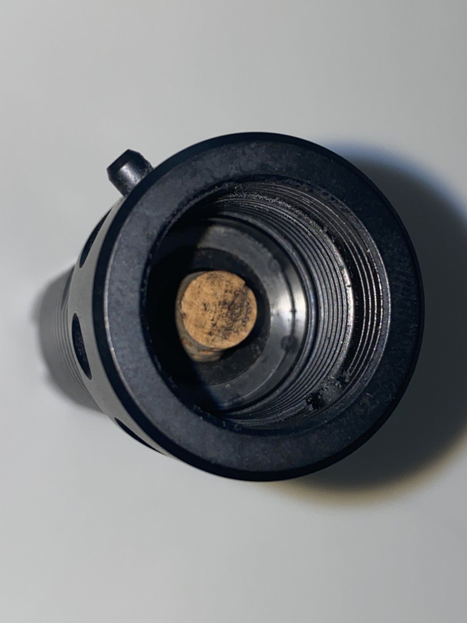

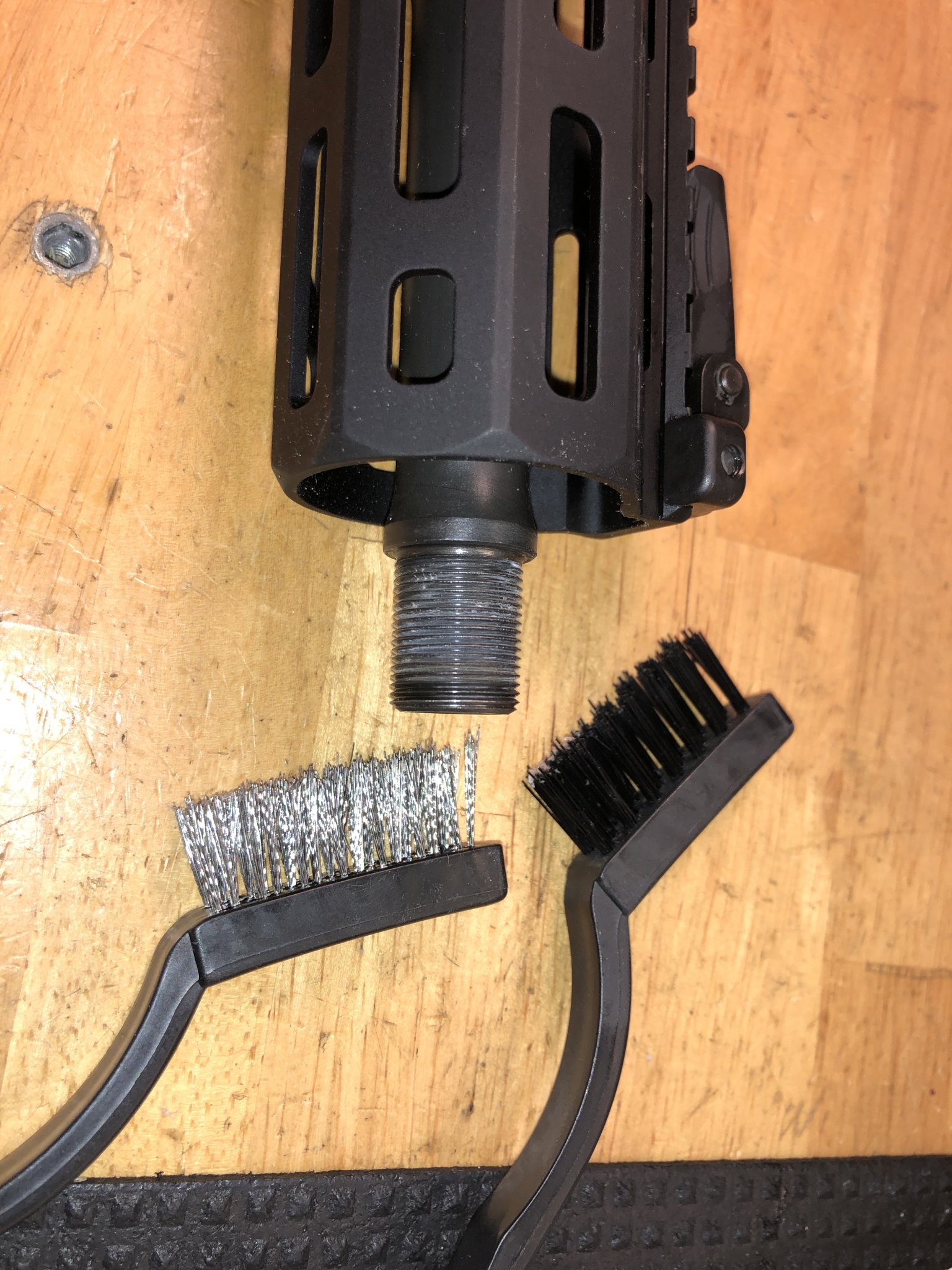

I use the microwave to heat the water, cork the barrel if worried about submerging the lining in water.
After the device is removed, same treatment to easily remove the residual adhesive from the threads.

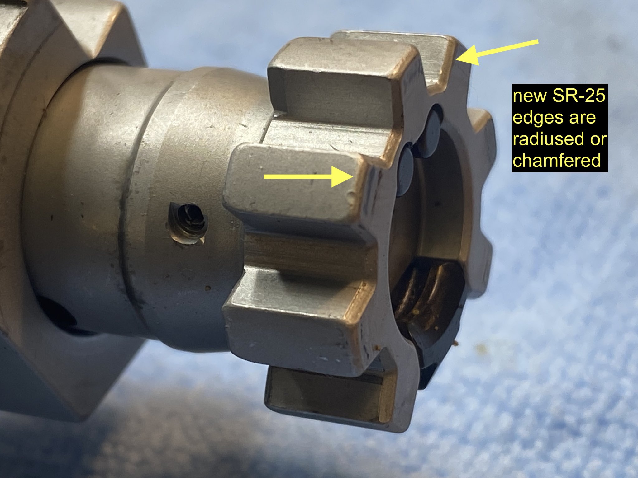

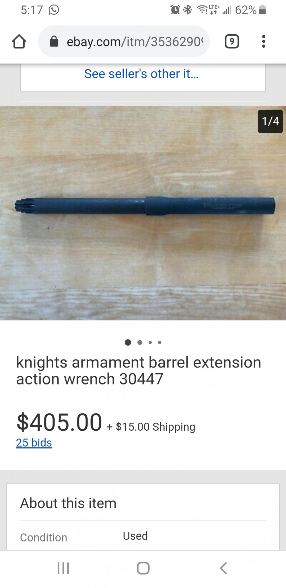

We haven't gotten a straight answer in the thread, yet. TheOE800 has told us that the thread has misinformation. These guys are all over the place. strikeeagle1 tells us we need a special rod with radiused lugs, even while he shows us a picture of the Geissele rod with the square lugs.
I think that the sr-25 is good to go with a standard AR-10 style Rod. As you can see from my pictures, the Geissele Rod specifically states sr25 on the stamp next to ar10.. I purchased mine after reading a different thread at some point that led me to believe it would work, because I could never find the Knight stick.
I think the sr15 is the one with the special bolt lugs that requires the proprietary KAC action wrench/Knight stick, as TheOE800 stated.
Have you or anyone reached out to KAC tech support/service for an answer to this question? Or perhaps engage J Lueba on FB or other social media platforms? Or even KAC licensed armorers such a Operation Parts, Presample Depo or NS Defense?
Seeing as how I don't have my Sr 25 yet, and I already own the reaction rod, I'll hang out and wait to see if anybody addresses it before I bother Jack or anybody at Knights. Perhaps someone else can chime in.

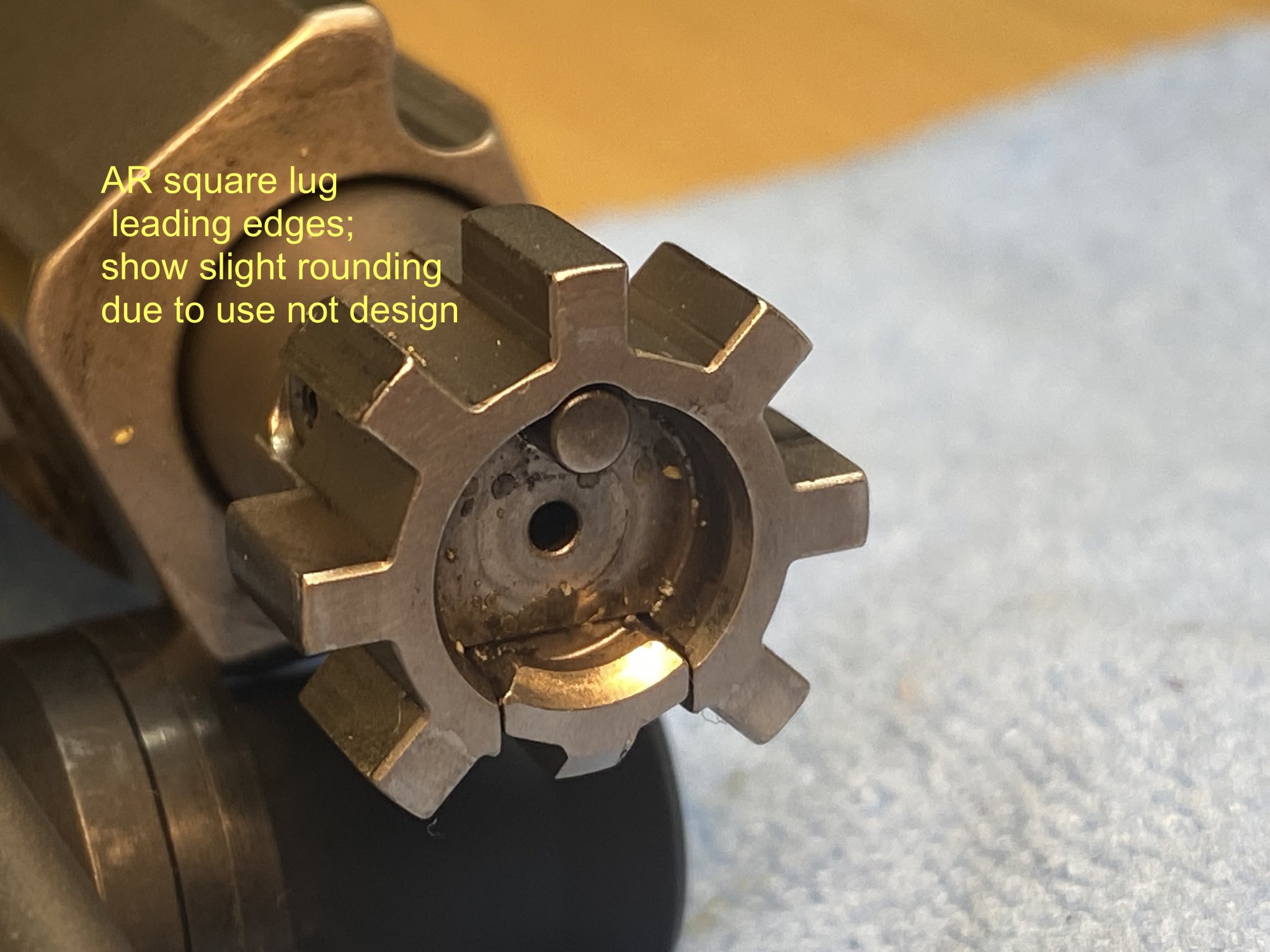

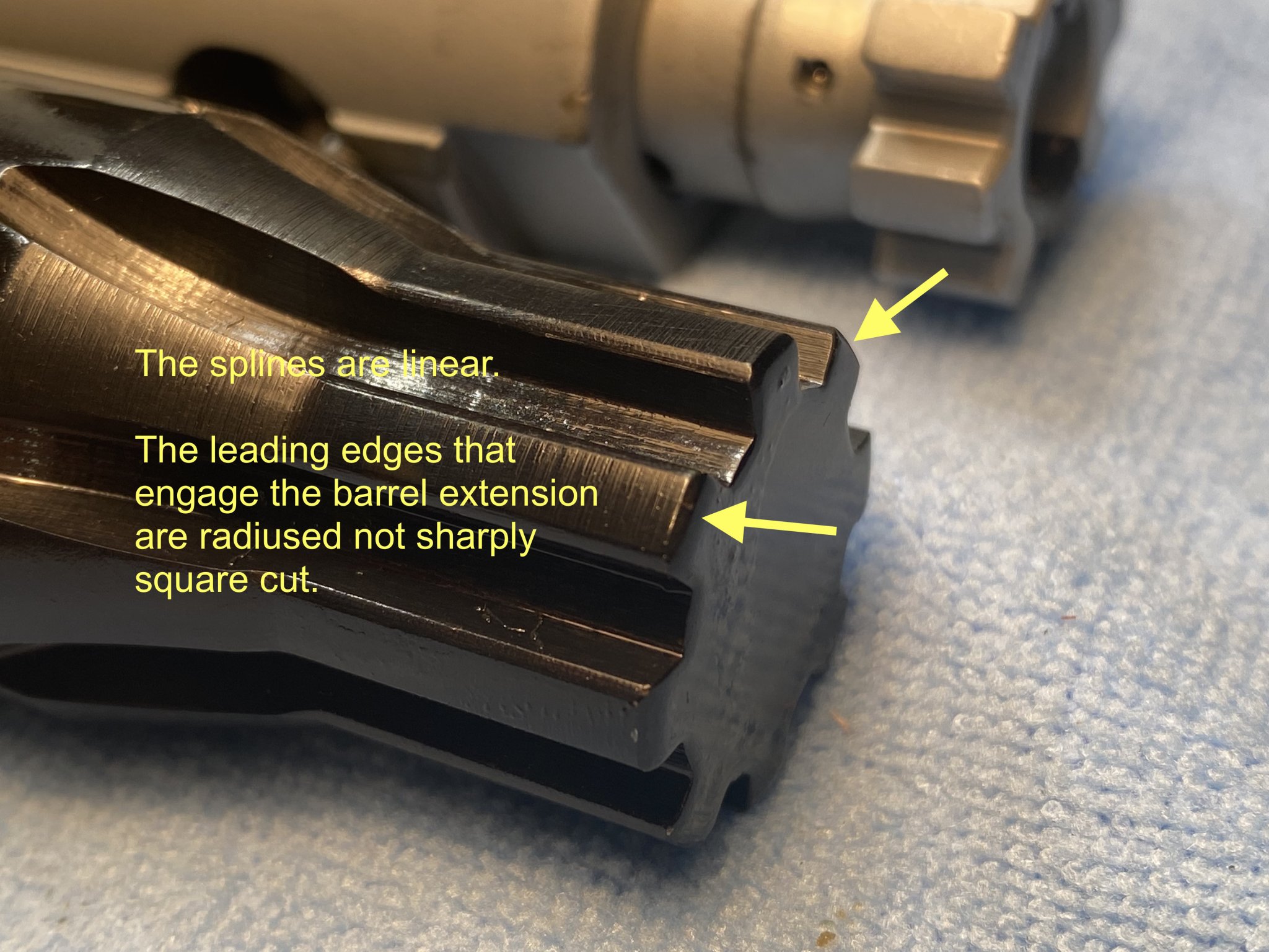

I am not telling anyone they need a special rod ......the manufactures of the tools (Geissele and KAC) recommend using the proper tool to avoid damage to the tool or the barrel extension in specific bolts!
It's not my picture.......it's Giessele's ad!! in which you cannot see the detail in question.

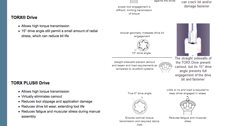

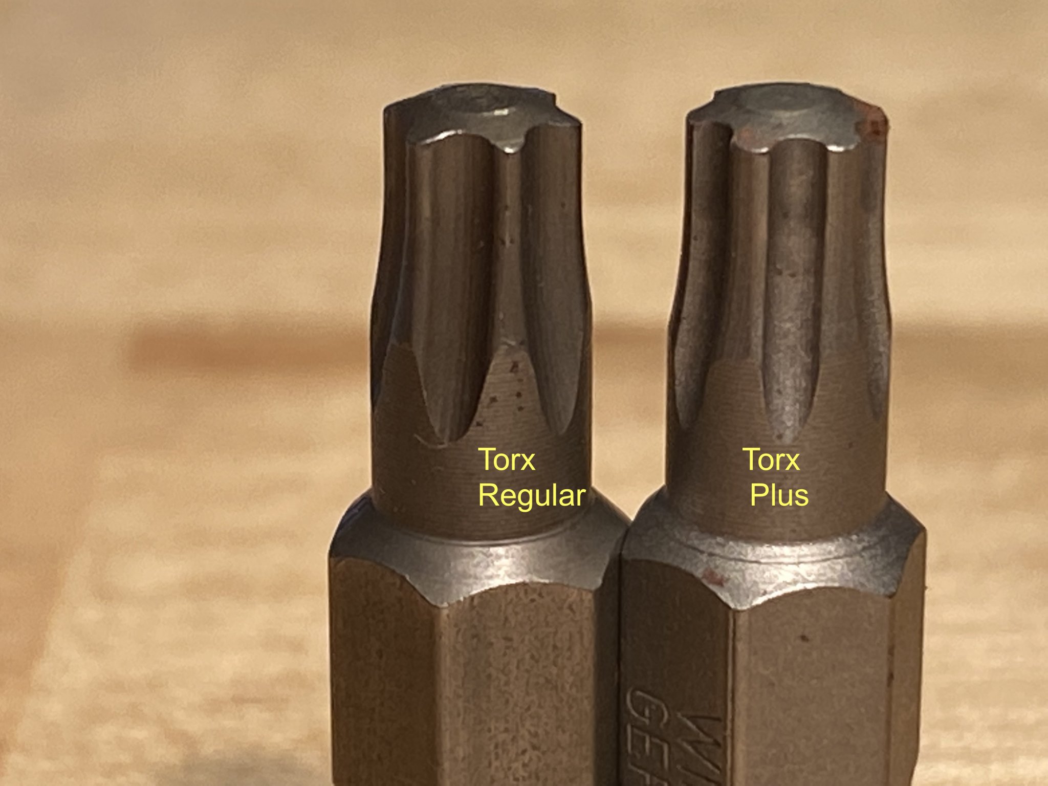

The leading edge of the recommended barrel extension tool has the same profile as the leading edge of the bolt, it's subtle but real. Kind of like the real difference between a Torx bit and a Torx-Plus bit, it's in the fine details. The improved design with radiused lobes extends the Torx tool life and provides a better engagement with the fastener, just as advertised with most recent KAC bolt edge designs.

Rocksett’s official documentation says to pee on it and it comes right off. Their compound reacts with the nitrogen in the urea and will immediately unset and come right off with minimal force.
