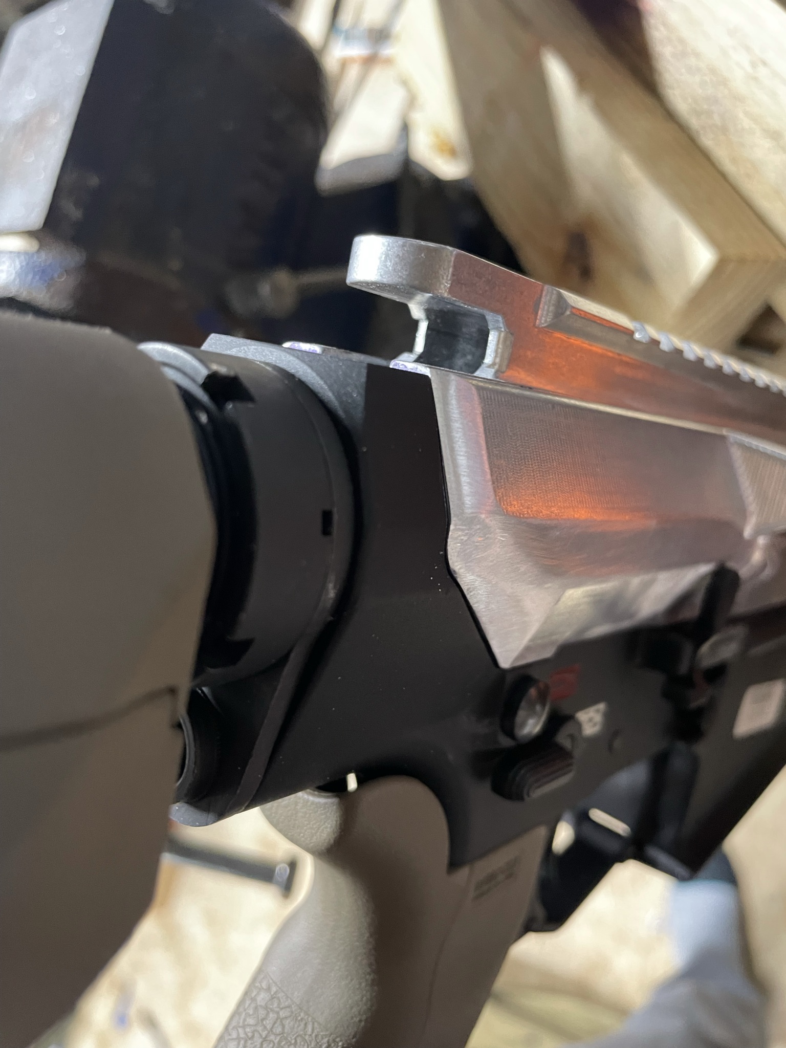

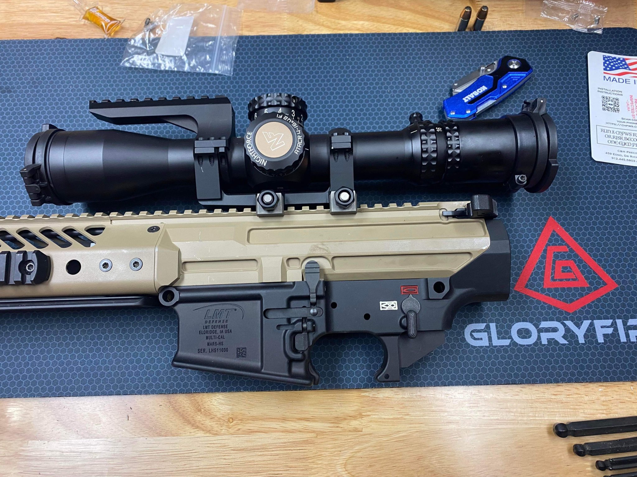

So after doing some quick compatibility research, I ended up choosing an LMT lower receiver as my starting point. I found a blem MARS-H in stock at Big Texas Ordinance. And this is where the issue started :giggle:. Upper receivers with a Armalite "slant cut" and DPMS High compatibility were not readily available for this pattern. I decided to set out to find a an upper receiver that I could use with my LMT lower, DPMS High handguard of choice and DPMS internals (barrel, bolt, carrier ect.) and I preferred to have no forward assist.
I have been able to test fit Stag, Seekins, Mega, LMT and Knight's and a few other brands with varying success and ultimately found pretty much what I was looking for. A long the way I created a spread sheet with the information I gathered to help others with similar objectives. If you can add to this I would love your input, feel free to comment and I will add as information as needed. There are no resources for SR-25 compatible manufactures as far as I know, but we can start here.

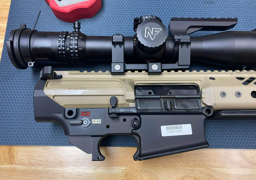

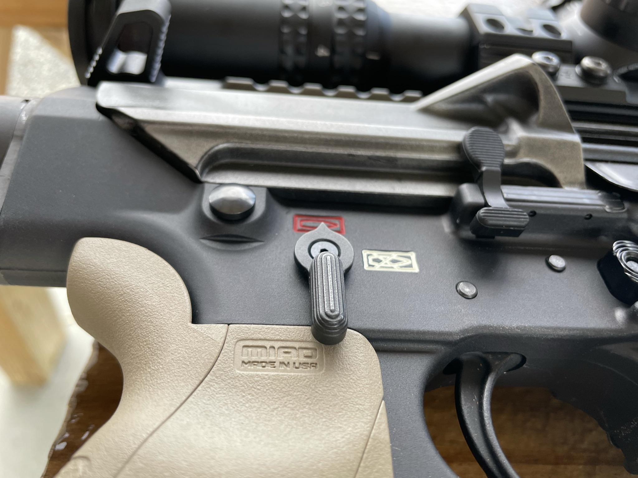

LMT MARS-H: Probably better than Knight's if I am honest... the best Ambi in the business and that monolithic design has a lot going for it. Only drawback is the proprietary barrel system. There is just one guy (I am aware of) who makes custom barrels for these, that's not great for longevity. On the other hand, Everyone who makes barrels is making DPMS compatible barrel... so LMT is a hard sell for me.

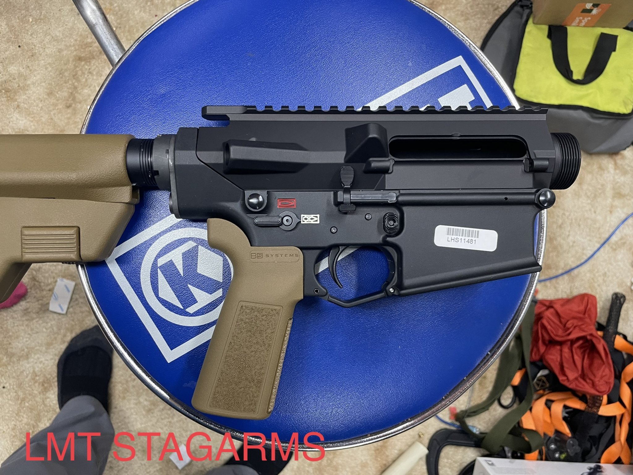

Stag Arms STAG-10: This was the first one I tried and it does function. One of the best solutions available… The fit is ok on the LMT lower, the lower over hangs the upper in a the rear and the Forward assist is kind of a bummer. Unrelated comment, as with most DPMS High pattern uppers, Knight's handguard's require hand fitting unless you want to live with a huge gap between the rail and the upper. A small mount of material must be removed from URX 3.1 and for URX 4s the receiver its self must be faced. Its a small amount of fitting but not for the uninitiated. (PM me if you want more details on how to fit knight's rails to DPMS uppers)

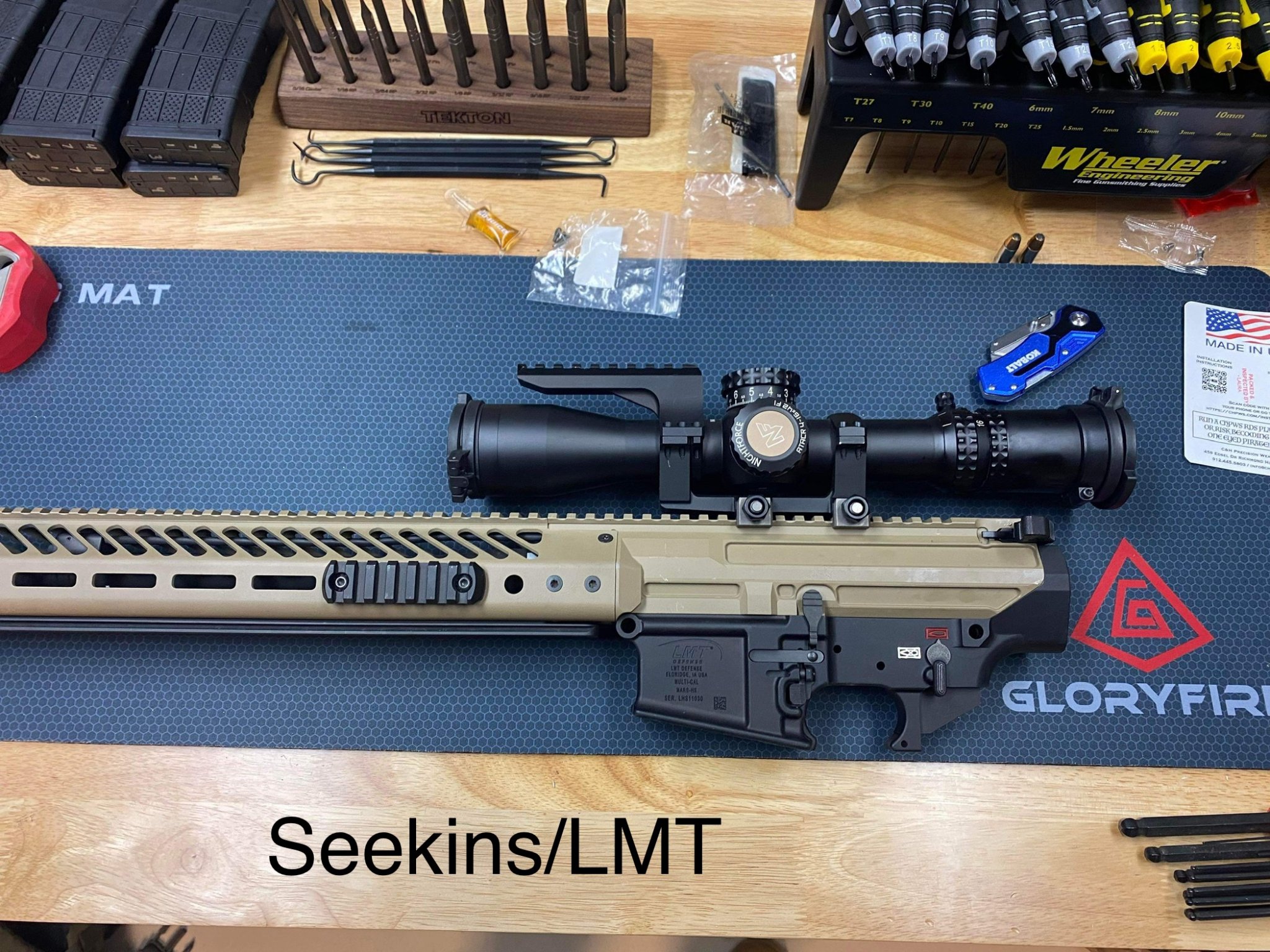

Seekins SP10: Probably the best option. semi monolithic is great. Readily available and out standing quality. I am not crazy about the triangle shaped handguard and the lack of options here. I have fit one of these on to my LMT lower and its a perfect fit. These are only available as a builder set or a complete gun. but no reason not to just do this if you are cool with the handguard.

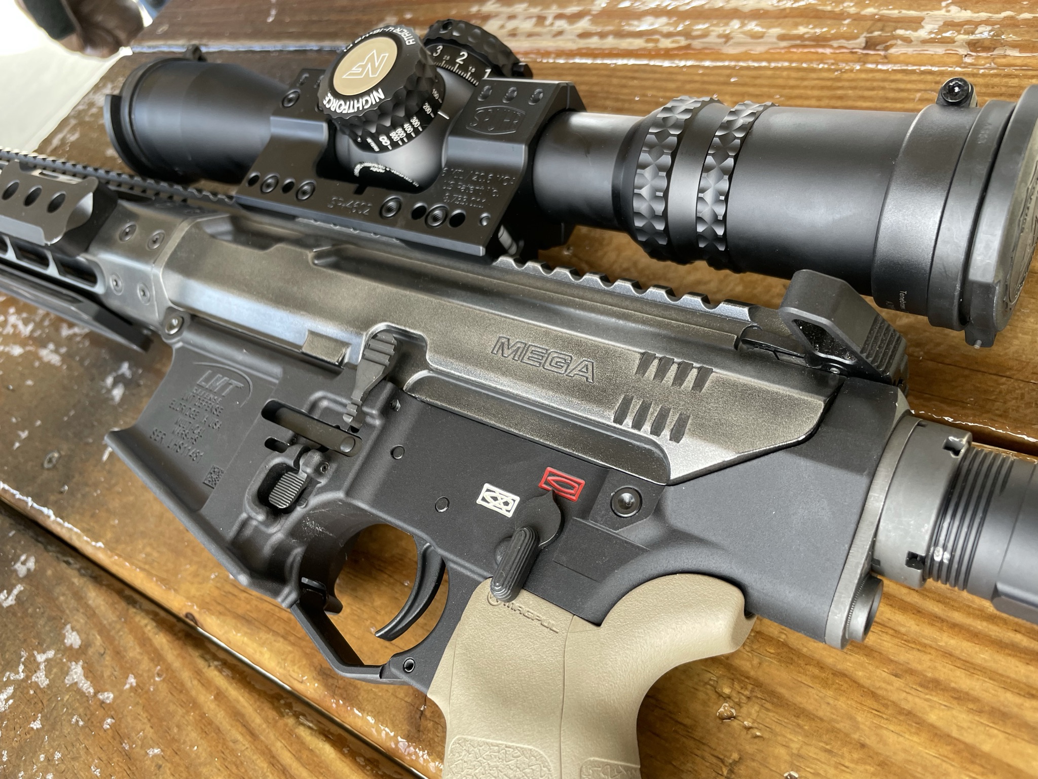

Mega Arms MATEN: Really nice quality. Availability is good. Not a great option to mix with other brans but will work with some. This is great if you are looking for a game gun. Super heavy. The upper will function with Knight's lowers but fit is not great interferes with MARS-H ambi controls.

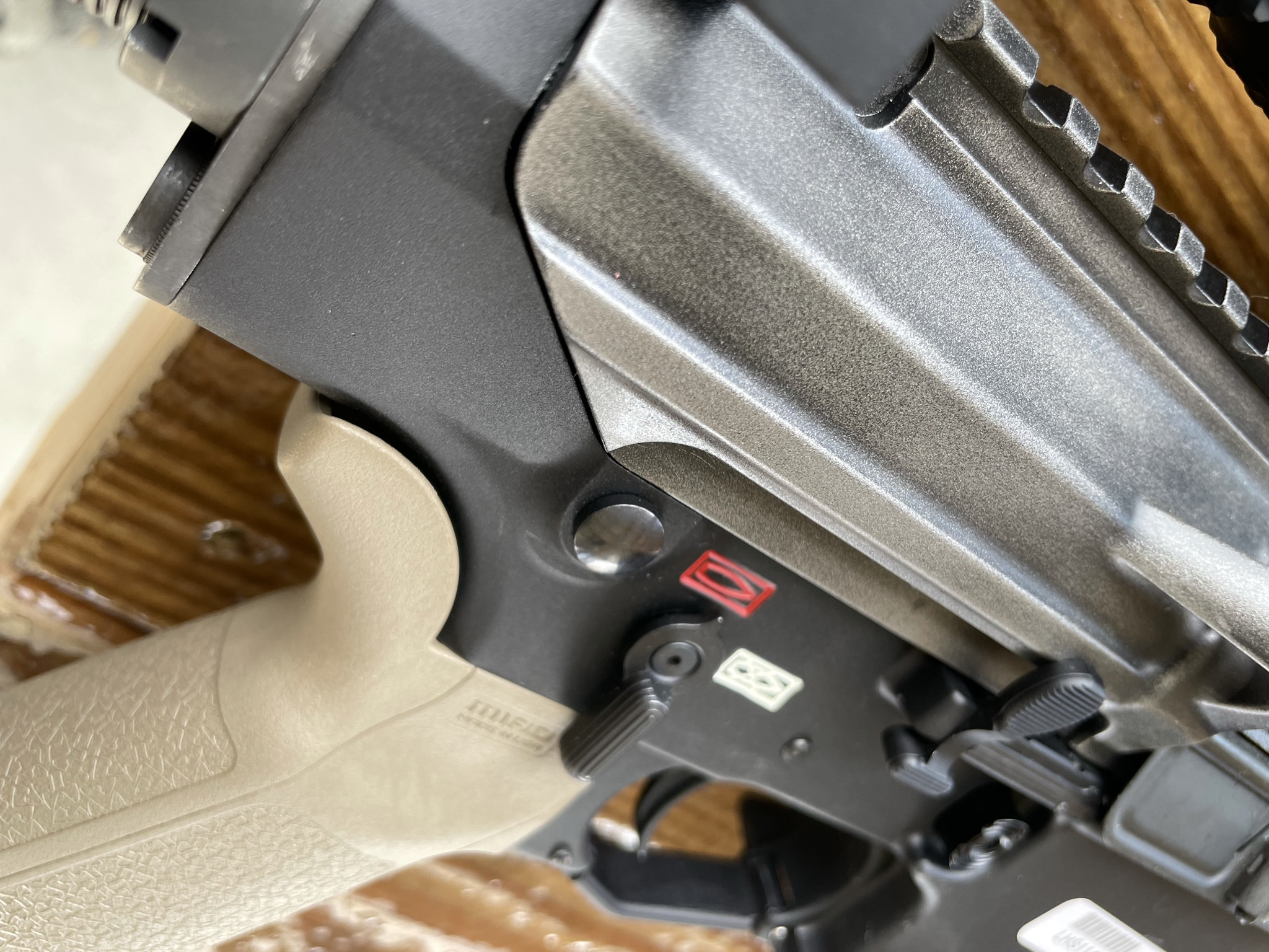

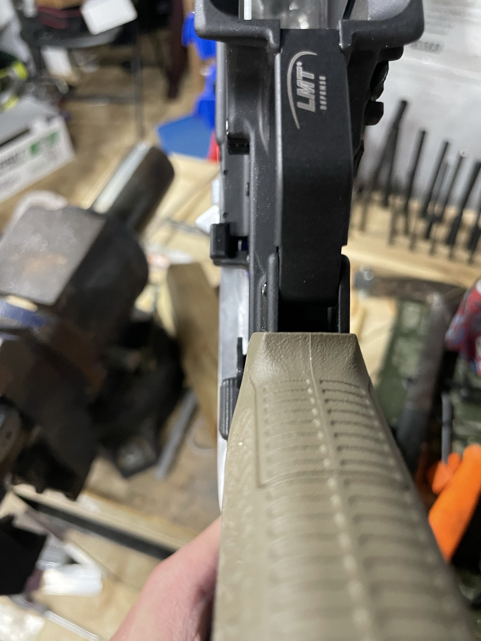

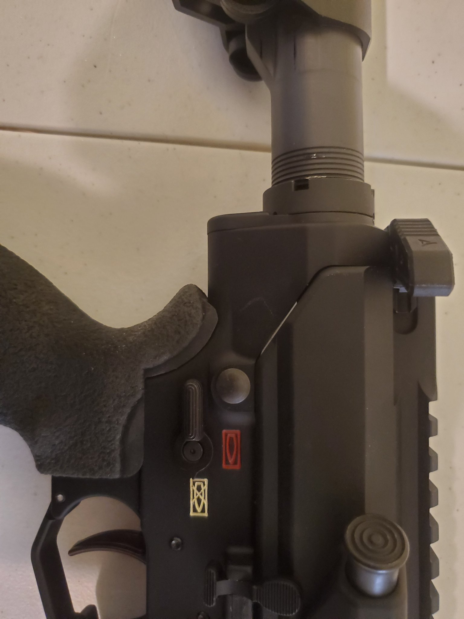

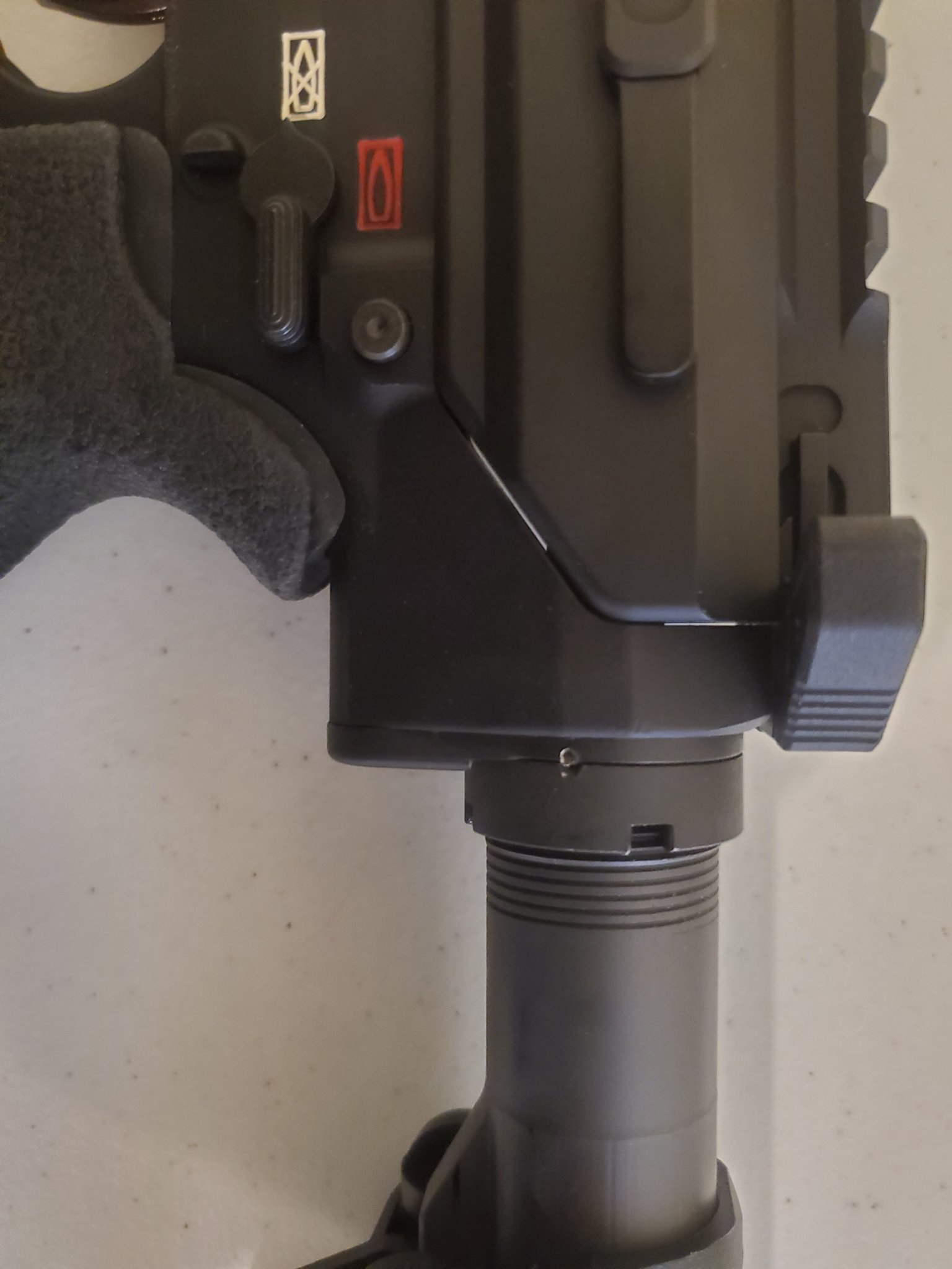

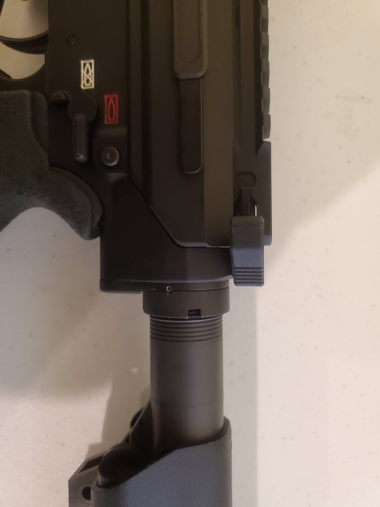

Wilson Combat: These do NOT fit and are truly a proprietary design. I did order an upper to try. The geometry is totally different and there is no chance this can work. I was so disappointed I forgot to take pictures before I returned it. They do have a disclaimer on the website but, I tried it anyway. They did give me a refund without and issues, but it took close to month.

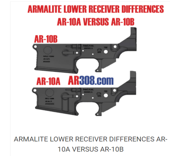

Armalite AR-10A: The lowers are compatible with Knight's uppers, take SR25 magazines (AR-10B do not use sr25 mags). But that is where compatibility stops. The uppers have a forward assist (not really into that), and a different thread pattern for the barrel nut, different barrel extension, bolt etc, etc,
ADM UIC-10: I have seen pictures of these with and without forward assist. They wont breakup a builders set unfortunately. If some one has tried this let me know.
Edit: ADM UIC-10 do fit. (At least the geometry is the same) I found this pic randomly… still no information on the upper or if it has a forward assist)

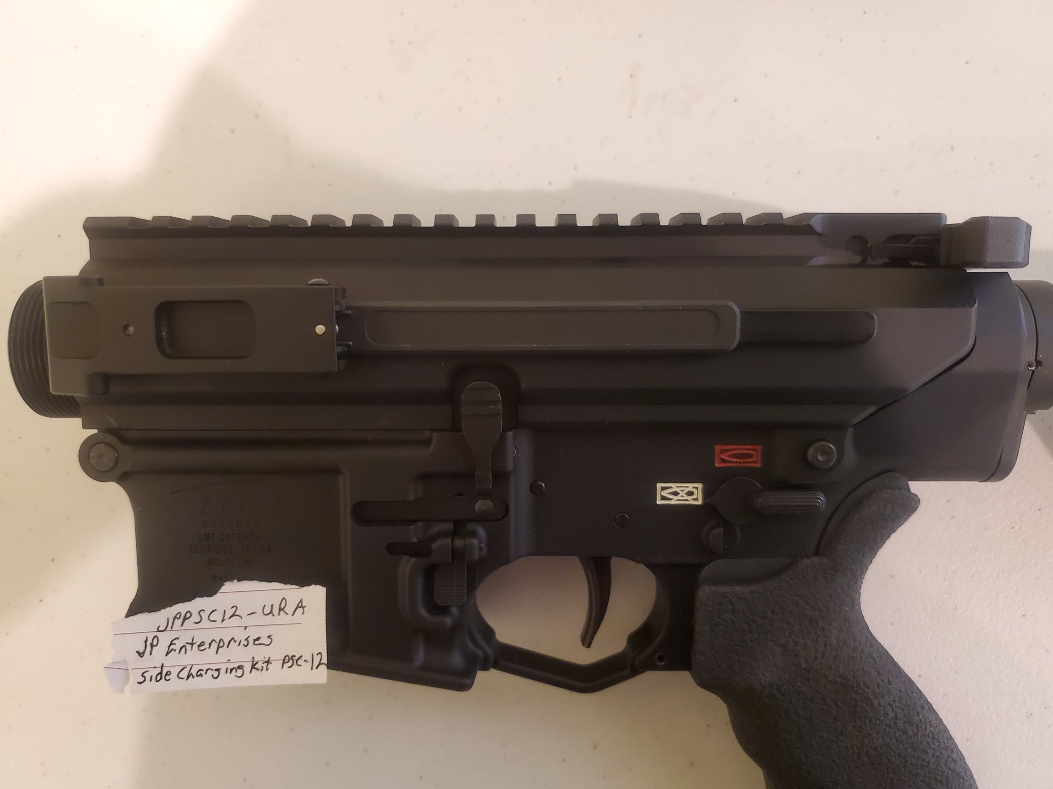

JP Enterprises PSC-12 (Information an pictures courtesy of @papershredder ) My take on it so far on an LMT lower; Pins are very tight, no play or slop between the receivers at all. There is a little gap at the back angled profile between upper and lower receivers. They use a DPMS threaded barrel nut and come with any of the JP DPMS bolt carrier groups (buyers choice).
Edit: the JP option ended up not working out. Details on page 2 of this thread.

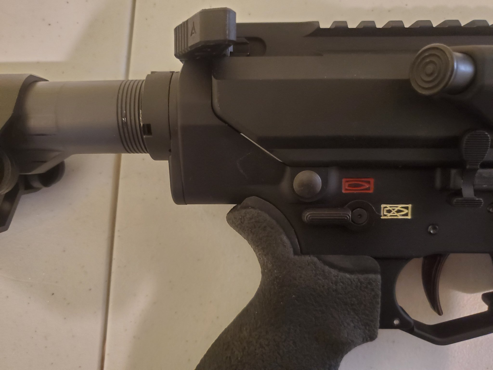

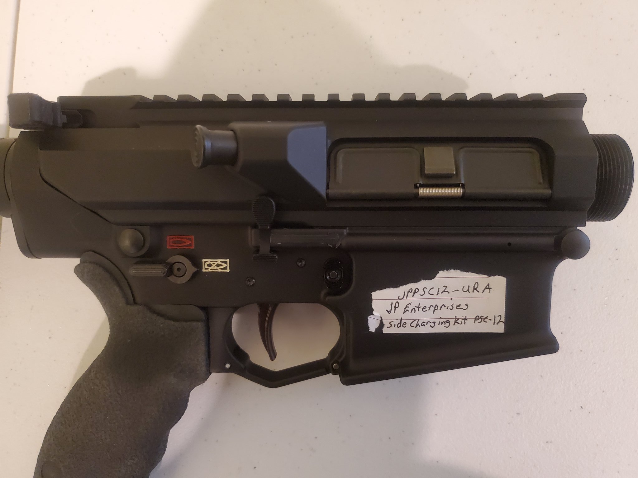

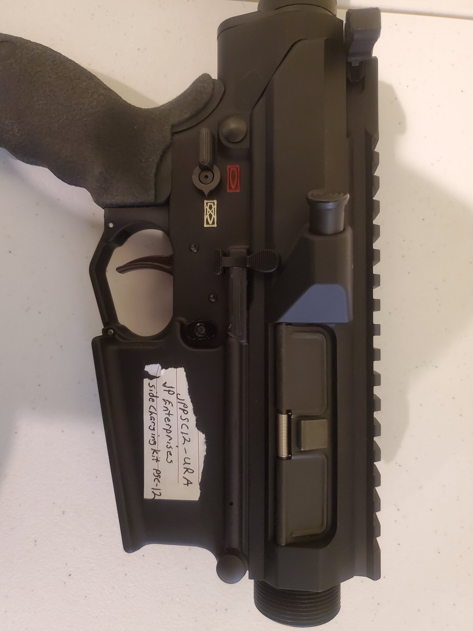

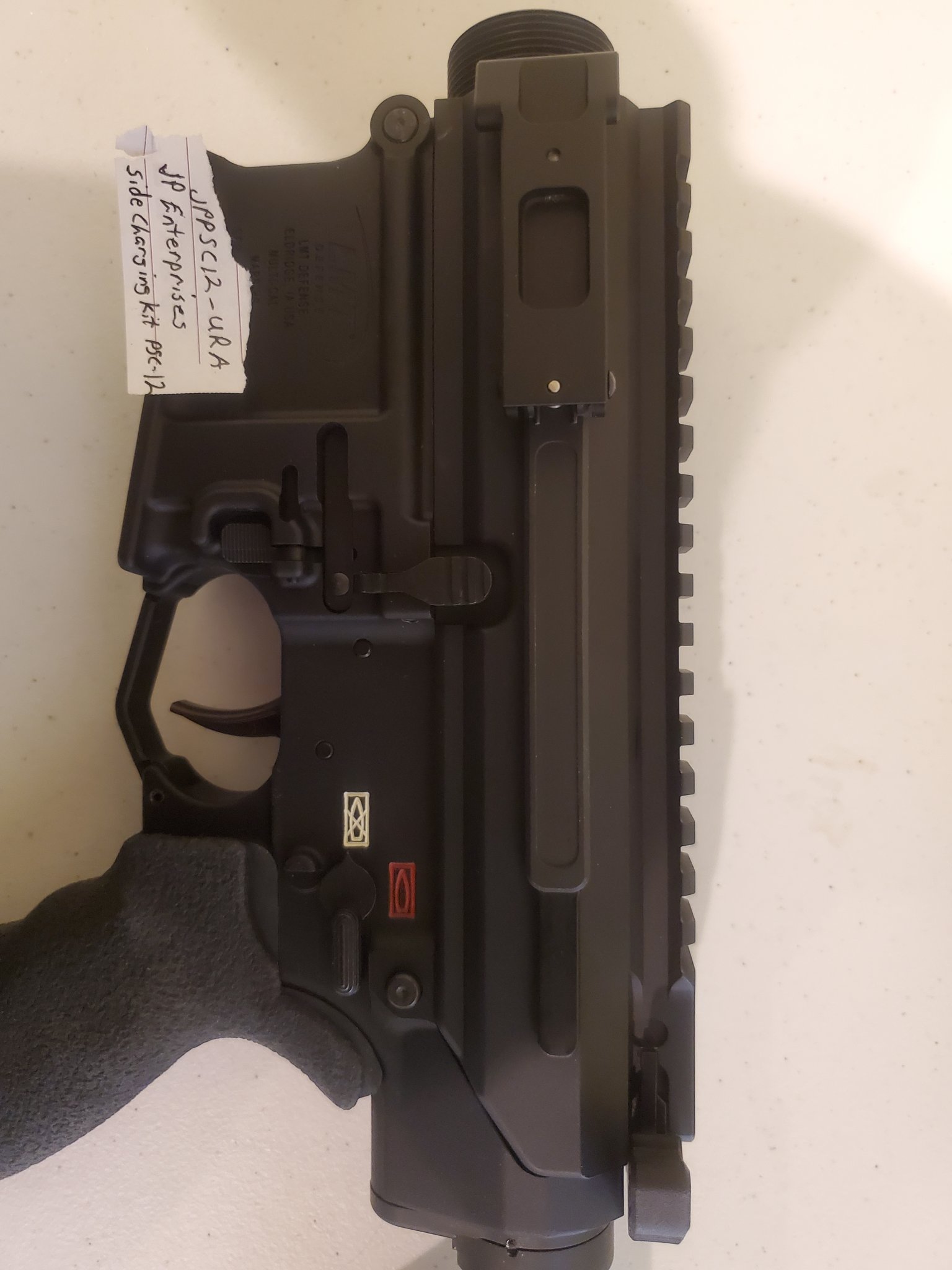

Here's another to add to the list. JP PSC-12 side charge receiver Armalite pattern. I'm still in the process of building this upper. My take on it so far on an LMT lower; Pins are very tight, no play or slop between the receivers at all. There is a little gap at the back angled profile between upper and lower receivers. They use a DPMS threaded barrel nut and come with any of the JP DPMS bolt carrier groups (buyers choice). Edit - Sorry for the vertical pics, apperently my phone and computer don't communicate well together
20220220_092420[1].jpg20220220_092427[1].jpg20220220_092527[1].jpg20220220_092557[1].jpg20220220_092607[1].jpg
I see a Century Arms in your sheet that is different then Centurion. Unless I can't see the whole sheet from my phone for whatever reason. But good info and post for folks going down this path of 308 gassers.
That was a typo… I fixed it and added their URL. If these come back it would be great.
One thing I didn't mention on the JP upper earlier is the JP barrel extension I bought is a little loose. I don't think it is the upper though. The ID of the upper where the extion fits measures 1.189 with calipers, and from what I searched on barrel extension dimensions, The receiver is +.001" from where it should be at (1.188). The receiver extension I bought measures 1.186 on the OD with calipers. So just a little caveat to anyone considering one of the JP uppers, a larger diameter extension may be required for a proper fit.

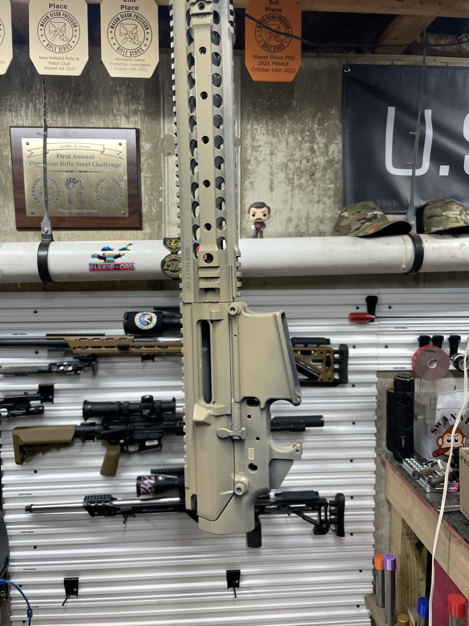

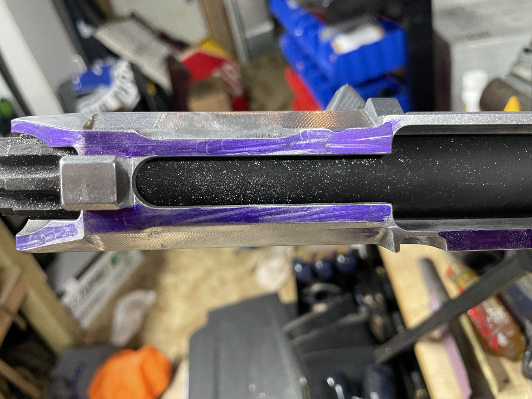

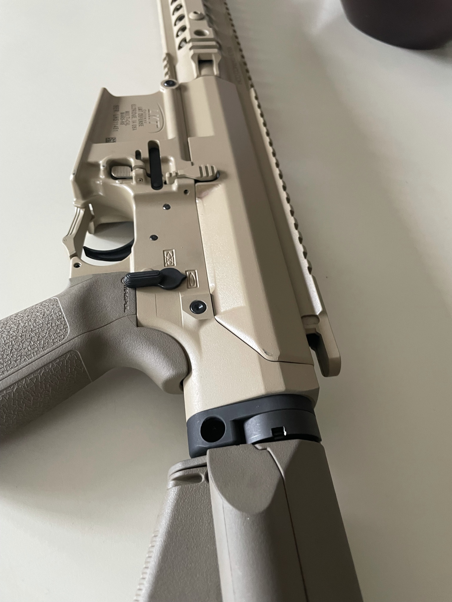

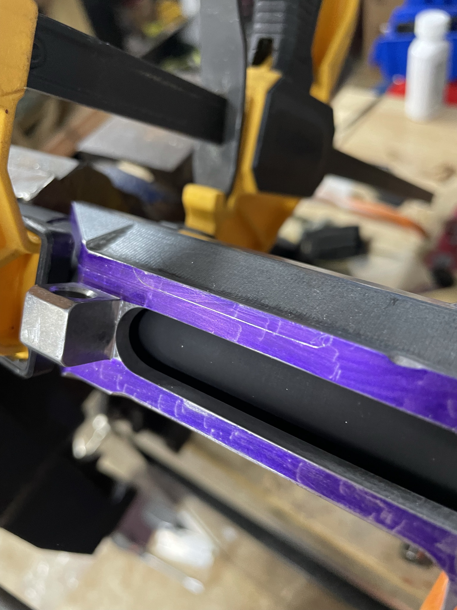

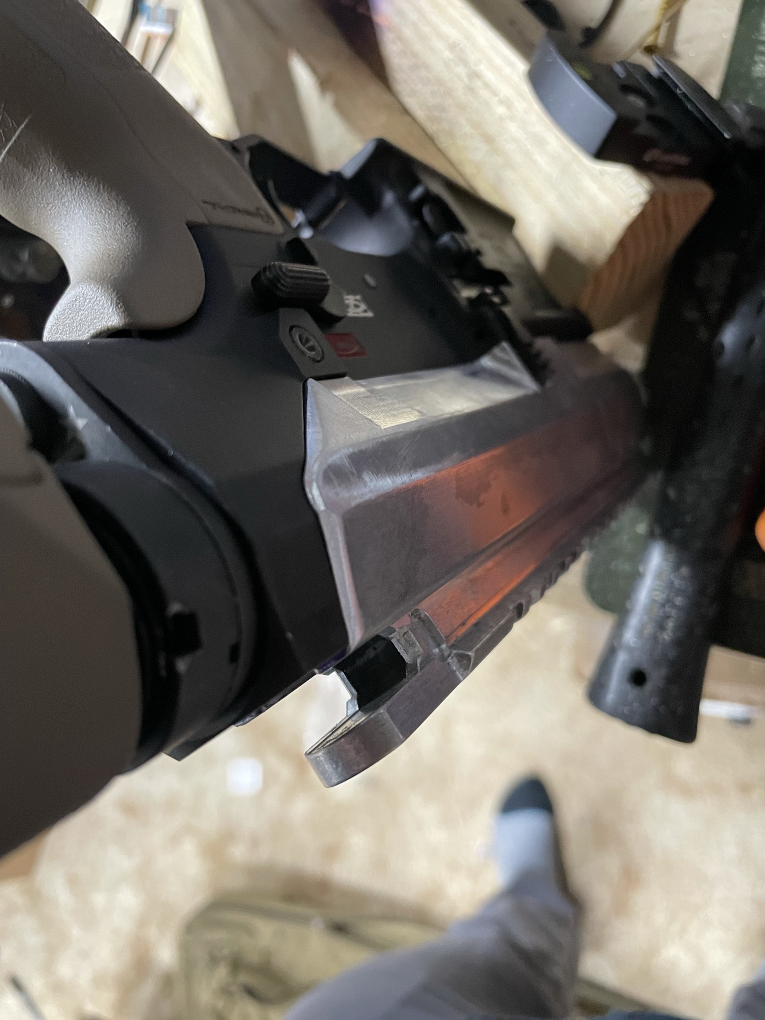

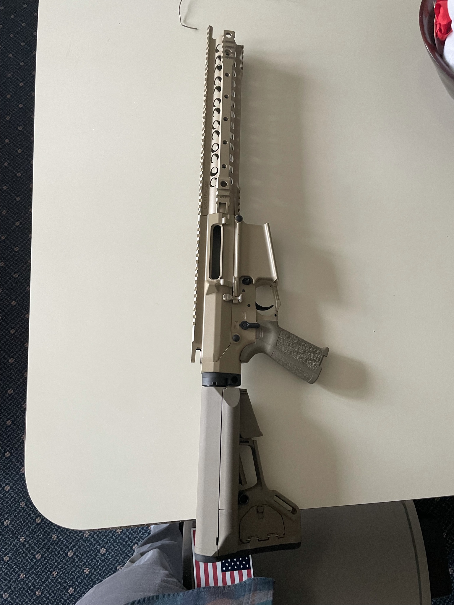

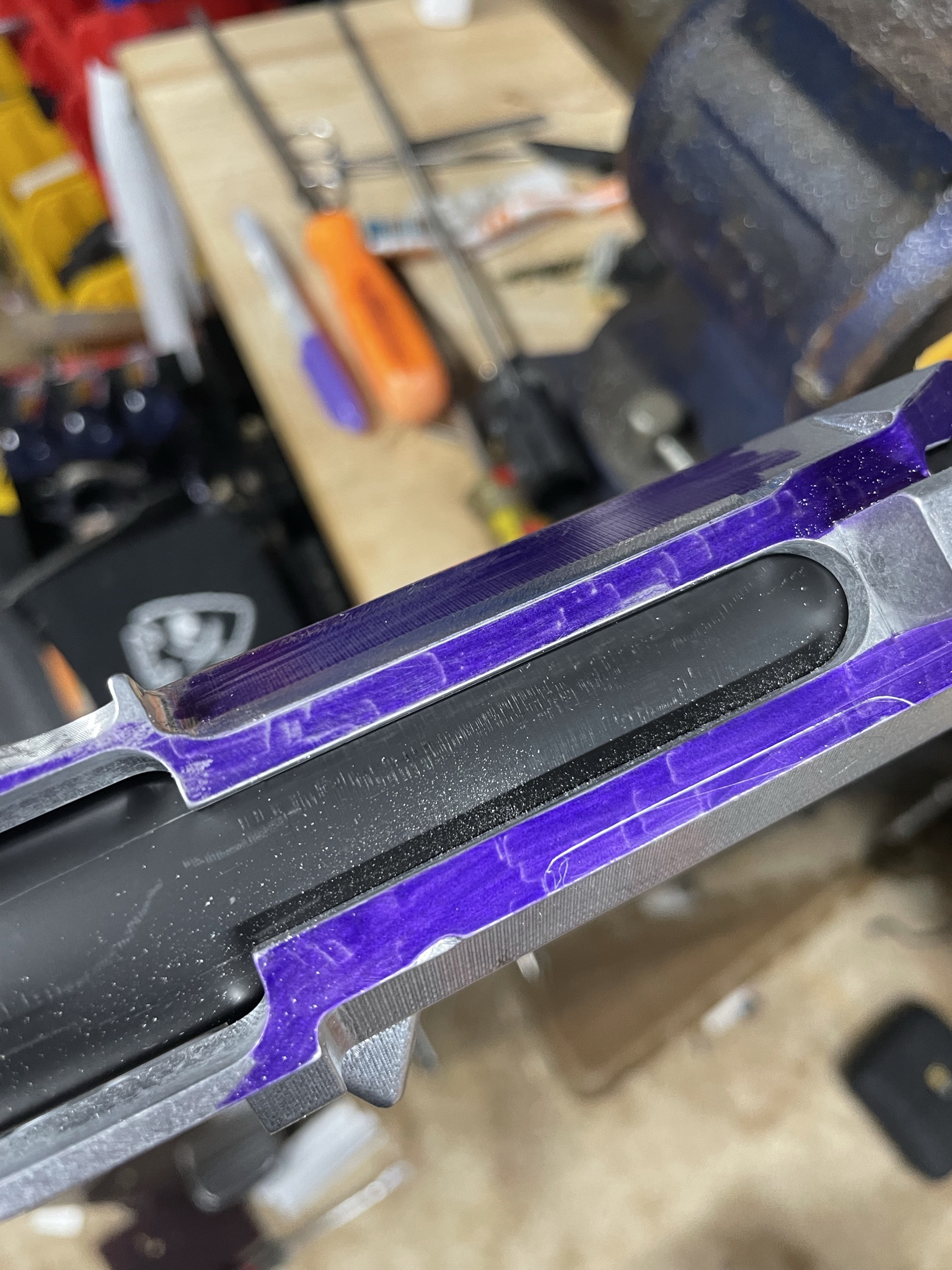

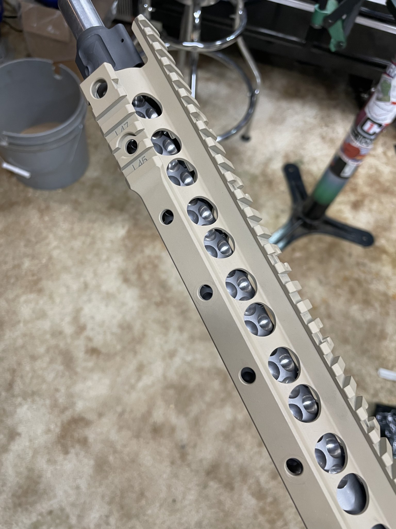

I did some fitting work to the SMF tactical upper to get the lines to match up better with the LMT lower. Really, I just broke some edges and trimmed some overhang but it made a huge difference and I am really happy with how it turned out.
Again… this did function without modification. I just wanted the lines to match up a bit better.
Basically I just put sharpie on the upper (Like layout fluid) and scribed some line, then use files to remove extra material. SO long as you take you time and have a some file (And a few different shapes) this is no difficult. It just requires patience.
Here is some shots during and after paint. (Paint is Aervoe brand and the color is Sand) Oh and that LMT blem marking is 🤌
View attachment 7815857View attachment 7815858View attachment 7815859View attachment 7815860
View attachment 7815867View attachment 7815868View attachment 7815870View attachment 7815871
View attachment 7815863View attachment 7815864View attachment 7815865View attachment 7815884View attachment 7815885

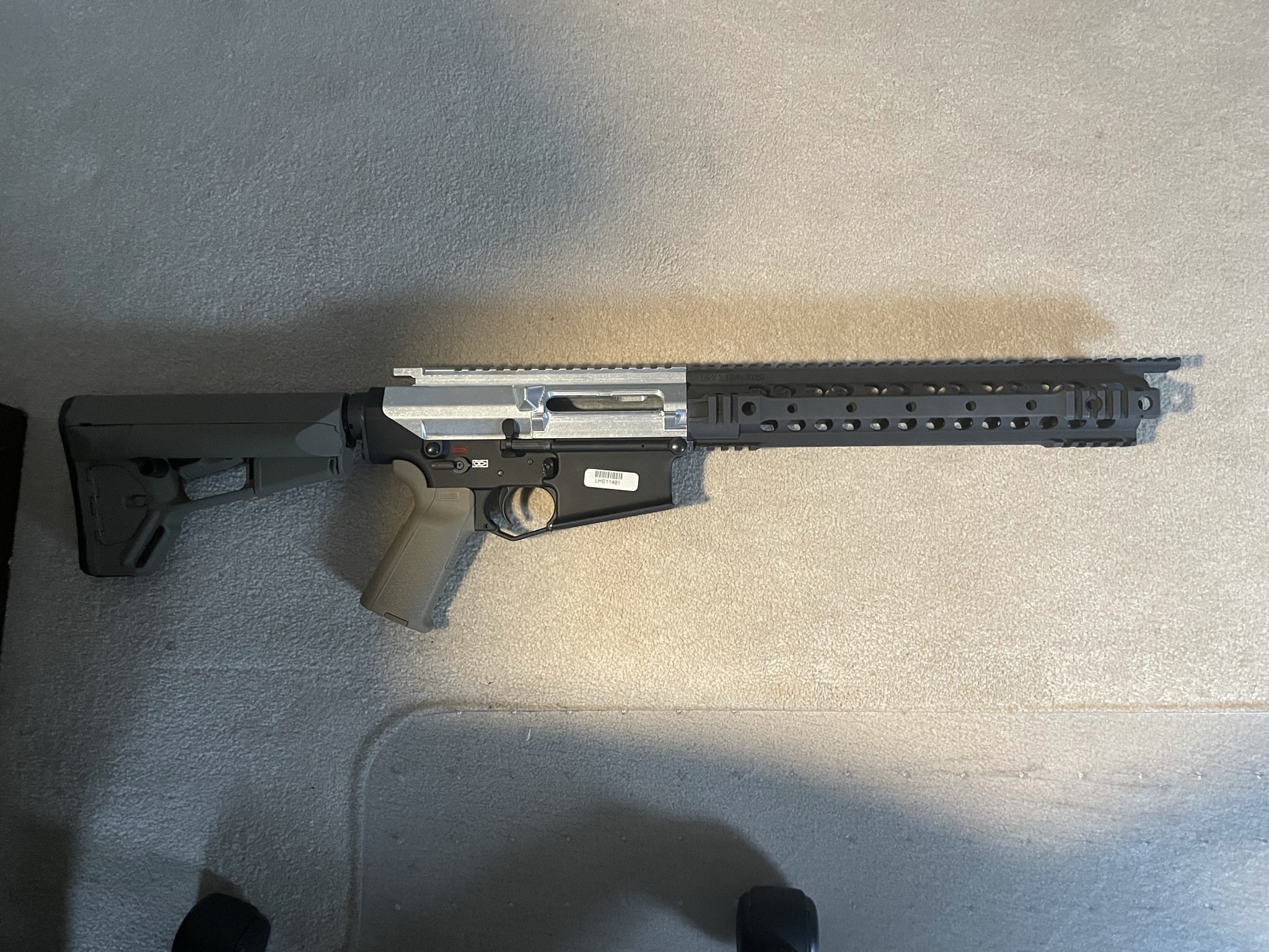

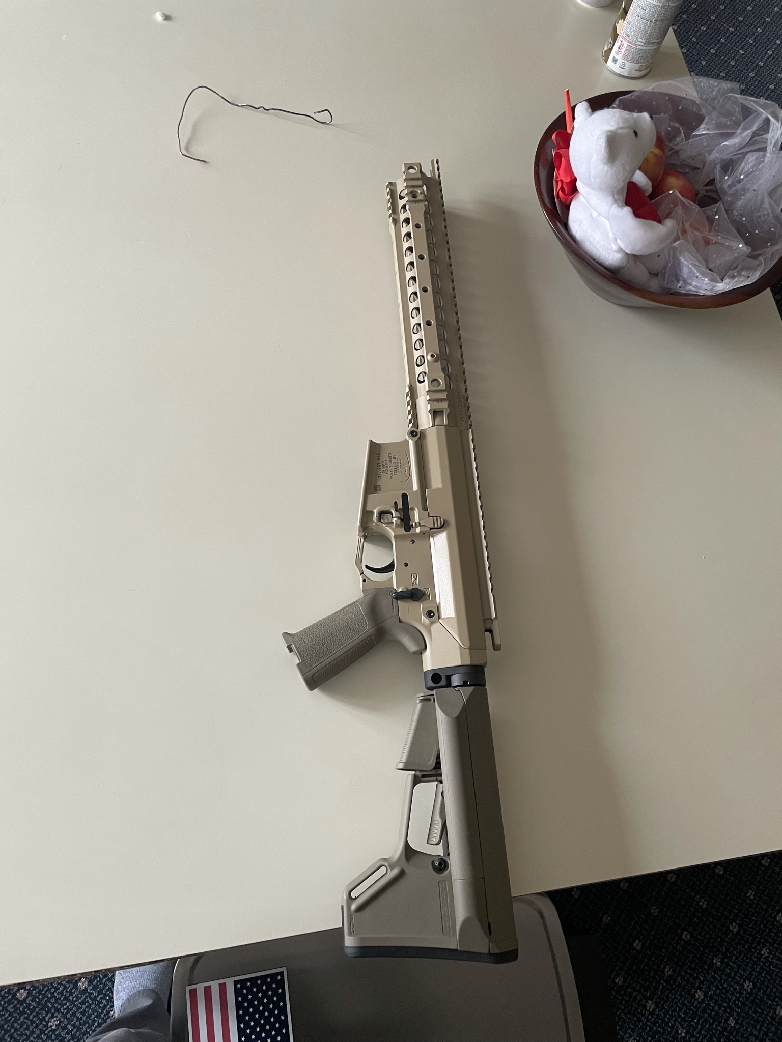

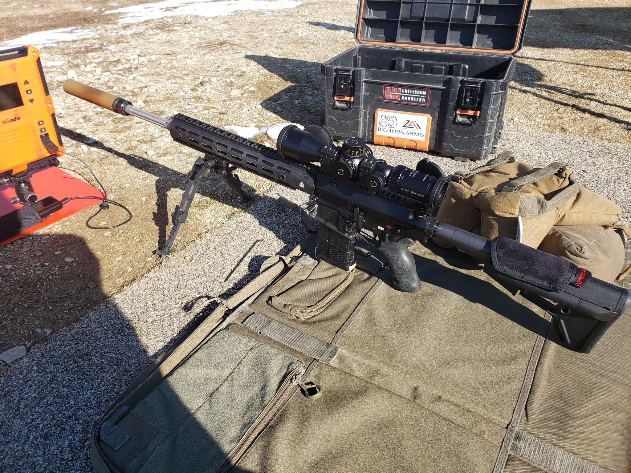

Update.....

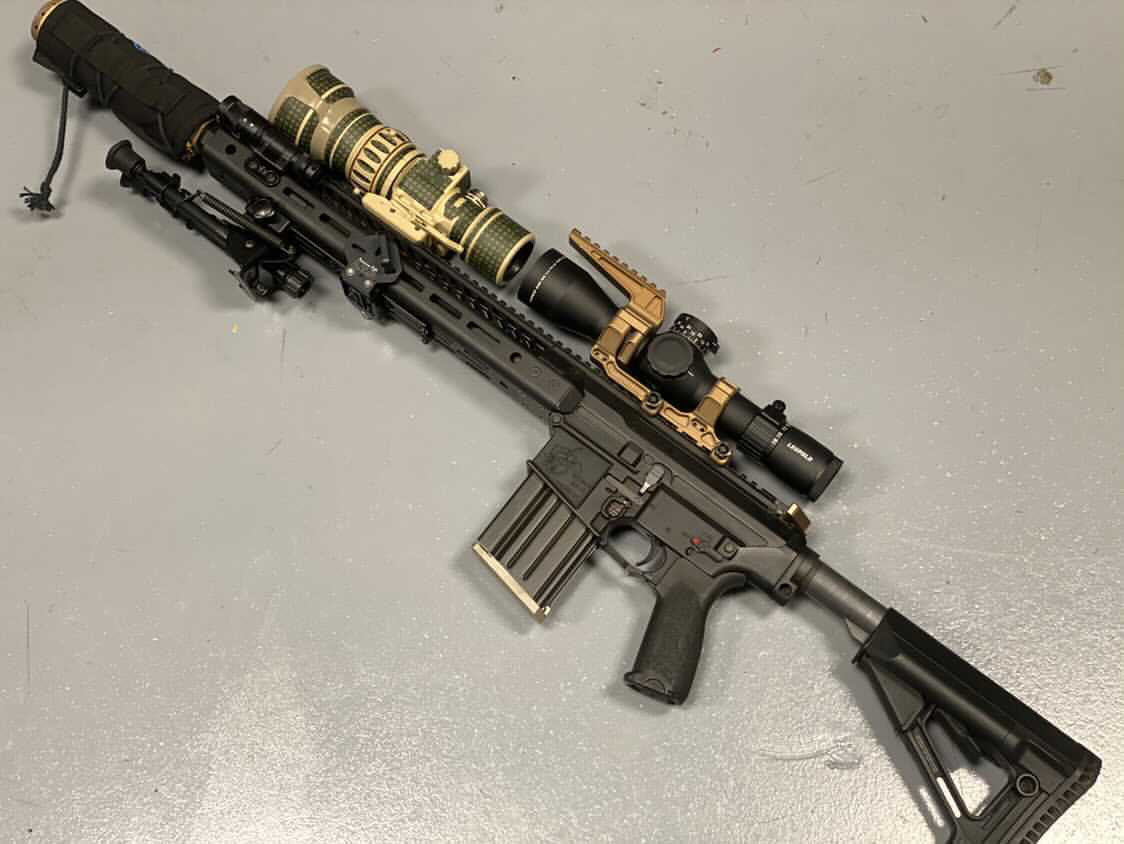

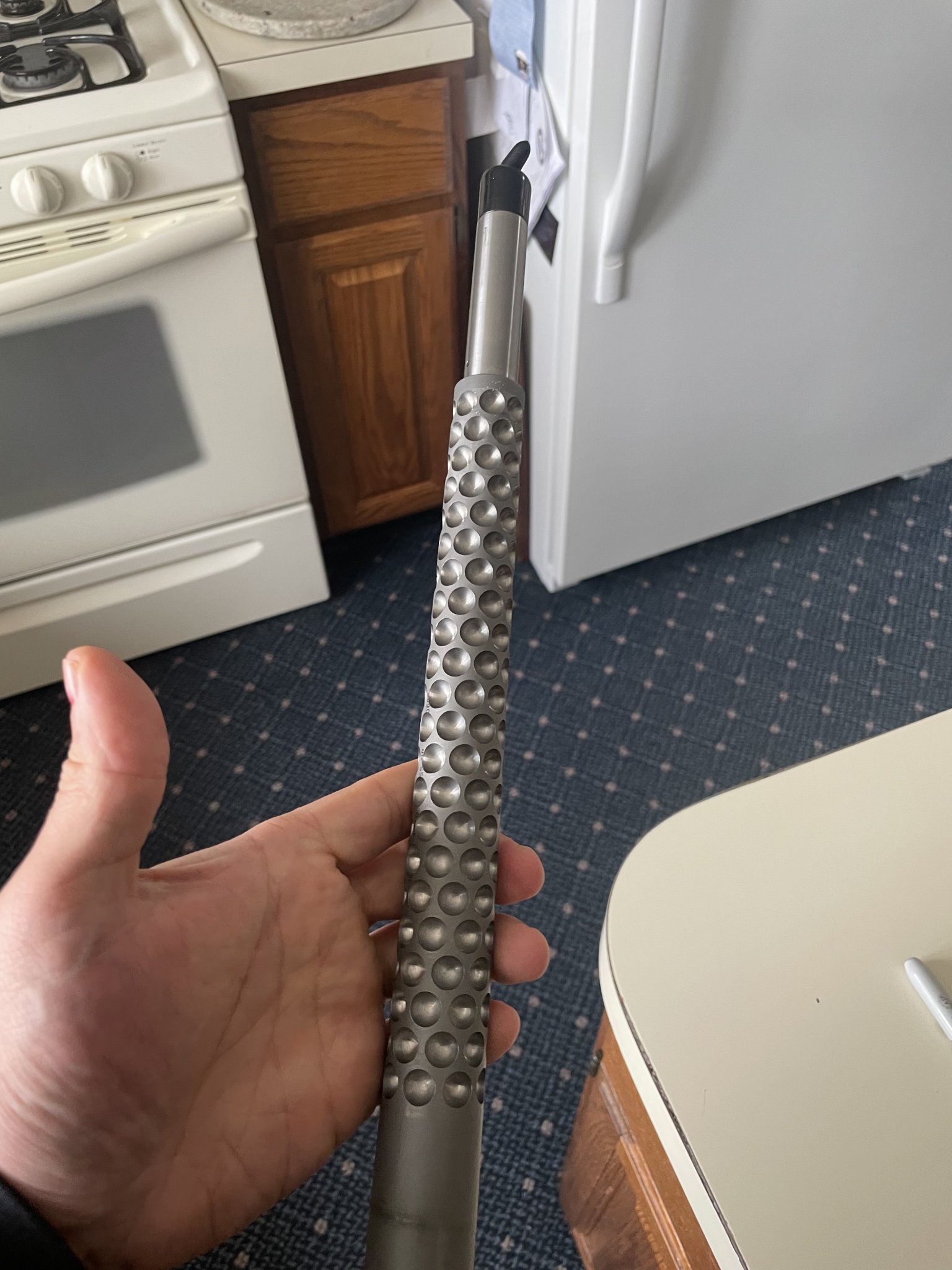

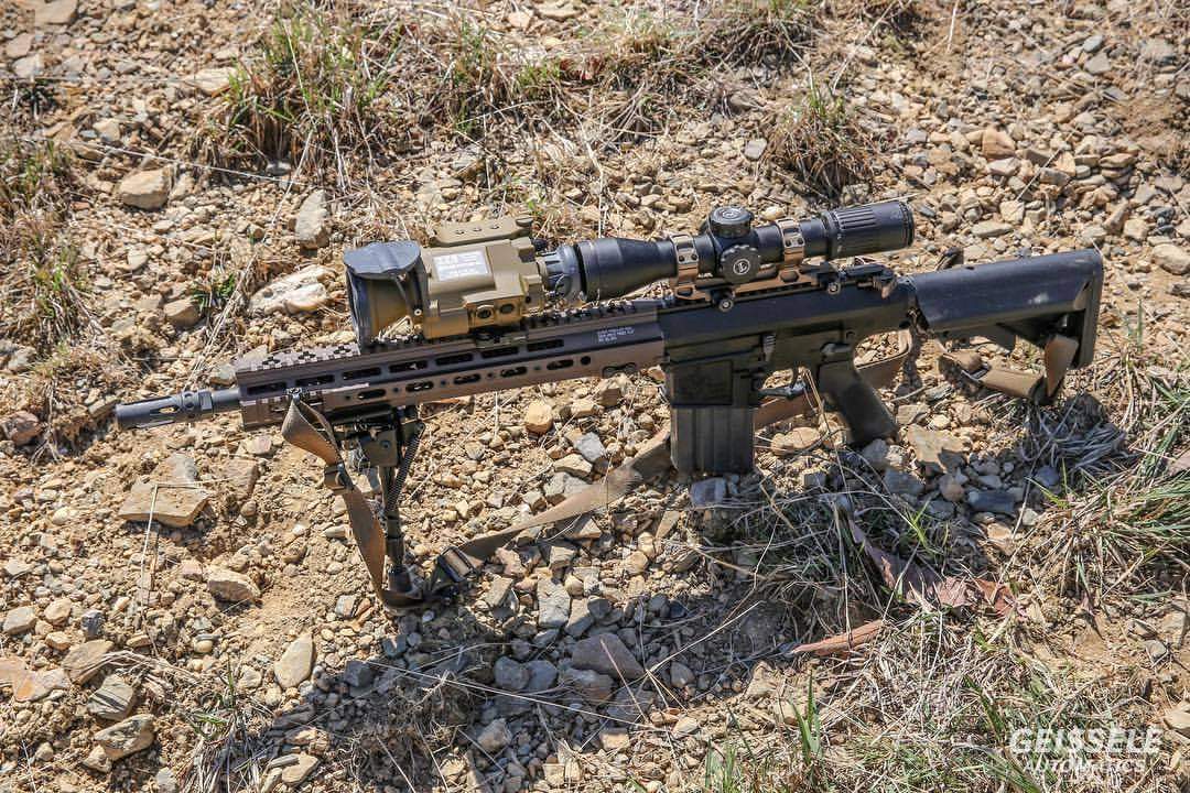

I picked up a 20” heavy contour 308 barrel from Ballistic advantage. These have a rifle length gas system with a .083 gas hole. I planned to cut it down to 16” and copy the m110k1 look.
Had the barrel dimpled by Marvin Pitts who did this for KAC with the original m110k1, which turned out really cool. He also cut the barrel to 16”, re-contoured from the gas journal forward to .750 and opened up the gas port to .095
Gun is all together now and runs well on FGMM.

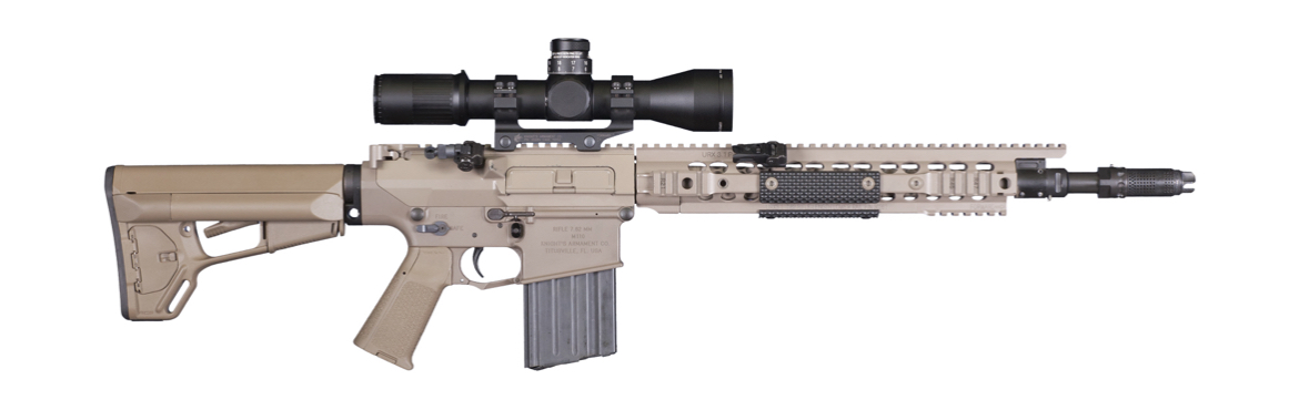

I included a pic below of the actual m110k1, which was the look I was going for.
Although, I wouldn’t call this a clone… there are just too many “unobtainium” parts that are not available and just dumb to try and get.
IE $500 muzzle device you can’t buy and only works with a $2k suppressor you can’t buy, both of which are old technology. Same for the scope, scope mount, gas block etc.

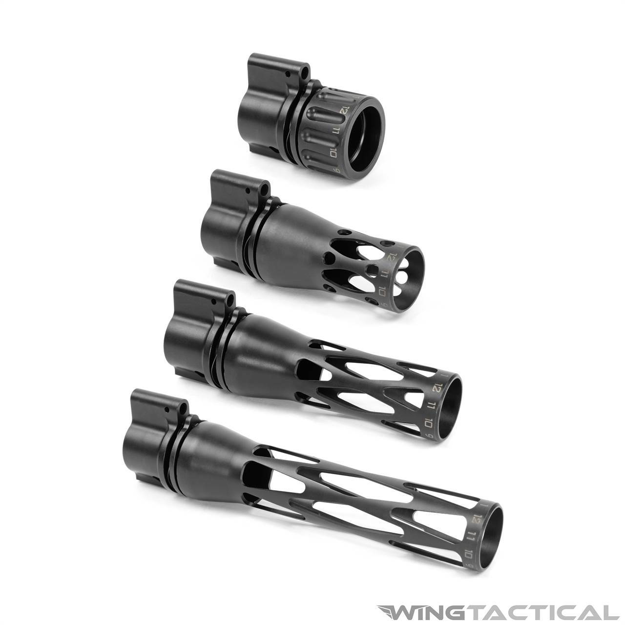

This rail (geissele mk1.5), and that top adjustable gas block with the urx 3.1
Thanks! I looked at the rifle speed (that almost happened.) The GB I ended up with is made by Allegheny and is designed to work with the AEM5 /OCM5 (allows shortest possible configuration) I think these are all 556 so I’ll probably have to convince otter creek to make me one in 30cal.

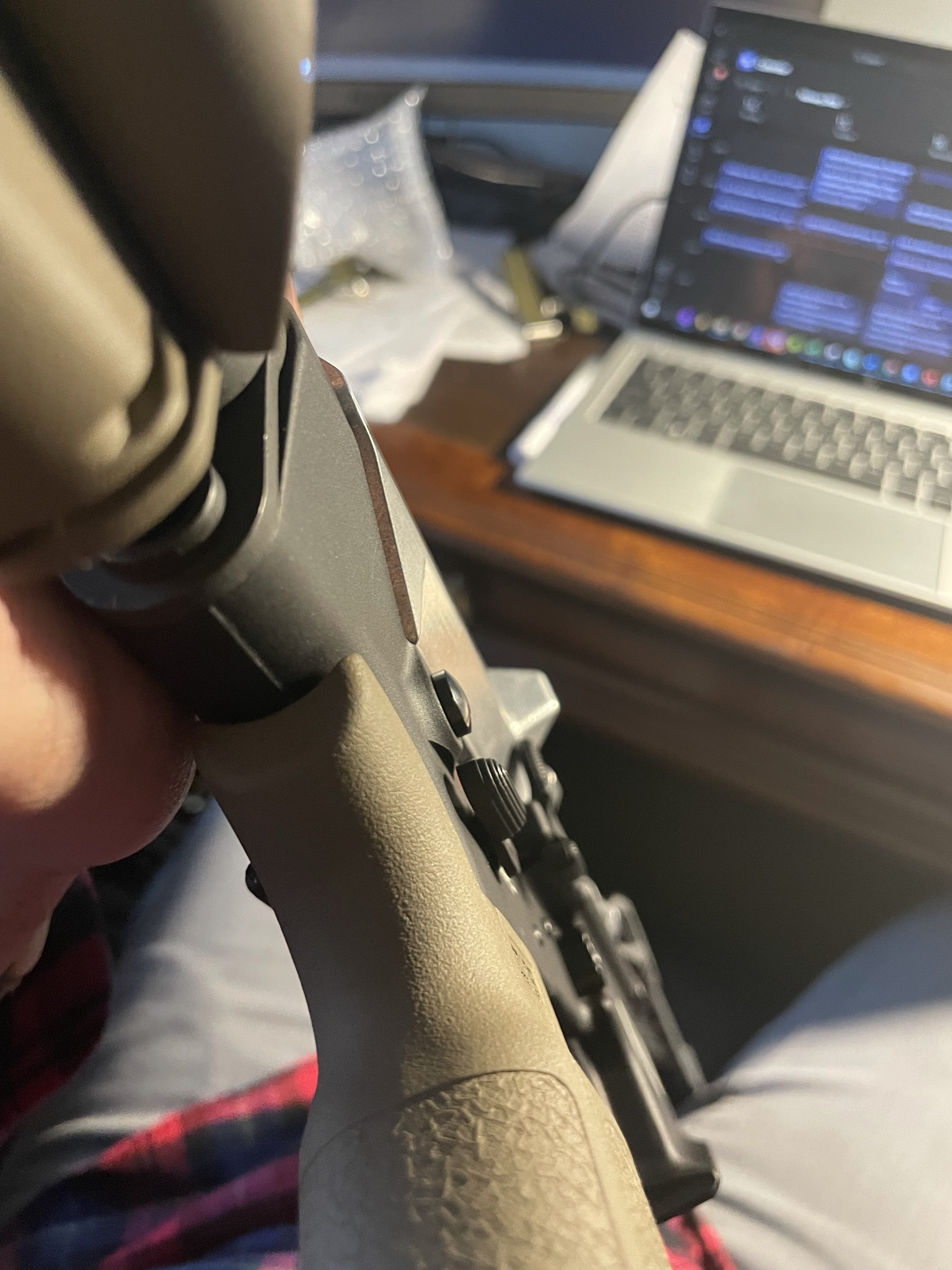

Have anyone looked at compatible uppers for the 80 Lowers SR25 Blanks?
I just finished mine up and it fits/cycles okay, there is just a little overlap between the upper and lower over the FCG pocket. Plus side is the lower uses DPMS parts with exception of takedown/pivot pins. Their upper however is DPMS barrel nut thread and matches very nicely with the lower (as it should). I use my 80lowers lower on my STAG 10 upper and it does the job. The only drawback I have is the finger grooves on the front of the magazine well, not very traditional. Just my $0.02 worth.
