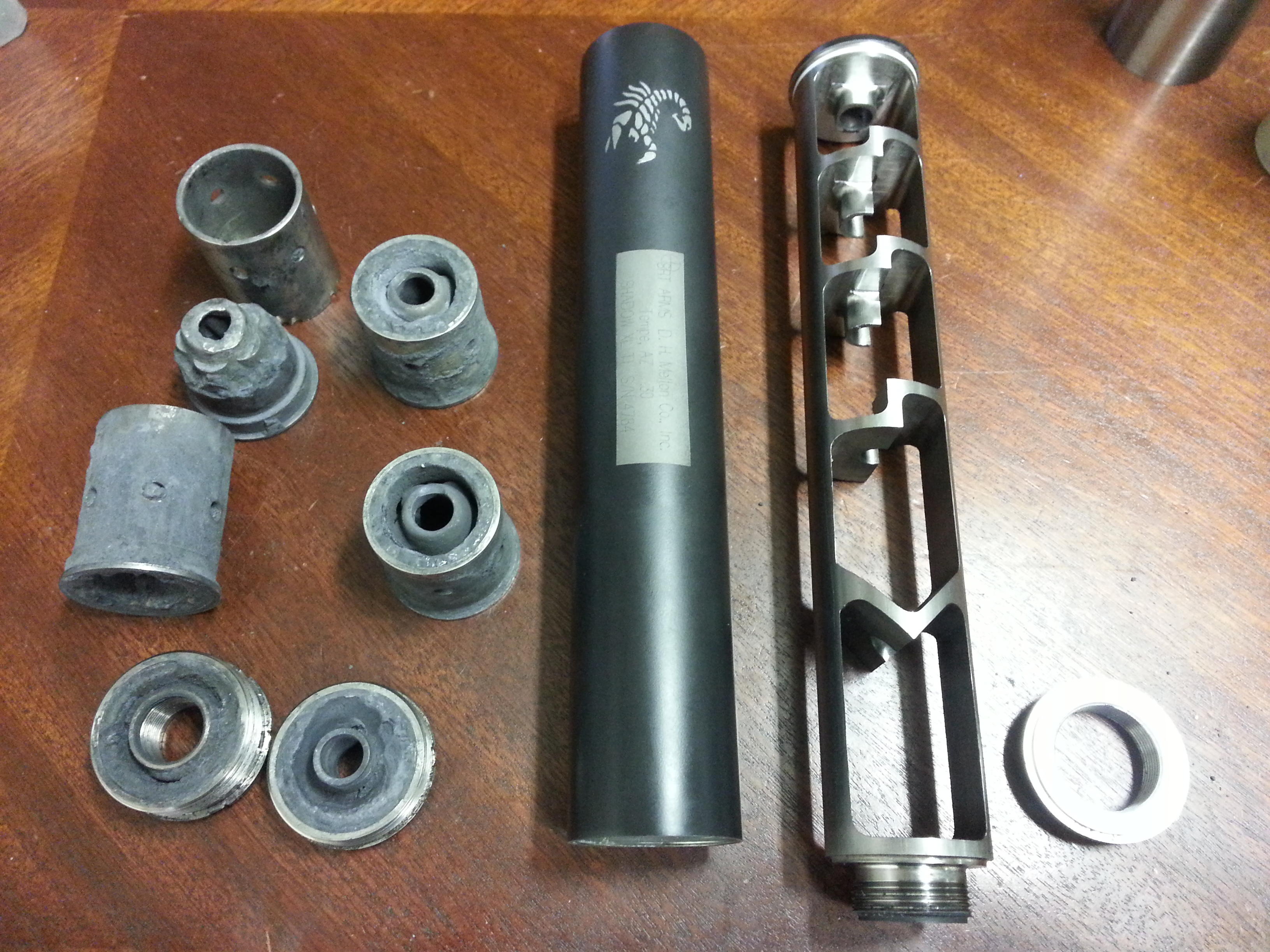

I Purchased a SRT shadow xl ti 2 years ago and it has been a great silencer since the day i got it. Unfortunately after approximately 6000 centerfire rounds and 1500 rimfire rounds the suppressor had approximately 1/2 pound of carbon trapped inside it that i was unable to remove because of it being a sealed can. When i contacted the manufacture, i was told to send it in for a professional cleaning that would have a hefty charge plus freight. This was more than i wanted to spend every two years to have my suppressor cleaned.
I made the decision to have Corey from Lane Silencer Llc. install one of his magnum cores inside after i removed the old SRT baffles. After seeing how much carbon was trapped inside the SRT, I could not have been happier with my decision to put a serviceable mono core inside my suppressor. it is pretty easy to see how much easier this design will be to care for and maintain.

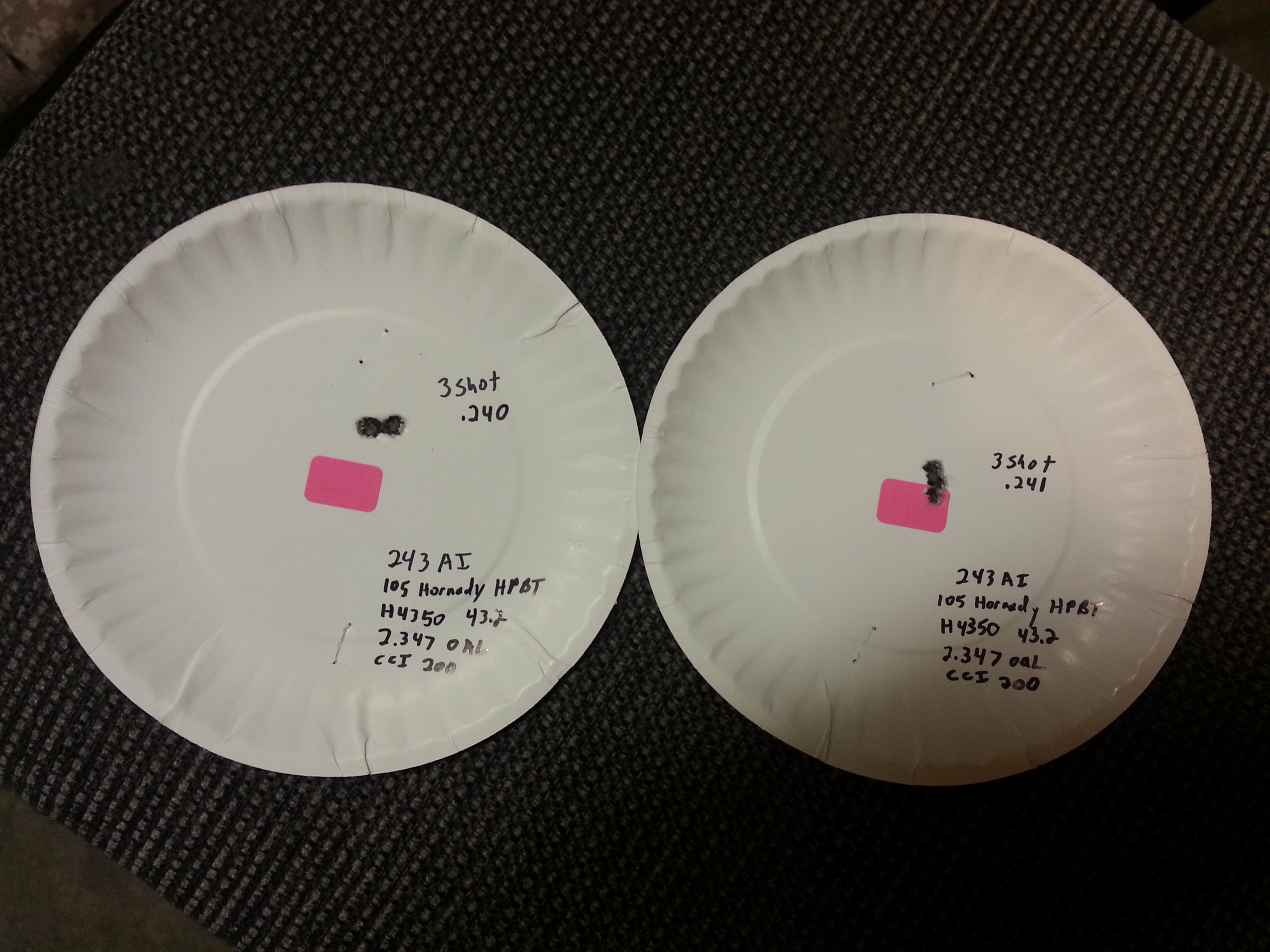

I received my suppressor back from Lane yesterday and made a trip to the range today. I am very happy with the performance so far. The recoil reduction with this can is amazing and the sound is extremely quiet. I don't have very many rounds thru it yet but from what i can tell, any shifts are very minimal and the groups are looking fairly excellent so far. I could not be any happier with this suppressor. The SRT baffles are on the left and the new Lane Core is on the right.
Ps. I know these are only three shot groups and they don't count but i am still in load developement. I think its showing promise.

Got to spend some more time at the range with the new Lane cored suppressor today. All i can say is that i love this new can. It seems to be every bit as quiet as the SRT when it has brand new,(maybe better), and it only weighs in at 13.7 oz. Groups are staying consistant as i fired a ten shot group today under .5 MOA. Whats not to love.
