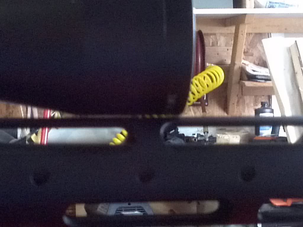

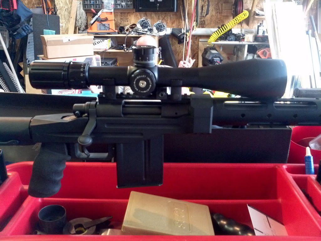

    If anyone wanted to know, high rings will get the SS up enough to not touch the shroud, but it will be damned tight! just a few thousandths off it. Mine are Leupold highs. Not sure what I'm going to do about lens caps...

    I suppose I could shim it, but that would bring it up even higher. As it is I am going to have to build up the stock to maintain a good cheekweld.

    The problem still is the total scope height. As I said, I am going to have to build up the PRS stock for my cheek weld, I really don't want it any higher.
    That being said, Bizell may be on to something with a minor cutout underneath the objective bell. I'll have to give Kyle at XLR a call about the possibility...but I can also see it weakening the shroud and causing more issues.

    thanks for the info, Yash. I just received my SSHD yesterday and I was curious as to what ring height I would need. Due to my past experience, I was guessing highs would do the trick. Although, it appears extra highs may be in my future because you don't have the BC caps on and it appears you have a micron's width of room to follow through with this...thank you for posting this, it helps greatly!

    Before you do anything put in on a bipod, and get behind it and load the bipod and have someone check clearance while you do it.
    I'll bet your clearance disappears and you have scope on shroud contact.

    damn guys! I ran the numbers from XLR's website (and used the info on this particular post) to go out and buy some rings today. I bought Burris XTR's in Extra High (clearance stated these are 1" high). When I ran threw XLR's formula, I came up with a necessary ring height of 1.01". Perfect! Or so I thought...I just finished strapping the SS in...holy shit! I have about an inch worth of clearance from edge of BC cap to handguard!!! Whiskey Tango Foxtrot!!! Do ring heights vary from company to company? I just assumed that because Yasherka used Leupold High's, that using Burris High's would get me the same result. Must not be true, huh? Damn! Back to big box store I go...

    I was making an analogous comparison: Since you were using high rings and had very little clearance that if I also were to use high rings, I would have the same issue and therefore I purchased the extra highs. I stated in the beginning of the post, "I bought Burris XTR's in Extra High". This is indicative of the fact the ring height of the one's I purchased were Extra High. Also why I asked if the actual heights of rings vary between companies, ergo, are Leupold highs the same height as Burris highs?

    The height between companies definitely varies. "High" on one brand may not be the same as "High" on another brand. My medium Burris XTR rings were pretty close to the high Seekins.
    Re: SS 5-20 and XLR Chassis
    Rings "sizes" are not standard from one manufacturere to another. One's high rings might be lower than another's medium.
    That being said, what I think you've run into in that different manufacturers also measure different dimensions. Some give the rings height as the distance from the top of rail to the bottom of the ring "opening", others measure from the top of rail to the centerline of the ring opening. You need to determine what dimension the manufacturer lists as the ring height and adjust accordingly. Good luck

    I put a piece of paper between the objective bell and the handguard. There was definitely some rubbing when I loaded the bipod. Not much...the guard is very rigid, but enough to get at least a small amount of contact.
    My solution, such as it is, was to put the 5-20 on my M-70 long-action and put my Vortex PST 4-16 on the XLR. Now I have about 1/8 inch of clearance and no rubbing problem. Wish I could have kept the 5-20 on it, but there were going to be too many issues.

    well, after a little fenagling, the Burris XTR mediums ended up being the best fit. Unfortunately, I have to shave some of the BC cap. Best way to do that...dremel?
