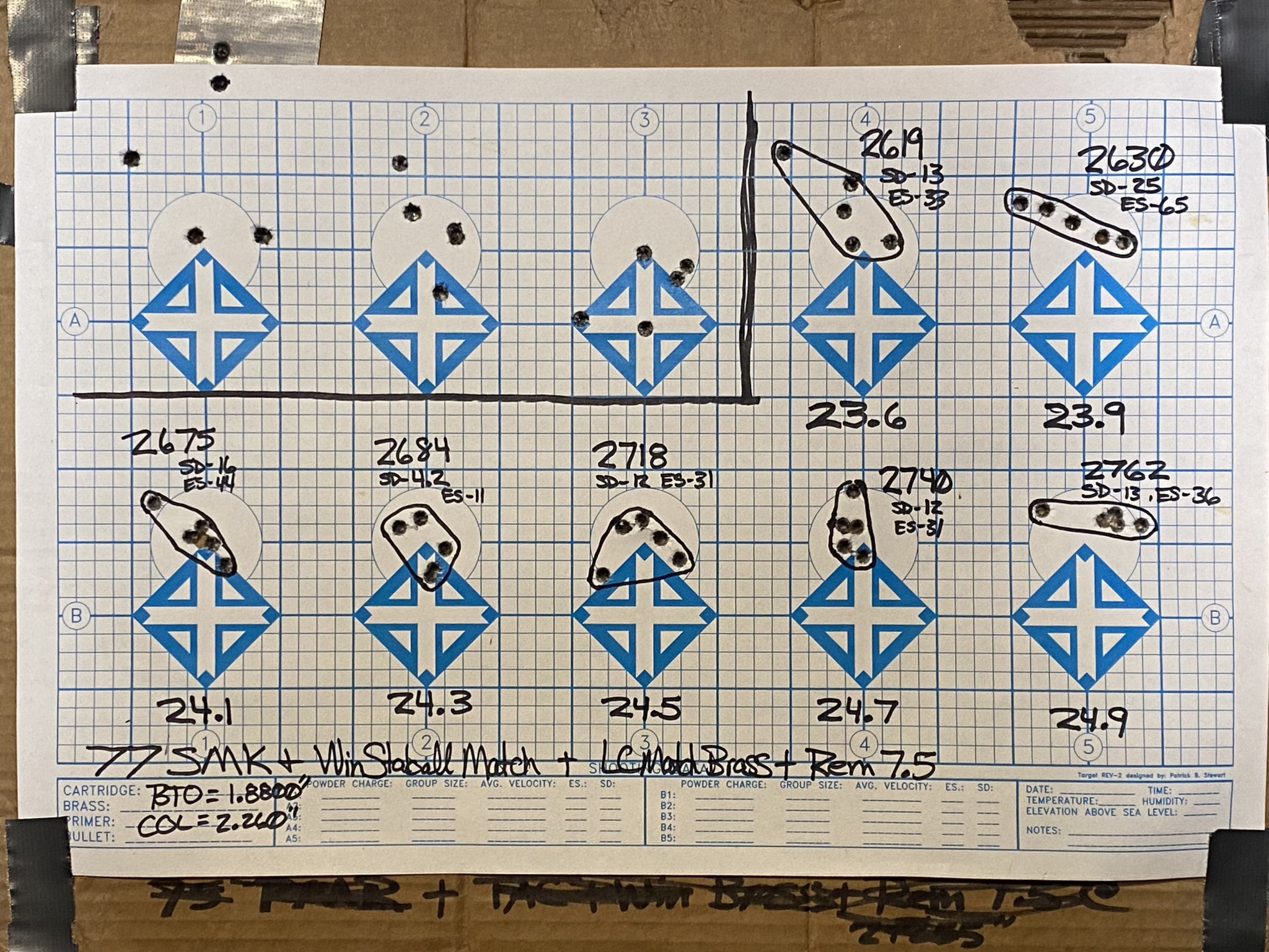

I was working up a load for 223 tac class with 77’s (3000 speed limit). Went up to 25.9 with staball match 26” Bartlein 8T 223W
25.9 77RDF 3000
25.9 77TMk 2982
24.7 88 eldm 2847
Virgin IVI brass & soft ruag primers. No pressure on these.

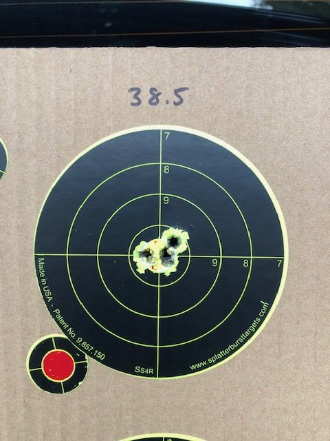

Savage 110 6.5 Creedmoor 26" factory barrel, 123gr ELD with 38.5gr of StaBALL Match. I need to try a few tenths above and below that to see if it closes that group up any, but I'm happy with it so far. The first 3 were right on top of each other, then the other 2 were just outside.
I need to work up some loads with 130's, 140's & 143's to see what it can do.

How does the accuracy and velocity compare to your usual load? Never messed with 123s in my 6.5C, or even researched them, so I don't know what an expected velocity range with the "go-to" powders would be.
I haven't had this rifle very long (maybe a few months), this is the first load development I've done so far. I do have another 6.5CM that's a 110 Tactical with a 24" barrel that I've done some loads for it.
With 38.0gr of H4350 and 140gr ELD match I was getting 0.34" groups with an average of 2538 ft/s.
With 43.0gr of StaBall 6.5 and 140gr ELD match I was getting 0.40" groups with an average of 2680 ft/s.
Other than these 123's, I've just shot off the shelf ammo to sort of break the gun in. I think once I get 200-300 rounds through, I think it'll tighten up even more.
I have a lot of development loads to try with this new rifle before I find what it likes to shoot. If the weather cooperates this weekend, I'll be able to test 130's and 140's with the match powder.
I'll have to load up some with each powder to compare the velocities.

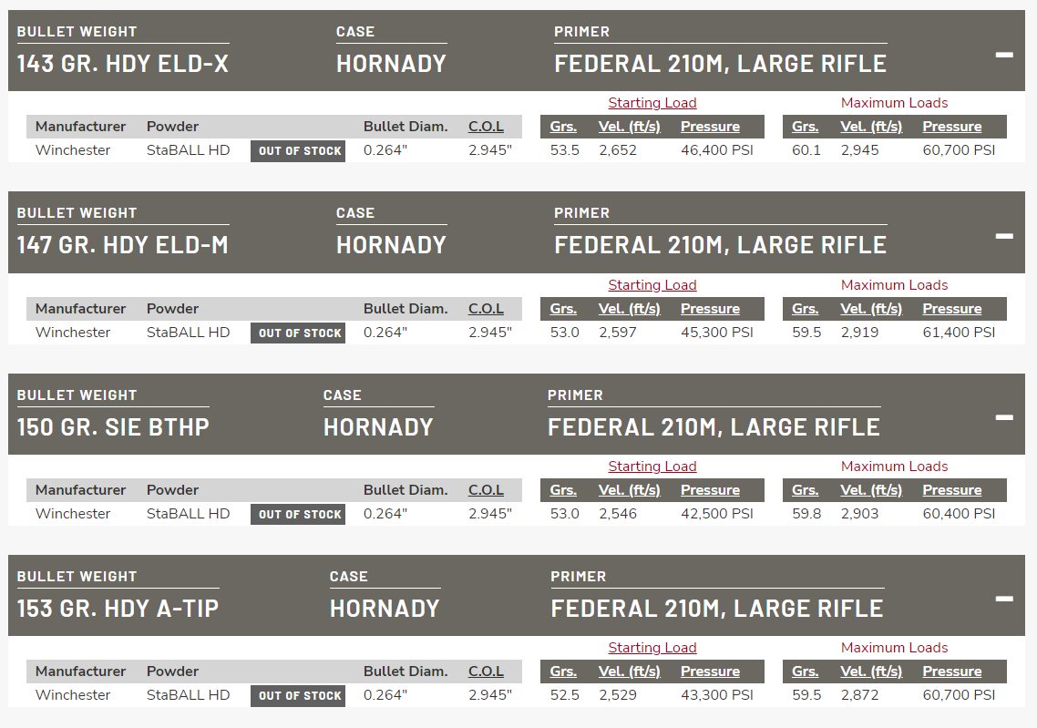

Also, it's funny how conservative Hodgdon's data on their website is for 6.5 CM with the 140 Amax . The current website loads show H4350 and Staball Match neck and neck for velocity at max pressure with a 140 Amax. Their website shows a max of 40.0gr H4350 at only 2660fps. I remember buying a case of early production factory Hornady 6.5CM 140 Amax ammo many years ago that was loaded with 41.5gr H4350. It ran 2830fps out of my 28" barrel and it was good for quite a few firings at that velocity before trashing primer pockets-- even in soft Hornady brass. Hornady's 10th edition manual shows a max of 41.5gr H4350 with the 140 Amax.

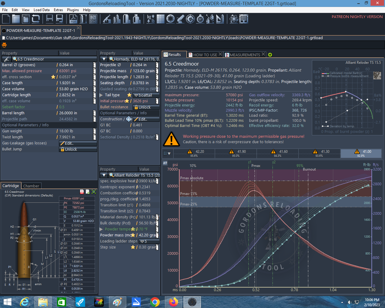

For comparison to the 38.5 Match load with 123 eldm @2840
41.0gr of 15.5, a mild load would be 2990 & 93% fill.
FYI - Gordon's speed prediction was within about 15fps for the RL 15.5 in my Creedmoor (on the low side). It doesn't line up for all powders, but it was very close with the 15.5.
It'll be harder to get consistent low SD's with a ball powder & low case fill.
IDK, I've seen the exact opposite. Case fill seems to matter WAY more with loads using extruded/stick powder than it does with ball powders.
That's part of the reason one can do mag dumps with hastily loaded 9mm using crusty range pick-up brass over a chrono and still get SD's in the low single digits. I've shot over 24lbs of StaBall 6.5 over the last couple of years, loading it at 41gn (~80% case fill or probably less in 6CM, loaded rounds sound like salt shakers when you shake them lol), still getting SD's in the 7-9 range.
There are a few exceptions, like in the case of Varget/SW Precision Rifle where the powder can make things easier, but mostly low SD's come from making good ammo and being a proficient reloader, and not much else.
Gordons Reloading Tool may be helpful to some (not me), but it uses some questionable algorithms and spits out a lot of useless nonsense too (as compared to real-world testing, which is still the only real way to do it IMHO).

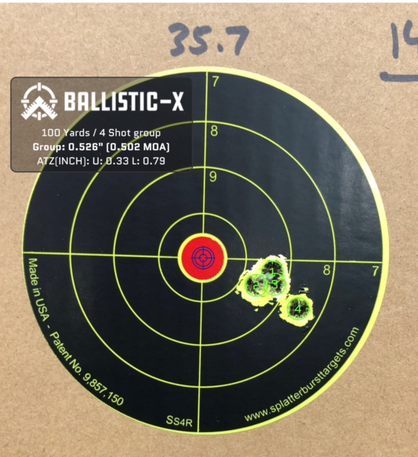

I had the opportunity to test the new StaBall Match as well as the HD. I did not test for speed. I took 9 calibers and built test loads. Here is a link to the article I wrote for Mossy Oak.

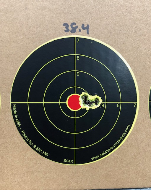

So, I was able to get out this past Sunday and try more loads with different weight bullets. Since I got pretty good results with the 123gr ELD match, I tried a few tenths on either side of the 38.5gr of staball match just to see if I could do any better.
I was able to get slightly better group with 38.4gr at an average of 2,789 ft/sec. Ended up at 0.345 MOA
I also tried some 130gr ELD's and some 140gr Barnes Match Burners BTHP. I didn't have much luck with the 130gr ELD's, but the 140's did pretty good with a 0.5 MOA on 35.7gr running at an average 2,555 ft/sec. Velocities with the 140gr were extremely consistent (35.7gr were all within 7 ft/sec) I think it would've been a lot better if I hadn't of messed up that last shot. I'm going to try loading some more around the 35.7gr range to see what I can do.
I have some 143gr ELD-X and 147gr ELD Match to try also.
