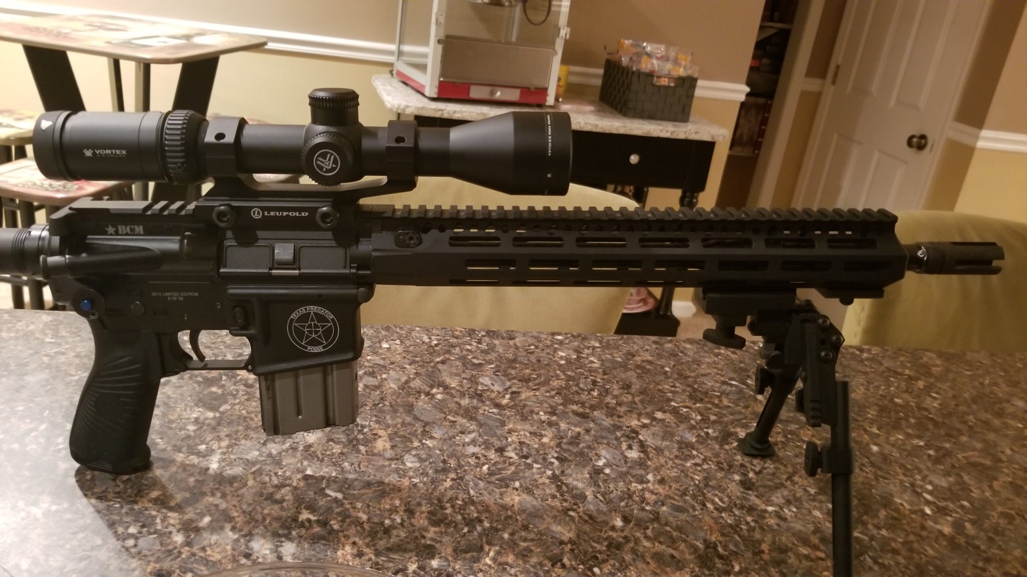

I have a 14.5" BCM that shoots Barnes 70gr TSX outstanding.
