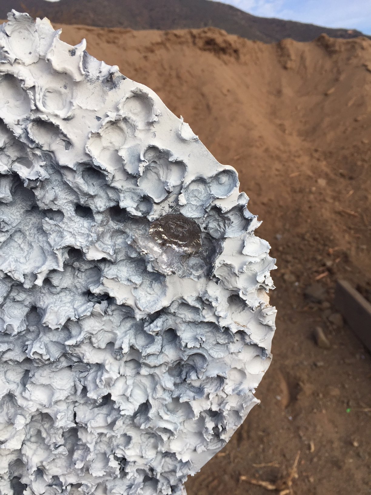

If you are shooting something major, shoot once and inspect for damage... If damaged, move it further away and get thicker for up close
Example of pitting... :)
