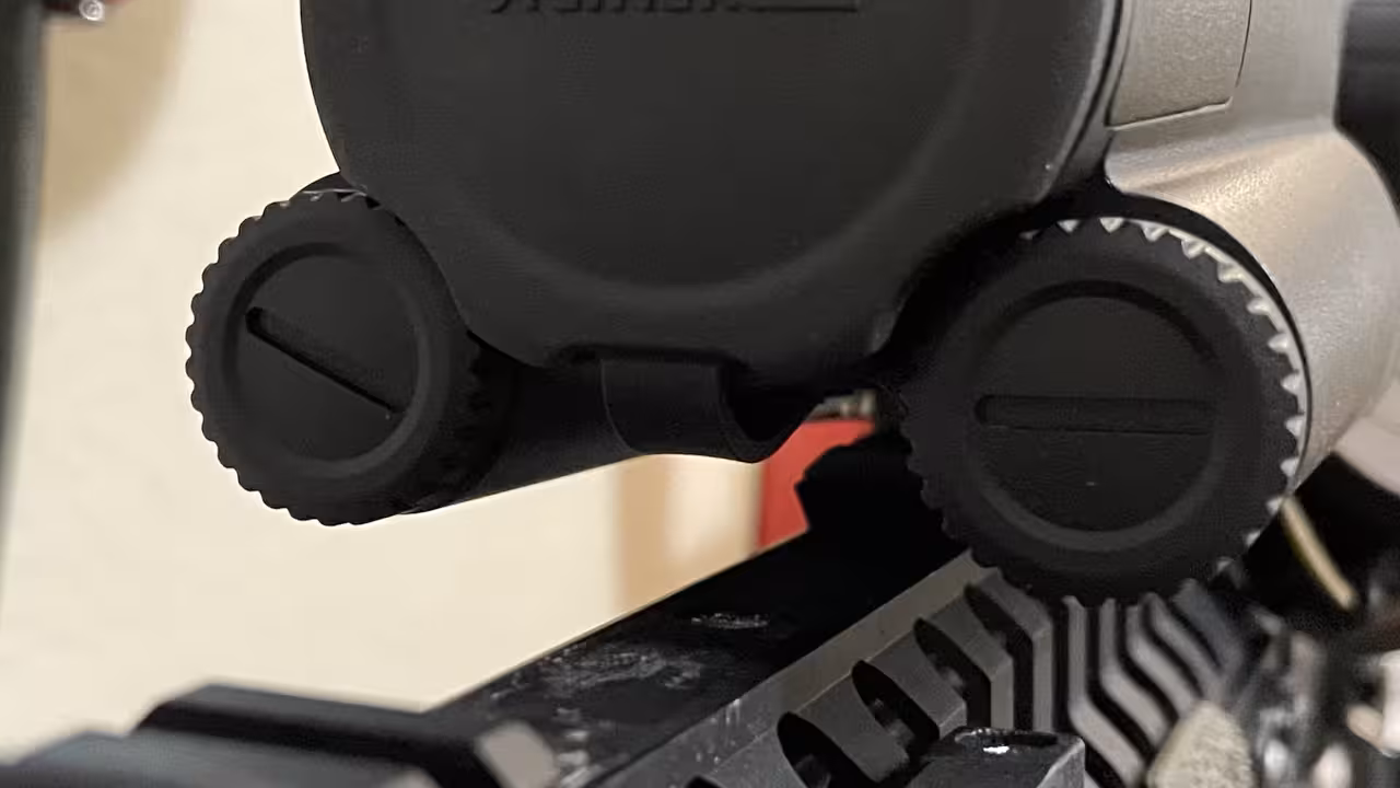

There is no focus ring, there is a focus dial on top of the unit which works really well.
RE: an eyepiece - the unit works well enough as a monocular without an extra piece.

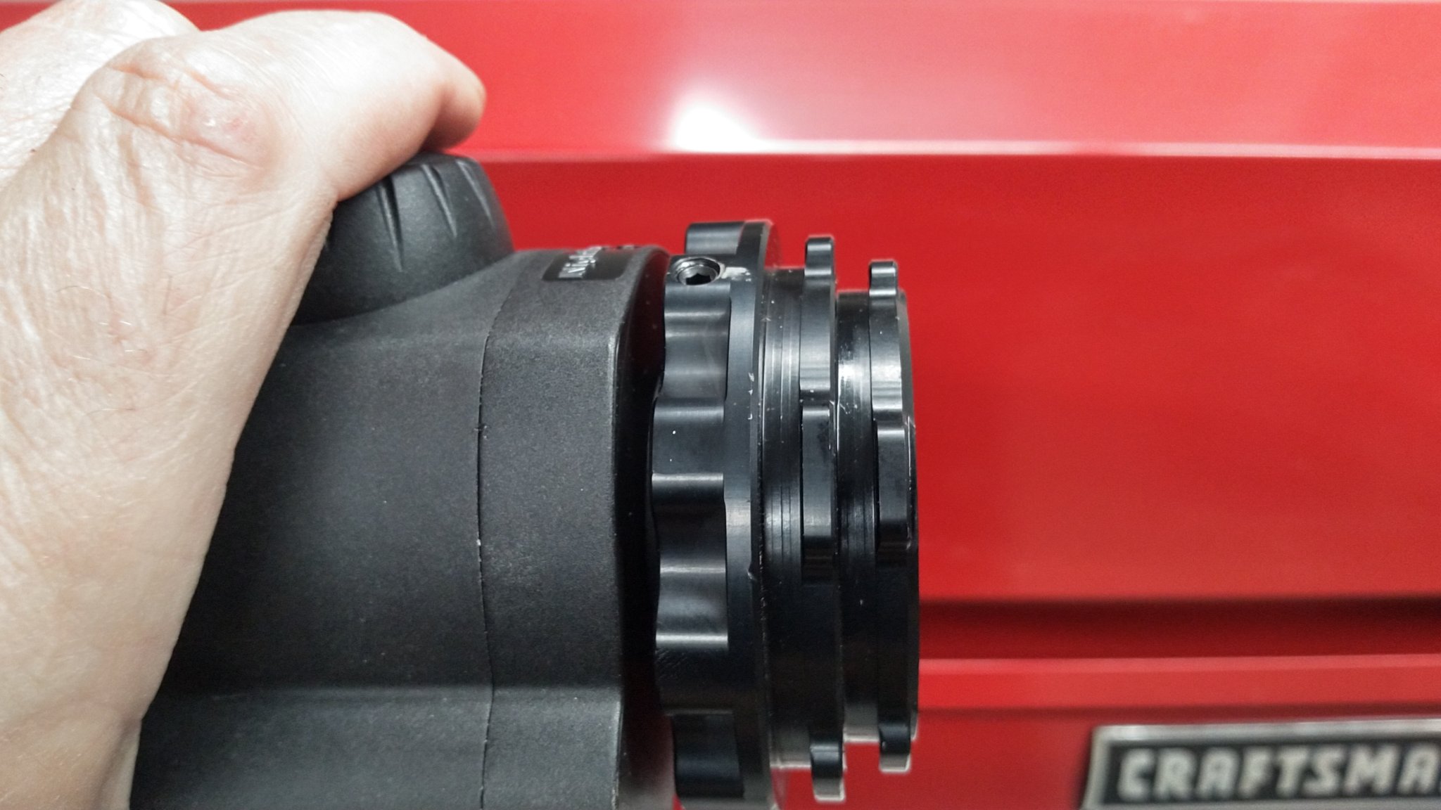

If you feel adventurous, you can still get one of the Pulsar PSP-V adapters and have a machinist make you a replacement part for the C35 to thread into. I'm almost certain it will work, because the Pulsar mount is made for M35x1 mm threads, and the Steiner C35 is M33x0.75 mm. So a replacement part with the Steiner threads is necessary, but the mount itself is big enough to handle it.
That was actually my plan. I have contacts that could likely do the machining no problem. I've seen the forthcoming mount and I'll wait for it. If it works like I think it does, there's more support for the C35 than the Pulsar mount.

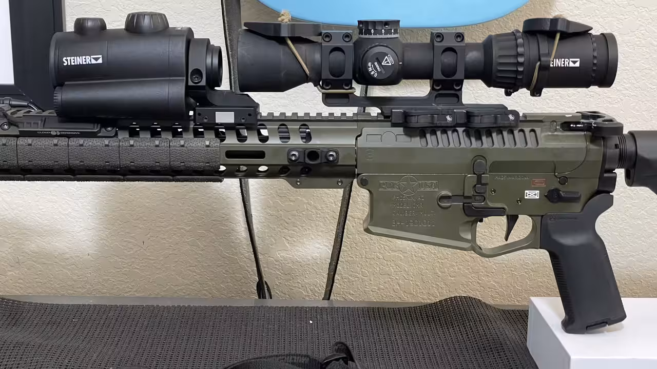

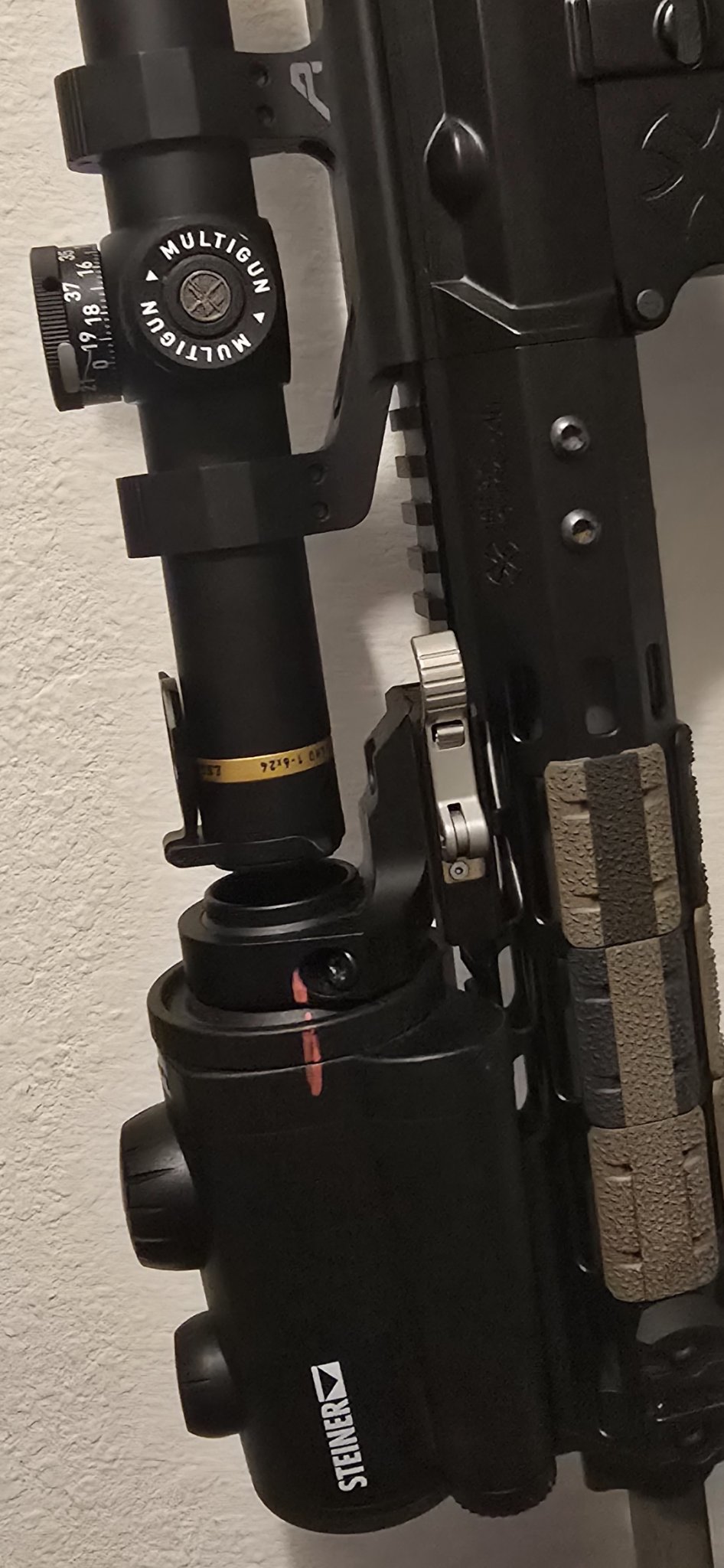

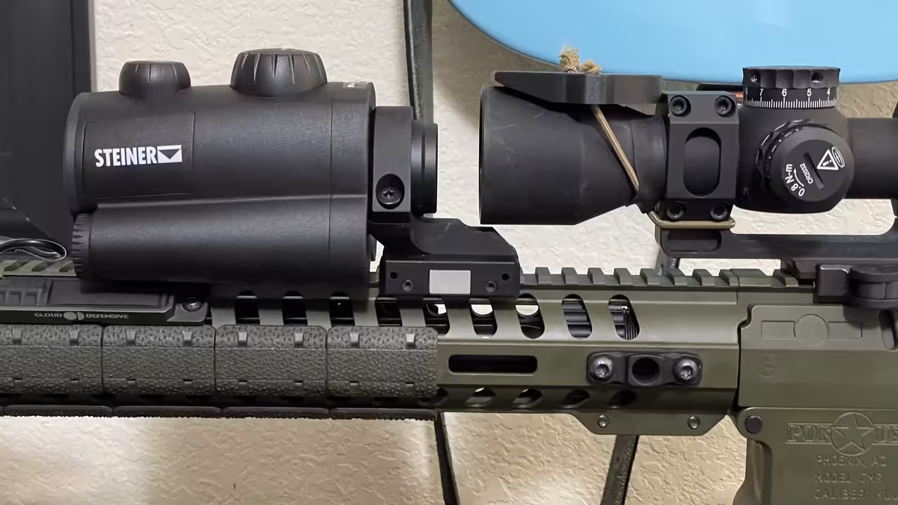

Posting this in both Steiner C35 threads. Got the temp Burris mount in until the new one is released. Works well with the Steiner 2-12x42 which is on my 308 gas gun. My mount is 1.54" but I'll be switching over to a 1.5" with that scope.
I tried it on my POF P415 which has "optional" top pic railing. It opens up some possibilities due to there being more room for something like a flip to side type mount. You'd have to bolt it on but it'd be slick. Other than that, with a rail bolted down, my PA PLxC 1-8 is perfect with the PLX mount (1.5"). I have a One Hundred Concepts pro cap with flash hider and there is no room between the scope and the thermal. I can't tell that there's a flash hider when looking through it either. So that's the easy button
I'd likely just use the 1-8 on the 308 gasser but it's nice to have options. I have a neoprene shroud on the way as well. I'll try to get some better pics in the near future. Zooming in at 8X is not a problem at all, can barely see the screen pixels.

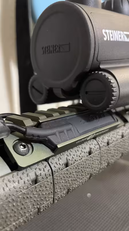

P415 gap.
w/flash hider in place
Gap without flash hider. If I clearance the mount, ever so slightly, I could get it flush.

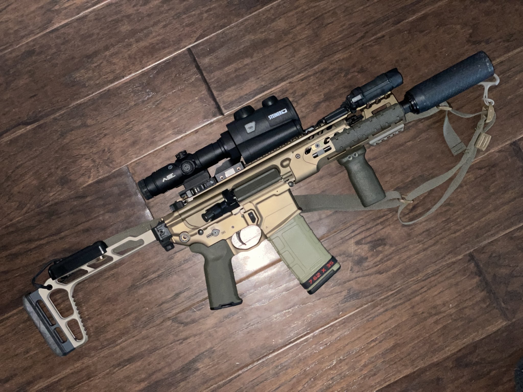

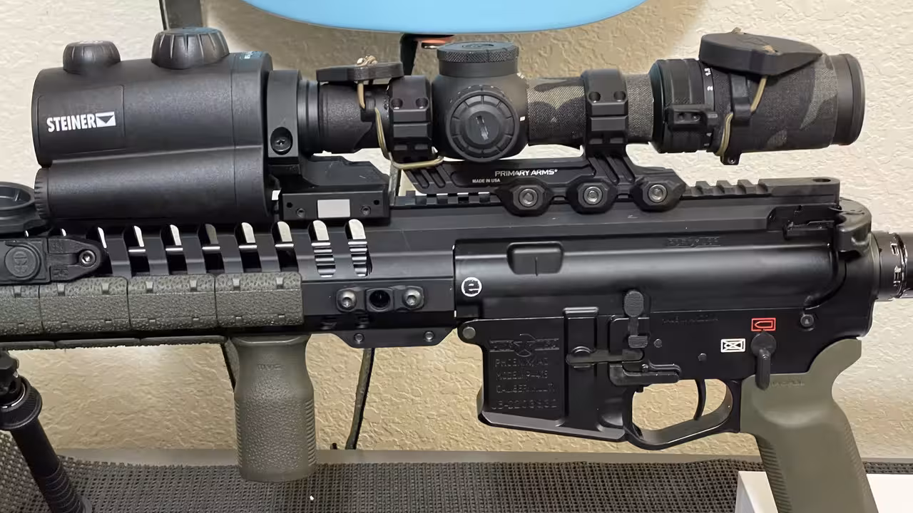

I've been experimenting to figure out setups for every rifle. I didn't even think about setting it up on my Spear LT in 300 blackout initially but thought it'd make a great, compact pig gun.
After a bit of research, I picked up a PA GLX 2x prism scope which has over 4" of eye relief. Messed around with a few QD mounts and the ADM QD worked out best from an alignment standpoint but it's not 100% perfect in other areas. None-the-less, it allows everything to mount over the receiver and not on the rail. Actually makes a nice, somewhat balanced package. I purchased the anti-reflection device for the GLX and thanks to an o-ring, it can be adjusted fore/aft by rotating the ring and extending outward to the point where it pretty much is up against the back of the Steiner. I do wish the C35 looked a bit more tacti-cool but I can live with it.
I went out to the range and took three rifles. I dialed the Steiner in on all three and it was actually pretty intuitive once the first one was done. Has three memory slots. Five would be ideal but I'm thinking if I have the same scope/mount on my other rifles, one of the three presets would be pretty damn close. The alignment numbers up top were a bit hard to read in daylight but it's easy enough to position that area of the screen over a featureless area where the numbers were then visible.

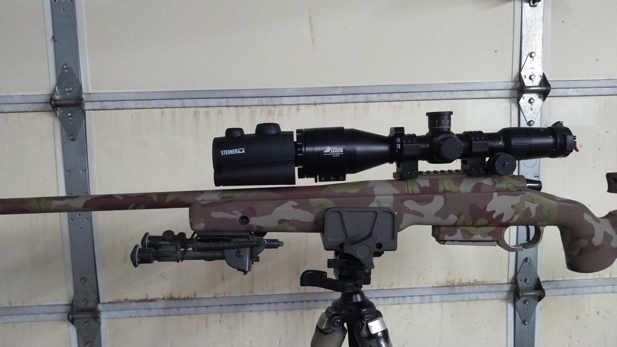

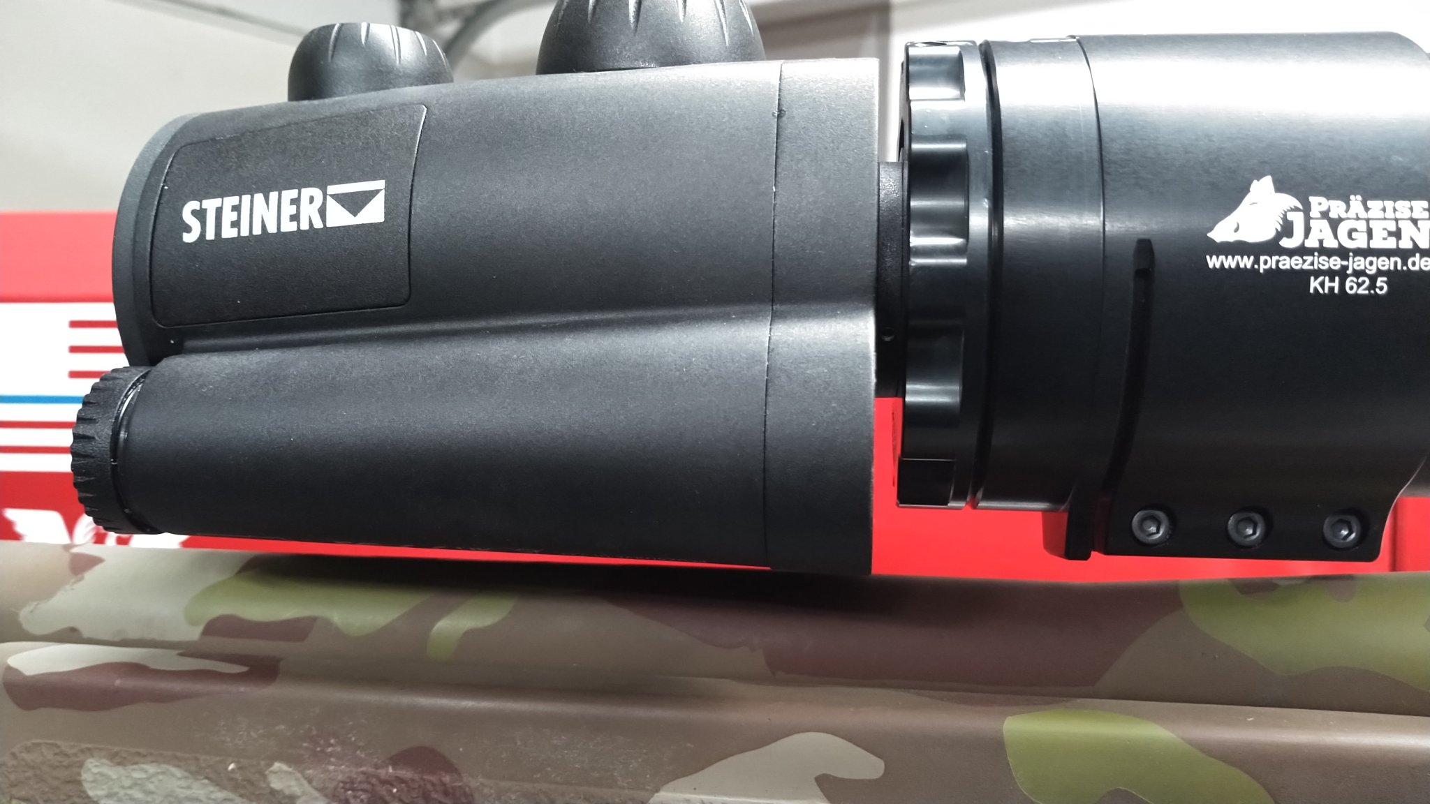

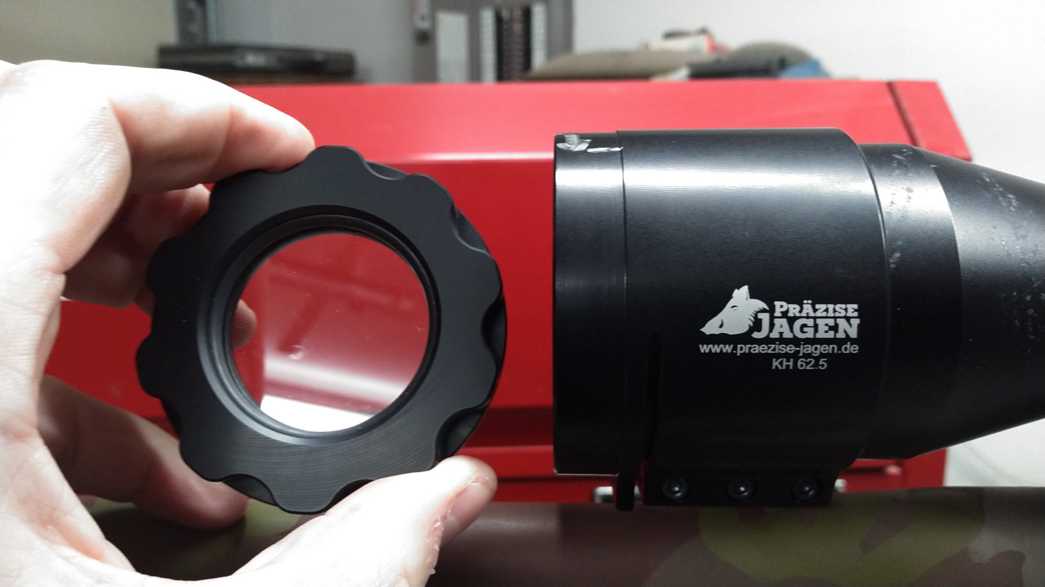

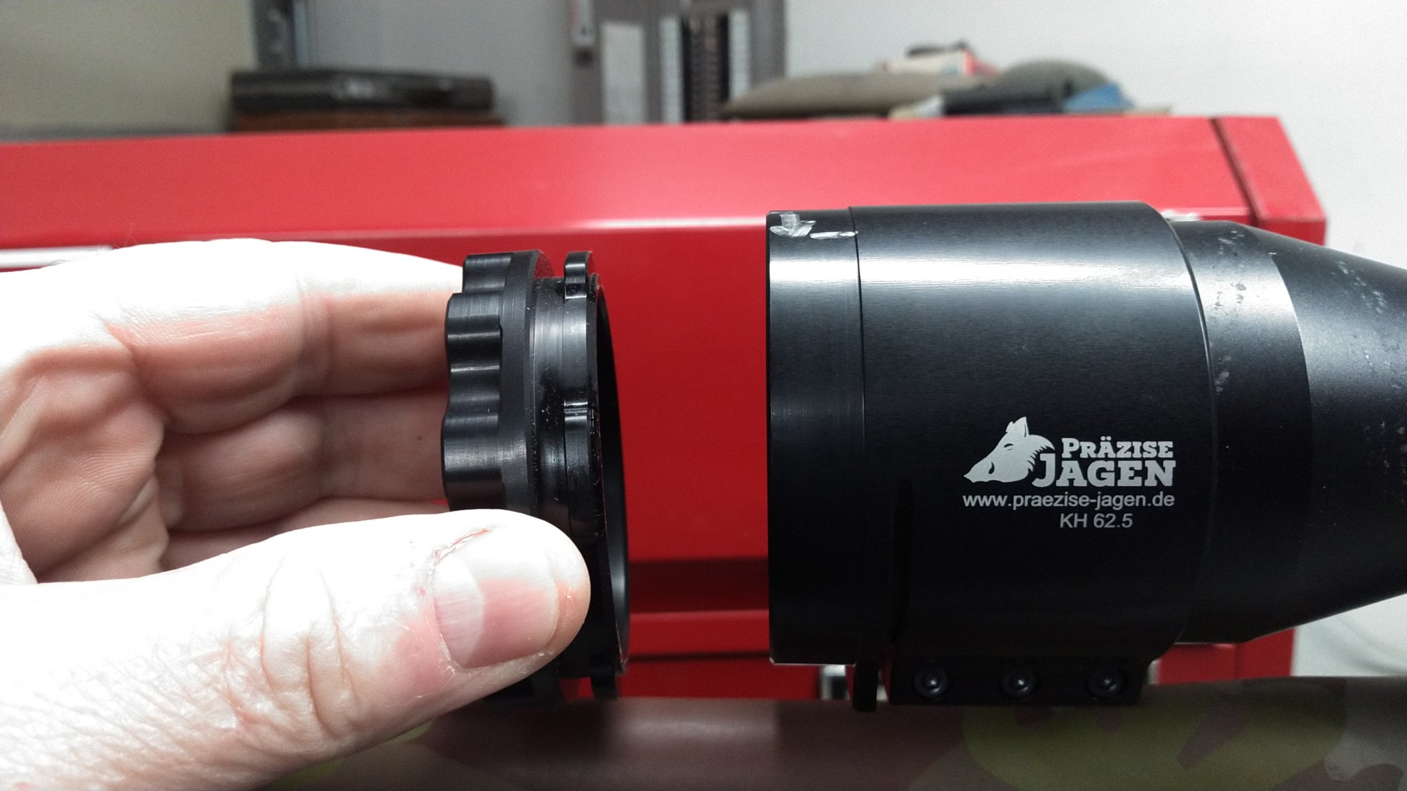

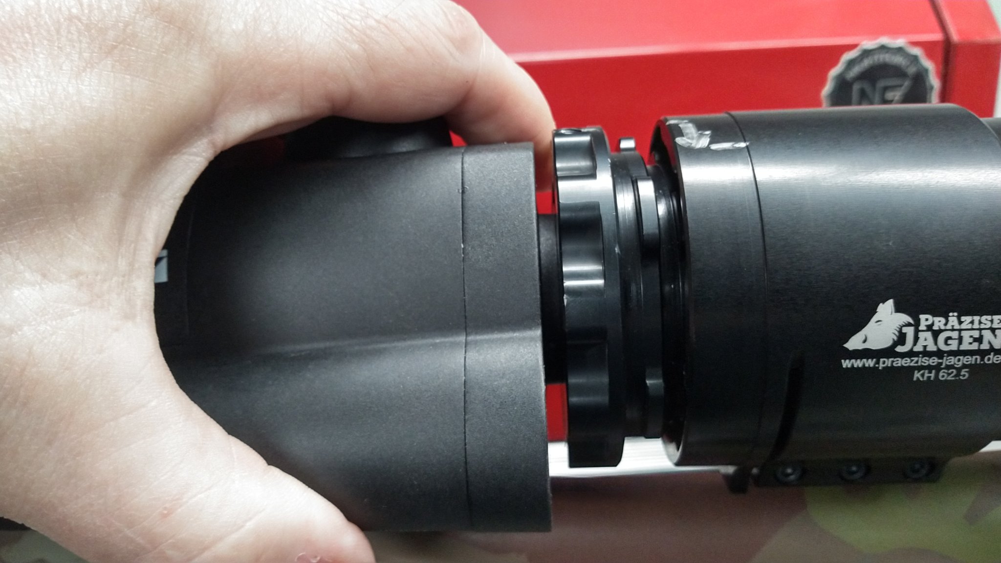

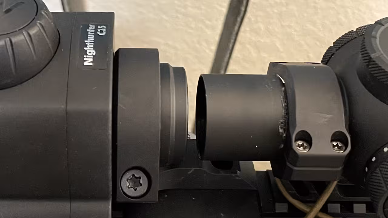

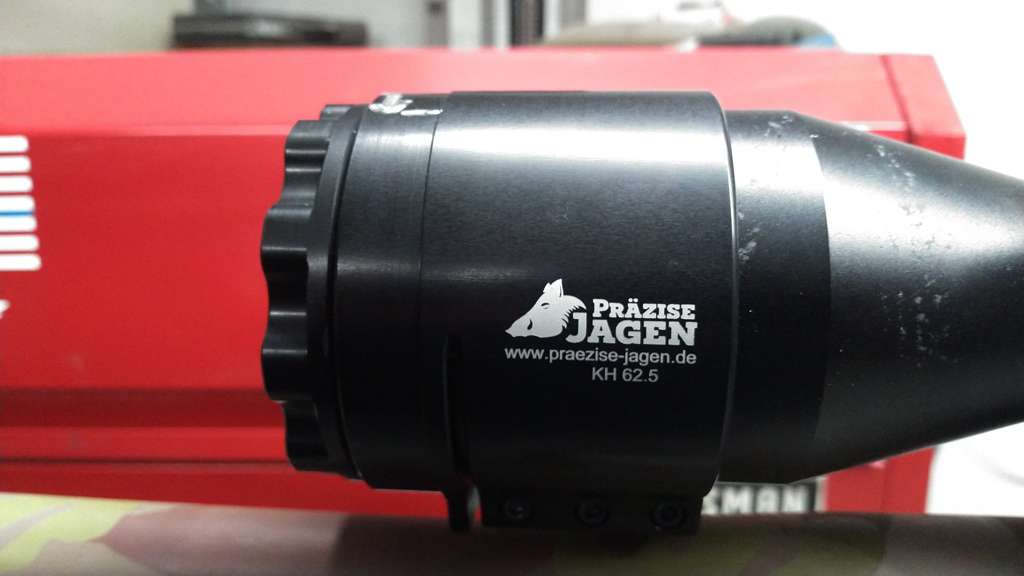

I bought the Praezise-Jagen mount for my C35 Gen2. So far it seems like a very good and solid option, especially for rifles that do not have forward mounted rail systems. This system seems well made and is easy to use. Easy on and off of the thermal. I also got the see through front lens cover. You will definitely have to correctly measure the outside objective diameter precisely and shipping takes about 15 days because of customs.

I got the mount directly from them ... http://www.praezise-jagen.de/ Shipping took about 15 days because of customs and it was sent DHL to my door. If you order make sure you get the OBJ lens measurement correct.
1 1 KH-61 Base-Clamp for diameter 61mm 151,26 € 151,26 €
CTC: 7616 9990
2 1 DV-M33.5 Duo-Connector thread M33.5x0.75 79,83 € 79,83 €
CTC: 7616 9990
3 1 KH-VKG-G Dust Cover large with glass (for Base-Clamp from 62mm) 58,78 € 58,78 €
CTC: 7616 9990
4 1 VP Shipping 33,00 € 33,00 €
Sum 322,87 €

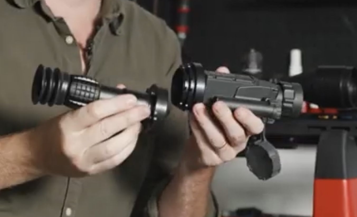

IMO, I think it's realistic. There are companies that make 2X and 3X eyepieces that work with the Steiner but they're European and you'll need to import them. The Burris is literally just a rubber tube/eye cup.
Now that you mention the Euros, Praezise-Jagen did have some eyepiece for sale for clip-ons, but it is kinda long. I found it on one of the only English-speaking videos about Praezise-Jagen.
See 8:05 on the below vid
It’s the thing in his right hand.
RE: other Euro eyepiece clip-on adapters
Would you happen to know the name of the brands?
