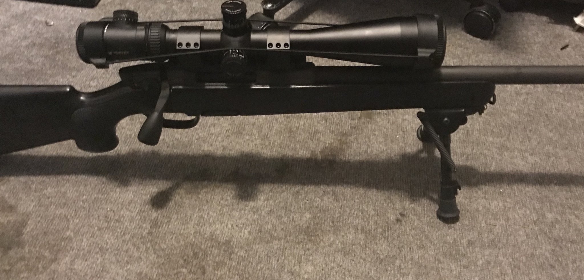

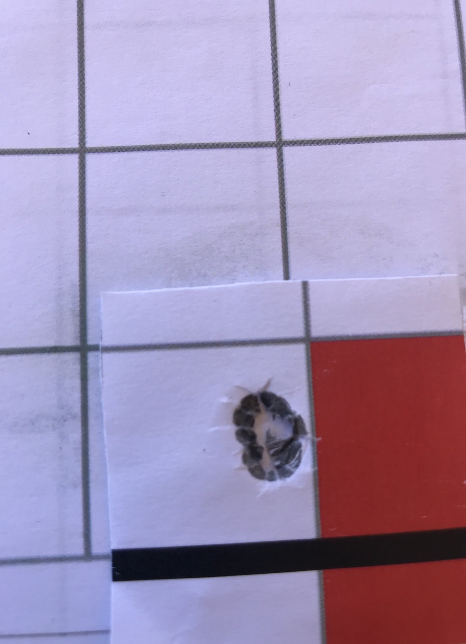

Yes, I sent the first one back to Steyr so they could evaluate it. They had no idea. Once the bore was fouled it would shoot one hole groups with match ammo. My first one came with a khales optic. This is my current rifle with a vortex.

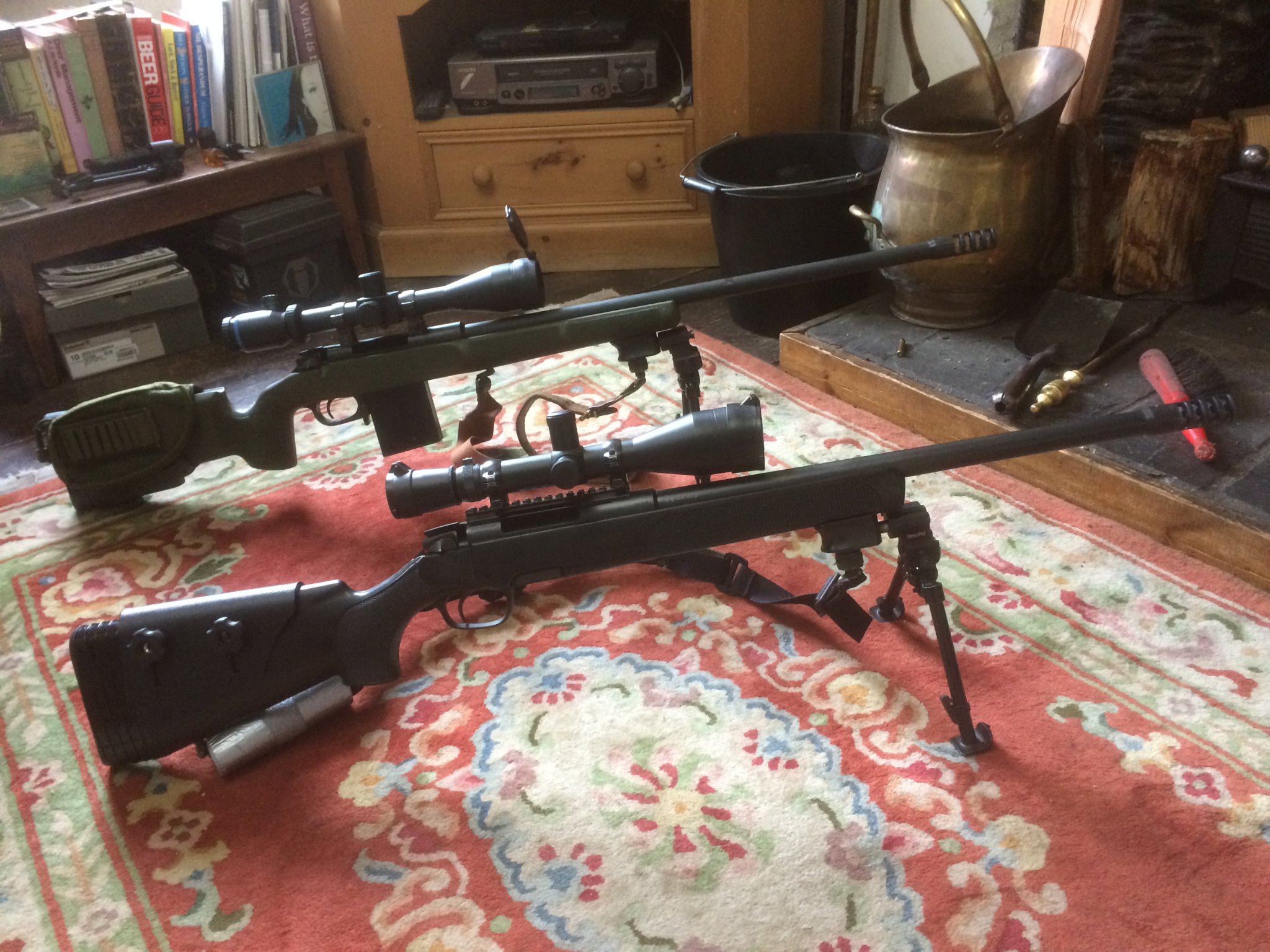

McMillan or Hogue? Also looks like factory rings/mount if memory serves me. Mine, if I’m having a good day...

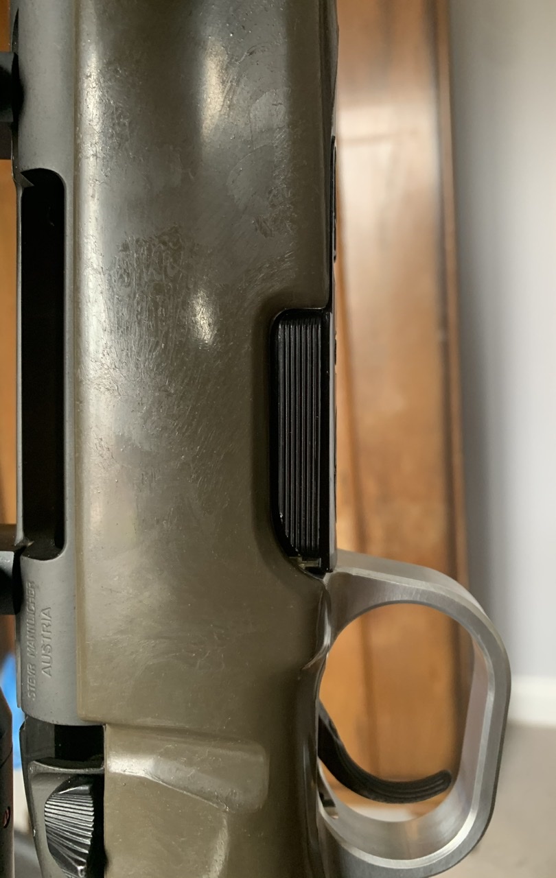

DV is that a Styria Arms steel trigger guard? I'm envious! I've eye'd those for a number of years, but couldn't justify the cost, even after my original factory plastic guard broke, as they are prone to. I was able to get multiple replacements, but they are factory plastic also. it's made me reluctant to shoot my 1st gen SSG-69. Very nice rifles you have there!
Hi, yes it is, managed to get one second hand. It's a superb piece of Austrian over-engineering weighing 3lbs! Not ideal for a rifle you intend to carry around. My shortened SSG has an 'accurizer' which is a steel bushing let into the action screw hole in the trigger guard. It acts like the pillar in a pillar bedded rifle and stops the plastic being crushed. Expensive but it does come with a new trgger guard/mag well.

DV, the accurizer modification is interesting, but my trigger guard broke at the two side magazine detents and would no longer hold the rotary magazine fully. I really like the ability to use AI mags in the Steyr with the Styria Arms, but for the $500+ US and shipping/ customs charges, I can't really justify. They are very rare here in the US. I've had my Steyr since the early 1980s and plastics technology of that era is notorious for age embrittlement. I fear parts will become unavailable with production ended and bought 3 factory trigger guards while they are available.

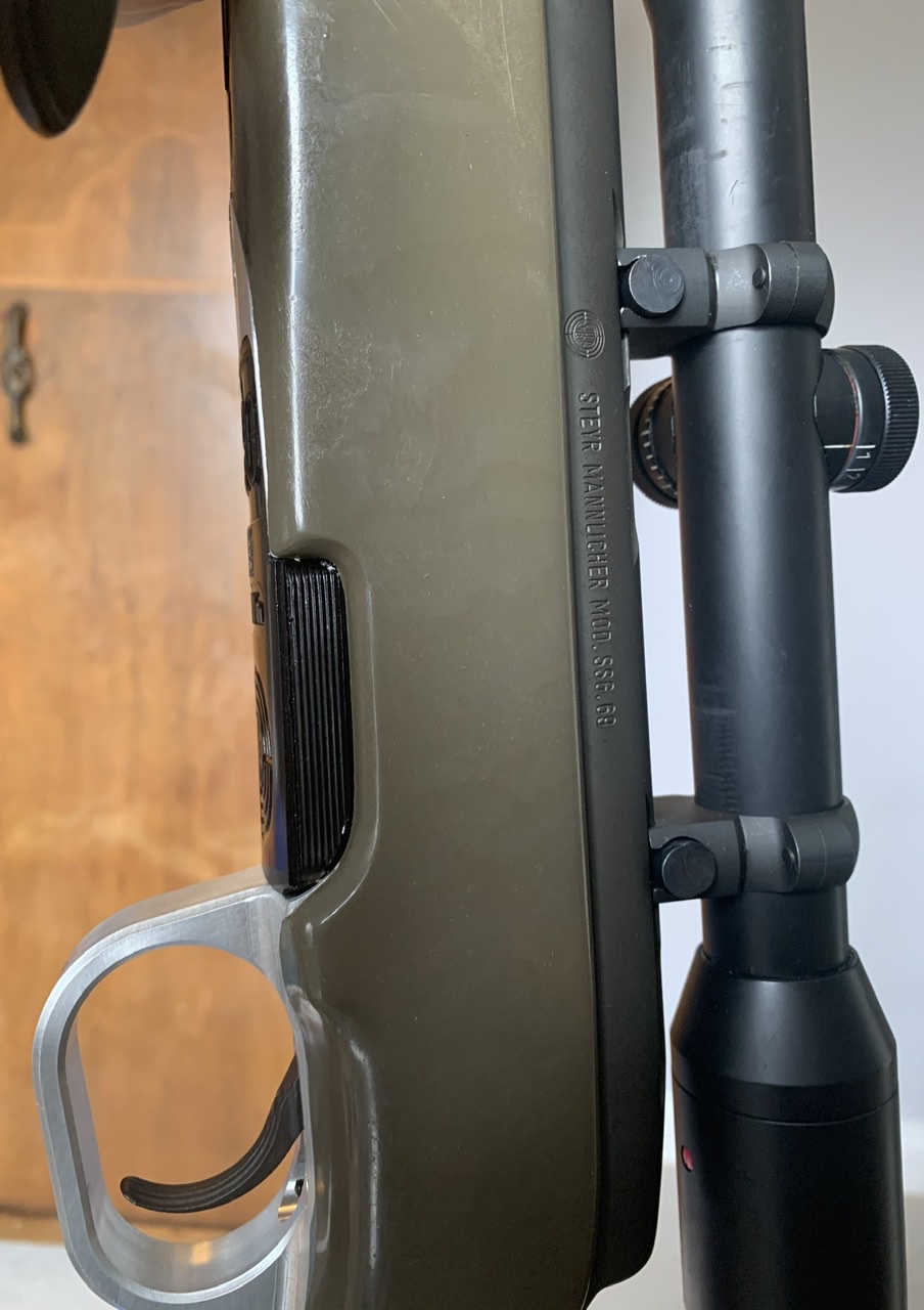

I have a tip about CNC machined aluminium bottom metal to take the original magazines. Waiting for a reply.

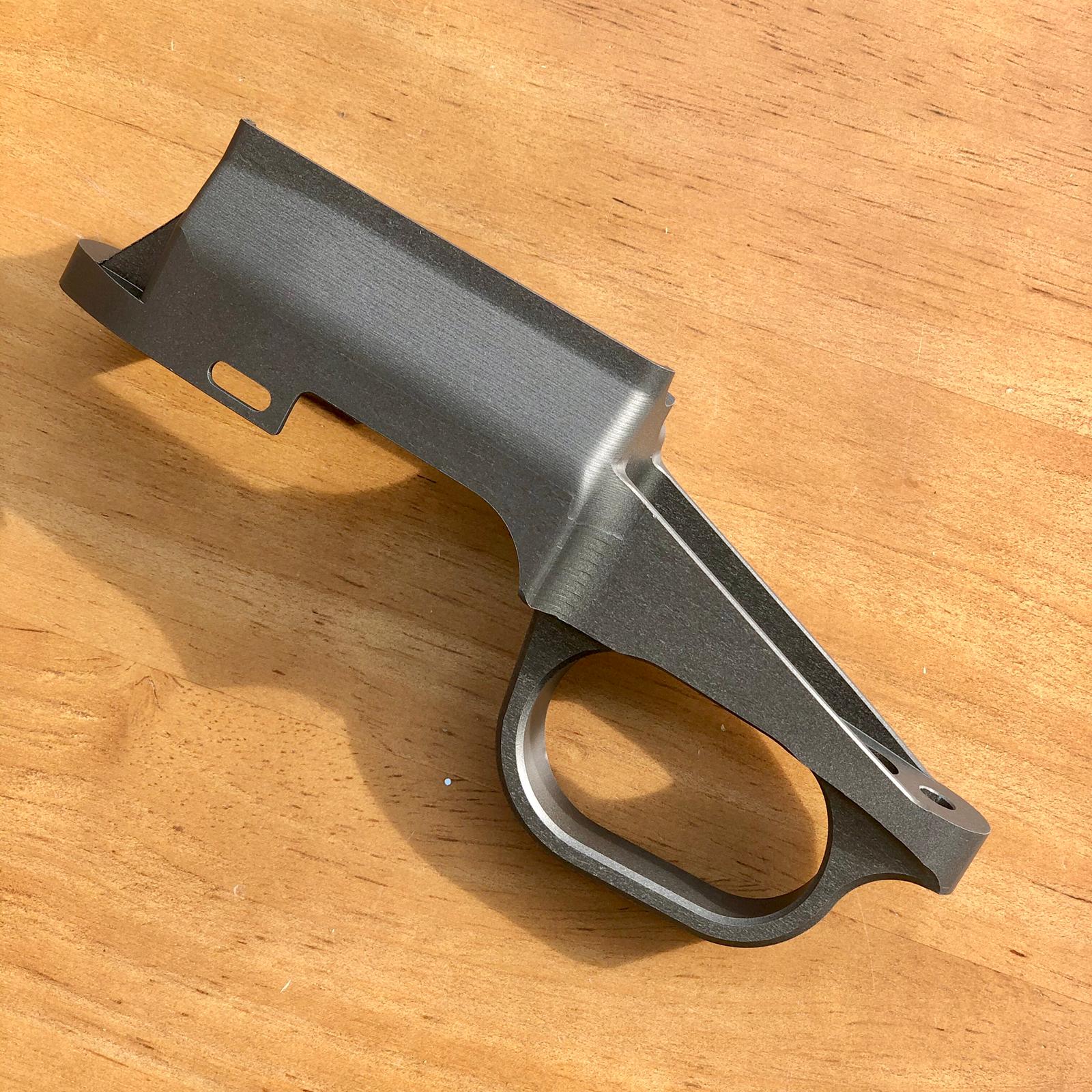

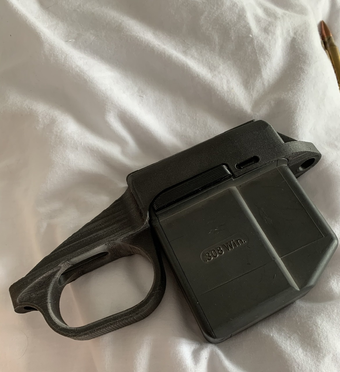

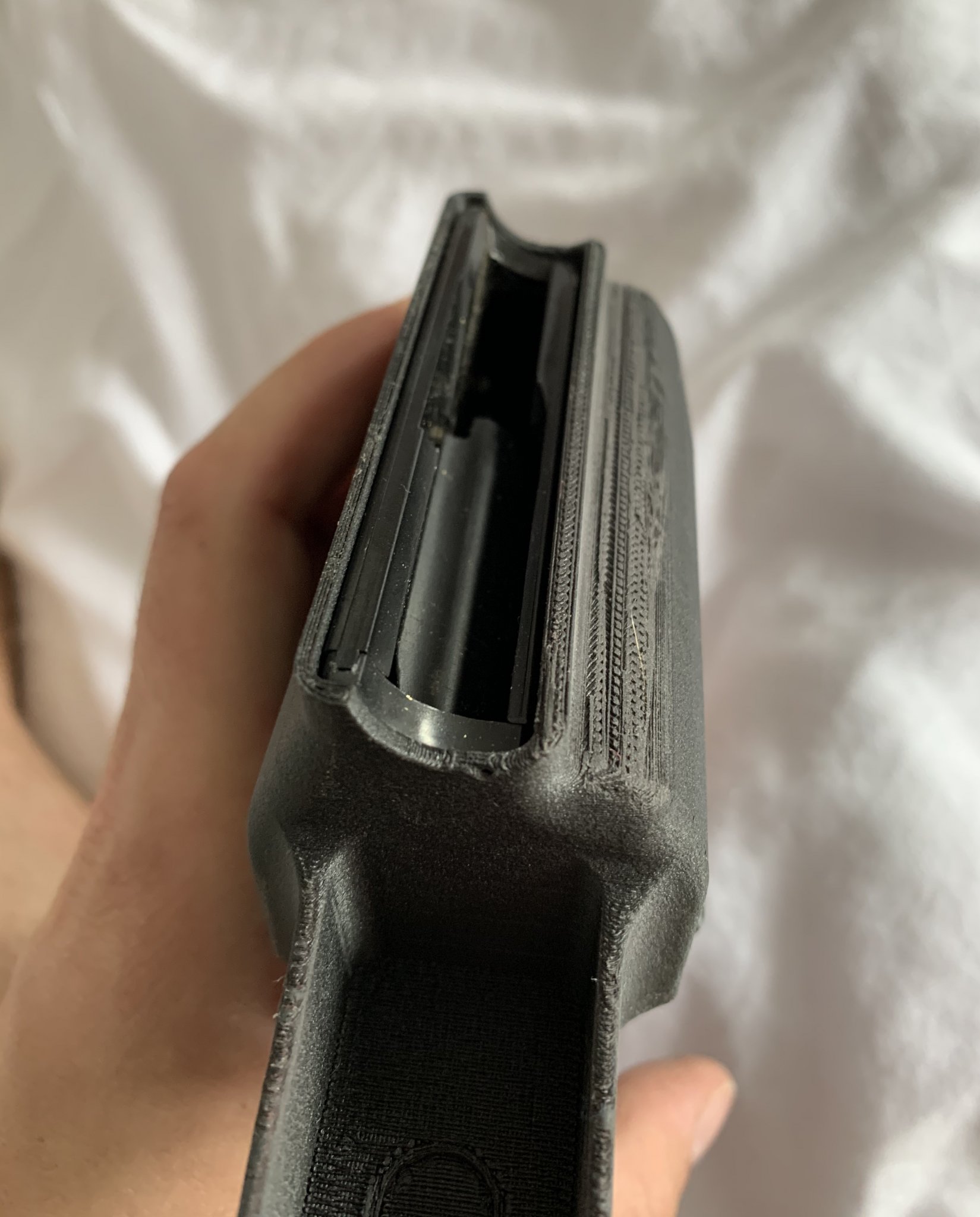

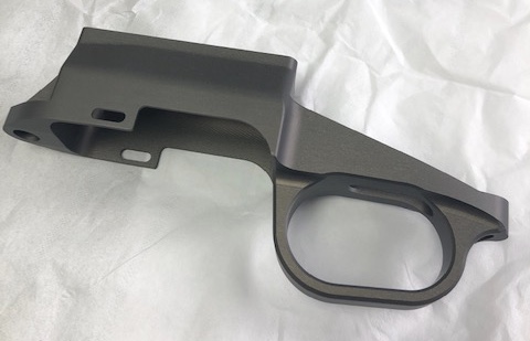

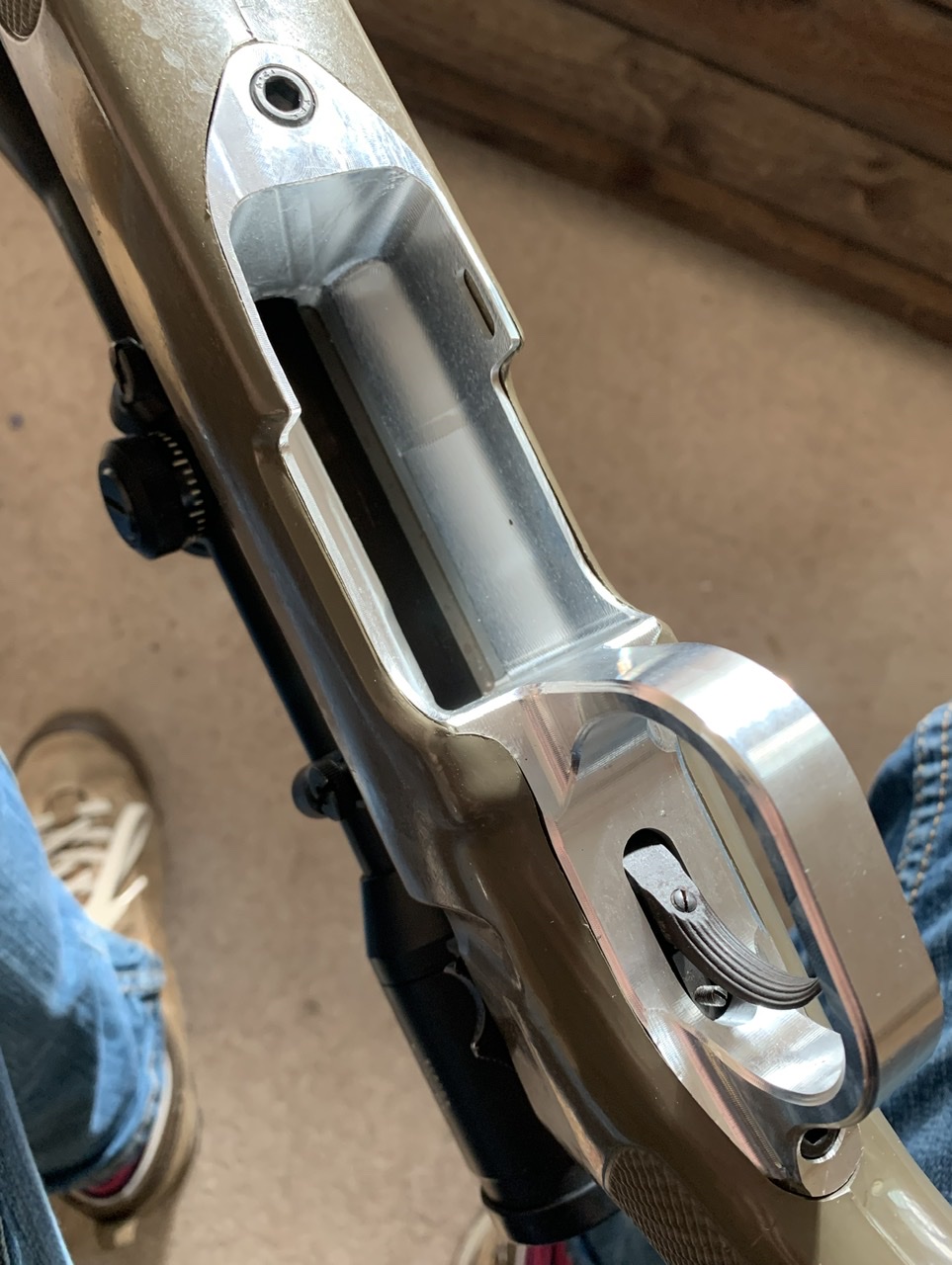

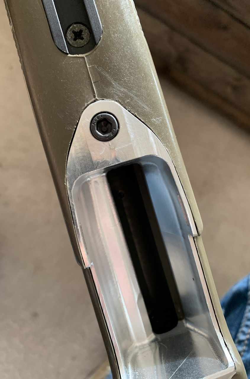

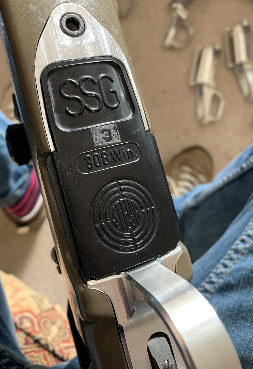

Not sure if that’s from my efforts! I’m currently working through production of a CNC replacement magazine housing that will accept the original mags, along with a couple of other guys in the UK. We’ve had a few 3D printed prototypes made to test fit and function. Waiting to hear back now about a price for having a quantity machined out of 7075-T6 aluminium.
Here are some pics of the latest plastic housing:
Looks good to me. I would like to see it in aluminum when you get to that point. My steyr is new/old stock, but I’m sure at some time I’ll be looking for one. Also hoping ur development price isn’t extreme...

Thanks, will definitely post pictures of the completed version.
No, thus far it’s been surprisingly cheap. We’ll also probably explore options to use AICS magazines with it in the future.

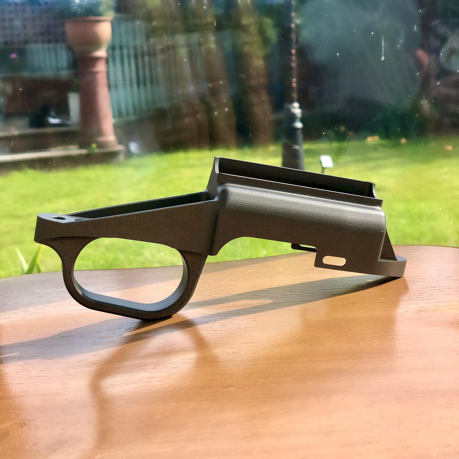

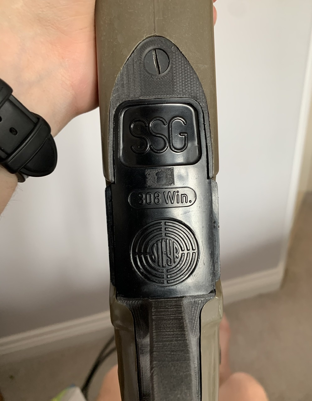

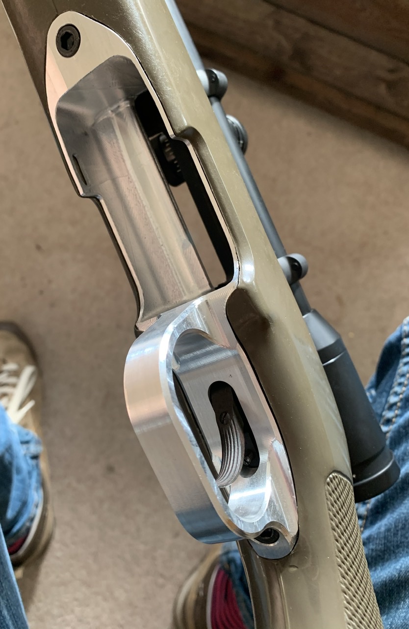

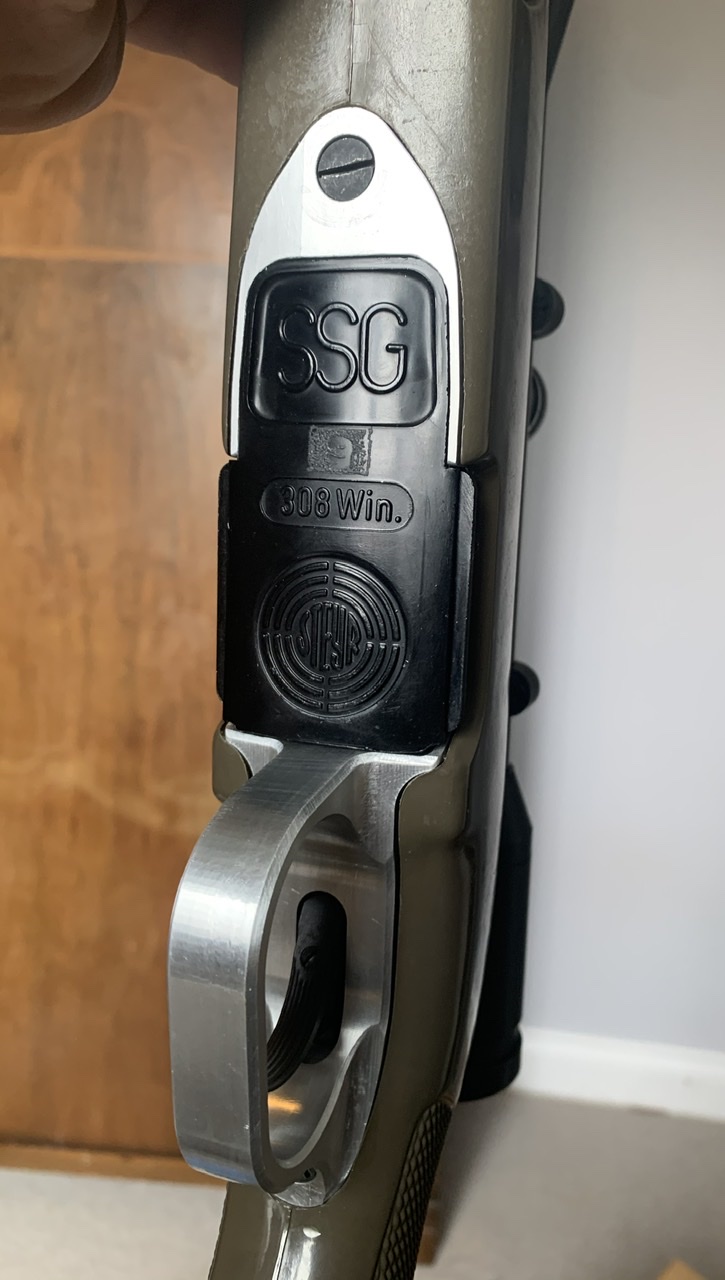

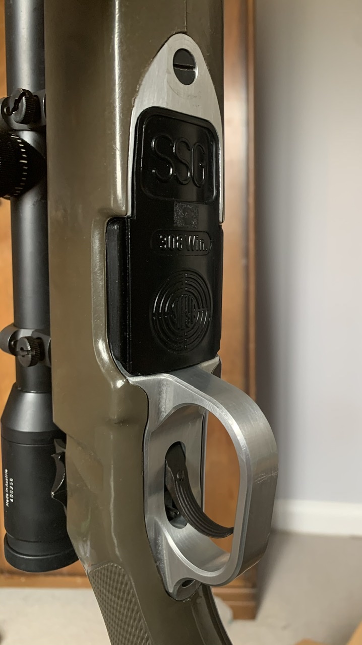

The rest of the batch is here! Unfortunately there will be a delay to them being vapour honed and anodised but hopefully it won’t take too long! They all fit and function perfectly.

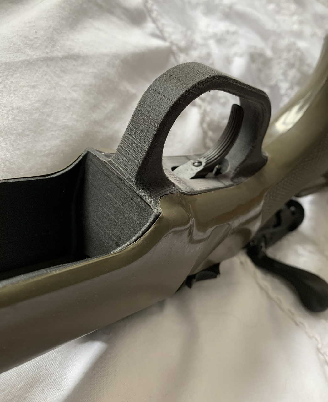

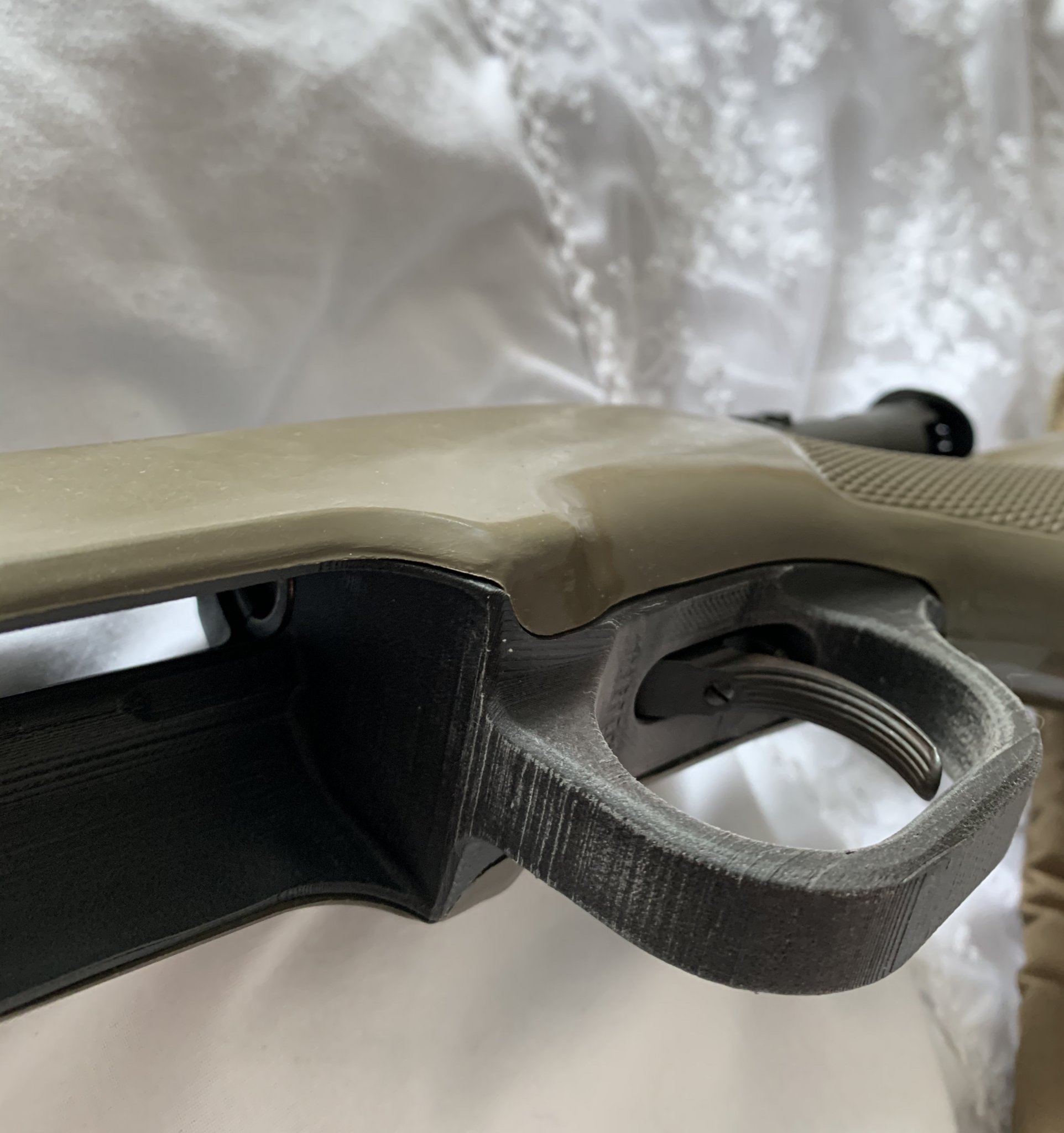

Looks great! Forgive my ignorance, but was the installation difficult?
Not at all - it’s an almost drop in fit. They may require a slight amount of stock fettling but all this took in mine was a very slight push to seat it down.
My stock has had a lot more wear than usual as of late with all the different prototypes!
