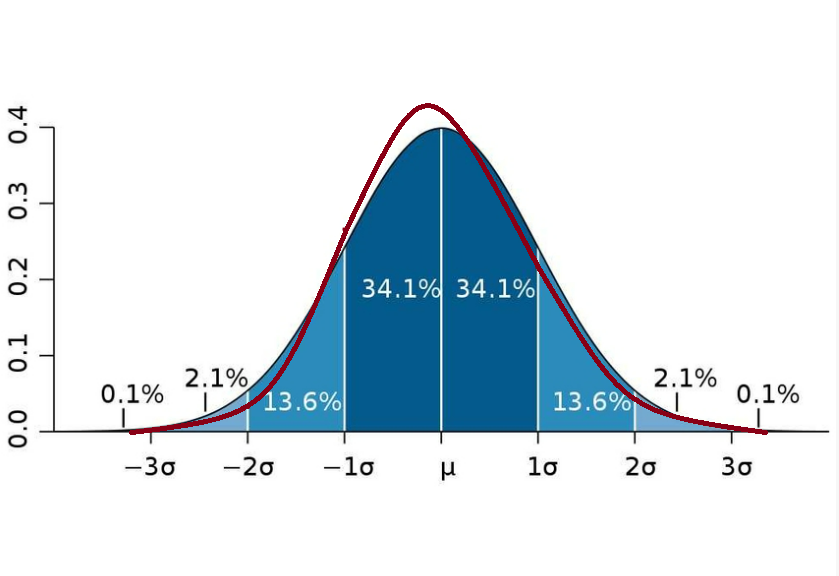

    Let me just preface that stats is not my jam. I have an education in it and use a variety of sampling techniques in my job, but I'm by no means an expert.
    Yes, we should assume a normal distribution and 2 sigma would mean that 95% of the population is within that distribution and 5% are on the outlying edges of the distribution. The higher the sigma value the lower the odds that a given result is outside of the range of distribution. That's why in Physics, for example, you tend to see 6 sigma as the gold standard, but for what we're doing that's nuts. It's kind of like trying to measure powder charges to +/- 0.0005 grains; those kind of fluctuations are insignificant to what we're doing.
    So that dark portion above is 1 sigma and from what I'm gathering from your questions, you're thinking that we should instead be looking at the lighter wider 2 sigma section? What we're generally looking for with low 1 sigma SD values in shooting is to get an idea of how spread out the velocity values are from the mean. Why not do 2 or 3 sigma? Honestly I don't know - the math isn't necessarily harder. I suspect it's just that for the small sample sizes we tend to test with (n < 10 or n < 30) a higher sigma probably doesn't really contribute more.
    Not an expert here, but I did take statistics too. Knowing the std dev gives you one or two or three sigma values already, as you mentioned 2x, 3x, etc. Yes 2x std dev captures a higher amount of your shot velocities, but at the end of the day, you are still looking for the std value that gives you the most consistent velocity. Whether you use 2 sigma or one std dev, it's the same effect, smaller std dev means more consistent velocity. Knowing one gives you the value of the other. Using the same terminology keeps it easier to compare different values.
