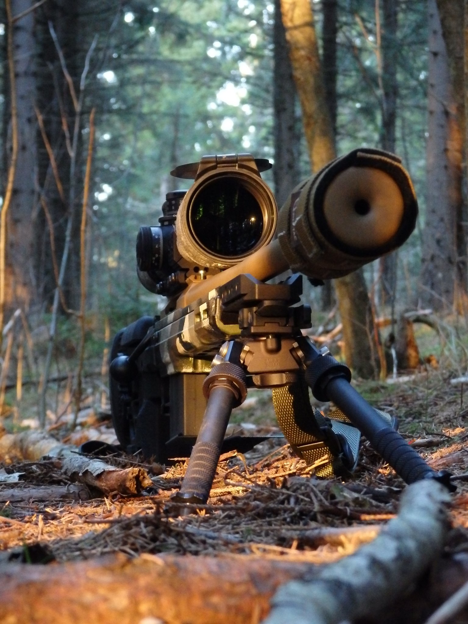

I had Bravo but i bought TRG rear stock for it, and now it is a totally wicked rig.
Little paint and cerakote on the barrel and action.

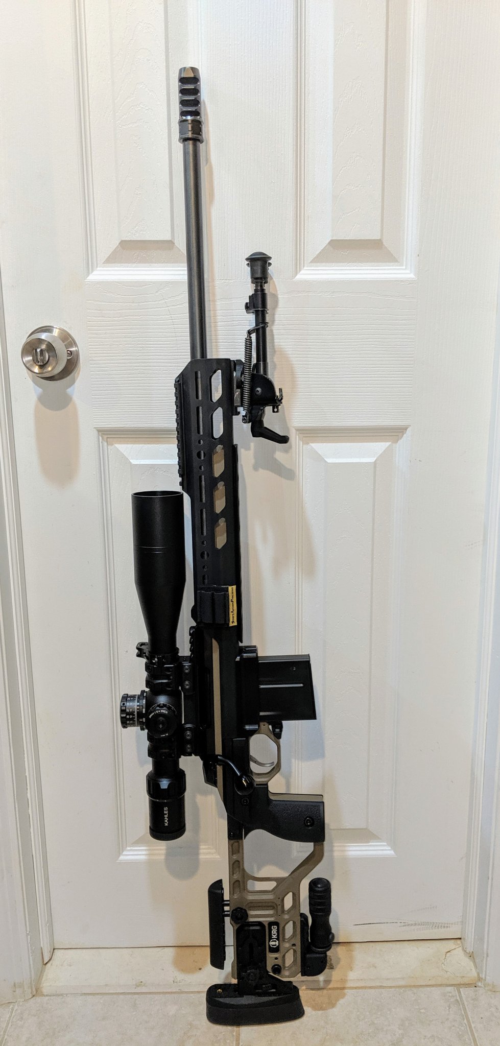

I ordered a Bravo that will accept CTR mags from KRG. I'll see if I can post up some pics once I get it on.

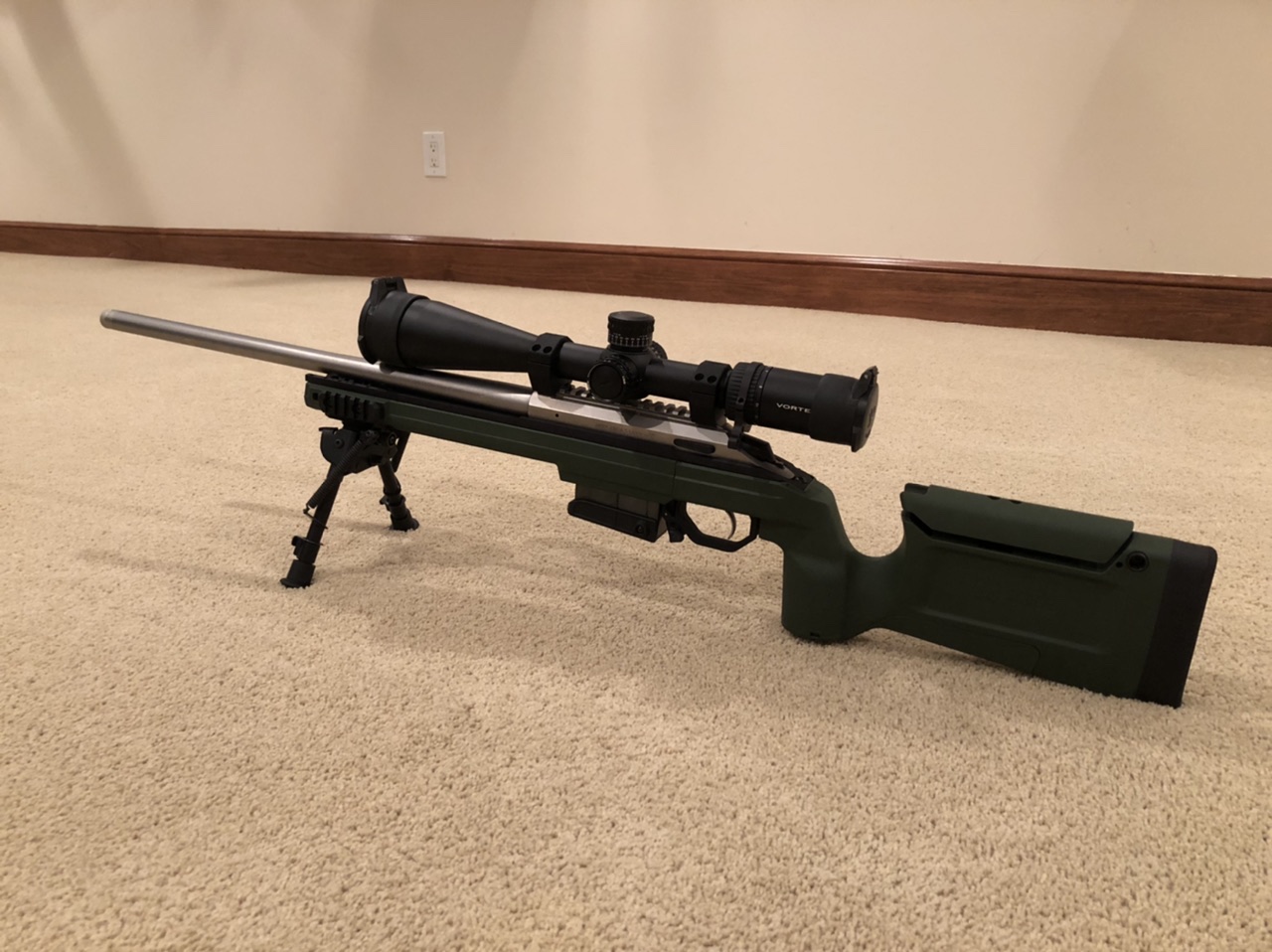

Just got my Bravo installed that accepts CTR mags. Went with Harris inline direct mount. Seems to drop and hold CTR mags very well. I also don’t think I’ll need the LOP spacers that came with it either. It seems very comfortable and I’m pretty sure I’ll like it better than the factory stock.
Just got my Bravo installed that accepts CTR mags. Went with Harris inline direct mount. Seems to drop and hold CTR mags very well. I also don’t think I’ll need the LOP spacers that came with it either. It seems very comfortable and I’m pretty sure I’ll like it better than the factory stock. View attachment 7323188
That looks great. If they'd had this option when I purchased, I certainly would have bought it. The mag is a $100 add-on for those of us not already invested in AICS. So the price difference goes up a bunch between Bravo and Manners now that they offer the CTR option. And I do like the look of it and it's certainly a big upgrade over the factory stock. Stocks are the only factory component that doesn't live up to Tikka's quality and performance standards - they are cheap and uncomfortable.
