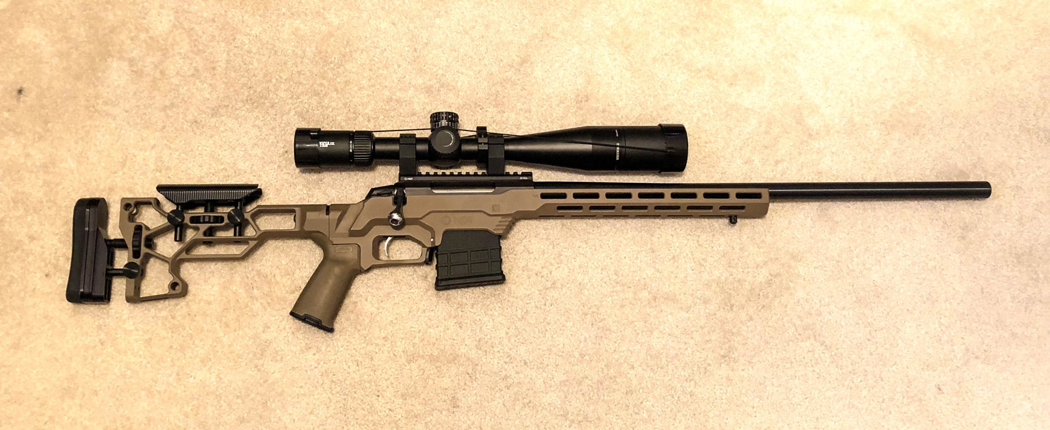

Tikka T3x Varmint (same action as CTR) in MDT LSS-XL Gen-2 with MDT Skeleton Rifle buttstock and MDT magazine. Scope is a Vortex Viper PST 5-25.View attachment 6958814
Looks great, I've really be on the fence between a TAC A1 or a CTR in this exact same set up. How do you like the MDT LSS-XL Gen 2? Also never considered a Varmint model. Besides the threaded barrel are there any differences? Looks like the barrel profile is a little heavier? How does it shoot?

If a TAC A1 had been available in .223, I would have bought it. But it wasn't (nor is the CTR available in .223). I wanted the longer, heavy barrel for better velocity, also a 1:8 twist was a requirement.
The rifle shoots well. With Defender Ammunition's 69-grain SMK match ammo, 1/2"@100-yard groups are quite consistent. My experience with heavier loads is limited; Defender is veteran-owned and not too far from me and the price on a 1000-round case was good so that's what I've used almost exclusively. Interestingly, the Hornady Steel Match 75-grain HPBT that shot really well in my DMR-config AR doesn't work for beans in the Tikka. I've tried a handful (literally) of other factory and handloaded rounds and none have done any better than Defender 69 SMK. Bulk 55-grain ammo is predictably inconsistent.
I like the MDT LSS-XL Gen-2 stock just fine with one minor quibble: the grip pushes my hand/trigger finger down maybe 1/4-3/8" further than I'd like. The excellent customer support at MDT tells me their ESS chassis system would have given me that.
One other thing: The Varmint comes with the plastic stock and 5-round plastic magazine. My copy sat in its box unfired until the chassis and MDT 10-round magazines arrived. I'm sure the stock and magazine combo is adequate - probably better - for hunting, but I wanted the rifle as a PRS-style match trainer so the factory stock and magazone will never be used by me.
I like the MDT LSS-XL Gen-2 stock as well but it is simply too light. One of the things I'm trying to overcome with a new stock or chassis is that the rifle is too light and unless you are holding on to it when in the prone, it will jump off target.

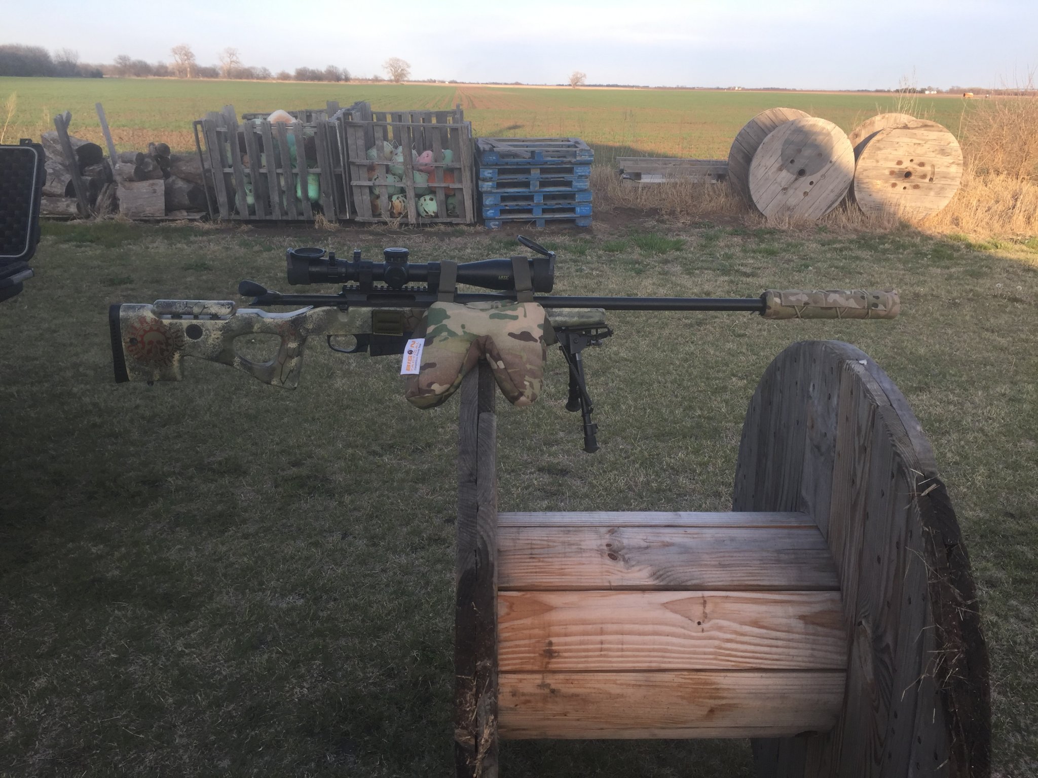

They can easily be threaded for not a lot (as mentioned). I had my .223 threaded and couldn't be happier (especially now, since I can use a can or brake on it). The rifle is an absolute hammer on prairie dogs...

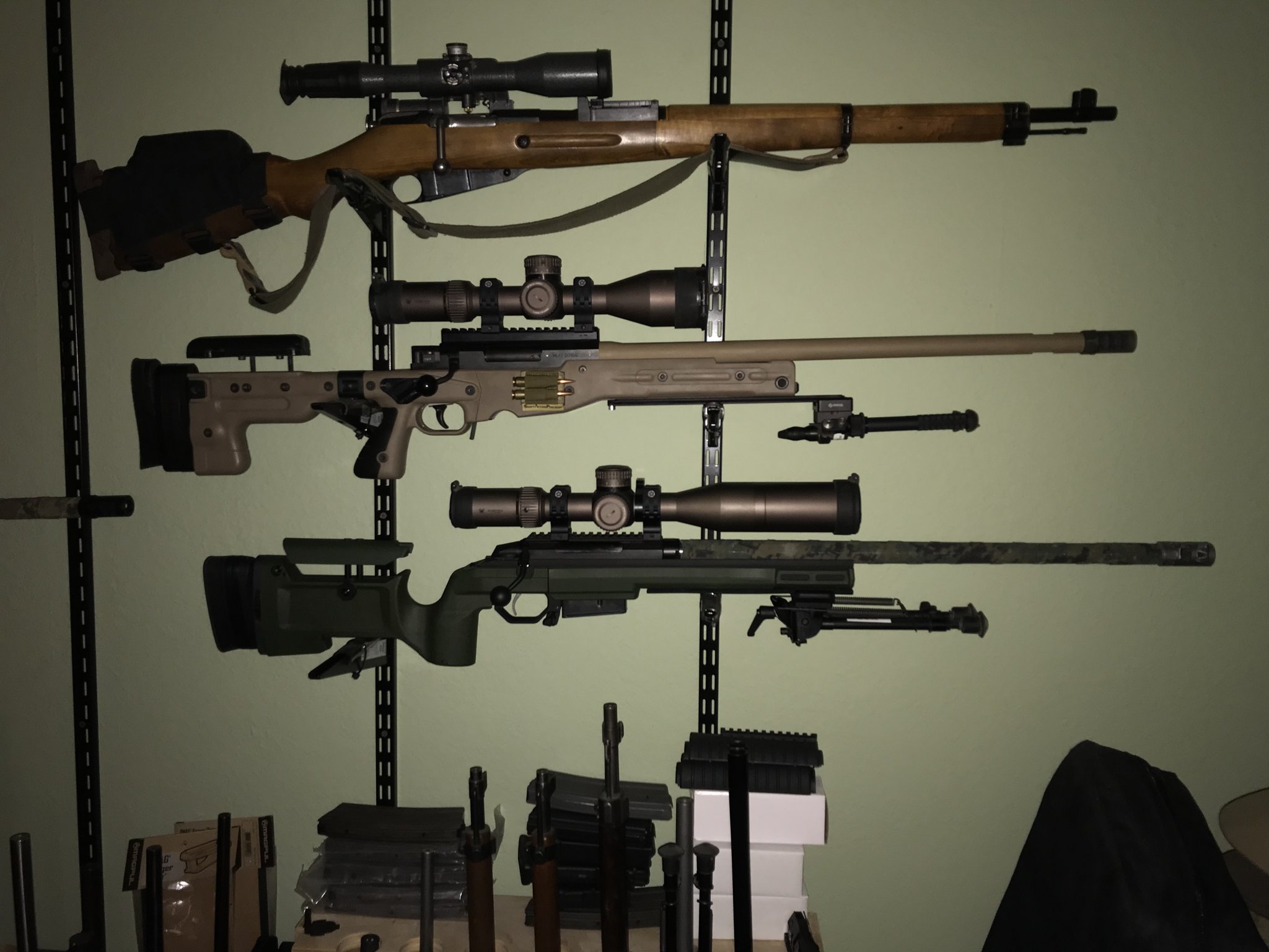

Gotta love a chassis system that has enough space between the forearm and what is obviously a monster class barrel for you to clad it in camo wrap and still (I assume) have it free floated!

Not sure, it was whatever the Marine PX had on the shelf.
Edit: Now that I'm at a full desktop system (not cell phone) and can easily search the web, I can confirm that it is McNett tactical wrap.
Reactions: patriot07
On the .223 it was to cut down on the mirage (I noticed just laying out in the sun, that the black barrel was creating a mirage without even shooting it, regardless of whether I was using a can or not). Hence the lighter color wrap.
With the CTR, it was done because the barrel is in the white (raw steel), and I hadn't decided whether to have it cerracoted, duracoat it myself (which I'm set up for) or to just leave it be, since the barrel will probably just get shot out and make painting it a moot point (basically...I'm being lazy).
I hear ya on the coating. I see all the cool colors and fluting and finishes... and then when I start adding it all up, I think 'WTF would I spend another $125 for the coating and another $125 for the fluting for a barrel that's going to last a year, maybe two?' Now on a .308 Win or .223 Rem thats going to be around for a while... maybe ;)

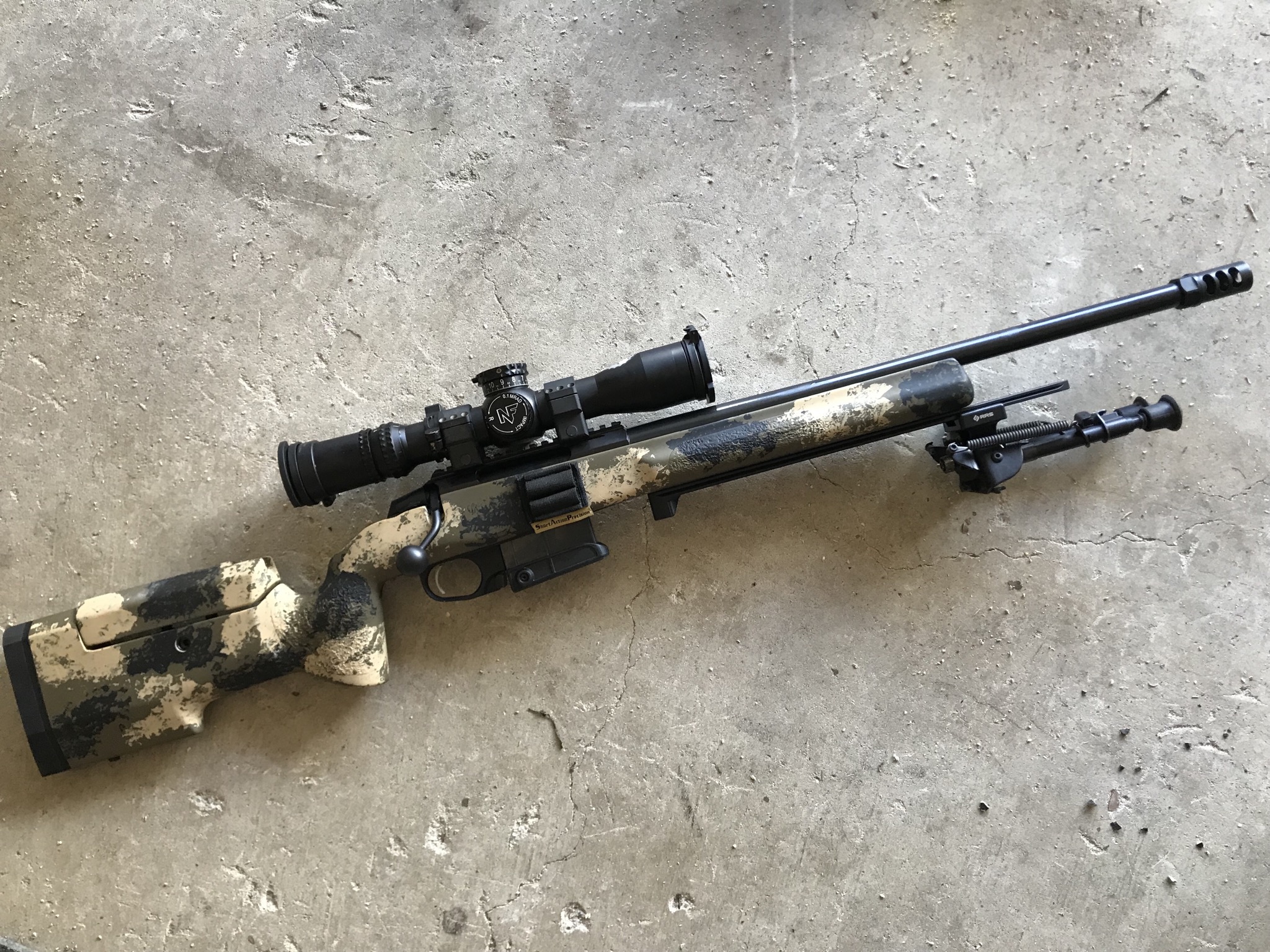

Manners T4A with CTR inlet
How is the accuracy after you dropped it in this stock? Did you have to bed it? My CTR in 6.5 is shooting submoa as it is. I just don't like the length of pull and the cheek piece has lots to be desired. I don't want to drop $700+ dollars for a new stock that makes the accuracy drops. Appreciate if you have any feedback on that.
Hi mate, accuracy was around 0.75MOA with factories (168gr sierras and 185gr juggs), I only shot about 30-40 rounds through that barrel so it had barely settled. I can't really report whether it did or didn't require it because the sample size is so small. I didn't have any issues without bedding, however, when the rifle returns to me (it's currently getting a new barrel), I'll assess whether it needs to be bedded or not after shooting it in. If it does, I'll give it a crack myself, I need a summer project.
I have been told that it is recommended that you bed these stocks due to the material being compressed when tightening the action screws to factory torque specs. Happy to be corrected on this though if anyone knows otherwise.

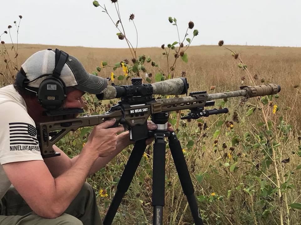

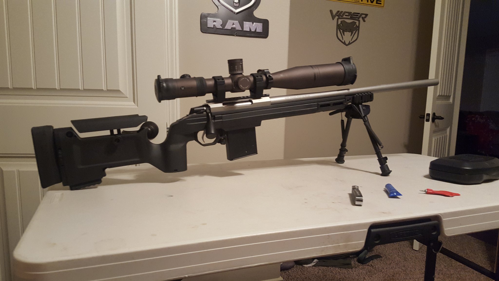

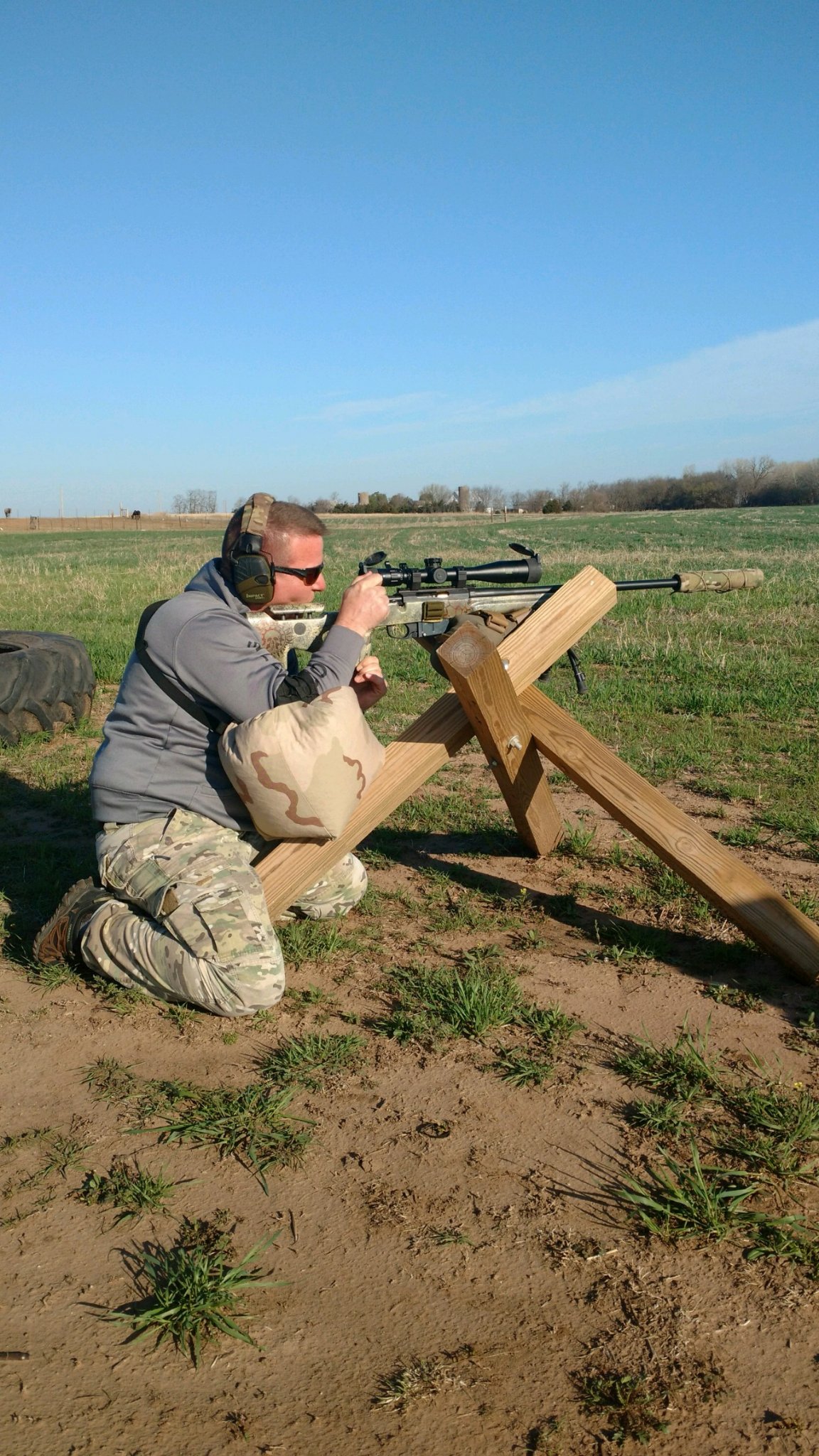

I run my CTR with factory mags in the German Gun Stock Predator. I use it for PRS matches and hunting. I ran a medium palma barrel with the BugNut for matches and I just put a factory CTR barrel on it for hunting season. It has an aluminum internal bedding block/chassis and an adjustable cheek piece. It is a lot of stock for the money. My son and I have Rangers coming and we are both considering the Raptor model for our match rifles.
