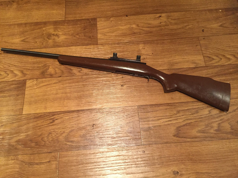

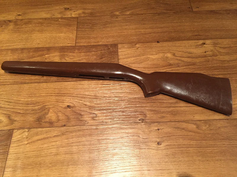

photos.... I went and bought some of that citrisstrip stuff, put it on tonight well see how it is in the morning.

I had already taken the bottom metal and action out before i remembered to take a photo. I'm thinking this thing must have been painted at some time, there seemed to be spots of paint or stained poly or whatever on the underside of the action,

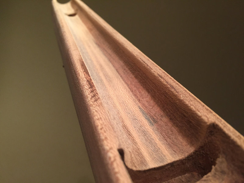

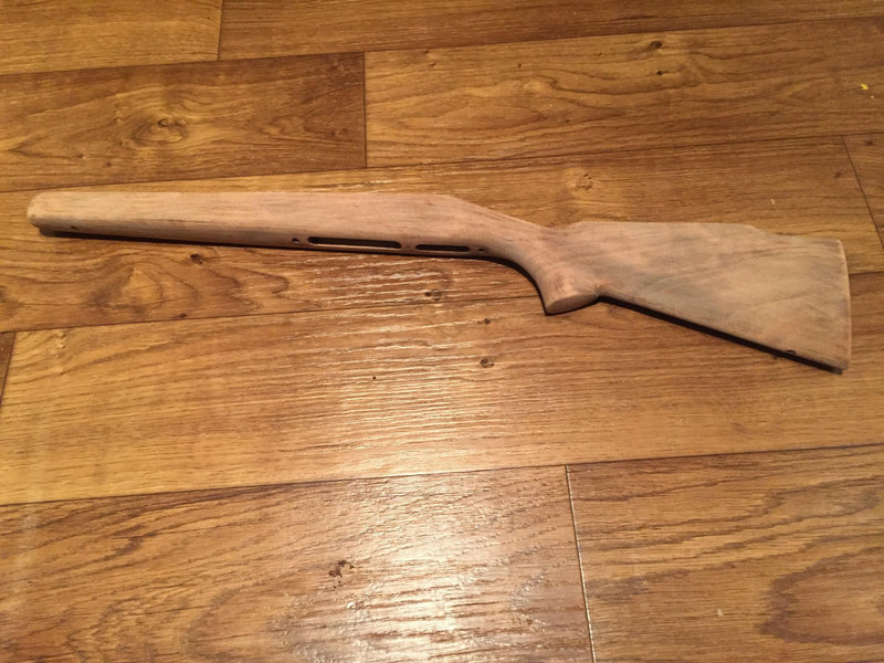

updated photos after stripping, and light sanding, its getting there. Im convinced to go with Tru Oil at this point, especially because its more forgiving to a newbie like me, just need to keep sanding it.
you can see in the second photo there where the barrel was wearing into the wood after the Lug hole, there seems to be a little bit of raised wood right there in the middle of the barrel channel, I'm thinking I'm just going to sand it down and open up the channel a little bit and bed the action.

A good check to see if you are free-floated is to be able to run a dollar bill between the barrel and the stock. If it will clear and 'see-saw' back and forth the whole length of the barrel, you have a good free-float. It's not a bad idea with a wood stock.
You can find the high-spots in the barrel channel by using smoke (cheap candle) or a bit of shoe-polish. Or a sharpie works in a pinch. Been a long time since I did a free-float. But that's how I did them back in the '80's.
