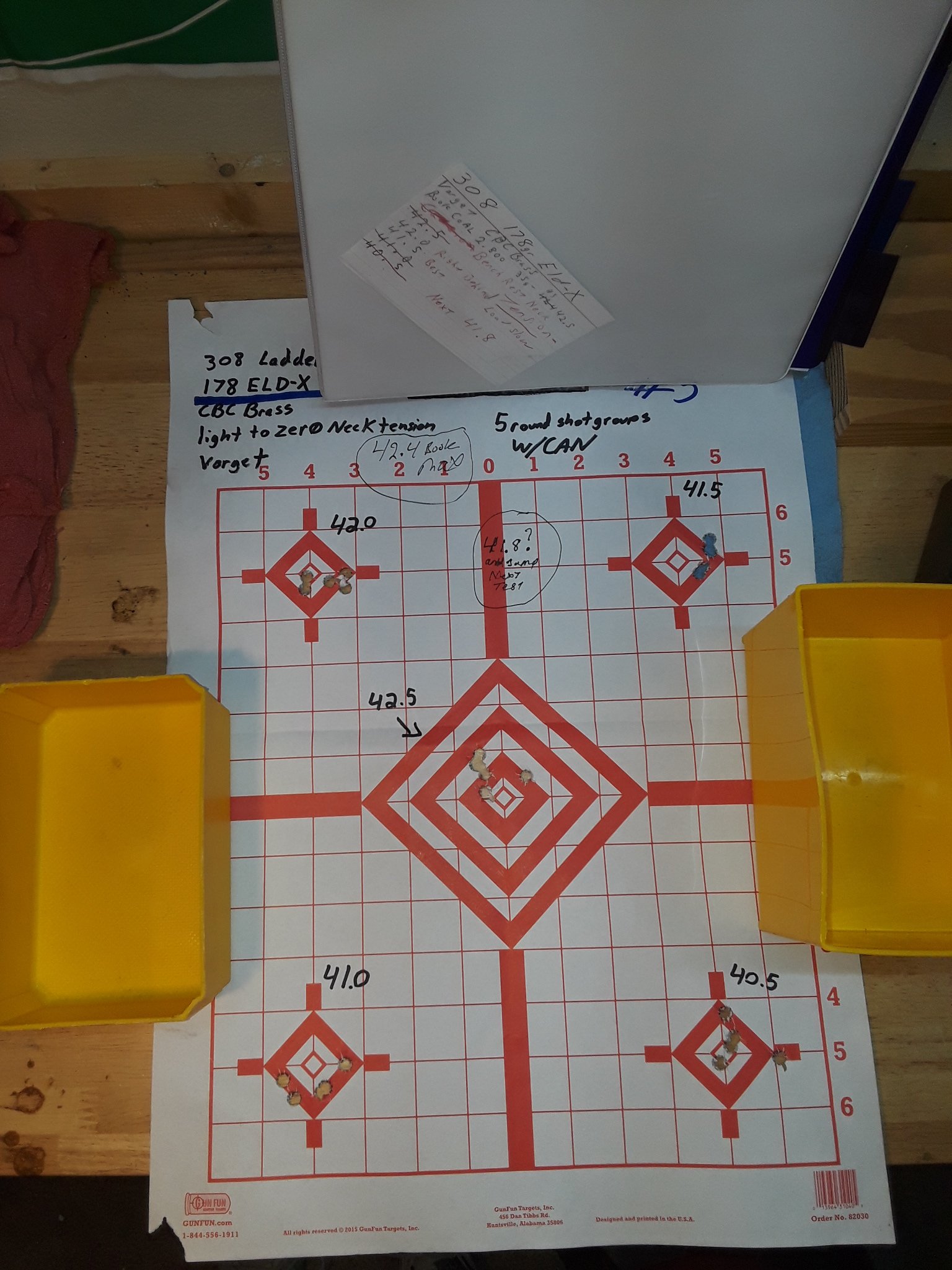

    178 eldx 20 inch 308 bolt gun first reload on brass. First attempt at the 178's.
    Every 1/2 grain, patern went from vertical to horizontal.
    Took 0015 off of the expander today and new rounds sized and trimmed.
    Hope I did not mess up.
    Rounds with 0005 to no neck tension were cdb brass and I ran fc brass today by mistake.
    So between fc and the magtec there is 0015 in neck.
    My son has hundreds of each first fired in his gun.
    Not sure easy way to go between the two.
    I may have 003-0035 now, not what I wanted.
    I could be wrong but all the Hornady eld bullets seen jump sensitive to me.
    Going to look for replacements.
    I haven’t found that.
    things change yes but getting accurate loads at .02 out to .12+ jump hasn’t been difficult.
    If your not in a stable velocity mode it will probably change a lot and possibly take you out of the node.
    I personally like some decent grip so I run .002ish.
    I think the second best way to set neck tension it a lee collet with best being setting it with a mandrel.

    Since these are my sons precision rounds (in work) do to case size and or spring back between the fc and cbd brass I am willing to try a mandrel setup.
    So the sizing button is giving me aproxamatly. 002 difference in the brass.
    If i run a Turing mandrel -.002 in both will I get both sets of brass at 002 neck tension.?

    The two different brass were split between 168 and 178 loads so no mixing.
    Sizing button probably perfect for my cbd brass now so I could just run all that first and for a couple dollars just get another and tweek it for the fc brass.
    The 168/cbd load should have .0015-2 now so a load to check it asap with the new tension.
    Hundreds of first fired cases left so not a big thing.
    Guess chalk this up to spring back difference?
