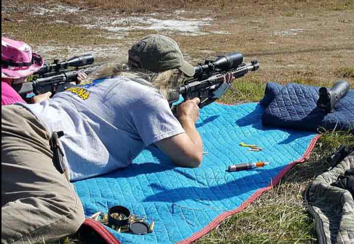

Here's my CHERRY PICKED 600 yard relay with the 22N.
I didn't come in first (or second) against the 6.5 and 7mm shooters, but for a rookie I don't think I did too bad.
Waterline errors were the shooter as were the two 9's (not my fault, it was the wind :) )

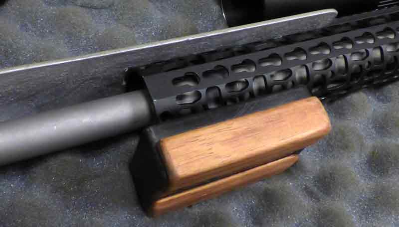

Trying to come up with what could be the stiffest platform with the best possible barrel/upper connection steered towards accuracy and precision.
The best option would be either an upper like the LMT monolithic design, where the upper receiver and handguard are machined from the same piece of aluminum, or something like the Drake Athena (now the Springfield ATC) that removes pressure on the barrel and barrel nut entirely.
The next best thing is an upper and handguard assemble where the handguard attaches directly to the upper, without contacting the barrel nut. Examples would be Aero Enhanced, Seekins IMRT (or SP10), JP LRI-10/SCI-10, Larue OBR/PredatAR/etc, Daniel Defense DD5, and maybe one or two others that I'm not remembering at the moment.

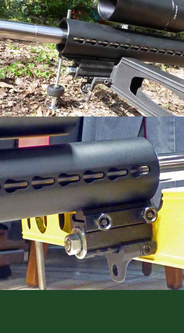

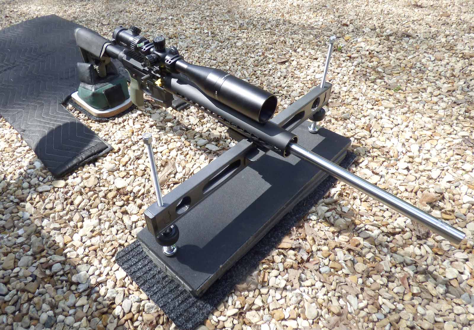

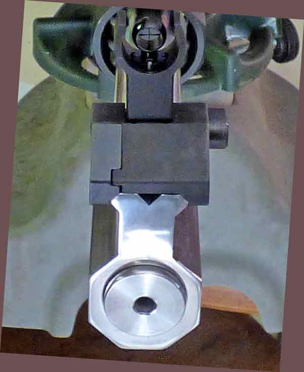

Since this is a discussion about bipod placement on an AR (even if you guys don't think my No-Gasgun isn't a real AR :) ),
Here's my take on bipods. Referred to on another forum as my PSB (Plain Stupid Bipod).
Well shit man..
I think it’s a very level headed idea. I absolutely love it! You don’t have a patent do you?!😂
Imma have to steAl that idea.

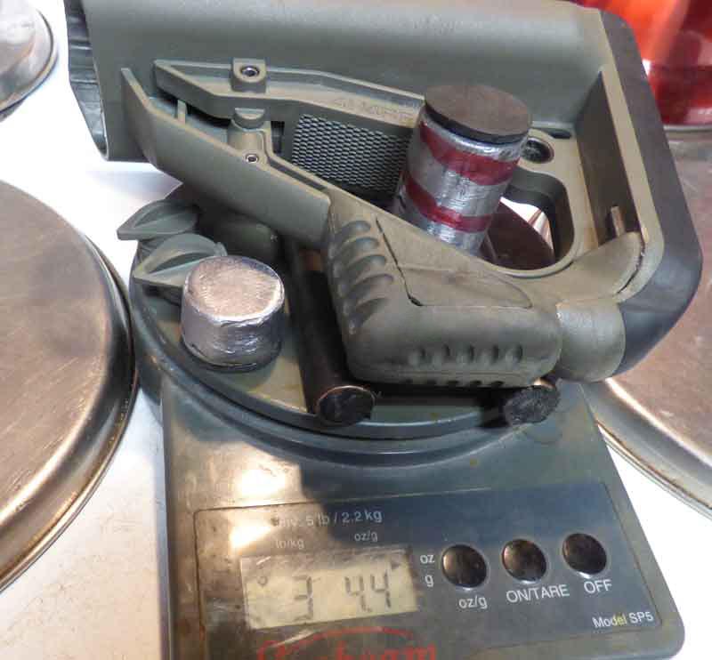

The PSB(2) weighs about 3 pounds that does not contribute to flex. Barrel overhang might help balance at the "pinch" point.
Since F-Open weight limit is 22 pounds I have some more lead weight in the stock that adds mass but not to flex.
Takes up space behind the buffer tube and in the two storage tubes. I have a little more weight margin left and will probably get up closer to the limit with weight in the right side of the bipod. Maybe even move some of the weight up front from the stock.

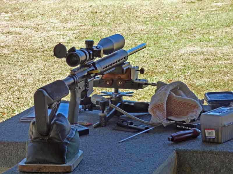

This is what I used for that 600yd video. Hopefully I can do better this spring and move over to the 1000yd range.
Smart enough to not try longer than that. Not with a small frame AR. Even if it is the 224V's big brother. :)
Used a lead filled bag rider with the Bald Eagle rest.

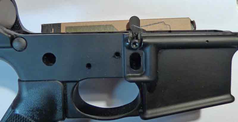

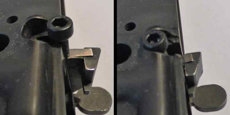

One little mod I've done to a few lowers is a right side bolt release. Cheaper than store bought options.

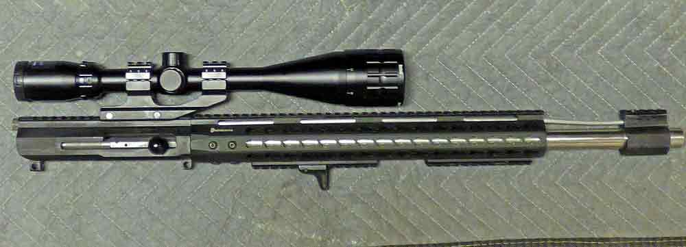

The last upper picture I posted is a Green Mountain barrel BLANK with a DIY front sight block for open sights.
