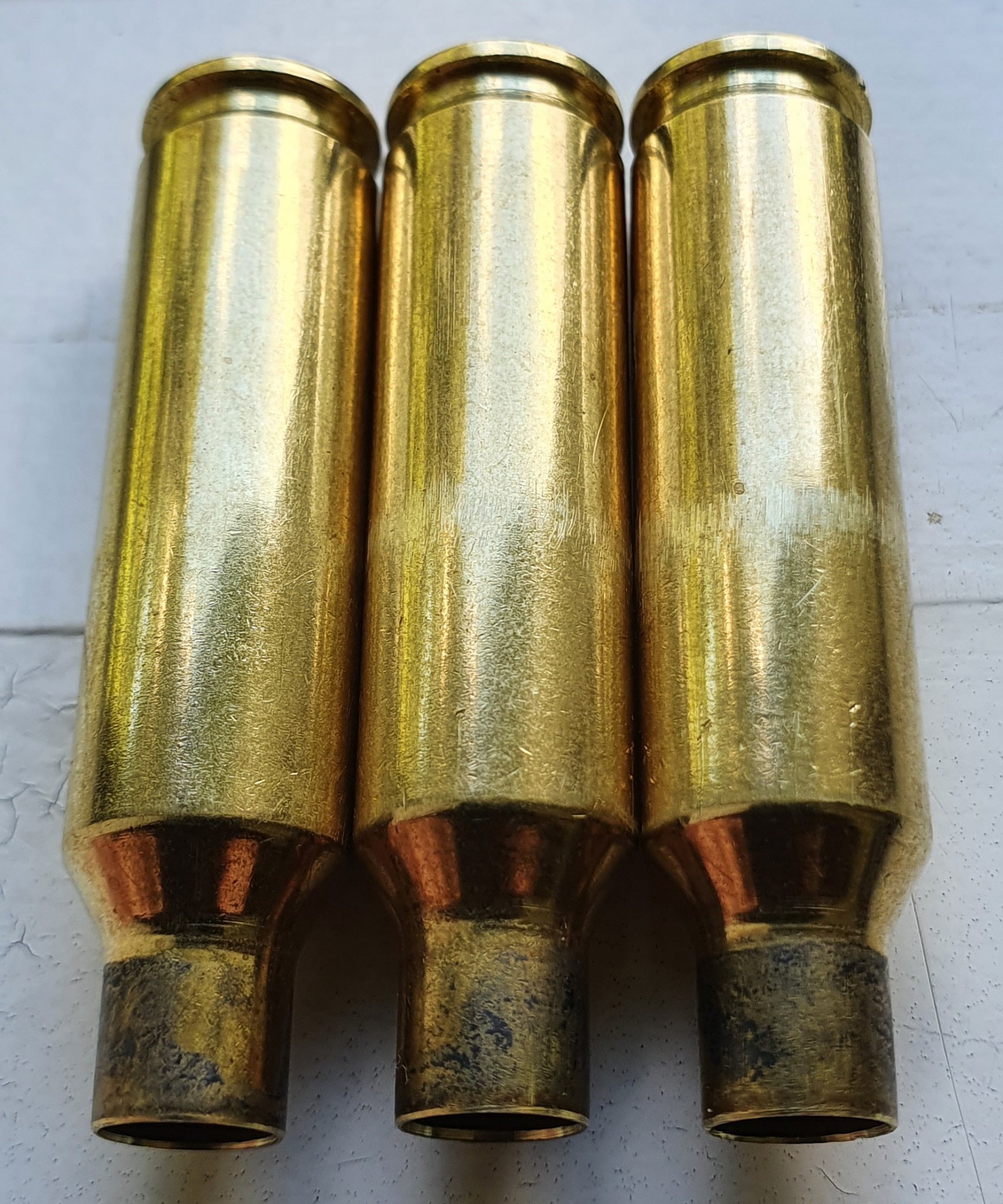

    Sako cases were resizing fine but some (2/5) of the Selliers would not chamber. I turned it some more and now it is taking in all of the cases except now some cases show to have a bumb in the wall?
    Left - no stripes Middle-chambered once Right-chambered 4 times so the stripes are more visible.
    What the hell am I doing wrong here?

    Have you tried to chamber the scratched cases in another rifle/chamber? Sharpie the scratches and see if it rubs off at the same spot, that could help indicate if it's the chamber or die.
    Look in the die with a flashlight, and see if you can see brass coloring about halfway up the body section. (if the die has galling in it affecting sizing)
    I'm leaning towards the chamber having some quirk, but I'd rule it out with a second, known good chambering before continuing to troubleshoot.
    On my .223 SB dies, I had a build up of brass inside of the sizing die causing striations on the sized brass. Took a hardwood dowel and sanded it until it just barely fit inside the die. Chucked the dowel into a drill and using some polish, ended up polishing out the die. Die works great once again.
    I polished the die when I got it and remember it having a stripe visible that I tried to focus on. I do not know how bad it is, it seemed minor.
    I have tried both unique and ballistol (the sprayed one) to get the SB cases to size comfortably but I have been unsuccesful.
    About 10% of them I have put in to a trash can that I thought test annealing on (I have never annealed before) to get a feel on it and perhaps improve them. Many of those cases still were tough even on second run in the die, so they are beyond help.

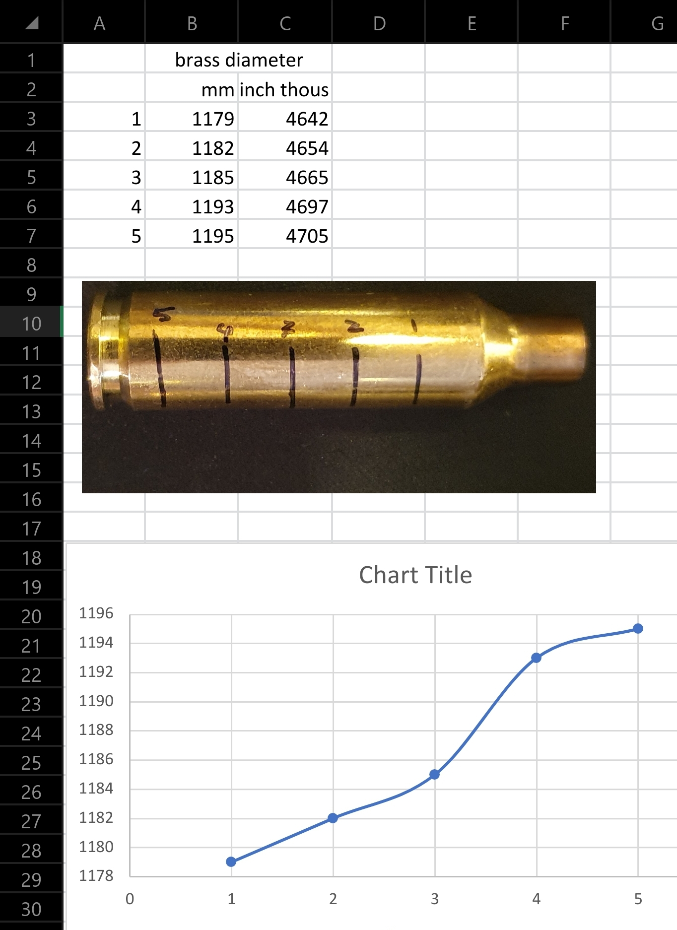

    Take a caliper and measure fired brass to see if that area of the chamber is different than the rest of it. Measure every 1/4" from shoulder to base.
    I will check this. I have few sako cases still untouched somewhere..
