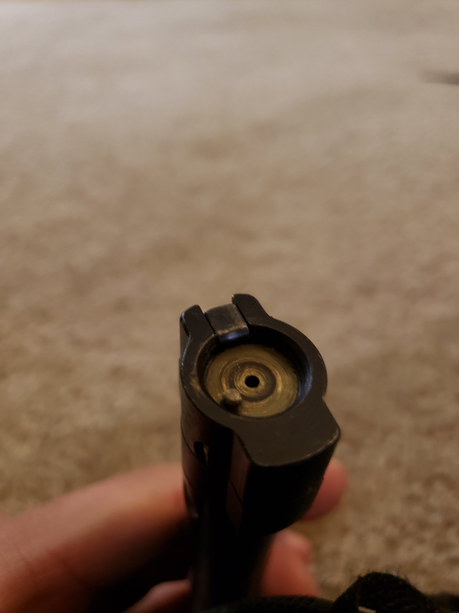

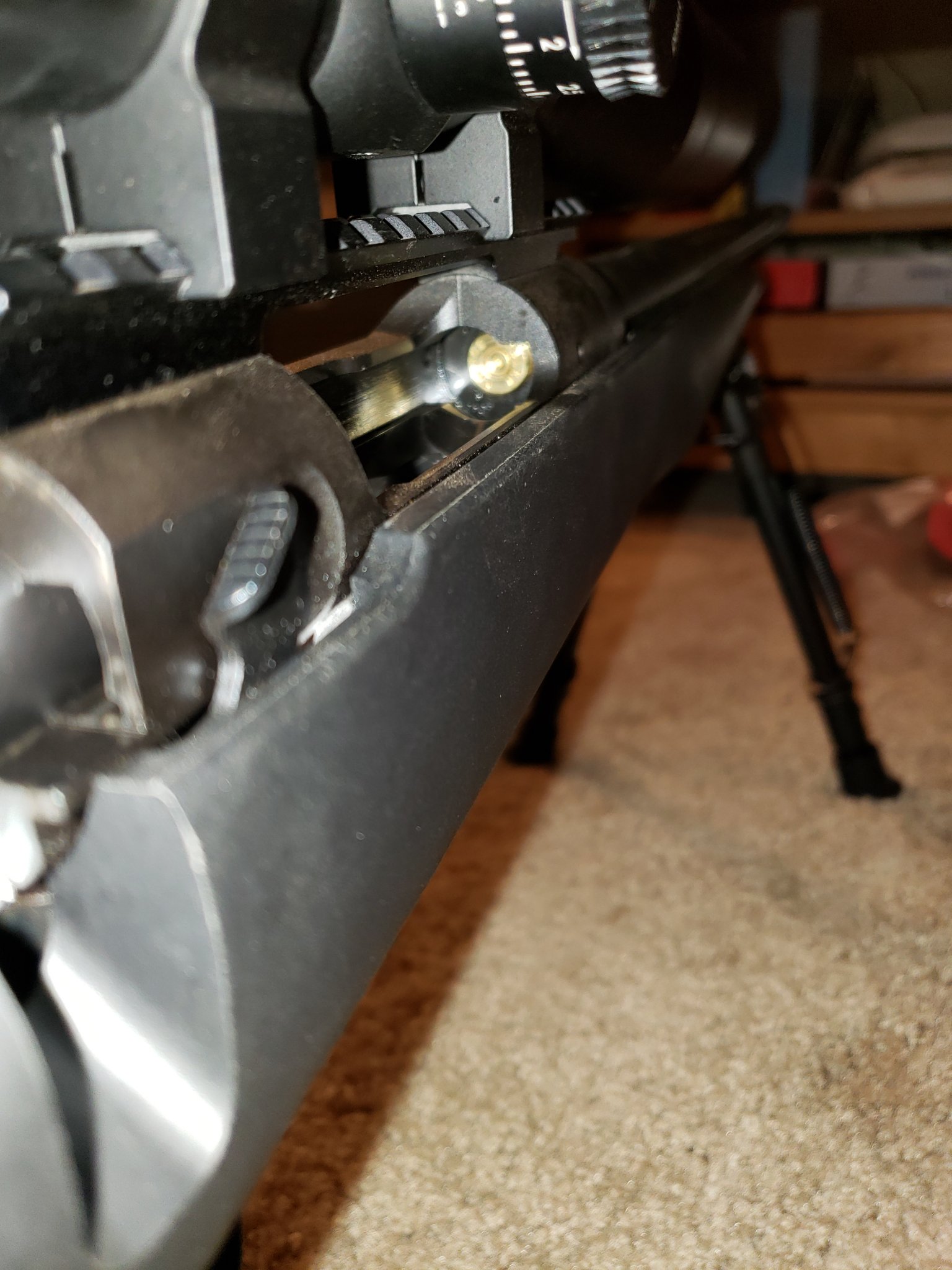

OK first post here. I did a quick search and wasn't quite satisfied with what I found. Here's the info:
Gun: Savage 10 fcp-sr
Ammo in question: factory Nosler match CC 168 grain
I went to the range yesterday and shot fiocchi all day with no problems. Decided to start using the Nosler. After discharging the first round, I noticed lifting the bolt was a little difficult. It had some resistance. Then opening the bolt to eject the casing took some work too. Got it out after about 30 seconds of messing with it and load the next Nosler round. I discharge this one and the bolt still lifts with resistance but won't open. I didn't get it open until I got home. I had to rest the butt of the gun on the ground (barrel pointed up) and hit the bolt downward a couple times for it to bust free.
Peeled in the chamber and the casing is still in there. So a couple of rams with the cleaning rod down the barrel and it busts free too. It took alot of force to get it out.
I've read that the bolt not opening is a symptom of ammo that's too hot but would I also experience difficulty in lifting the bolt too? Should I have the rifle inspected by a gunsmith? I noticed the casing was damaged from the ejector ripping the rim.

Did the unfired Nosler 168 chamber easily or with resistance? A stuck bolt is the sure sign of excessive chamber pressure. This could have come from the bullet engaging the threads on locking the bolt, insufficient headspacing of brass rim or shoulders, or wrong amount or type of powder. I would take some careful caliper measurements of the factory fired brass as well as new cartridges; also compare to the Fiocchi fired and unfired, as well as to standard specs in a reloading manual. If the Nosler is off spec on COAL, shoulder/neck length I would not be surprised. That brass looks asymmetricly charwelded, making me think poor seal and or wrong powder. I would certainly contact Nosler. You are lucky savage actions are strong, however their QC can leave something to be desired. If the fired brass is way over or under expected spec in both the Fiocchi and Nosler empties, it would be safe to be concerned your chamber is cut improperly.

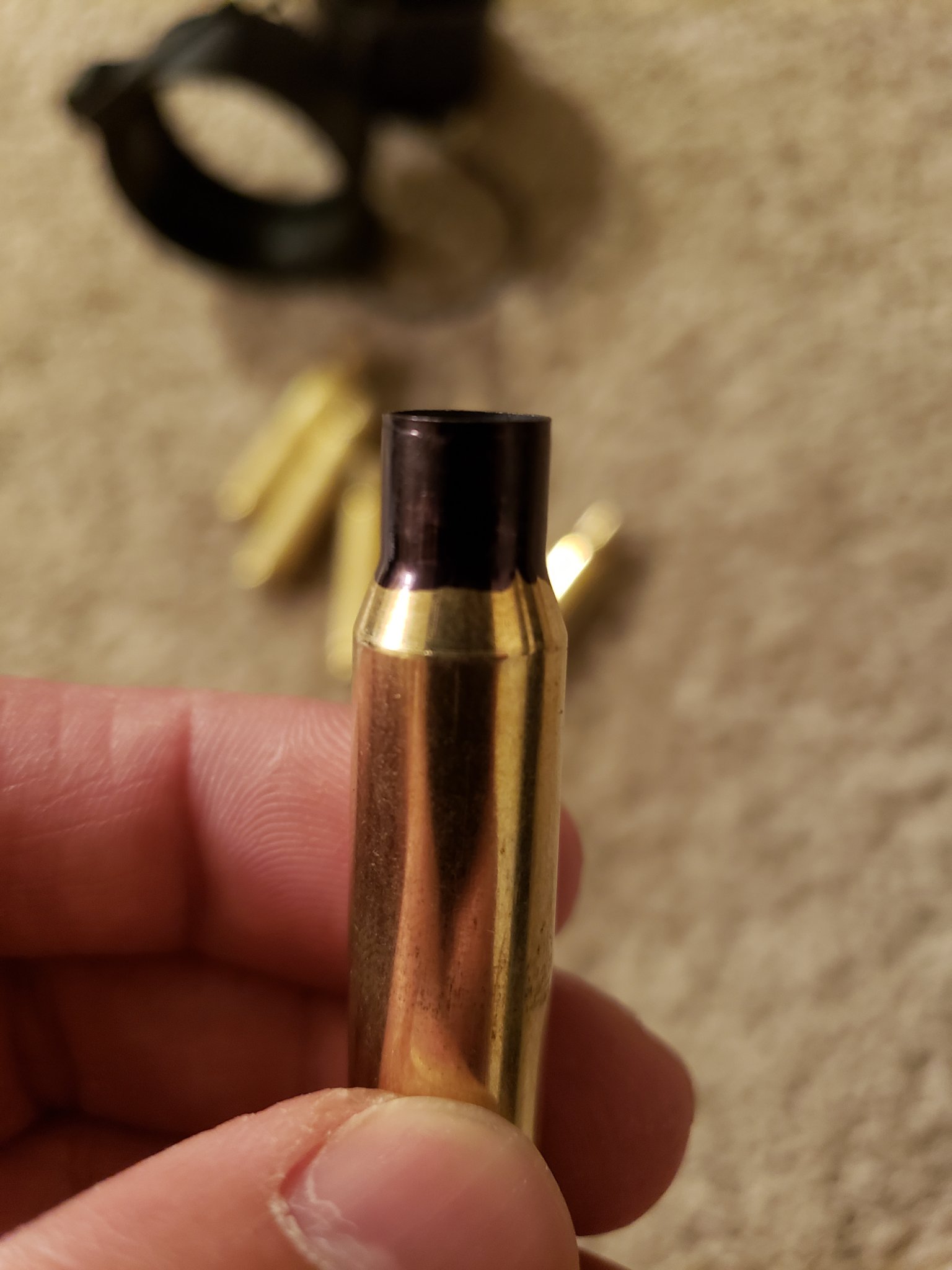

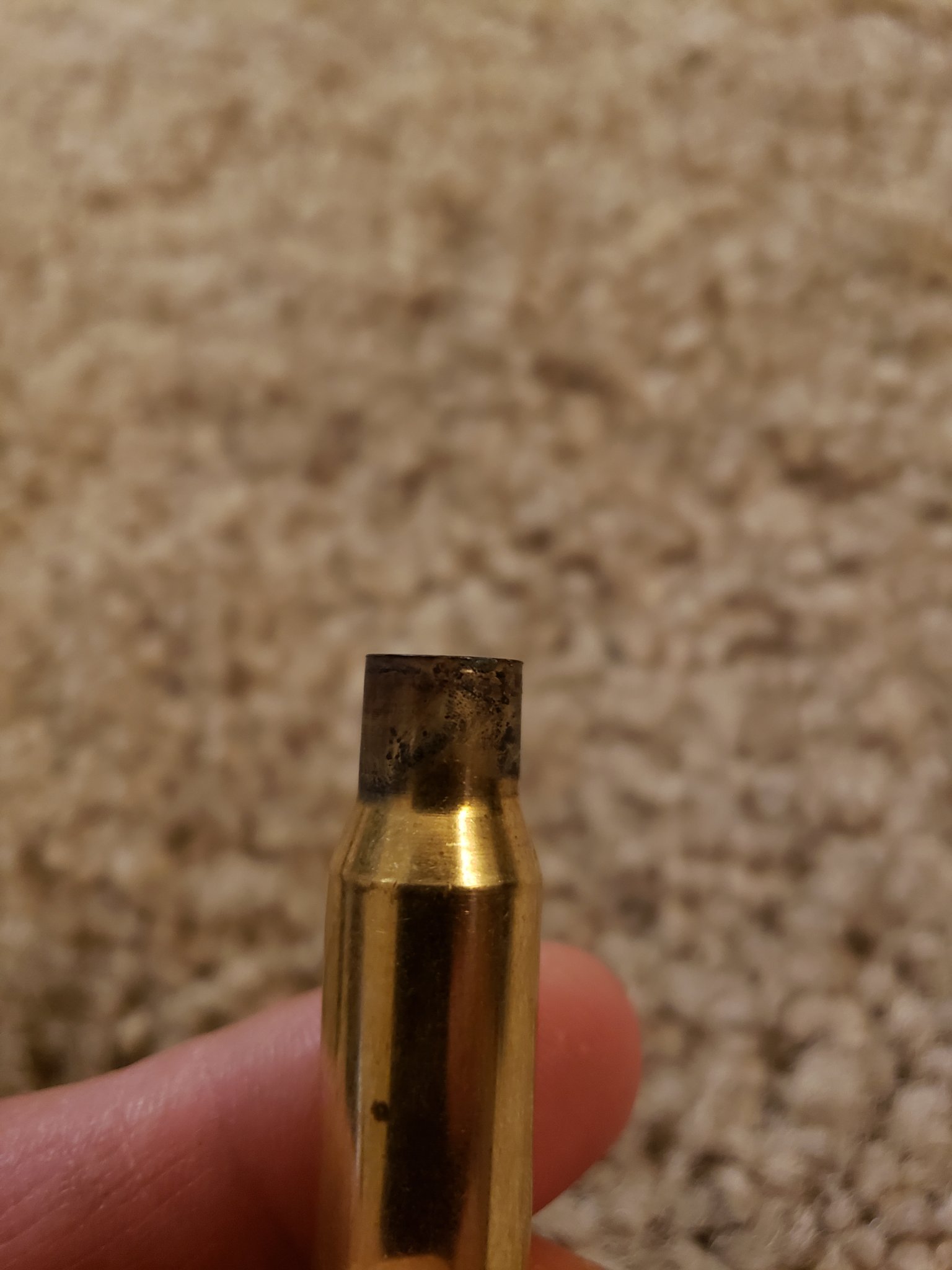

I think the case neck is getting stuck in the barrel... sounds like the brass was not trimmed correctly. Take a black sharpie and color up an entire Nosler cartridge, primer to bullet tip. Do same to a fired brass. Insert them into chamber and close bolt. Fight bolt open and post pic. Dollars to donuts that spent neck will be scraped clean.
Matches3215
Dec 31, 2019
24
3
6
I think the case neck is getting stuck in the barrel... sounds like the brass was not trimmed correctly. Take a black sharpie and color up an entire Nosler cartridge, primer to bullet tip. Insert into chamber and close bolt. Fight bolt open and post pic. Dollars to donuts that neck will be scraped clean.
I suspect the same. Standby for pics of test.

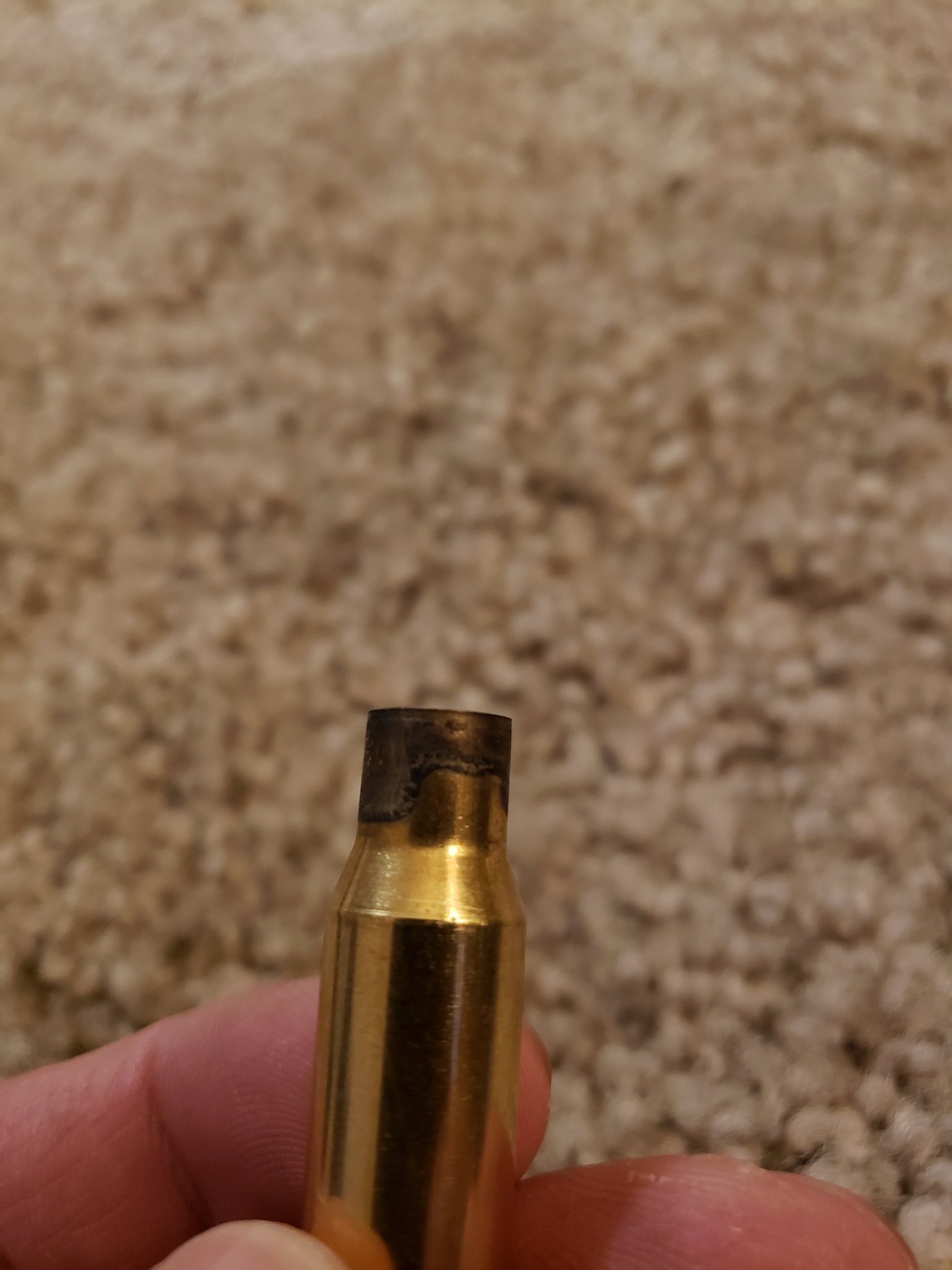

There is a dent in the case right behind the shoulder. This could certainly lock the brass in place. You need to have a gunsmith take a careful look at your chamber for a protruding machining bur.
Last request... color up a Nosler Cartridge’s bullet and see if the rifling leaves marks.
I'm a little nervous about chambering a live round. I really appreciate your input and insight. It was definitely more than I had considered or thought of. I think I'll just call up a gunsmith tomorrow and ask them to check it out.

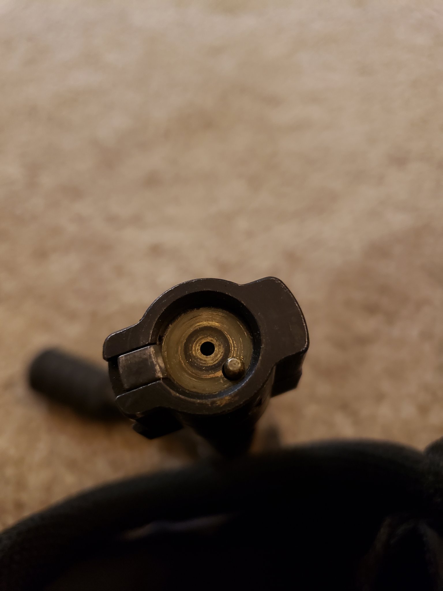

Well I finally picked up the rifle. They were backed up so it took awhile. Guy said they cleaned the chamber and deburred it. So it could've been that I suck at cleaning the chamber or there was some burr that eventually caused the casing to get stuck.

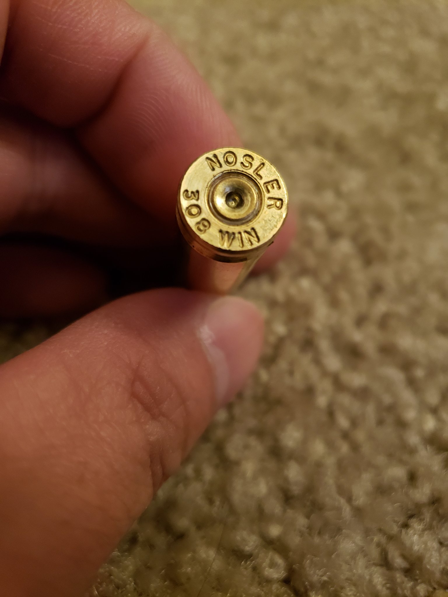

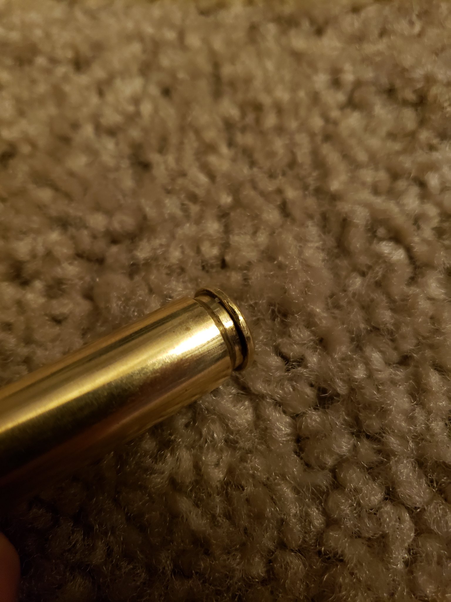

The case didn't expand at all and there was no hinting of being hot?
I assume you measured the case head, neck diameter, shoulder, and length at the datum on the unfired and fired brass to confirm this lack of expansion?
Pro tip and spoiler: all cases expand when fired to some degree or another in order to seal the chamber to direct all the expanding hot gasses out behind the bullet, they spring back slightly as well... hence why the cases need to be resized to some degree when reloading them.
Here are some points and info to consider since my coffee has kicked in:

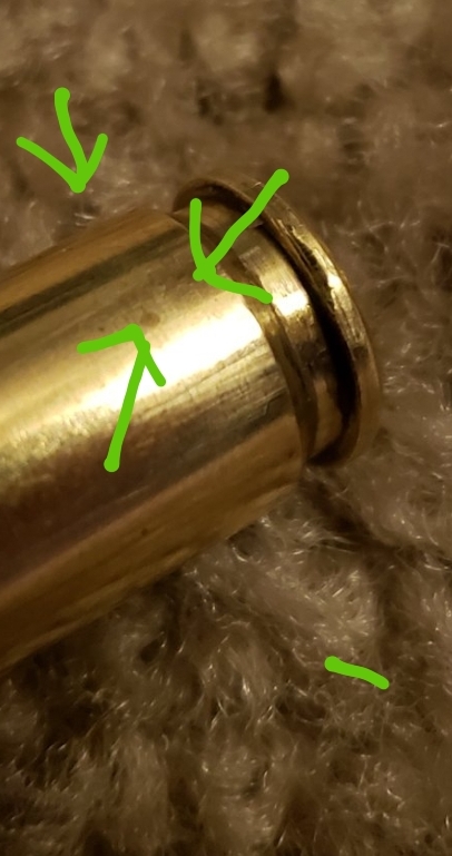

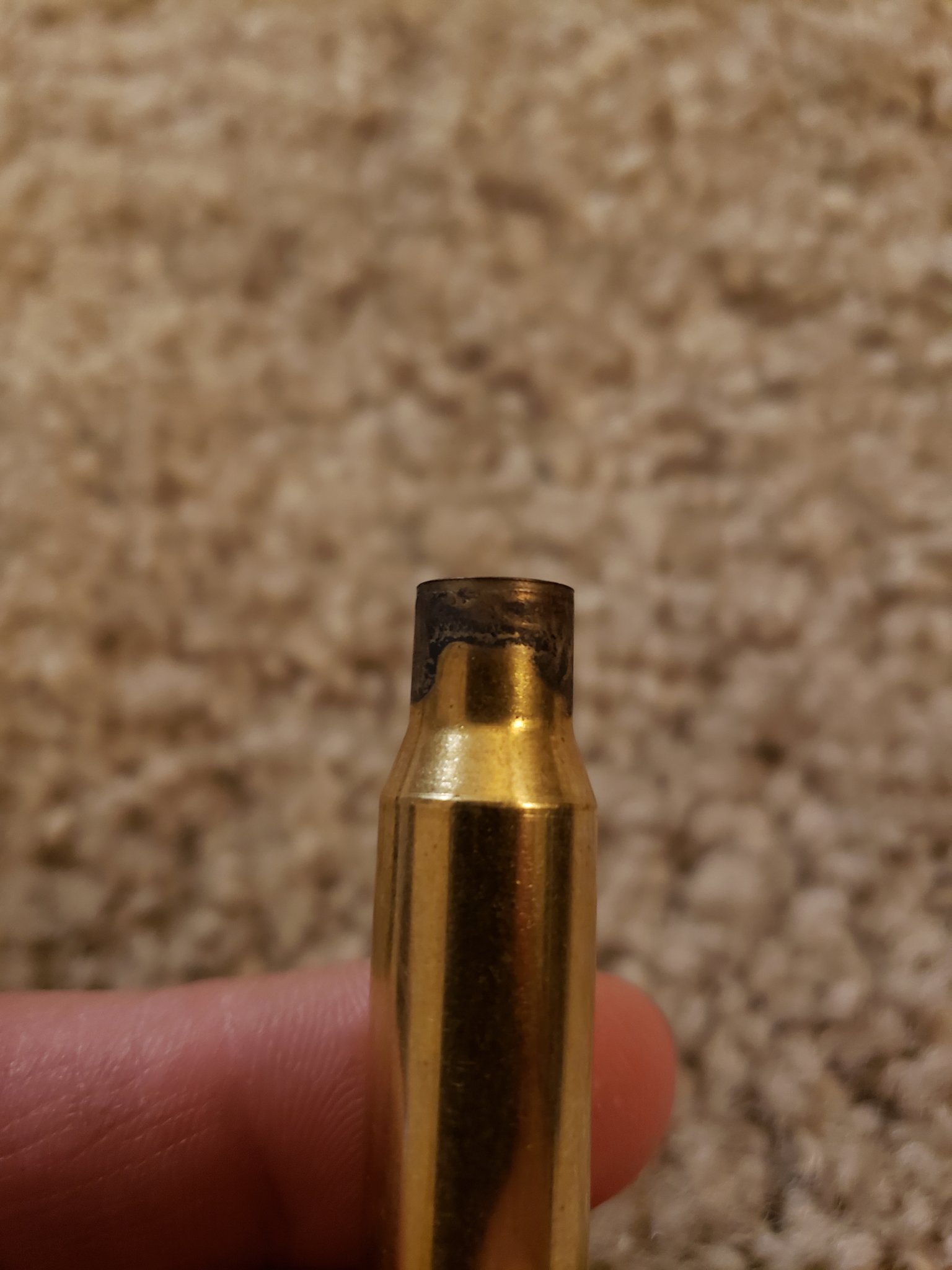

I see on your brass you chambered the one casing that got stuck and pulled the trigger due to the primer deformation. I'd be willing to bet that primer was very flat before you did that and there could have been some primer flow/cratering... flat primer and cratering is an indicator of either being close to high pressure or being in the high pressure area depending on the brand of primer. Flat primers can happen from another thing too: the headspace may be on the maximum SAAMI tolerance and your casing is likely a hair smaller than the minimum headspace tolerance so it will chamber in any rifle. During the nanoseconds the pressure is increasing in the chamber, the shoulder seals the chamber and locks everything in place, the pressure continues to build and it has to go somewhere... everywhere. Pressure pushes the bullet out and expands the case in all directions, including back toward the bolt face. If the headspace is on the SAAMI maximum pressure can push out the primer out a hair, it mushrooms, and then the case head gets pushed back to the bolt face which flattens the primer. More on that later.....

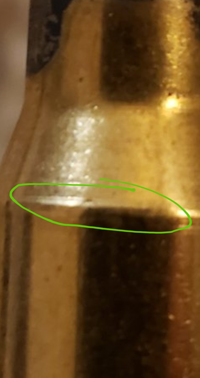

Notice on the shoulder of your one stuck case, where the side of the case angles sharply toward the case neck?
Right here in the green circled area...
Compare that to an unfired nosler brand of ammo. I'm willing to say the fired brass has a much sharper junction and extra tool marks that were embossed onto the casing from the chamber due to the pressure. Based on my experience, a cartridge usually takes 2-3 firings to get to that amount of "fireforming" to the chamber... yours happened on the first firing which could be an indicator of higher pressure which could have contributed to your stuck bolt.
On the case just above the rim you see there is a faint, cloudy ring that goes all around the base of the case in that area?
Right here....
One of two things, either the chamber is a non-custom savage chamber, not a polished custom chamber or...
During the nanoseconds the pressure is increasing in the chamber, the shoulder seals the chamber and locks everything in place, the pressure continues to build and it has to go somewhere... everywhere. Pressure pushes the bullet out and expands the case in all directions, including back toward the bolt face. If the headspace is on the SAAMI maximum and your ammo is smaller than SAAMI minimum so it chambers in all rifles... your brass is going to expand to fit your chamber. Lots of areas are designed to expand and contract. The area of the brass where the case head and where the arrows are in the picture.... not really happy with expanding.... and an indicator of either high pressure or the mismatch size issue.

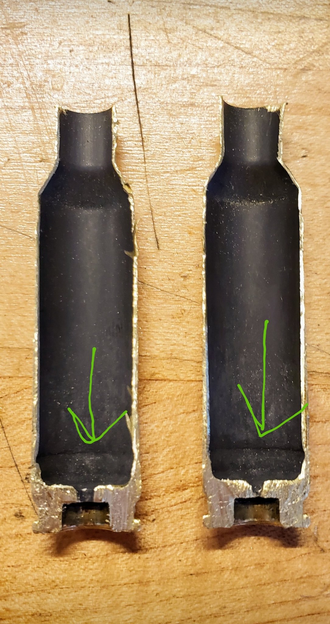

Get a flashlight and look inside the fired case, waaaaay down in there, you may see what looks like a depressed ring on the inside at the same position as that cloudy area on the outside of the brass.
Kinda like this. These are when I resized some brass waaaaay too much because I was stupid:
That ring is the beginning of case head separation.
Thats it for now. There's more, but I'm hungry. I understand you're new to this whole thing and thats all good. You're rifle was probably fine and whoever you took it to made some money for doing essentially nothing.
