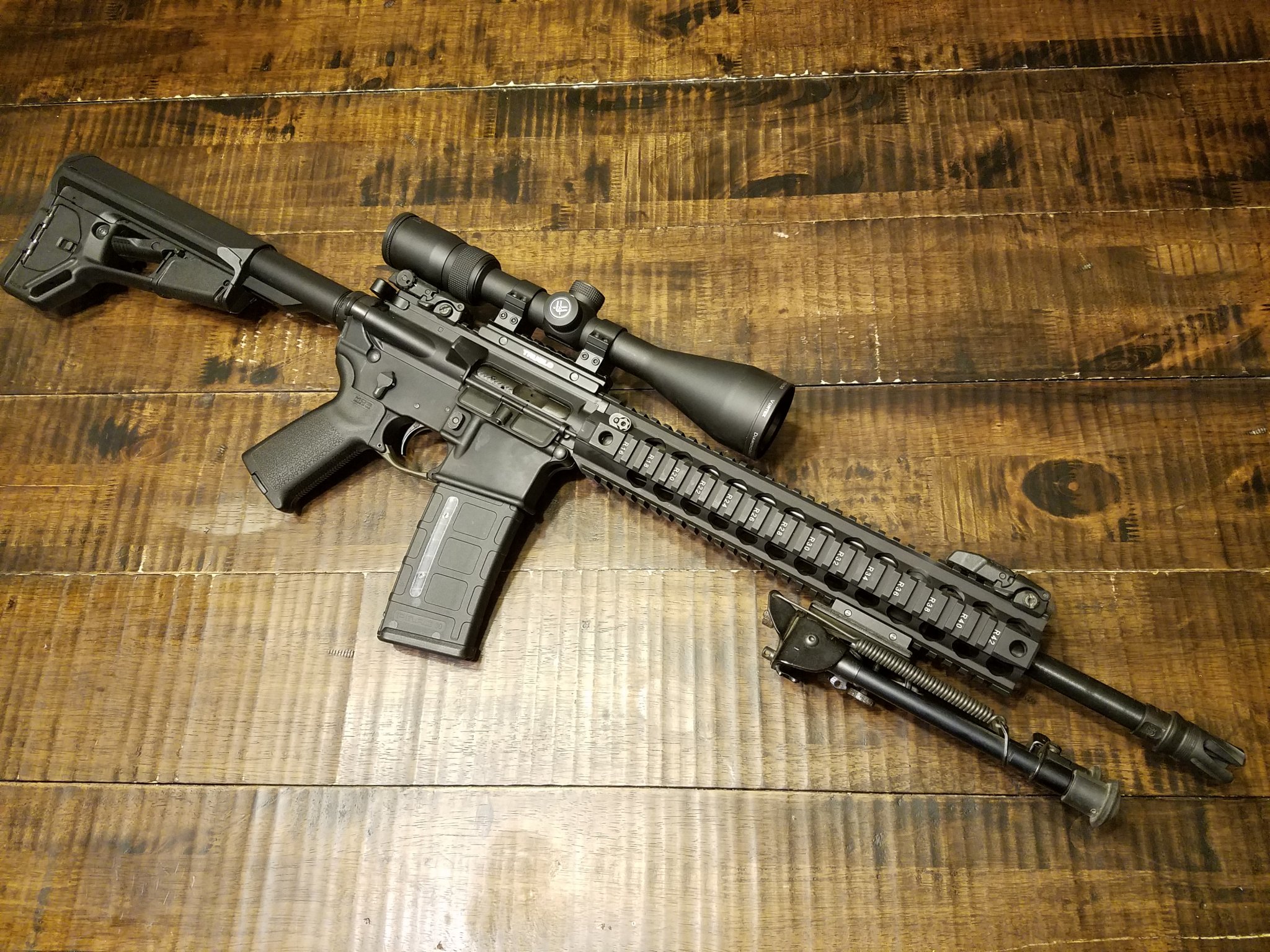

I was told to post back with some results, well I got the old girl put together a few weeks ago. I shot a few groups with the scope pictured, but was having a bugger of a time adjusting the parrelax (on the front) in the cold weather. Switched to a different scope and gained 1/2 to 3/4 inch per group. I used the load data provided by @Constructor but bumped the oal down from 2.285 to 2.265 so they would run in my mag. Will two hundreths make in oal make a difference in accuracy? Im looking forward to more comfortable shooting weather, hoping that will also tighten the groups a touch. Thanks again for all your input!
