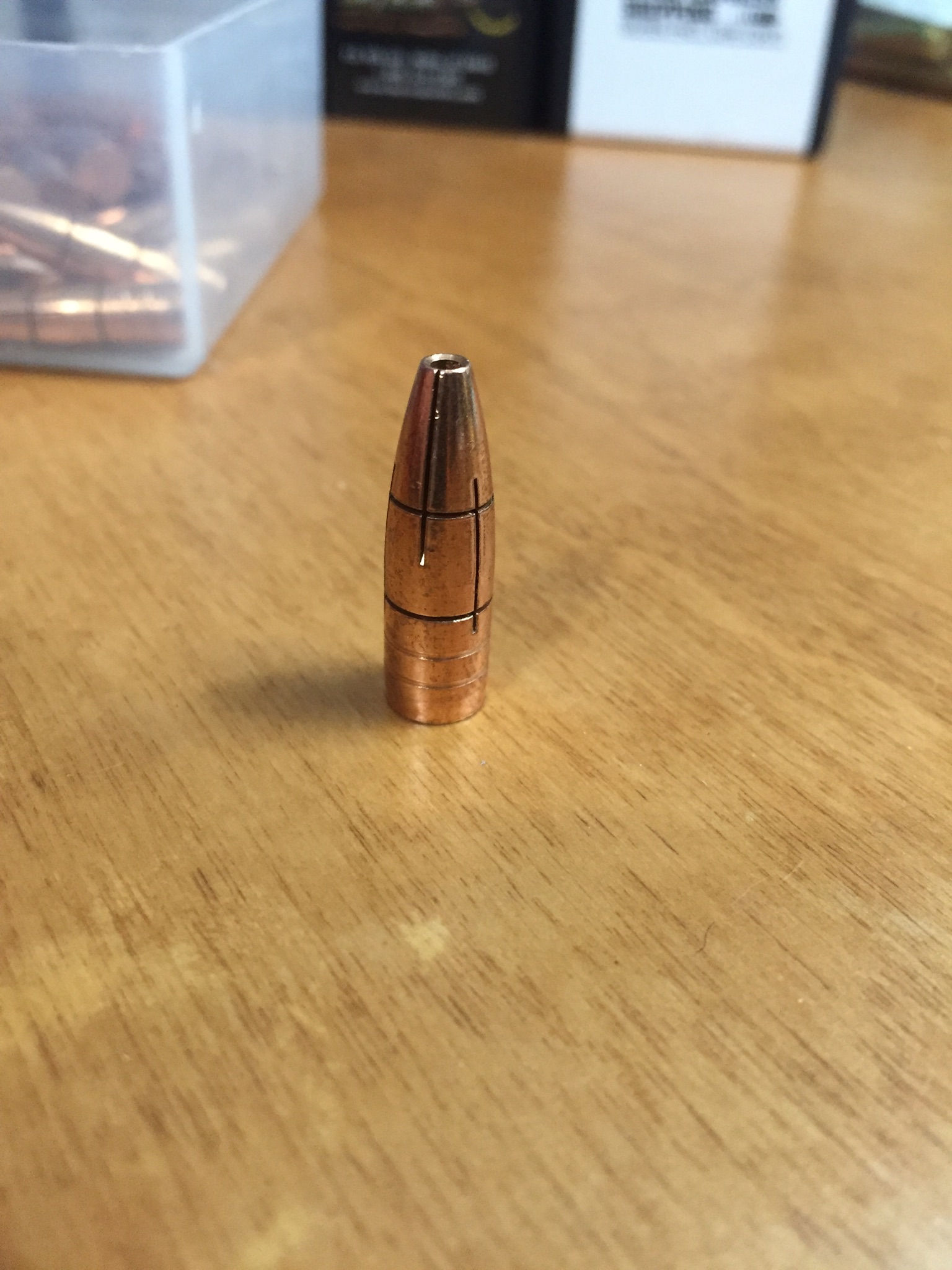

Most of my load data is with maker Bullets. If you’re not shooting them, you should be.
Never heard if Maker bullets. Just looked over their sight, the subsonic expanding bullets look interesting. Have you used any of the .224 bullets or only the
Found Maker bullets after seeing this thread, so thanks for that. So glad I did. These things are slick. Between these, Barnes, and LeHigh, I’m set. Pictured below is the Maker 125 grain BLK high velocity fracturing and 200 grain sub-sonic expanding. These will be used in both a shorty bolt action and AR 10.5” pistol. I’m considering deer hunting with the Maker subs this season.
Edited to add: I’ve had best accuracy with 125 TNT’s using 18 grains of H110 and 296, but haven’t shot the 125 Makers yet. Used 6.0 - 6.5 grains of Titegroup for the 200 grainer out of the bolt action for Hollywood quite. I’ve got CFE BLK to try with the pistol when it gets completed. With the LAW folding stock adapter and TBAC U7 it should make a handy little side kick.

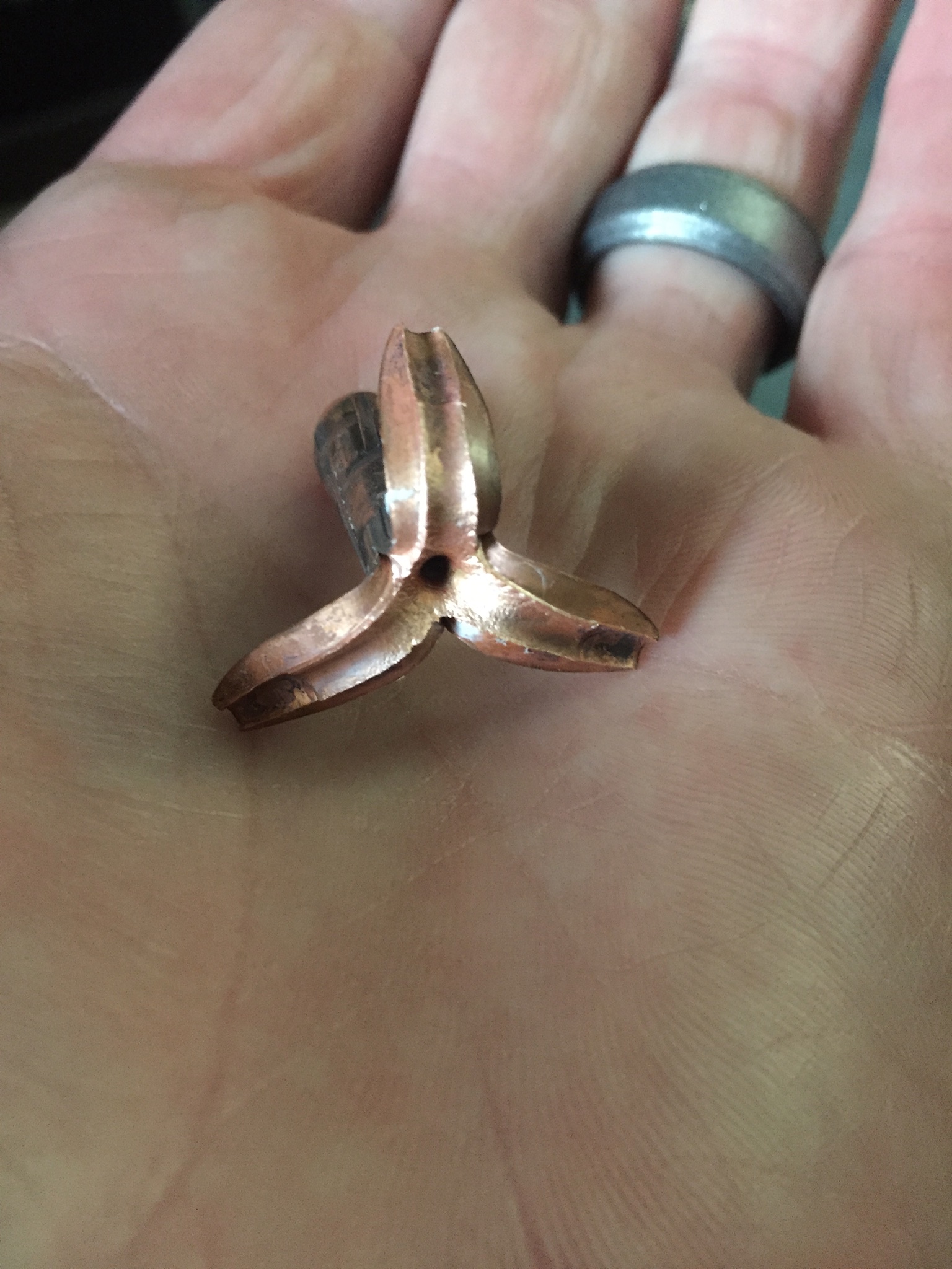

I’ve killed a pile of animals with 200gr subsonic makers. Including deer, big hogs, and a cow I processed. Anyone that says subsonic ammo is not ethical has clearly never shot makers. Paul (the owner) is a great guy to deal with as well.
Reactions: Guns&WhiteWater
Agreed. I got a nice doe this past fall with the Maker 200 gr sub. It ran into a fence about 25 yards away and piled up. Another younger doe was standing beside her and she never moved after the shot broke.
Reactions: Snuby642
I'm with you guys all the way on the Makers. I'm pushing the 220 rex at 1000 fps and getting 2" at 100yds. I have only taken three deer with them. Two crumbled up on the spot and the third jumped, stood for 5 seconds, took about 3 steps and laid down. Question: how many times did you do the water jug test? I've got 6 perfectly peeled 220 grainers sitting on my shelf LOL. Looking to try the Lehigh Defense 176 gr. controlled fracturing as well. They look nasty but we'll see.
Reactions: Snuby642
What is your load with the 220 Makers?
I'm running 12.1 cfeblk over 220 rnfb hornady interlocks.
Accuracy is great but no expansion. Great for cns shots 50 - 100 yds on stationary targets with patience but nothing else.
I'm shooting these from my 16" Ruger 300 Blackout Bolt gun with 11.5 grains of CFE-BLK, CCI-400 primer and Hornady brass. They are loaded to the crimp groove with a light crimp. I've tested this bullet on water jugs at 25 yards and 75 yards and can't tell the difference between the bullets. They all look like the examples on Maker's website. Hope this helps.
I should add that this rifle has a 7 twist. The Maker 220 Rex is LONG bullet so try it without the can first.
