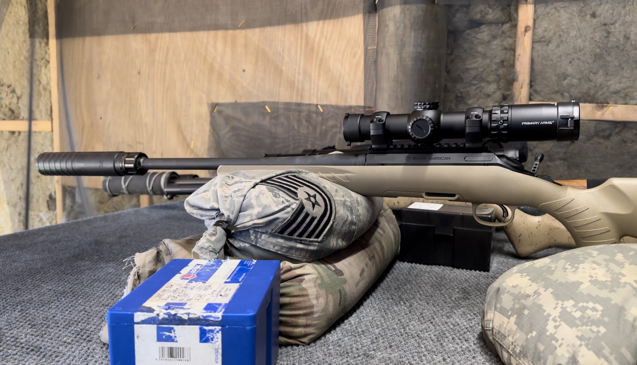

Went and zeroed the new SLx 1-10x28 34mm LPVO. Pretty impressed for the price. 👍🏼

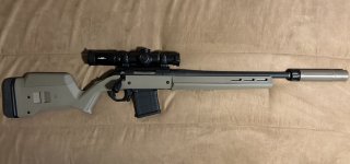

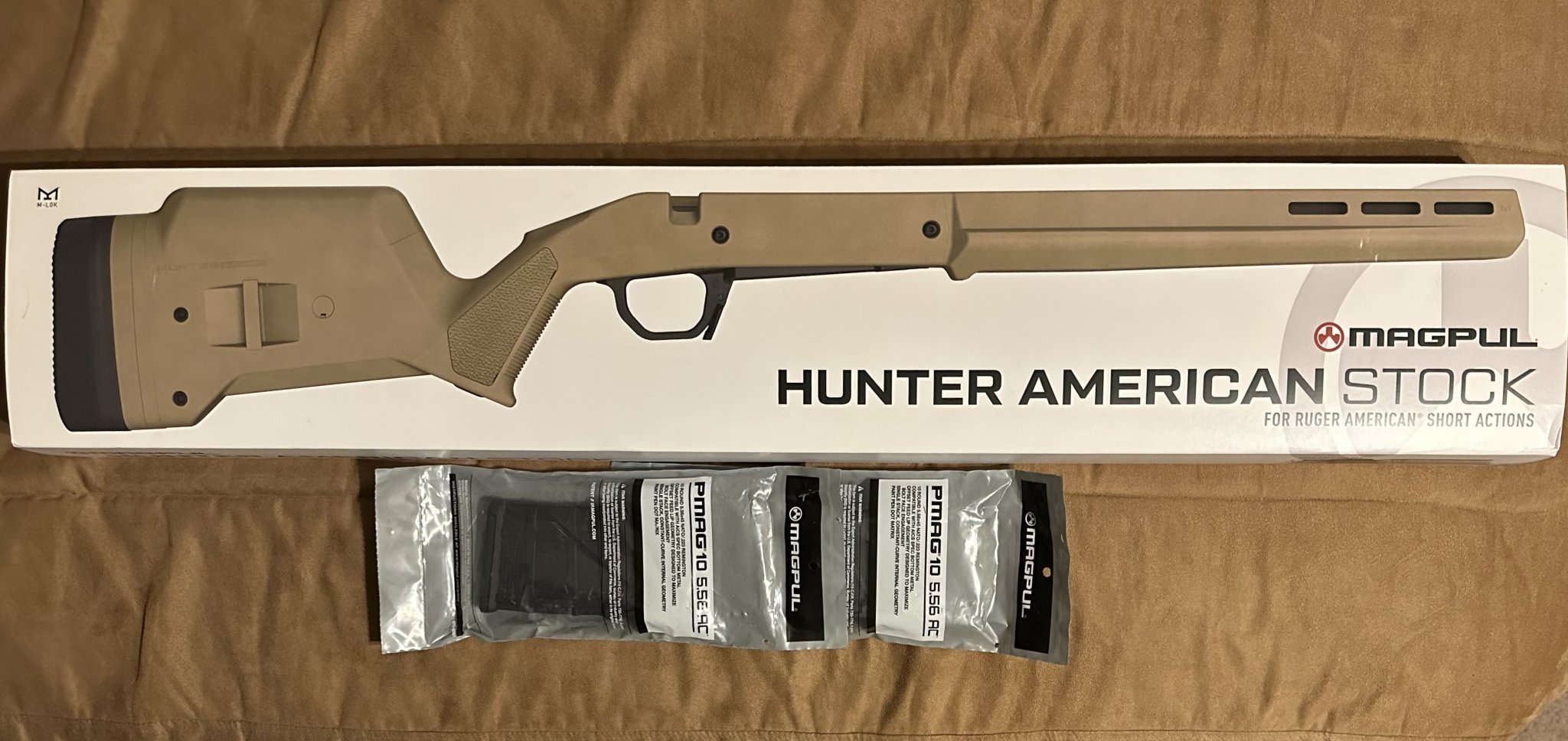

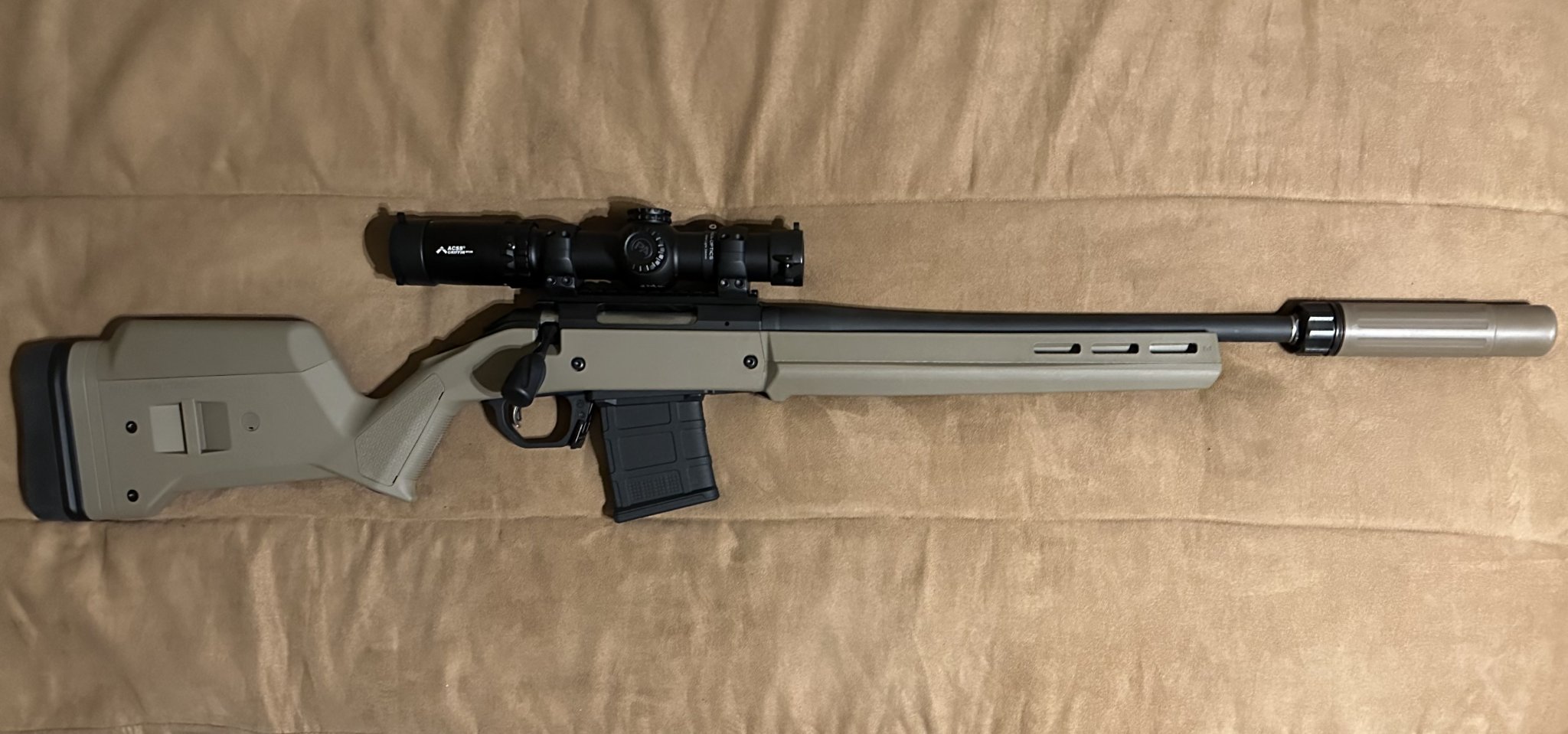

New Magpul Hunter AICS stock and Magpul AICS 5.56 mags finally came in for the Ruger Ranch .300 BLK. She looks (and handles) exponentially better than with the factory plastic stock.

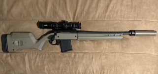

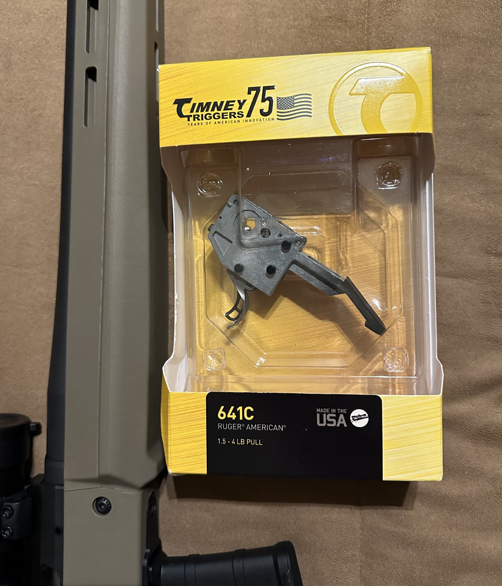

Well… Since it’s last public appearance, my Ruger American Ranch 16” .300 BLK has undergone a bit of a transformation, and definitely for the better. That factory stock, while lightweight and functional for hunting, is thin and flimsy, so I put a Magpul Hunter AICS stock on it. And got some of the new Magpul PMag 10 5.56 AC (AICS) mags for it, so I could seat the bullets much closer to the lands for Precision subsonic handloads. I also installed an Anarchy Outdoors threaded bolt handle & knob, and a Timney trigger (factory Ruger trigger is in the box), that I adjusted down to around 1.5 lbs. It has no excuse not to shoot good groups now. 😏

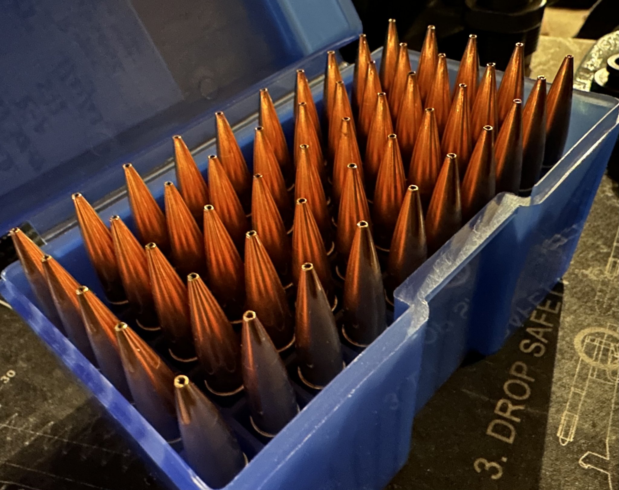

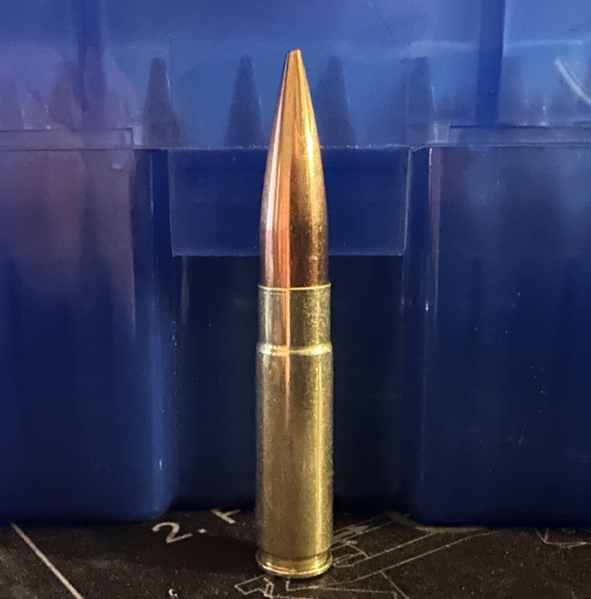

Precision subsonic Berger 210 VLDs. I’ll test them tomorrow to see how well they shoot. They’re seated 0.010” off the lands, thanks to the longer AICS 5.56 magazines. 👍🏼

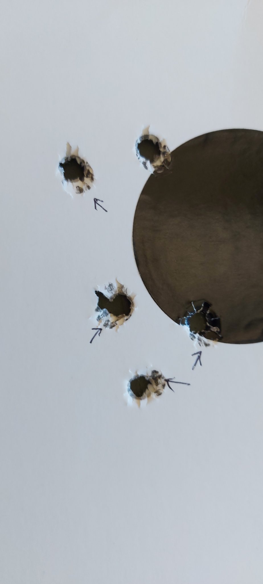

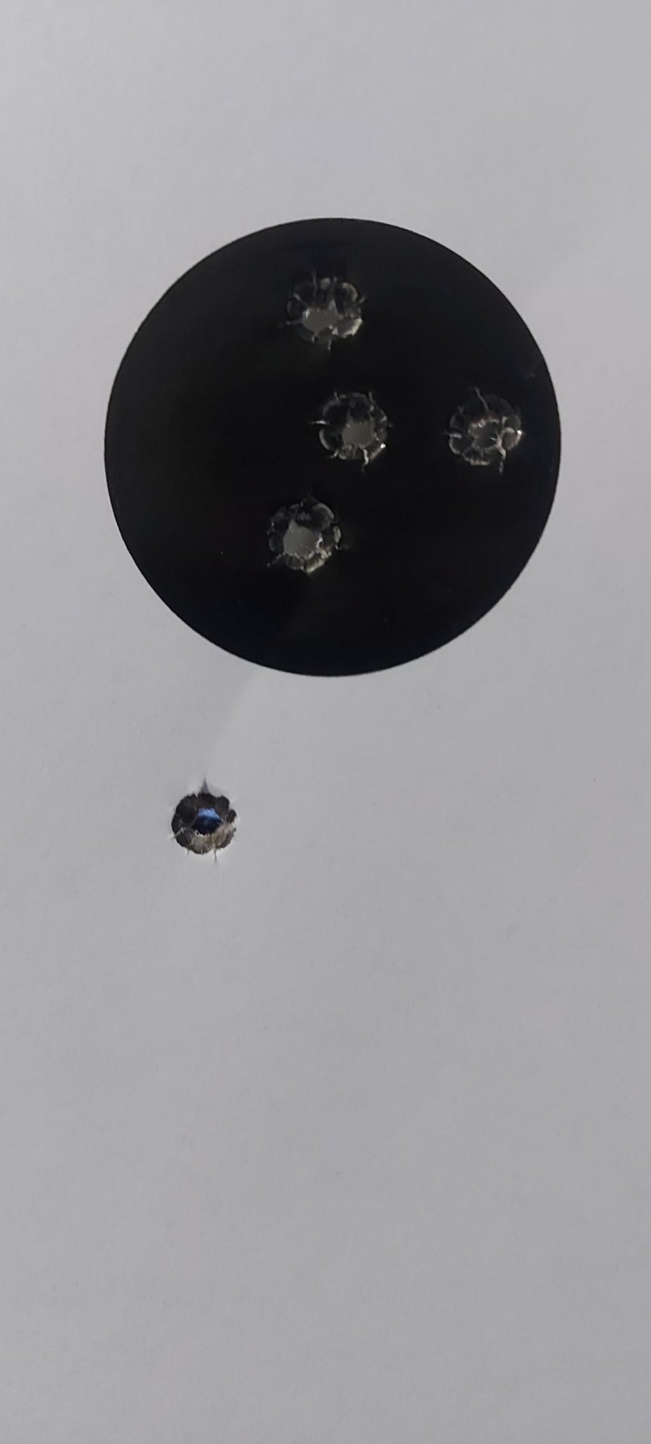

Does it look like these bullets are not fully stabilizing? (Bullet Hole Smears)
308 Win 20" 220 gr Hornady RN 1/8 twist 1030 FPS 100 Yard Target.
Yeah, that looks like a slightly to moderately destabilized bullet hole. With a 1/8 twist and the shorter 220 round nose, it should be more than stable. I've shot those out of a 1/10 and through a circa 2000 AWC Thundertrap with a really tight bore and I don't remember them smearing like that...kinda makes me wonder if there might be something else causing it.
Thank You All for the Help. I'm going to use the cleaning rod/tight patch trick to check the twist rate. Thats what I thought too that a 1/8 twist would be more than enough for heavy bullets subs/supers. Could a muzzle brake or barrel being an 5R rifling affect stability?
5R is the type of rifling, and should actually improve the accuracy based on how it's designed to cause LESS bullet deformation on the jacket.
But yes, if the muzzle threads were cut crooked, or the muzzle brake threads were crooked, or it wasn't machined 100% straight, or if you're muzzle threads weren't straight, and your muzzle brake is getting baffle strikes, or if your crown wasn't cut 100% straight, then it will cause this as well.

I had the same problem with my blackout and the 220 Hornadys. Switched to the Maker 210's and problem solved.

Loaded up some 220gr SMK bullets and re-did the ladder test. Perfectly stable. You are right Jambau, The Hornadys 220gr RN are not concentric.
Also tried some 208 gr bthp also stable.
Berger 210 VLD's and Nosler 210 RDF's the same... My Berry's .300 BLK 220 TMJ's are not stable in my 8.5" twist 16" AR, and they don't shoot very well in my 16" 1:7 twist Ruger American Ranch... However, the Berger 210's shoot REALLY well in both of them.
My theory is the RN and TMJ type .300 BLK specific bullets have an extremely long bearing surface, and they just aren't designed very well. The Berger 210's have a shorter bearing surface, and will most-likely stabilize in a slower twist barrel, because of less bearing surface touching the rifling. This is just my theory after spending years experimenting with subsonic and .300 BLK and .308 Win.

I believe the answer is in the physics. If you have two identical gyroscopes but one has a solid "wheel" and the other has one like a spoked bicycle wheel the bicycle wheel gyroscope will be more stable and for a longer period. With a higher % of its weight further from its axis it develops greater centripetal force. The Hornady 220RN and the Maker 220 are both round nose. The Maker is actually longer due to being a copper solid,yet it will stabilize in my 1:8 ranch rifle when the Hornadys will not. This is because it is a hollow point and therefore develops more centripetal force. Side note: I shoot the 210 Makers over the 220 Makers only because I found an accurate load for it first.
