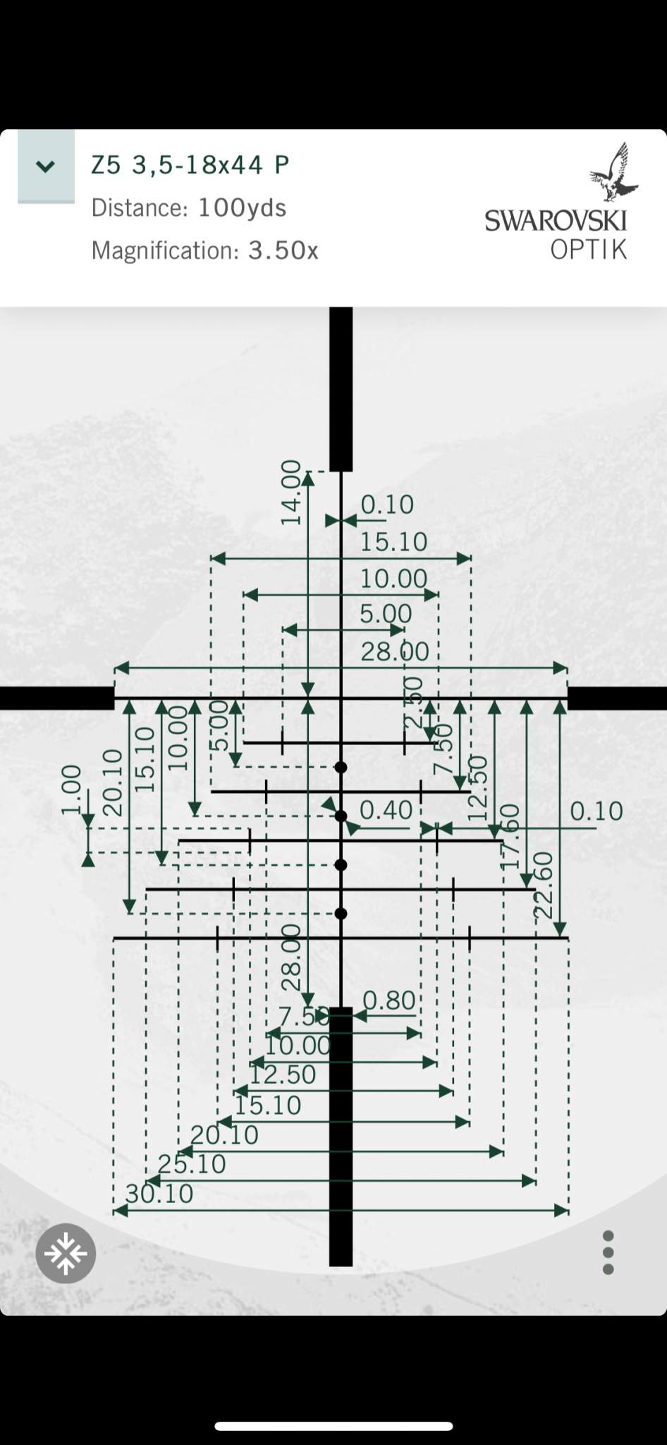

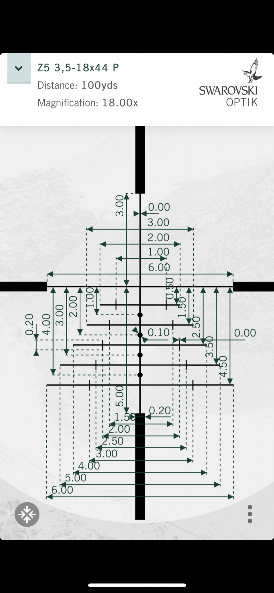

You have to download the app from Swaro. Here is the BRX reticle for the Z5 At 3.5 and 18 x showing subtensions in MRAD.

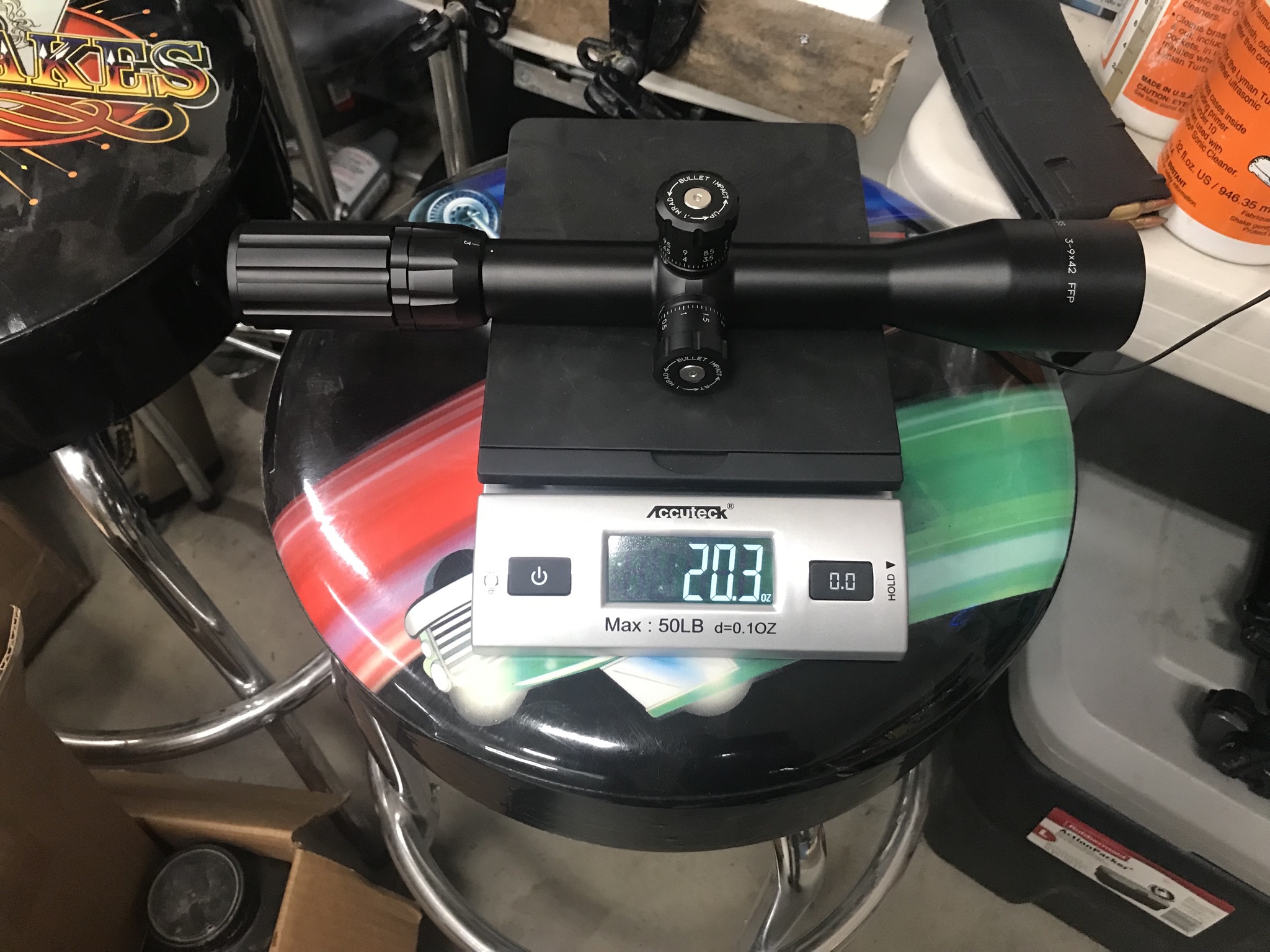

This one just squeaks under your weight threshold.
3-10 so more than 9x of the Leupold. MIL/MIL.
But it isn’t FFP but not a deal breaker for me on such a low mag scope.
Otherwise the 3-9x42 SWFA would be your huckleberry. :) But it is 20+ oz not the 19 listed:

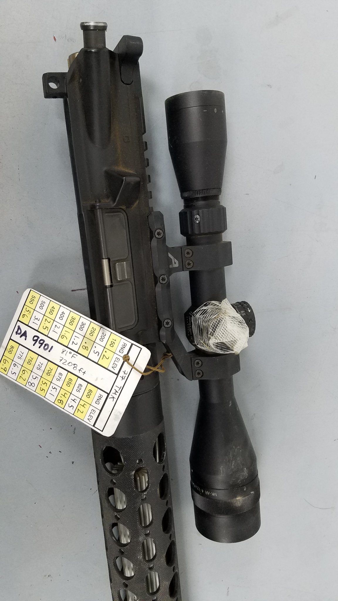

Below is the upper it currently sits on (JP Ultralight). Its beat up, but still works great. I taped down the windage knob since I carry strapped to my pack and I didn't want the windage slipping on me.

Fred and I run that same scope on the same rifle for the same event. I have to agree it's pretty decent. My only gripe is that it doesn't have a zero stop, and I can't figure out how to add one like I did on the Super Snipers. At the last SAC, I rolled into a shooting stage and the elevation turret had moved exactly 1/2 revolution. I rolled the dice and guessed which way it had moved, and guessed correctly. Lucky. For what we do with it (carry it in or on a ruck for 36 hours) it's close to ideal. I learned my lesson, though, I'll count how many turns from my zero to the bottom.
They used to make the mark AR in a capped dial version. It might be worth it to just pull the windage turret off after its zeroed and cap it if you can get one. I have a box of random caps from old scopes. maybe i could get lucky and one would work.
Ive also seen people put a glob of semi hardening silicon on the turret so it stays in place but you can still scrape it off if you need.
Isnt there markings below the turret cap that show which rev tour zero is on? My swfa 3-15 is zeroed when the elevation turret is touching the three mark. My windage is zeroed on the 5th mark. I couldnt forget that if I tried. Maybe the scope in question doesnt have that feature. A dab of nail polish or paint would serve the same purpose.
