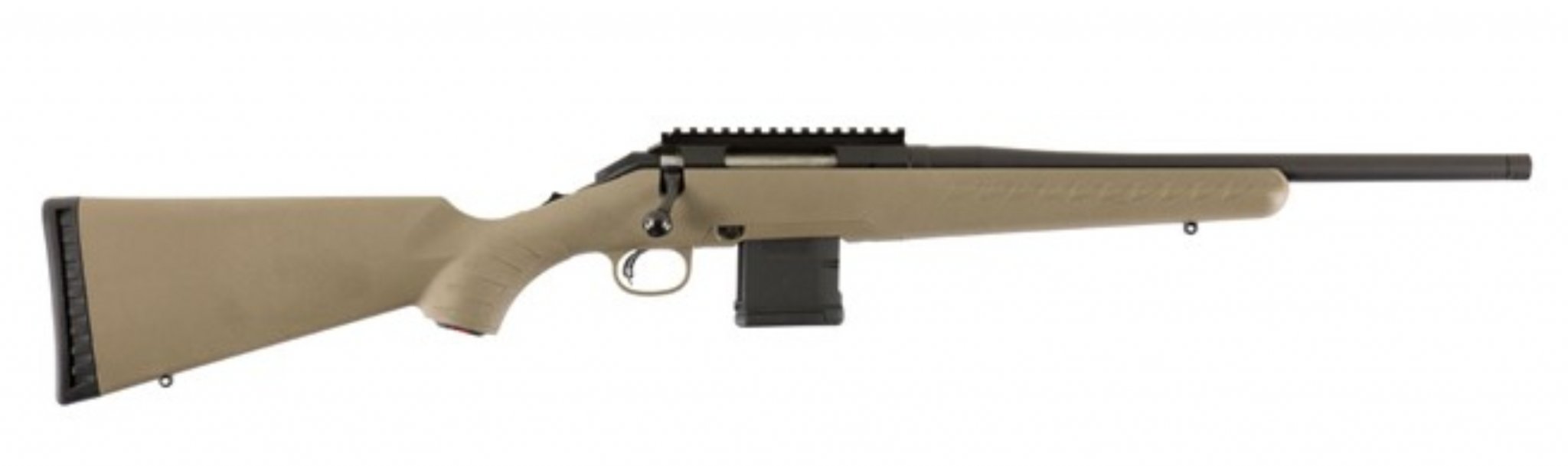

Any particular reason why you would choose .308 over 300blk for a subsonic only rig? Pay $200 for the tax stamp and chop it down to 10"-12". If shooting subsonic only, you gain nothing with the extra barrel length. A 1/10 twist may work, but I'd try to get closer to 1/7.
You could pick up a ruger ranch in 300blk for ~$450, chop a couple inches off, slap on a 1x-6x LPVO and have a very handy sub shooter
