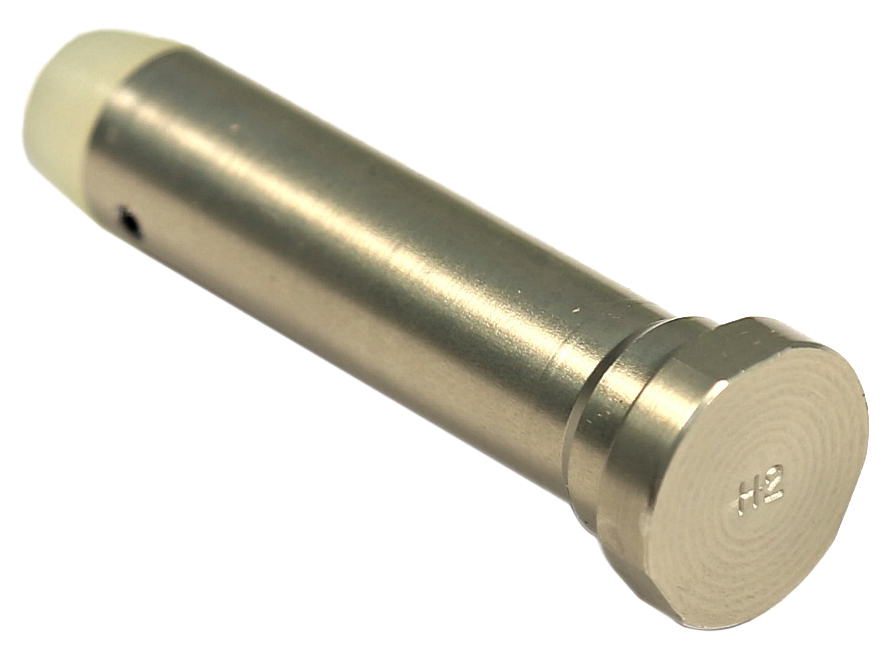

If you are willing to tune (H2/H3 buffer with springco blue or Vltor A5H2/H3 with springco green for example)

They are buffers and the spring in the lower receiver. It's very easy to swap. So the bcm comes with an H buffer. A carbine buffer is 3 steel weights. H buffer has 2 steel weights and 1 tungsten. H2 is 2 tungsten, one steel, H3 is 3 tungsten. Below are the rough weights of each. There are some minor weight differences between brands.
Carbine - 3oz
H - 3.8oz
H2 - 4.6oz
H3 - 5.4.
opplanet-noveske-buffer-h2-carbine-buffer-4-8oz-ar-15-main
Even if you go with the OSS, going to a heavier buffer can be a benefit depending on how the bcm is gassed. Tbh I'm not sure how the bcm 11.5's are gassed. If it's a bit over gassed from the factory going up in buffer weight is a good thing imo. Delays unlocking, reduces chamber pressure, less gas in face, less signature at your face.
As far as further tuning using different gas tubes or gas blocks there is a bit more to it. For you just increasing in buffer/spring weight would likely result in desired effect.
