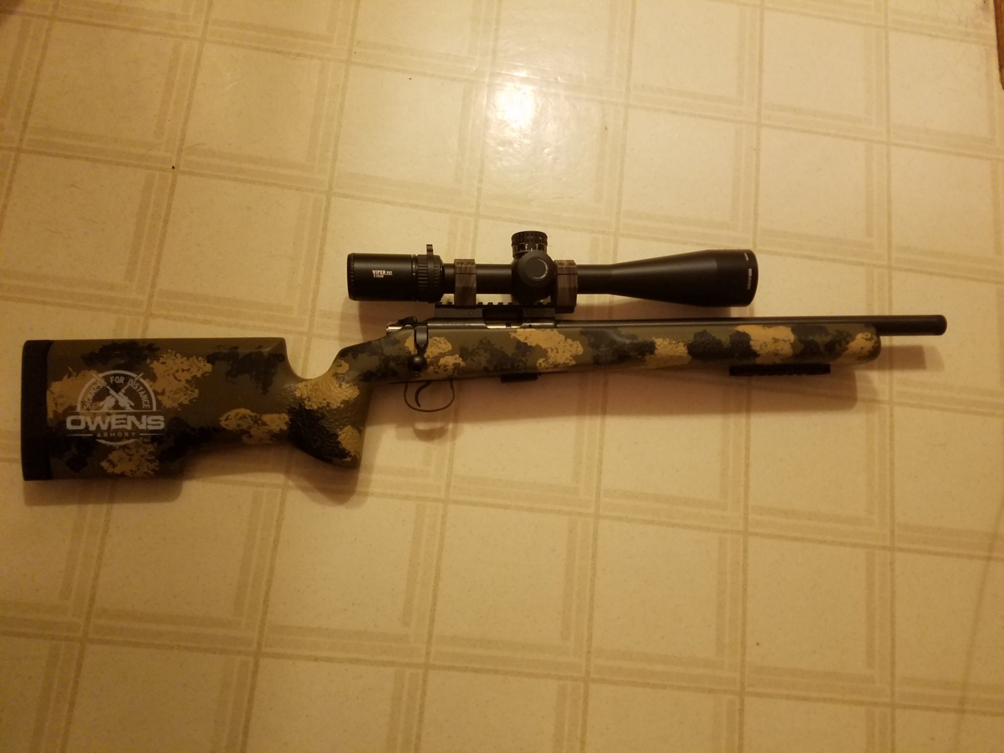

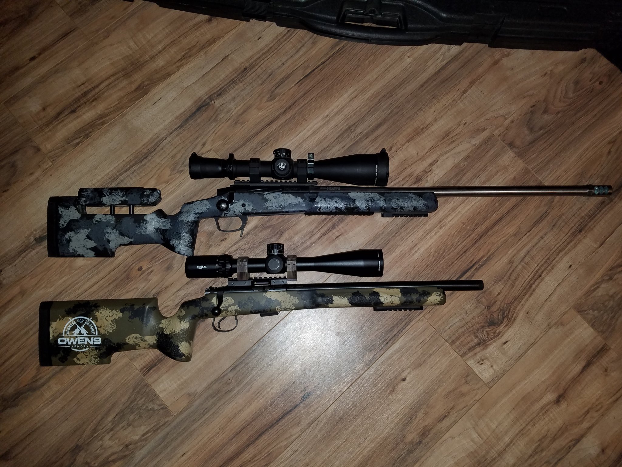

I finally pulled the trigger and scooped this little gem UP! I cannot wait to test drive her!!!
Thanks everyone for the guidance and especially Tiger Shilone. I went from a complete know-nothing (still don't) to making an informed purchase. This little guy is essentially a brand new CZ 455 that had some love put into it from the good folks at Owens Armory. Trigger feels clean, rather crisp and light. It has an EGW 20 moa pic base on top with an unknown barrel (threaded) I have yet to pull it out of the Manners and look to see if it is pillar or glass bedded. I scooped it up off a friend who upgraded to a Vudoo last year. I think this was a great decision and direction for my purpose.

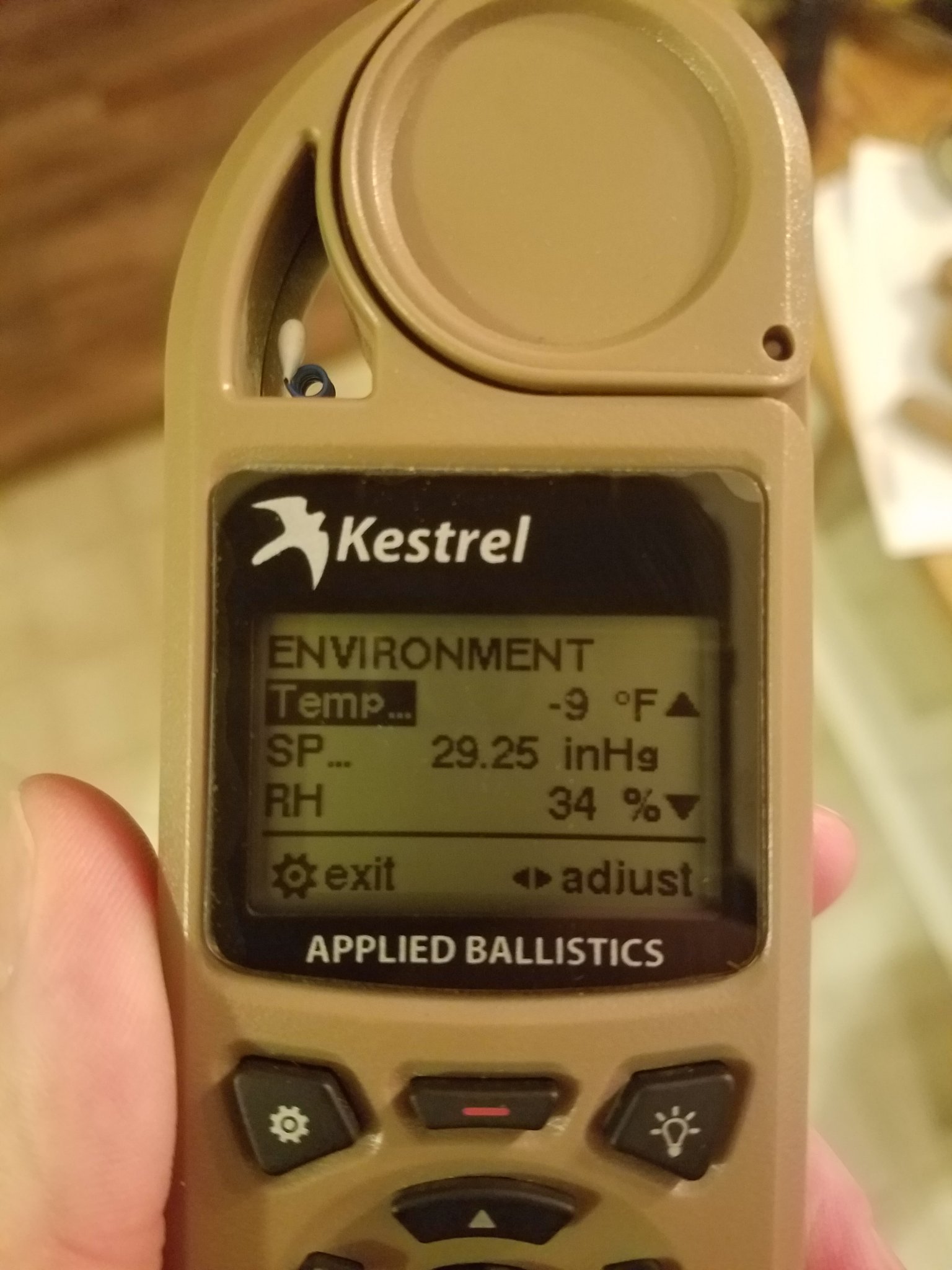

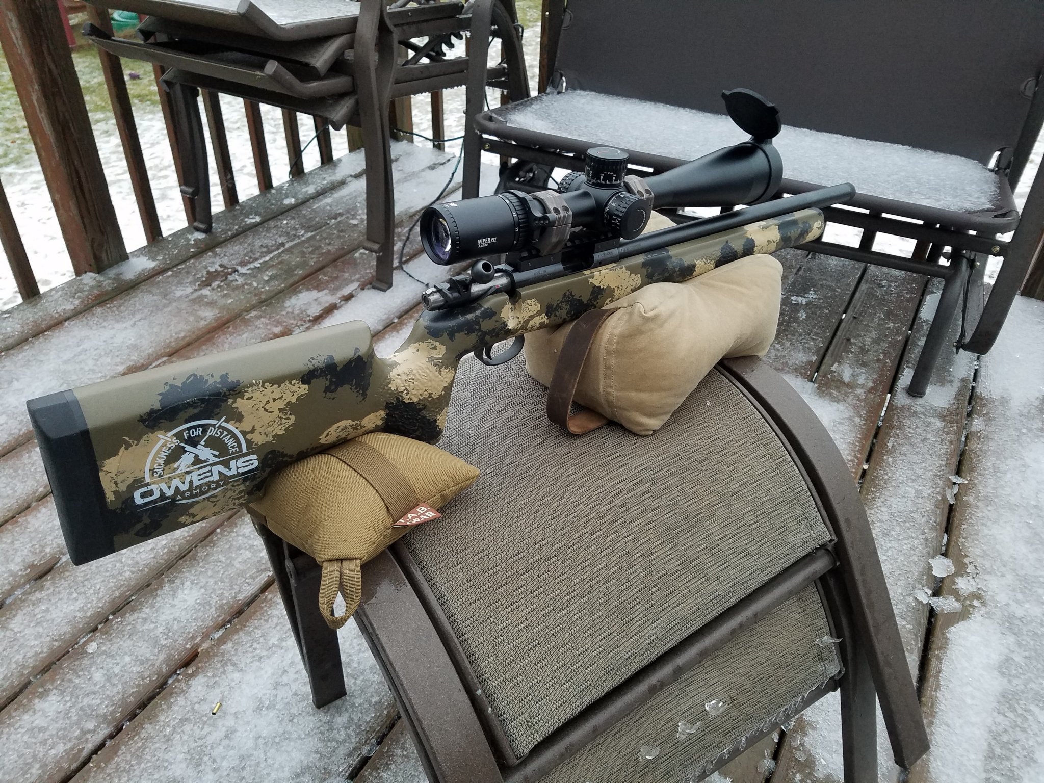

...might I add it was COLD! I really should not have gone out but, like I stated earlier I am like a kid in a candy store with this new 22lr.

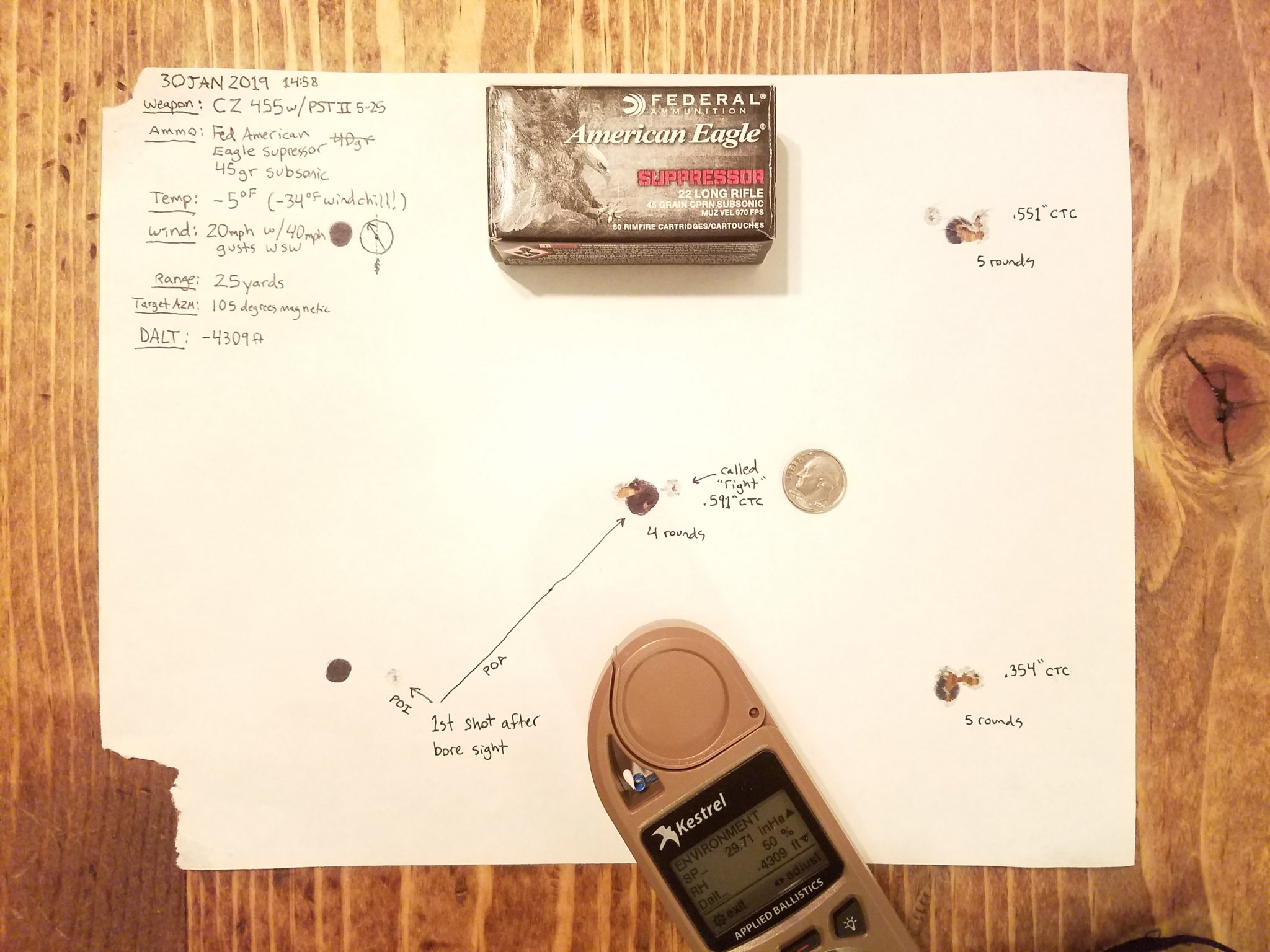

I bore sighted it indoors then went out back. I just shot in my back yard out to 25 yards. POA dots were apx. 1/4". I shot off my patio table w/game changer up front and a pint-sized for rear support. The wind was ridiculous and the temp skin piercing. Overall, the wind was apx. 1/2 value right to left. Zeroing was a breeze Ill say. I fired one round for a major adjustment and then fired the remaining four into the center big dot. Zeroed! I am a bit disappointed with the subsequent 5 round groups but I might add the conditions weren't optimal for a proper gun/ ammo accuracy test. I only had the one box anyways. Anyhow, thought I'd share my results and see what you guys thought. A tad disappointed, compared to what others here have posted BUT, time and more tests will happen. Cheers

Don't be disappointed in that!
1st, yesterday was WAYYY too cold to expect rimfire accuracy.
2nd, Who knows if that's the flavor it likes??
Rimfire starts getting crappy around 37 deg. unless you're shooting polar biathlon or the like. Even then, barrel temp makes a difference as well. I've gotten totally different results by simply keeping the gun inside a warm building in between strings vs. keeping it outside and letting it cold soak.
Get yourself a selection of ammo to try and be patient, wait for a 40 deg. or better day to accuracy test.
Try SK std+, Norma match, CCI SV, Eley Target on the lower end and then look to more expensive stuff from there.

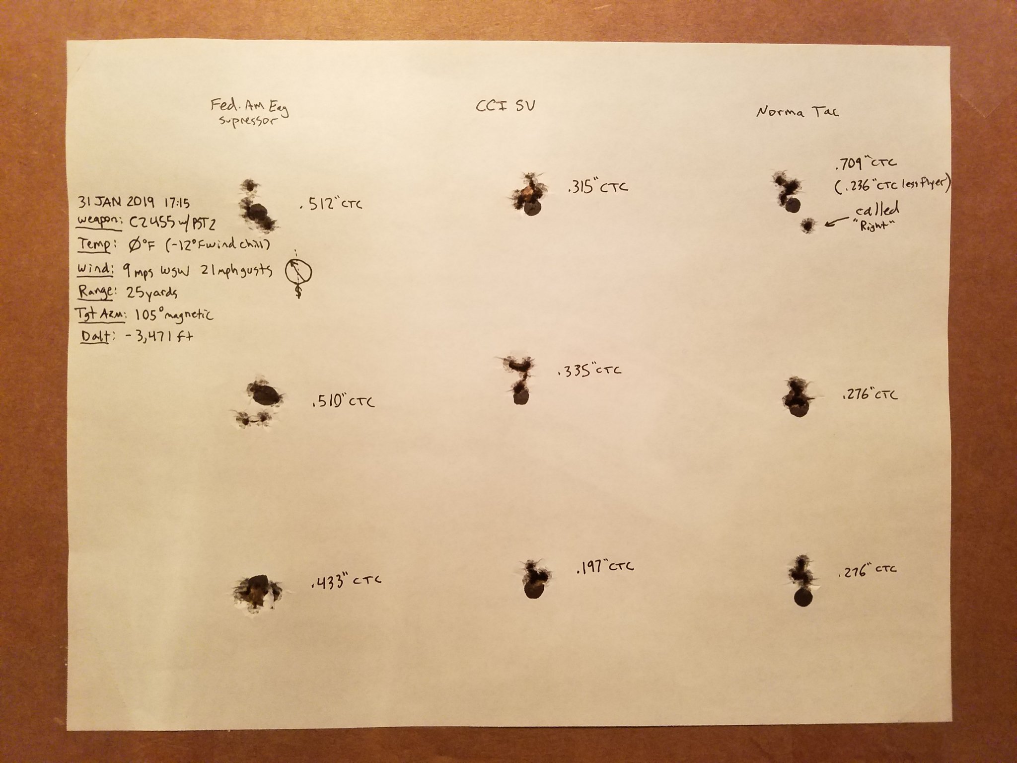

I just did what you suggested and got much better results yesterday! Posting shortly...
So yesterday as you will see on the image was a better day from a wind standpoint. Still cold but manageable. The Federal Supressor performed very similar as the previous days performance...BUT! It seems to really like Norma Tac22 40 grainers. I am now getting pretty excited?.

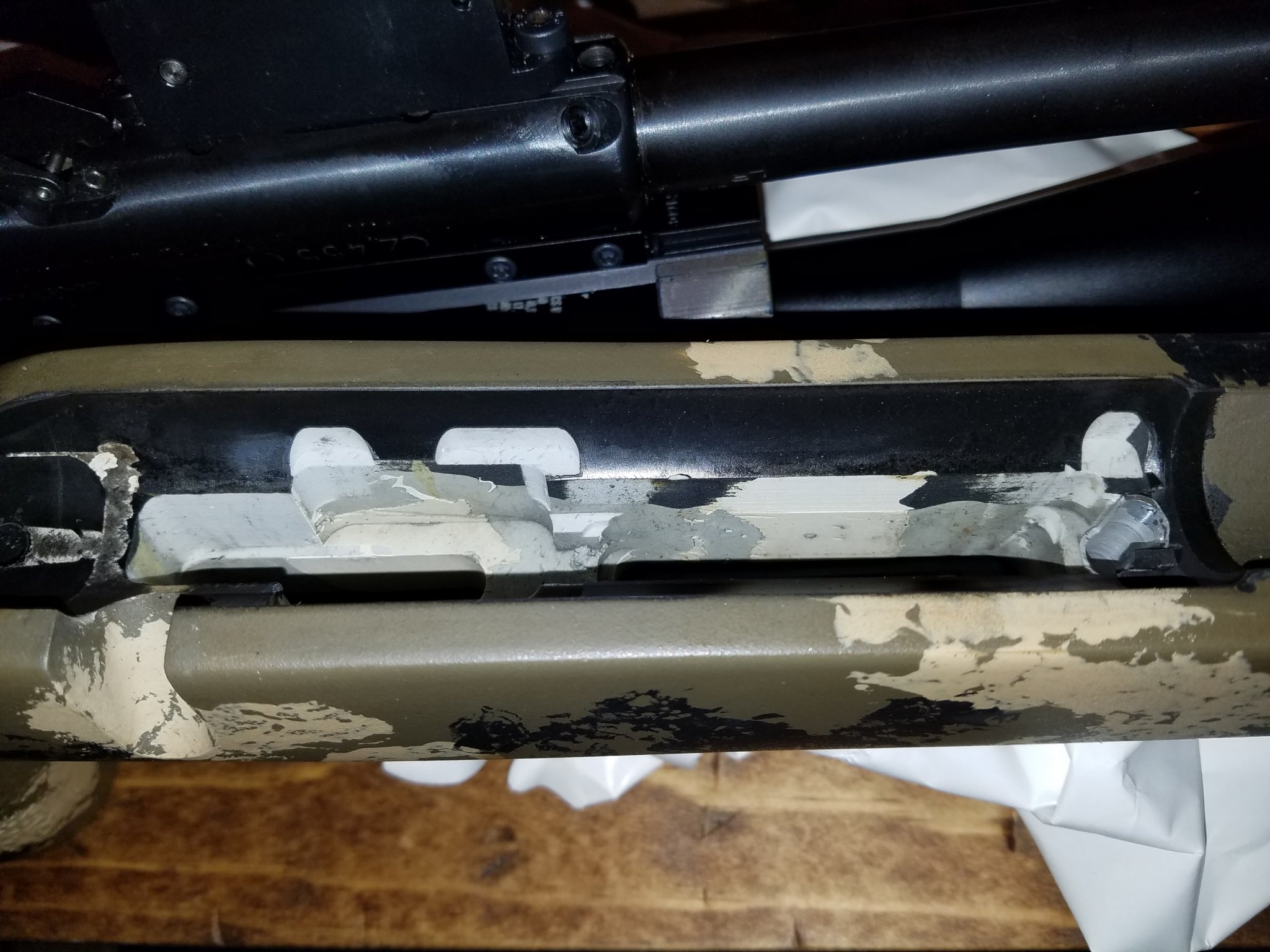

I finally decided to take the barreled action out of the stock and take a peek at wat all has been done by Owens Armory to this her CZ 455. I am impressed. It appears they installed a front pillar and also glas bedded the action to the stock. It also appears they did some milling or polishing to the bearing surfaces between the trigger and the sear and adjusted the spring down. I figured they did trigger work because how nice the break and weight appeared. Very satisfied.

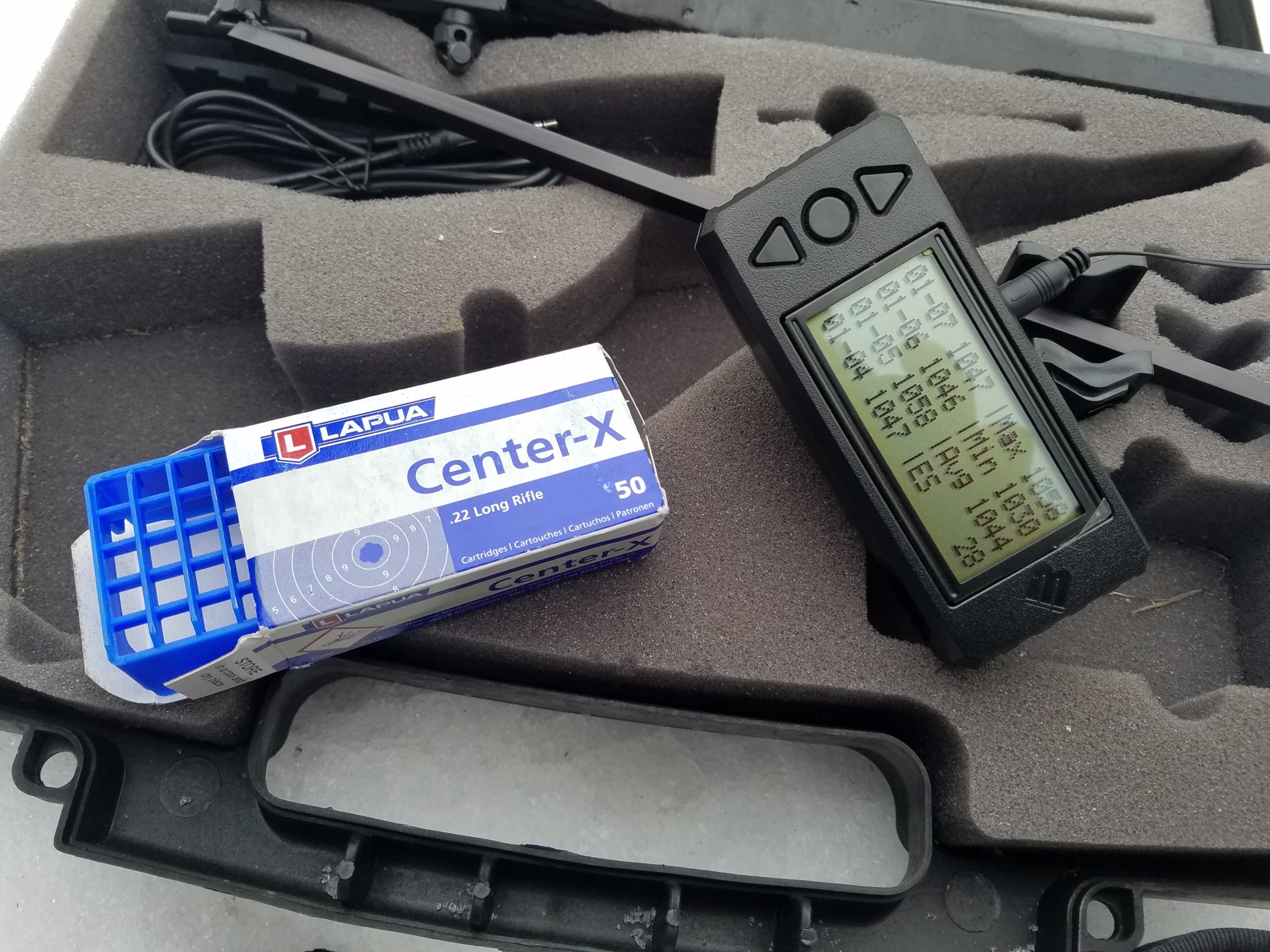

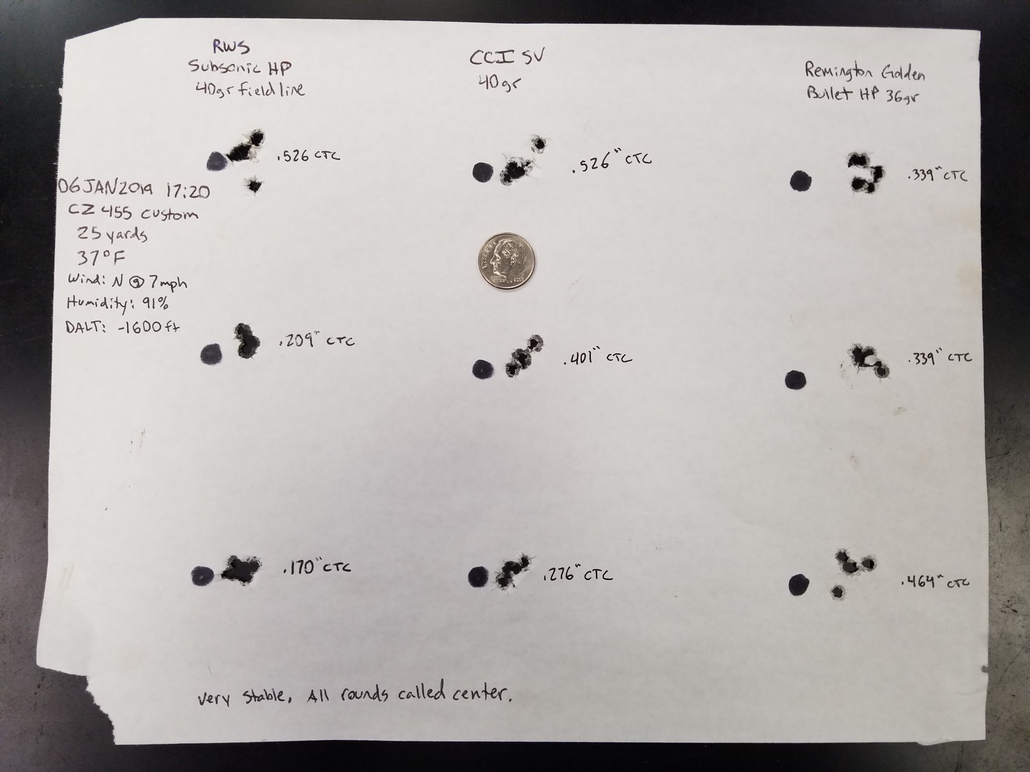

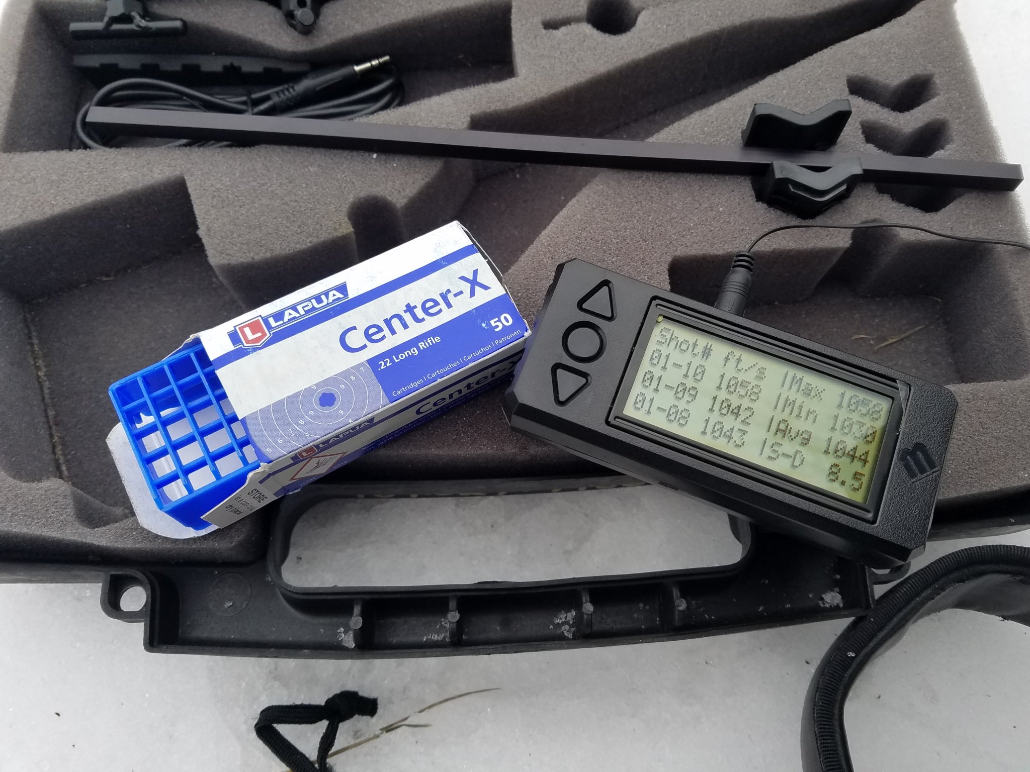

Anyhow, I also ran some RWS subsonic and Remi golden bullet thru it with CCI SV as a sort of 'control' since it has generally been consistent in its group sizes. The next step is to order up some Lapua center X, possibly Eley, and Wolf match. afterwards, I plan to shoot em all over a chronograph.
Looks like you got a good set up. These are a lot of fun with the suppressor mounted and when it gets warmer it's ammo selection will be easier to determine. 50 yards is the rimfire akin to the 100yd centerfire zero where most comparisons take place.

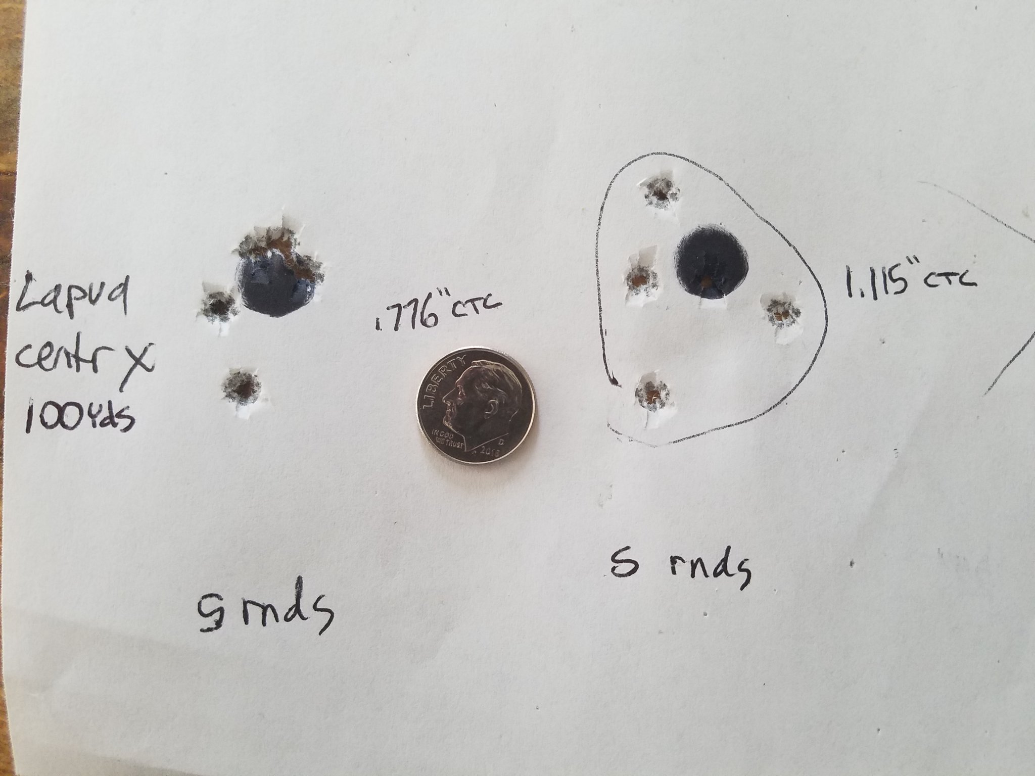

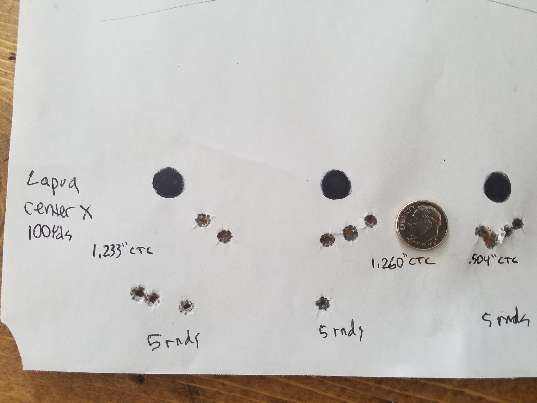

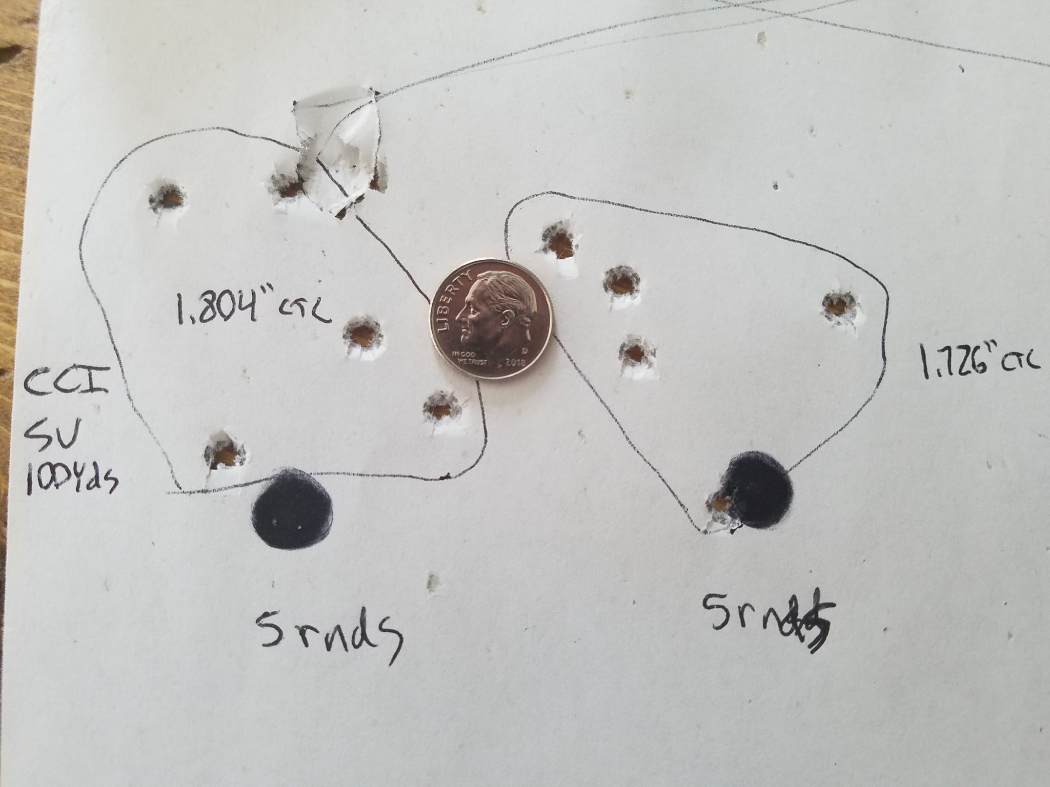

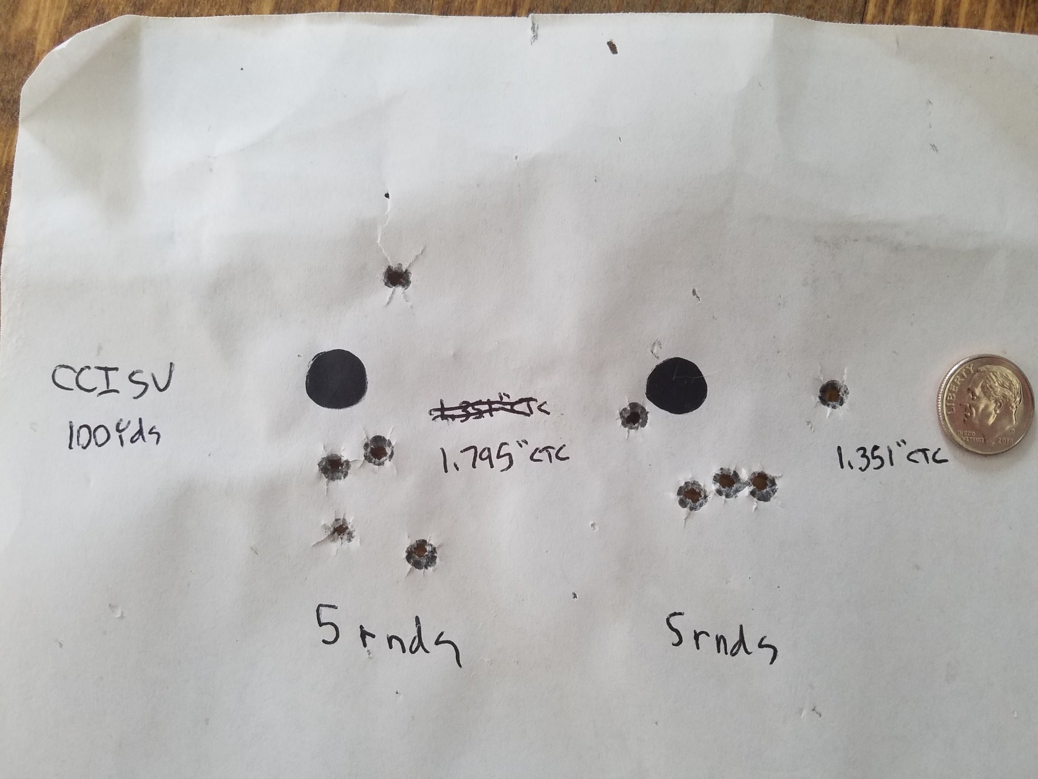

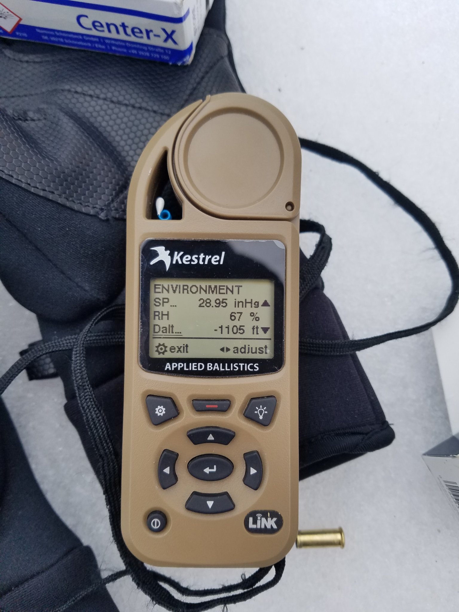

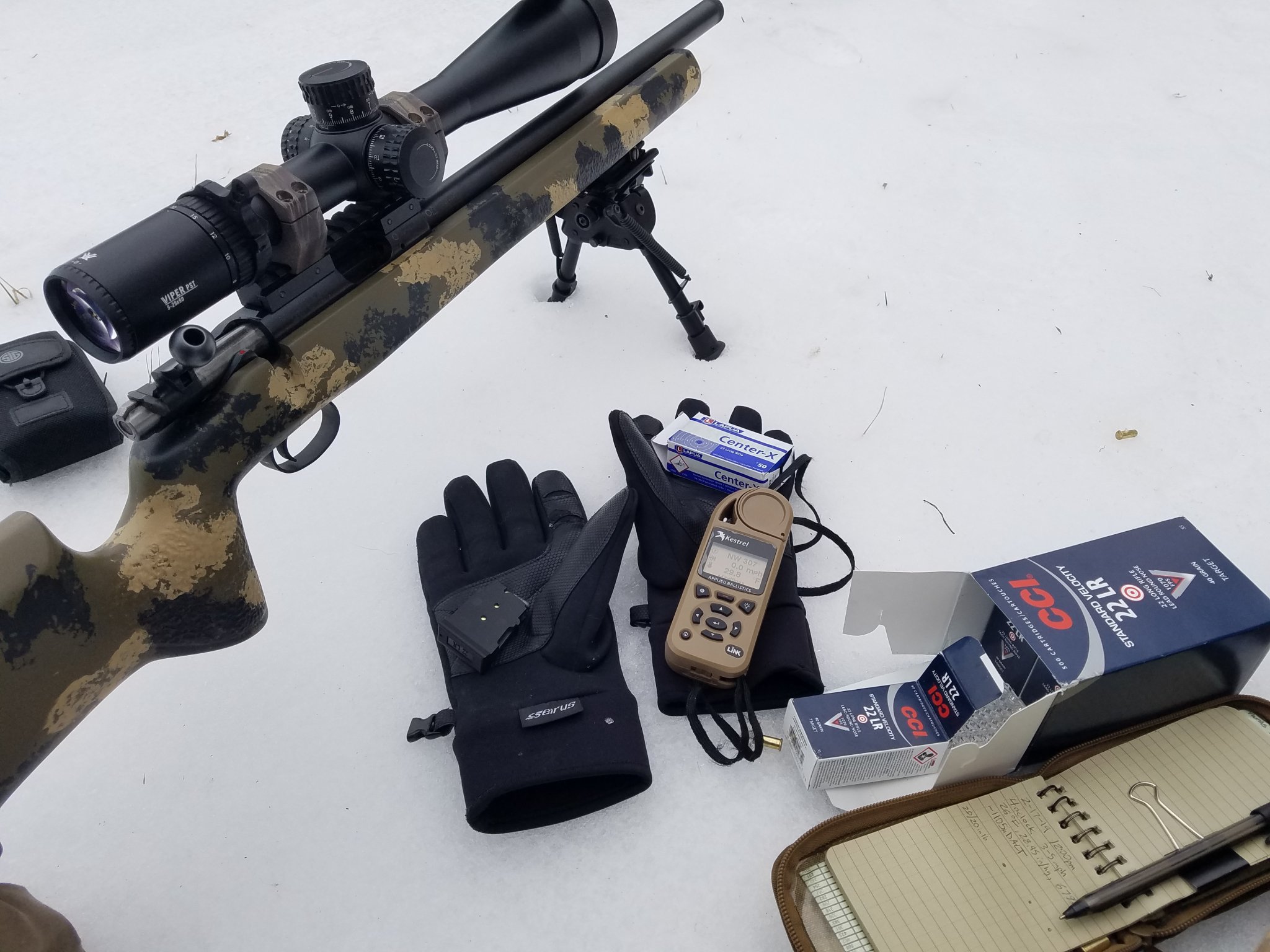

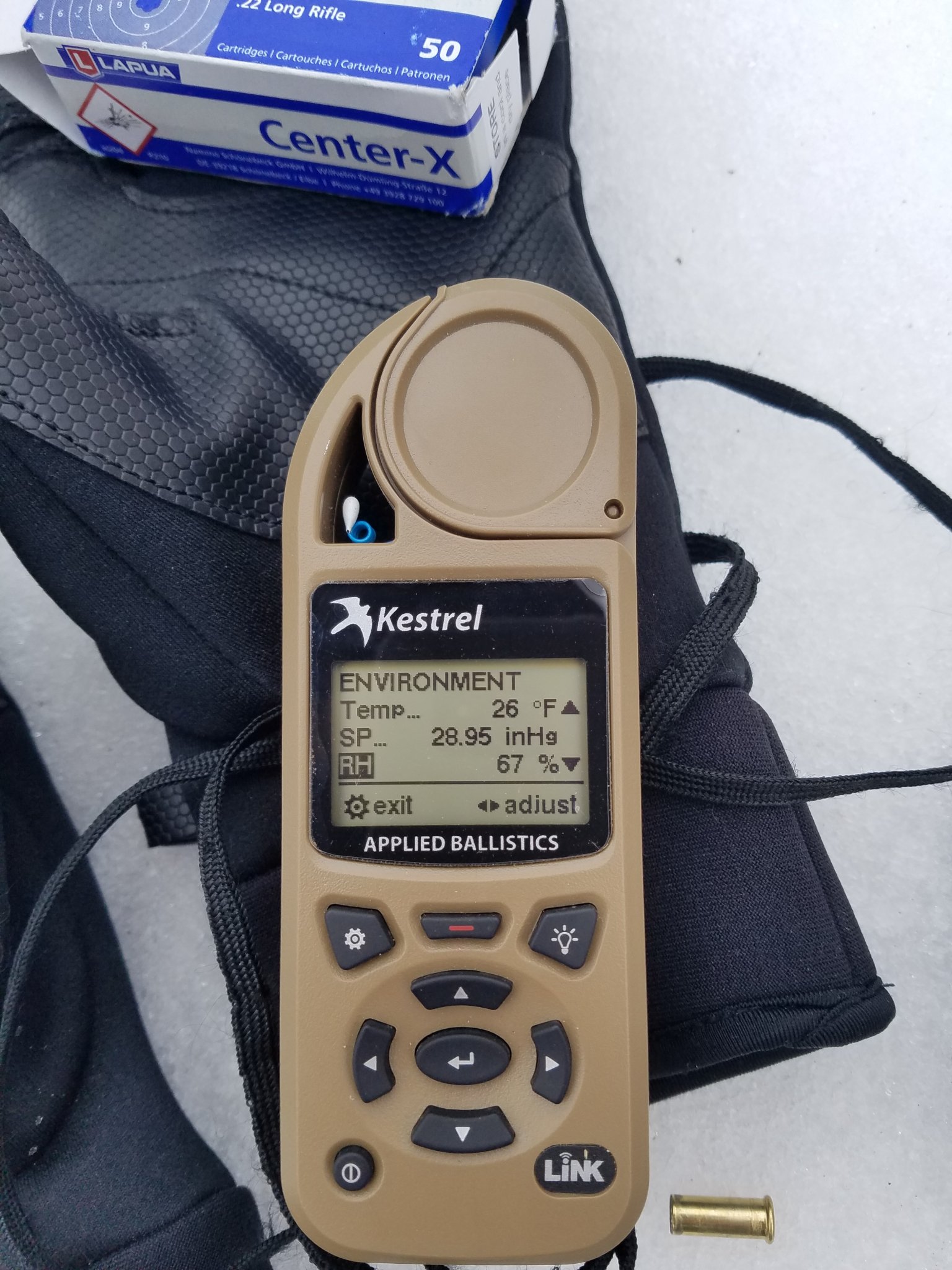

Made it out to the range yesterday and decided to put a bunch of rounds down the tube iot hopefully season the bore and wax it up a bit. Once I had a couple hundred more rounds thru it I decided to send some groups at 100yds and see what I got. I shot CCI SV and Lapua center x. Here are the results:
