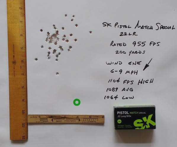

Testing was done in 2010 using a Swiss made Bleiker rifle which is well above average, and I'd guess the ammunition manufacturing components and equipment have changed to some degree.
200 yards, SK Pistol Match Special...impressive eh?
CZ 455 Varmint, Lilja EPS chambered barrel, set trigger, Mueller 8-32x44 target reticle, Sinclair bipod
That's a small sample. Nothing I would rely on for a verification of ammo quality.
Total disclosure, 50 shots, provides much more useful information.
Appears SK's stated velocity is out of a 4-6" barrel.
How does this 50 round group rank in your 200yd testing?
Base on the monthly 100/200 match I shoot, considering wind and direction those results should deliver a Top 3-4 position.
Were you shooting using wind flags?
There's no way to cherry pick when you have to show all 50 shots.

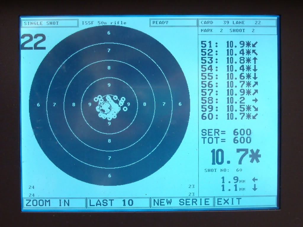

I often shoot 60 round prone training sessions at the Olympic Training Center in Colorado Springs. We shoot on electronic targets that show all 60 shots. The small circles are just the center point of the bullet impact. The last shot actually shows the OD of the bullet. The latest software upgrade corrected this annoyance.
This is 60 shots, aiming center of mass on a rubber 10 inch black bull with no scoring rings or other markings at 50 meters. Just over a 1/2 inch (maybe a touch less) vertical spread and a touch more for windage. For no small aimpoint, I will take it.

Can't argue with those results, all the information is available.
Comparisons between results obtained with large samples allow more accurate conclusions.
Using the ballistic calculator on the SK PMS results at 200 yards,
1064 low, 1104 high should produce right at 4 inches of vertical spread.
Measuring off the image shows 4.5 inches of vertical.
Accuracy limited by the ES, not the wind.
I presume this is indoors? Did you use a sling?
All ISSF positional rifle shooting is done supported with a sling while in the prone and kneeling positions. No slings are allowed during the standing stage of a 3 position match. No bipods or other artificial support is allowed, ever.
50 meter matches are shot both indoors and out. I believe World Cup and Olympic finals are always indoors to remove one variable that the shooter can't control. Hoser will have to say where he shot his target.
Thanks for the intel.
Prone, Atlas bi-pod, S&B 12-50, TBAC Ultra 7 and a magical lot of Eley (Blue) Team. Just having fun at the Olympic Training Center. Not everything has to be coat and sling. But the ISSF target is very unforgiving as far as the 10 ring goes. Even more-so holding center of mass on a big black blob of a target.

200 yards and 50 shots at a single aimpoint.
Sent 20 to season the freshly cleaned Lilja, then sent 50 at the sight point.
Chrony kept track, not bad, but a higher mv than the Annie likes with it's tuner.
1111 fps hi, 1093 avg, 1081 low...only 30 fps ES
This batch of Tenex was shooting like cold weather biathlon ammo...mislabeled box maybe?
The muzzle velocities didn't fit the annie's harmonics and were showing undesired vertical spread.
RvP2agmreju_fXHx2FlSV800EQC9ZoitrgdqR49C7XSu3207PItCdlJvpnZkDGBYJUHi3R5kyCAOneArH9uK9iWdYgtwHUqM1oOrpmpqm2ZH7icnB-QetAizKAhadtA34pftQoMBqHNTLW_SYErp3ttAbKYz50nDAhOkvdJwRmkfCYh91kOtvoj65NG5WnAesGPo1mxqivZ5jToJcROPho4Eg3HXV9IjD8SKIwMeZSohaUpAhyIH3zZsvDHj8Dq1VuKZ-AgFQRw6LKENVMqATXs2_IbEOuIUBcCkN2docB6p44T1ST240AhkUmge0SDt4qgQpdeaIwyr6zT3zeFOi29bfppWiIaOsGisIsytiVqG3VJQ-HOGOVxX0KeEDwXhdXx3Pqb1FLQ1LZkVCZVNfelFHzkQNCYjqlyyRQSEmyMbyAgT56Pm0-_3GSe55iv8_BcHvaFz4yviU8ESll0h5r7ugvXzt-2nE5EgwjtAa0cDb2Km6myNeHDkU9A1k07e5HgMTPkANJEJQF7V1PImTGVsWN0AU74lA2IR1NUtBMnnH9b-5x6qnEJoGQDTS_cogRHsfD9WYVWSOxZoW1CK0irxcHhVZjV55egvKULG3NPtDCH6eg8F8aAOZp39dZMIsgaS71krobhq9hCOmmtVQDxpqh-HvH7S=w323-h536-no
With my bedded barrel the differences in mv average have minimal effect on the results.
With a bench rifle and tuner set for a specific range of velocities, problems can occur.

I got out today and had a chance to test the ammo I picked up out to 300 yards. The SK Pistol Match Special was the winner. Some of the other ammo I had shot just as good but was about twice the price. I started out at a fairly sheltered 100 yard range and then moved to an open range where we were getting wind from 10-15 mph which made shooting pretty interesting.
