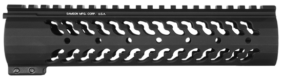

Hi,
I have a LAR-15 RRA Elite Comp that I am planning on using for hunting and I'm trying to lighten it up so that it isn't so heavy to tote around in the field. I am swapping the stock out for a Magpul CTR stock also.
The handguard that is currently on it is
What I'm not sure on is what I could replace it with, I was thinking Magpul's MOE handguard but I'm not sure what length I would need. Would it be midlength? From what I've read it would be easier for a gunsmith to change out the handguard because of how it is attached.
Can someone help me out?
I'm looking to use a bipod still and I know the MOE handguard allows for pictinny rails to be mounted.
Here is what my rifle currently looks like:
Thanks for your help!

I didn't take into account that the MOE was not free floated. Currently the rifle's handguard is free floated. I didn't see those variants listed on Midwest's website, could you link me to them?
Edit: The current handguard is about 16 oz.
Re: Switching Handguards on RRA Elite Comp
MI SS12 G2
http://vtsupply.com/mi-midwest-industries-ss12-g2-free-float-handguard-ss-12-gen-2.html
Troy 11" Battle Rail Alpha No Sight TRX Extreme
http://vtsupply.com/troy-battle-rail-trx-extreme-11-8243-vtac-strx-eli-e0bt-00.html
Specter Length Customizable Forearm
http://yhm.net/index.php?main_page=produ...42f835d15825487
Nordic Components Slotted Customizable Free Float Tube Handguard AR-15
http://www.midwayusa.com/product/2545182...-aluminum-black
Found out after calling RRA that it weighs - 21.3 oz
Someone has suggested the Daniel Defense Lite rail system and to go with a full length so that I can better use my bipod.
