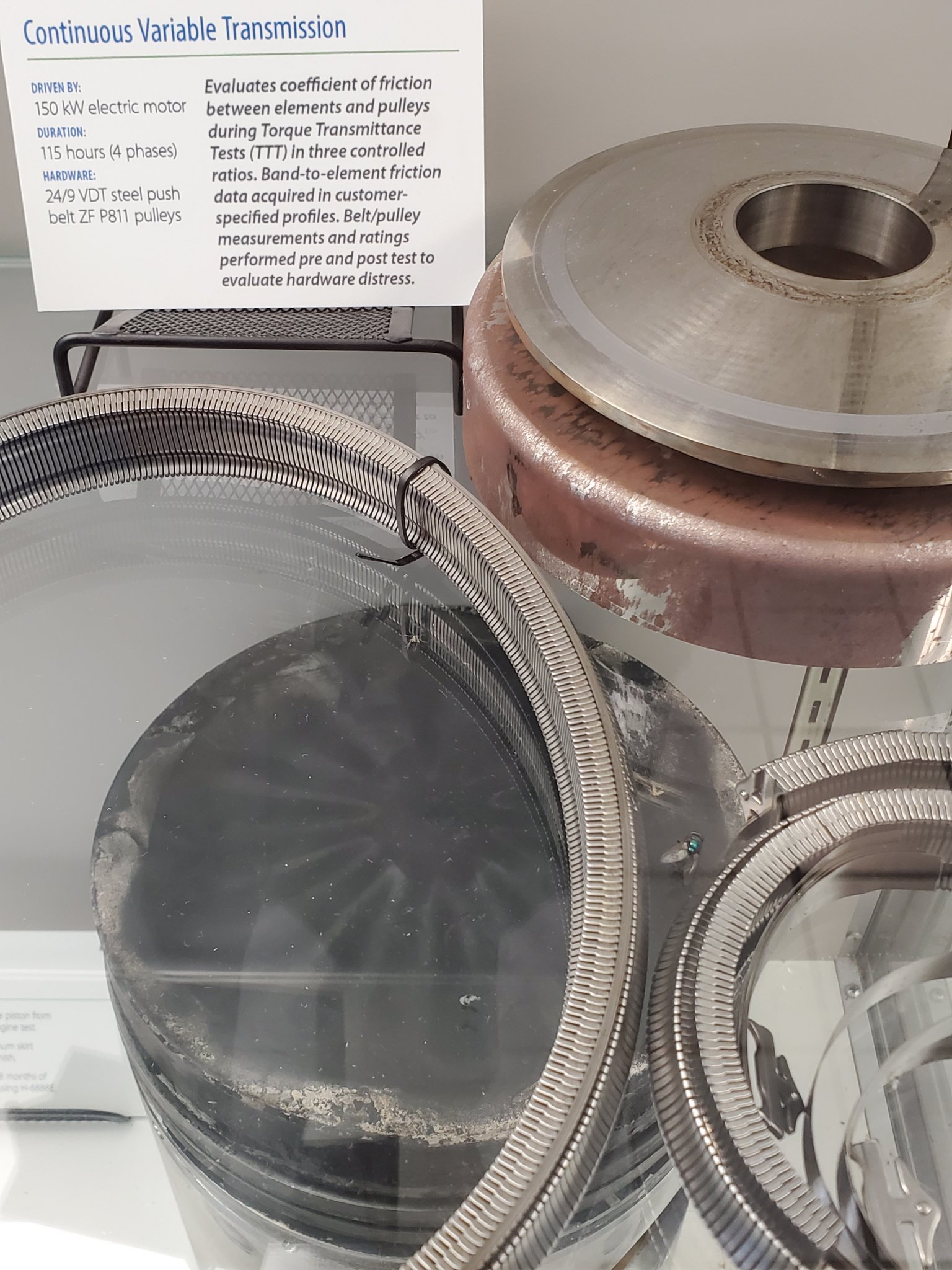

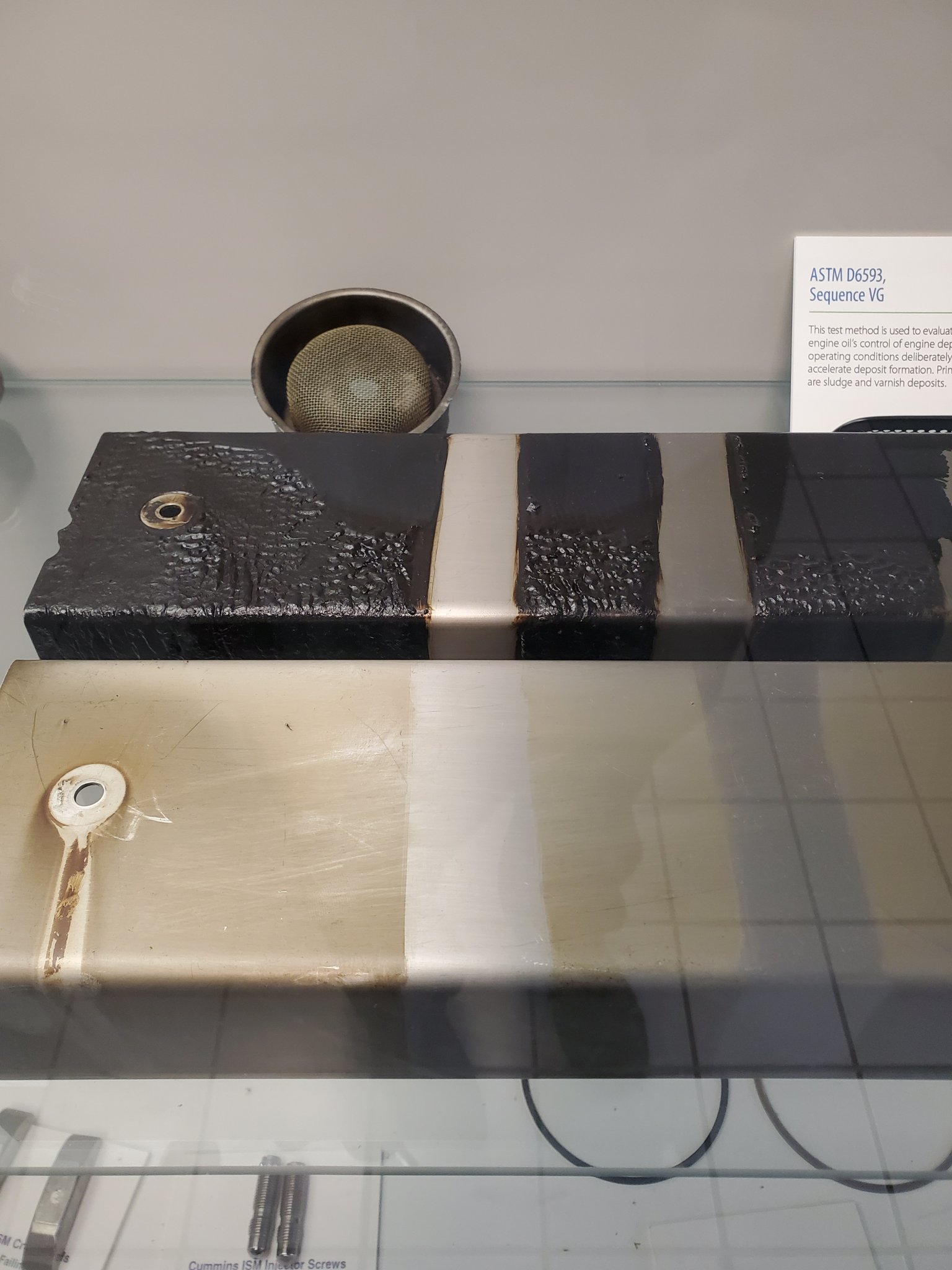

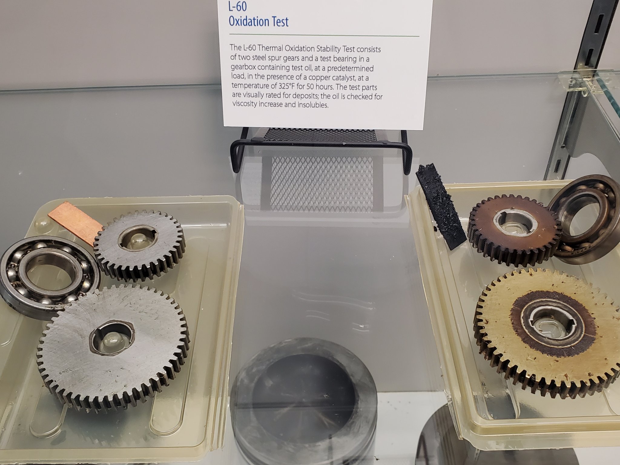

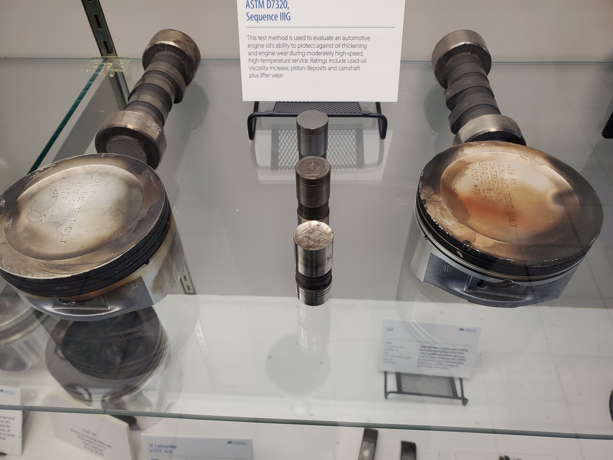

Here's a bit on insight if I may.
I work in an R&D facility for petroleum additives. As mentioned earlier "Bob is the Oil Guy" has a wealth of knowledge but application and technology are a huge factor to determine performance of an oil. Port injection vs DIG, turbo vs naturally aspirated, gas or diesel...Seal compatibility is also a consideration that we test for in our facility to ensure there is no breakdown of material. Microscopic metals; lead, copper, iron also impact performance as does byproducts from the combustion process such as blowby (the fuel you run in your vehicle impacts oil performance) ...Asking for the best oil isn't a realistic question.
All in all, industry tests are designed to break (fail) oil anywhere from 100 hours of testing to 500 hours of testing for engine oils and up to 500/1000 hours for ATF and MTF. These tests are extremely severe in order to show results quickly. We also run road tests as well since bench testing has it's limitations.
AMSOIL has run double length tests and passed... Kendal Titanium is another top shelf product that has had great results... but testing is is standardized. There are many different tests a single oil must pass to show performance characteristics to be approved for OE/API certifications.
Performance is a balancing act and so is the chemistry involved. Typically thicker oils protect against wear better... however, the engine must work harder (more resistance to rotate in thicker oil) causing less fuel economy. Thinner oils typically have better fuel economy but may allow some wear (still within passing limits of the test). Our analytical data confirms this. To add more to this; some companies don't want the best additive package... but only something that meets minimum requirements. Better product = more expensive product. At the end of the day an oil either passes or fails. It really is that simple.
Follow the manufactures certification codes, change your oil at recommended intervals, pick the brand you trust the most and you will be just fine BUT DO NOT GO CHEAP ON AN OIL FILTER!
